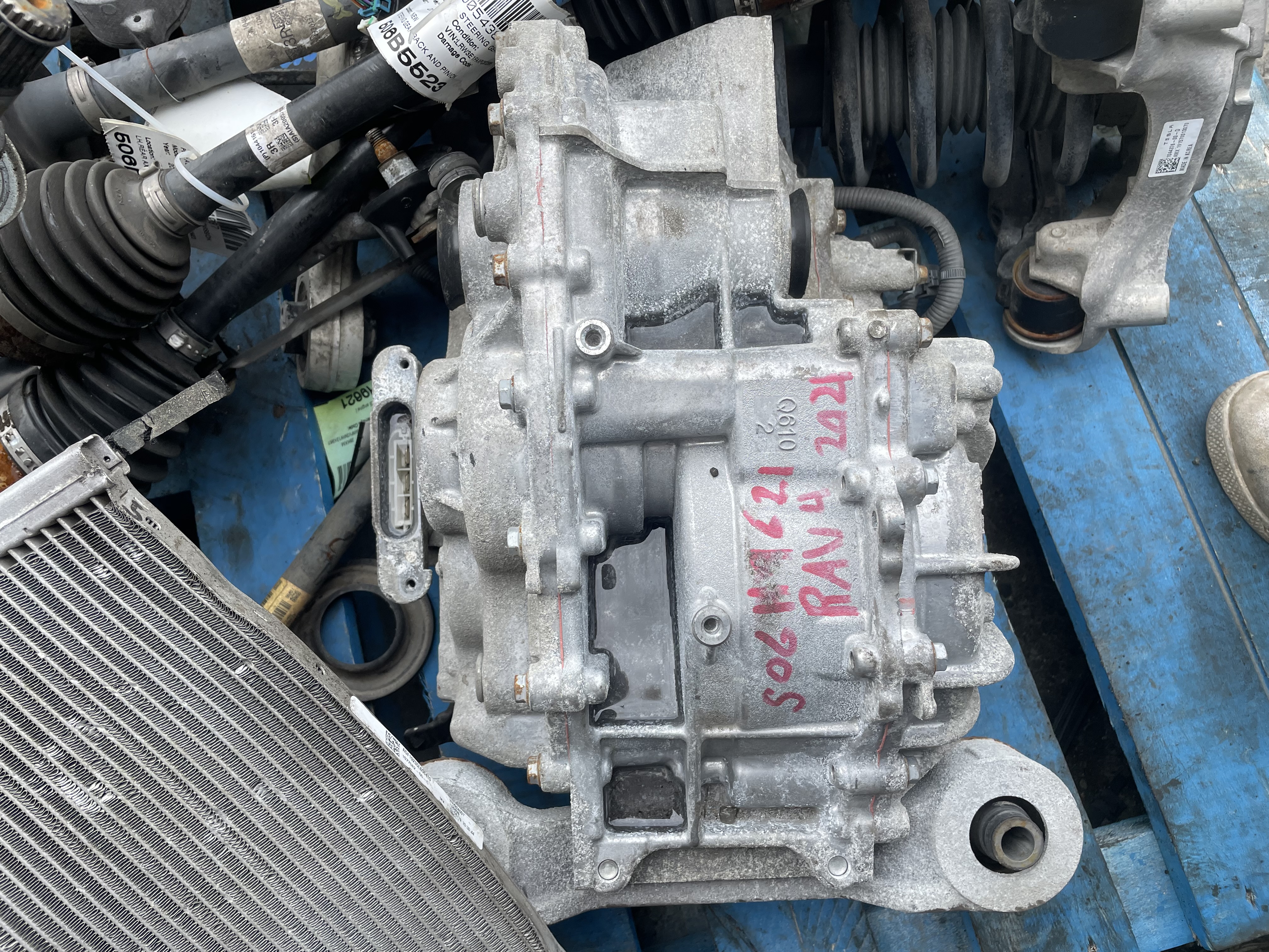

Starting a new thread to collect / disseminate info on the Toyota Motor Generator Rear aka MGR
Lexus / Toyota part number: G105048010
aka Q211-2FM Electric rear axle
North American market this is in the following models:
TOYOTA Highlander Hybrid 2006 - 2015
TOYOTA RAV4 2016 - Current
Lexus RX400h RX450 2006-2014
The MGR uses a Tamagawa resolver
Jack Bauer wrote: Thu Jun 20, 2019 6:31 pm I think the MGR with a little 12v oil pump and cooler would make an excellent low cost drive unit.
Oil cooling is a good idea, potentially allowing a longer high power duty cycle.
Synthetic ATF is used in this unit.
With more testing, will have more info to share soon. Anyone else utilizing this drive unit please chime in!

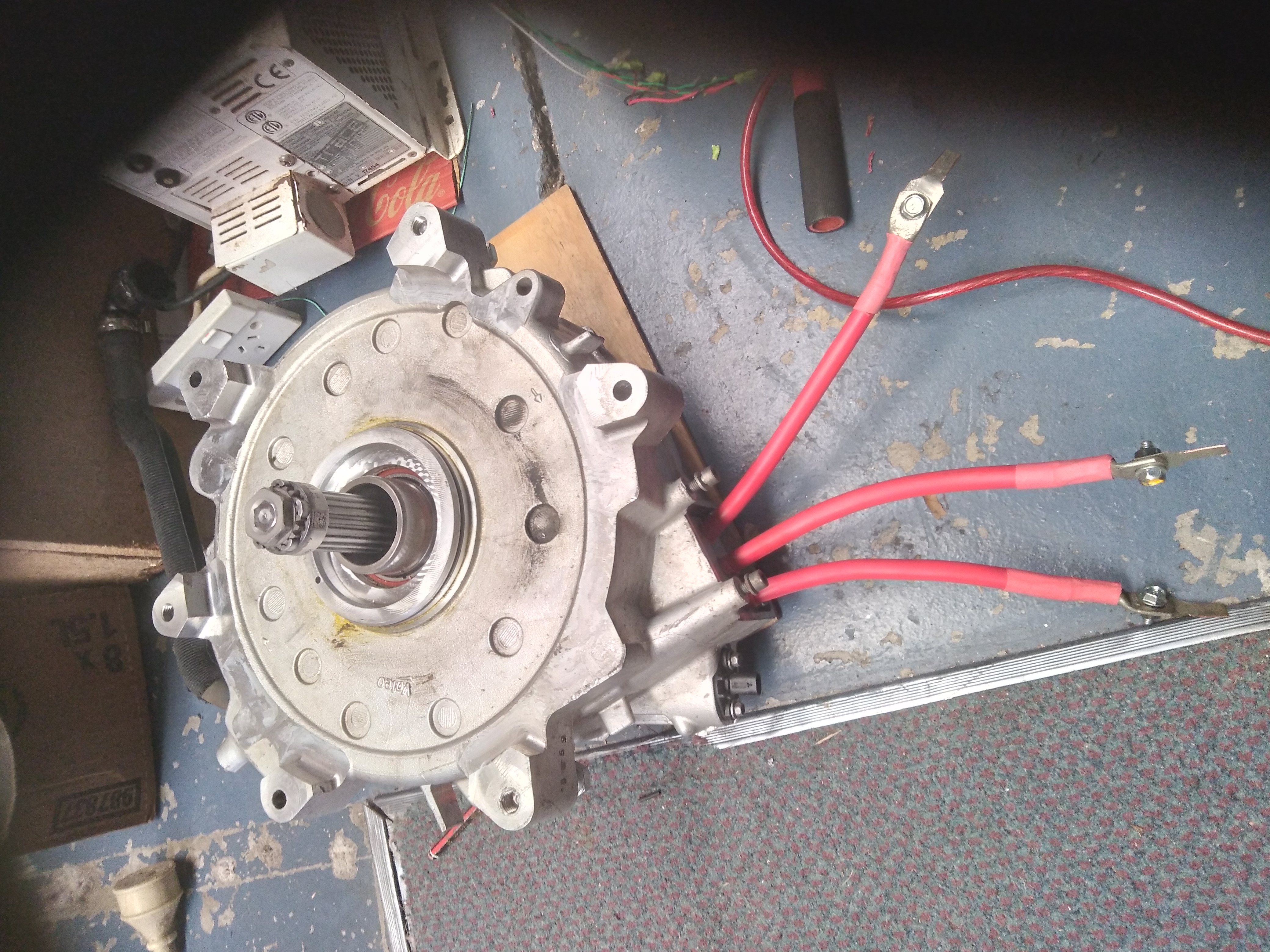

Just picked up one of these on Ebay for 200 Euros delivered:) 2007 RX400h
Mouse
Posts: 142
Location: Wales
Been thanked: 9 times
Re: Toyota MGR Rear Traction Transaxle
Post by Mouse »
Jack Bauer wrote: Tue Oct 15, 2019 7:41 am Just picked up one of these on Ebay for 200 Euros delivered:) 2007 RX400h
SNAP!!
Jack, Are you planning on doing any speed vs rpm measurements as information appears to be a bit thin on the ground for these motors?
I paid £100 and collected it at the weekend.
It was sold to me as a "LEXUS RX 400H 2004-2008 209048010 "
It has 2FM on the casting and what looks like a barcode and serial number sticker.

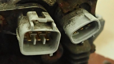

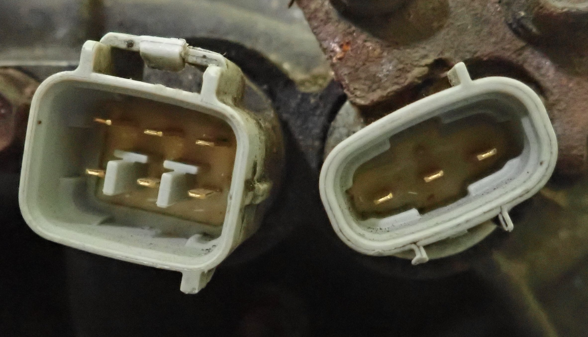

Has anyone identified replacement connectors for the resolver and temp sensor?
Trying to decide if something like an inverter from a 2015 Yaris would be a suitable donor to power it as they are common and inexpensive.
I also guess they are more compact and a bit smaller than the Mk2 Prius inverters?
