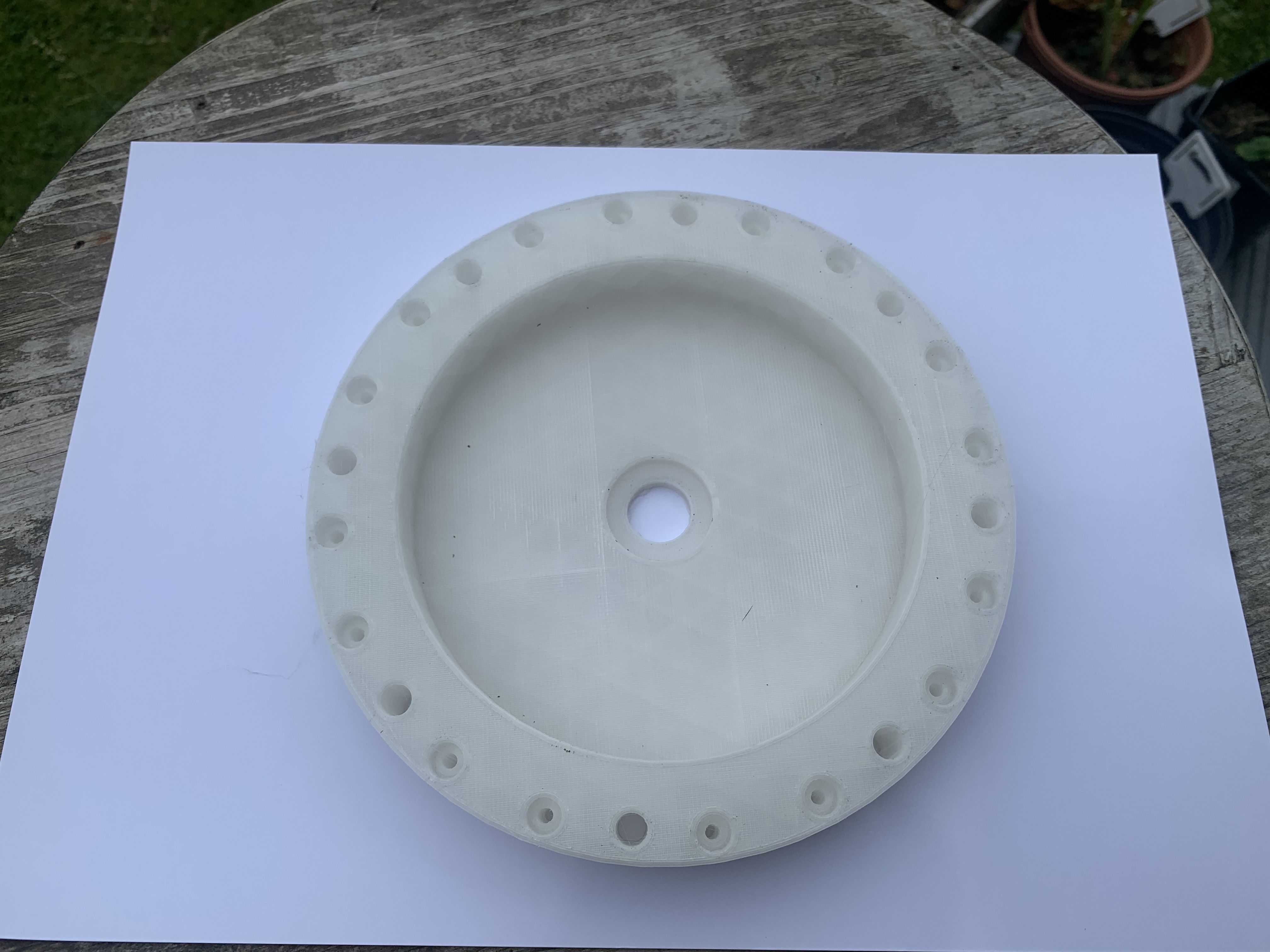

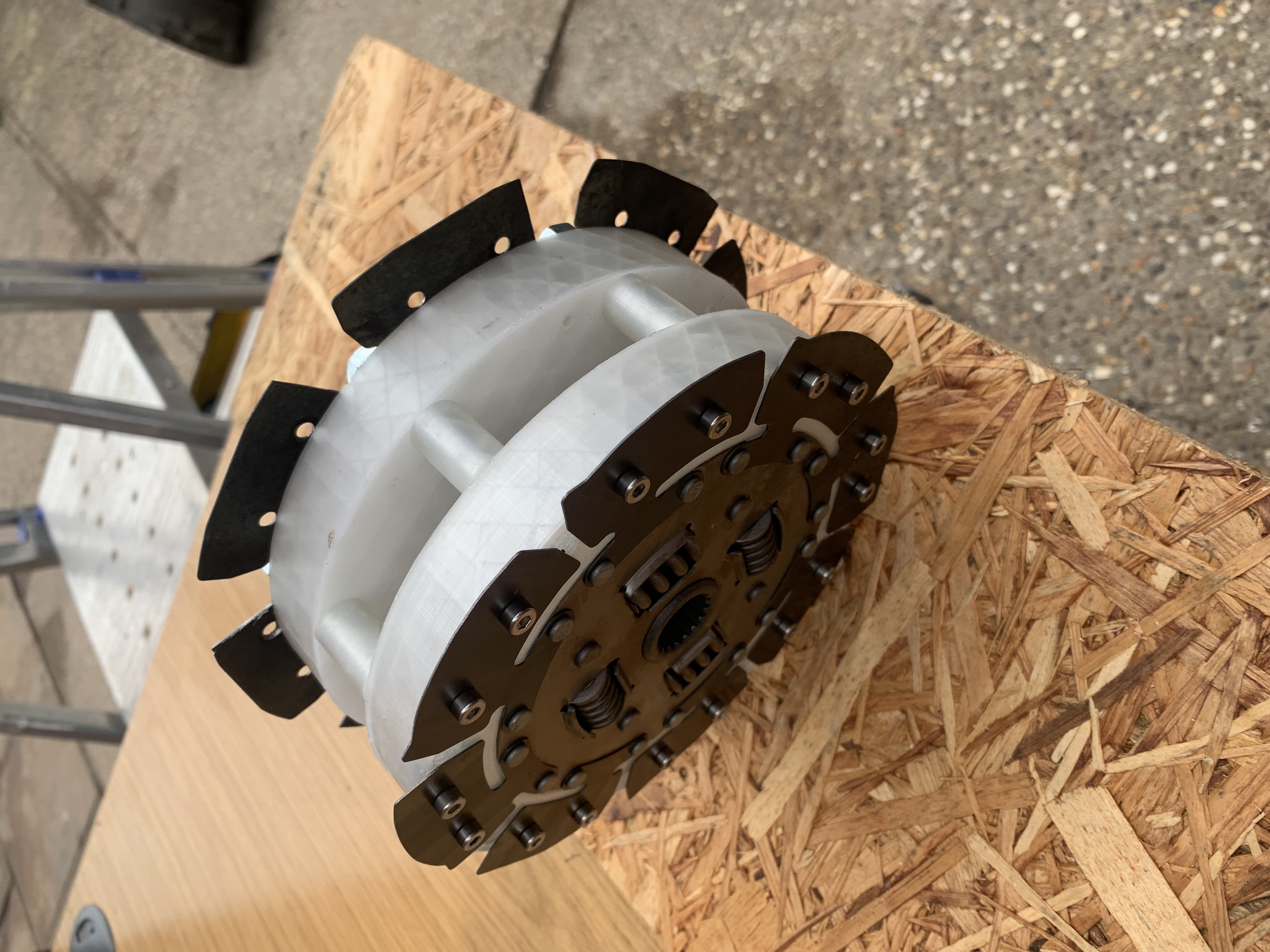

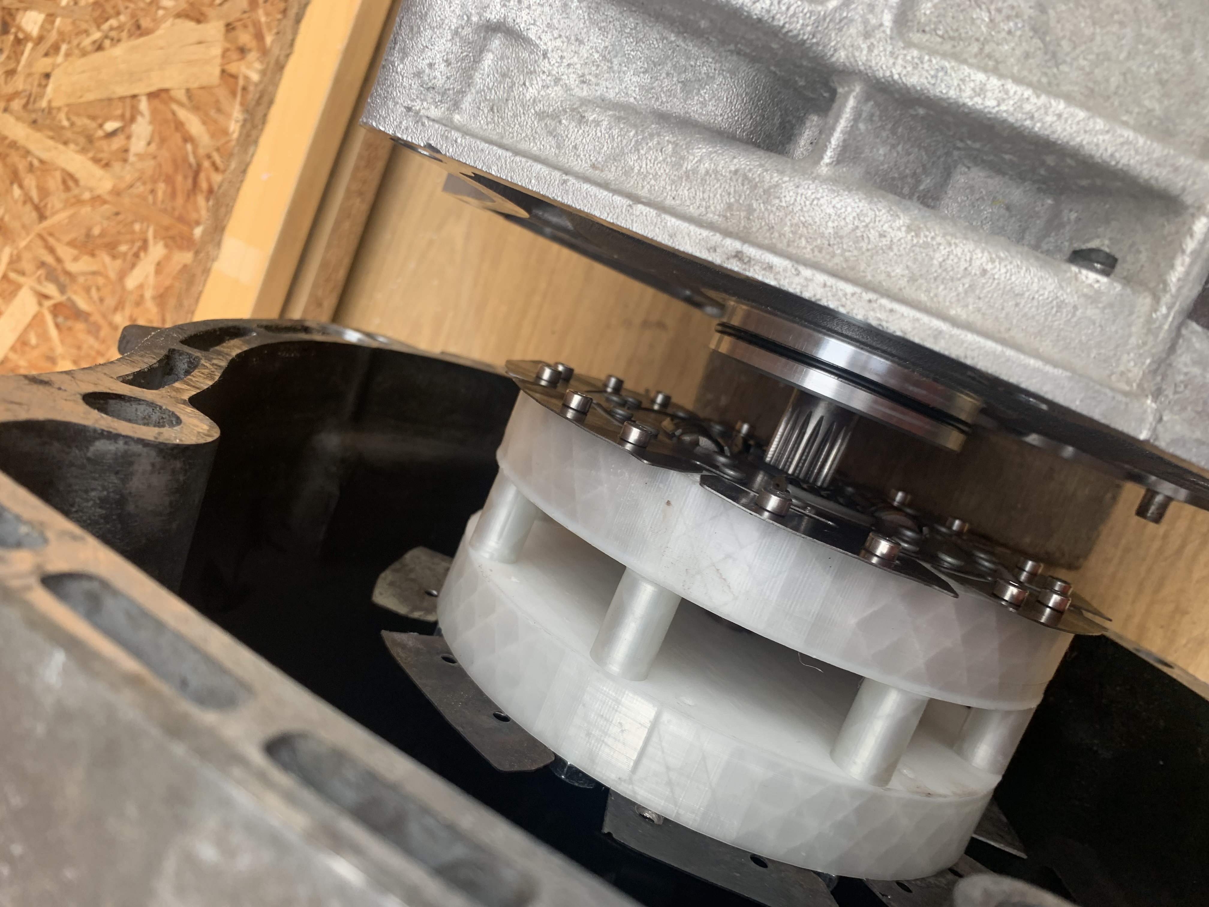

Hi I’m new here so go easy on me - I’ve been working on the physical motor mounting and battery boxes of several projects for a 3rd party and I’m now starting a project of my own. I’ve decided to use a Mitsubishi Outlander rear motor and have already purchased it - my question is how do I know the correct invertor to buy and also has anyone successfully managed to use outlander charger and dcdc? I plan on using a very small battery pack for the battery pack for the 1st stage just to get to a driving vehicle point as quickly as possible!

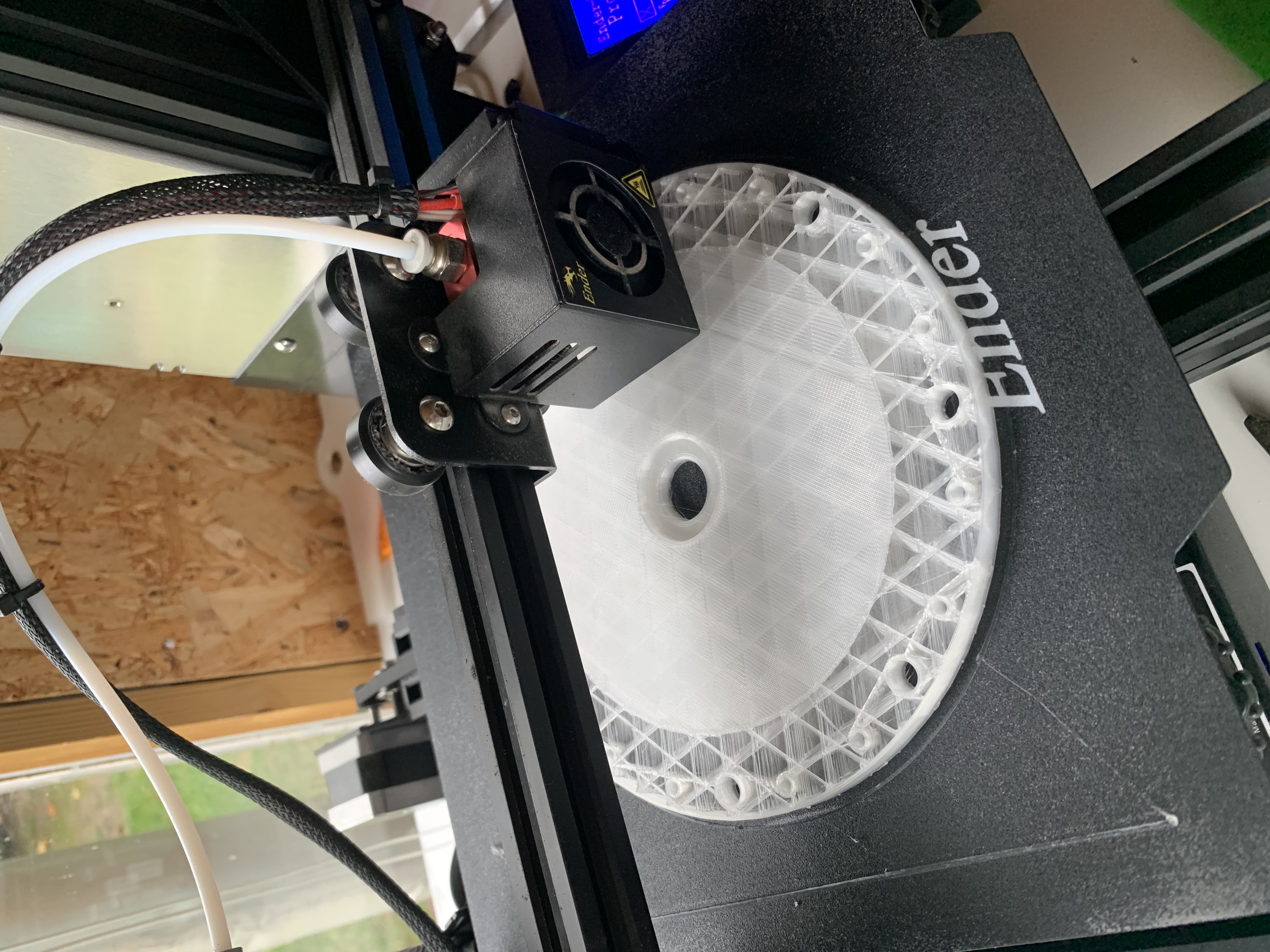

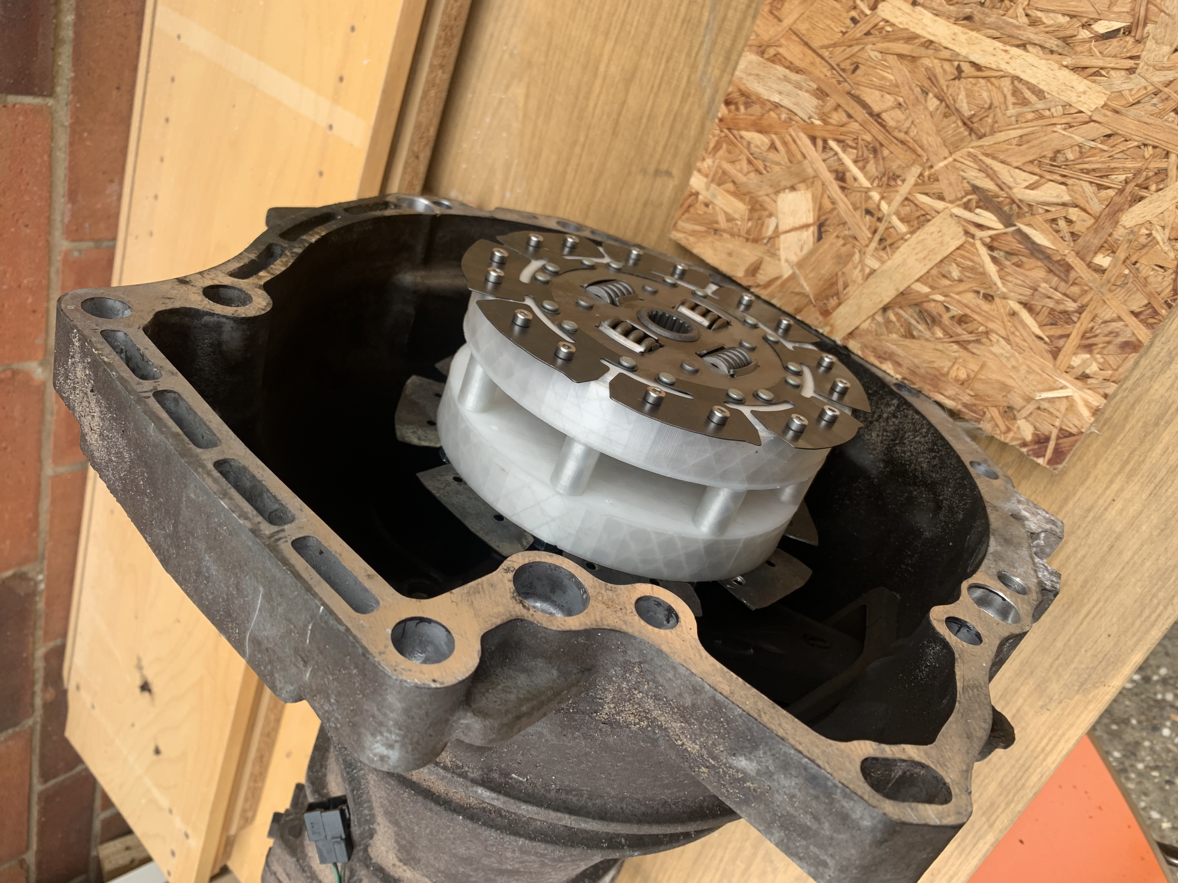

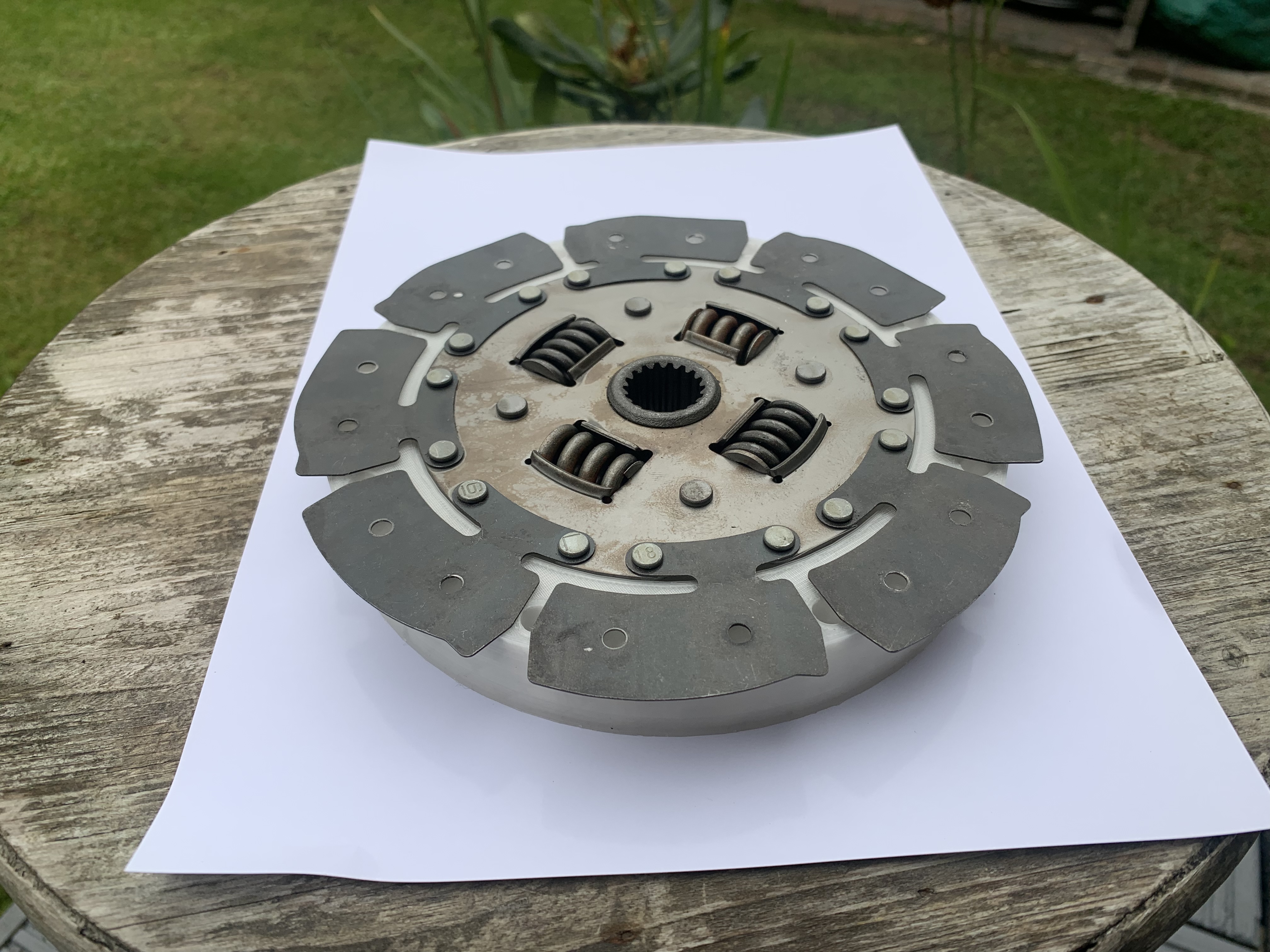

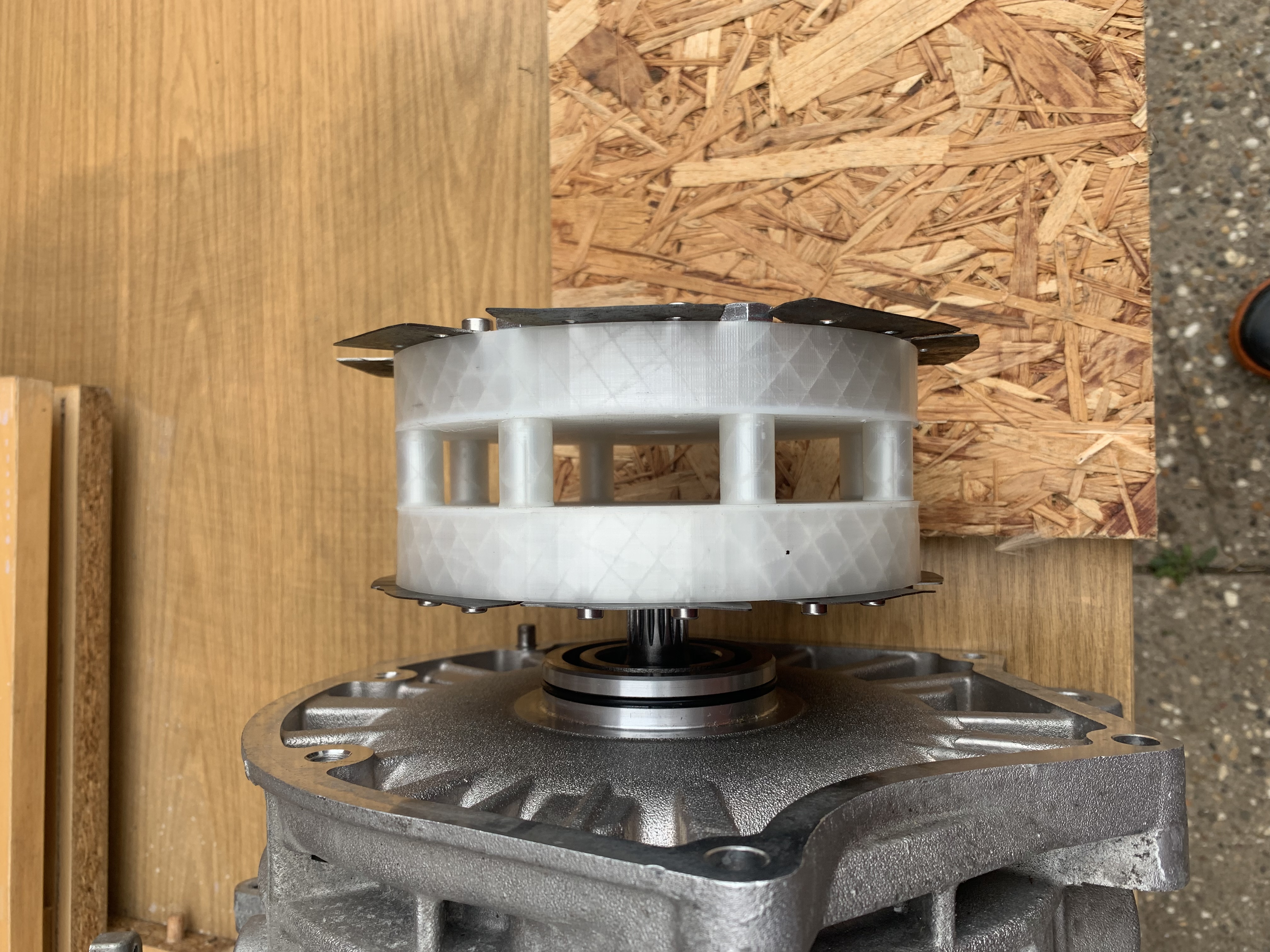

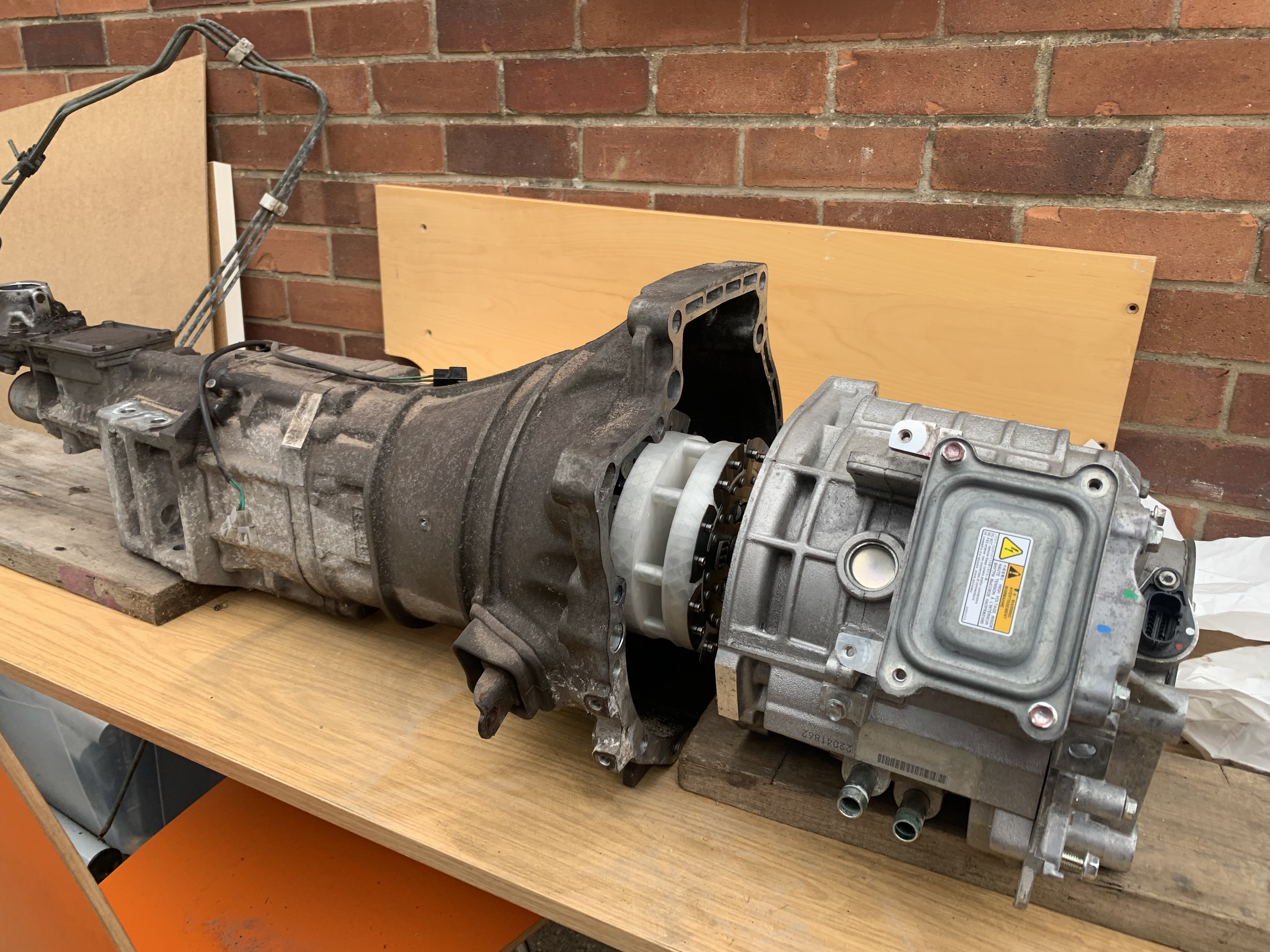

So I’m still working on my mini project but in order to reduce the timescale to actually owning an electric car I’ve started on an mx5 project alongside! Started by using a Jimmy clutch plate and the mx5 clutch plate to make a coupler. Next step is the gearbox to motor adaptor and then create the subframe for the motor and inverter! Physical engineering is what I do best - it’s electrical that challenges me!

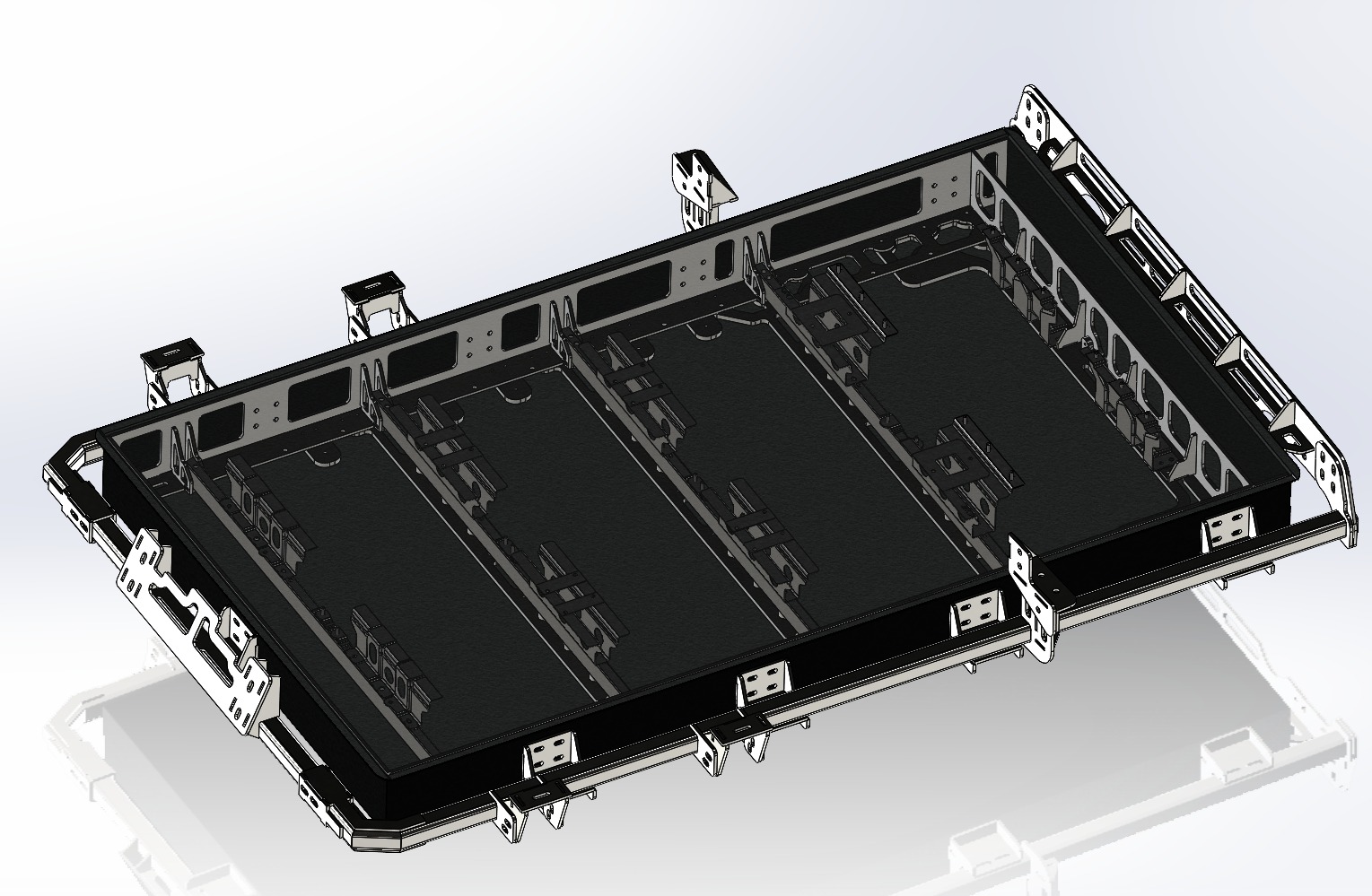

Here’s a little sneak peak of a Chevy bolt custom battery box I’m working on at the same time!
