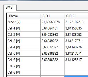

Ok so i have progress and i have good news and bad news. Lets start with the bad news.
The badnews, in my first ever PCB run i made some NOOB mistakes.
Like ground symbols not connected to GND net and some more.
(like i didn't know that you cant remap one pin, always the complete device function is remapped).
Yes i should have know but hey i was in a hurry to have Chips available at JCLPCB...
Now the good news after some pretty long debug sessions i made it work! I have a working taycan battery block slave controller!
Updates will follow as i progress to show something for that i'm working on a GUI app too.
For now the situation is as follows:
V1 board, when modified:
Dual CAN and Remote IO and Single Channel MC33664 string (up to 15 blocks);
or Single CAN and less Remote IO and Dual Channel MC33664 string (up to 30 blocks);
The taycan uses originally 4 strings but that's done because they wanted a faster scan rate of their bricks / needed more then a dual channel anyway.
The main CPU i have used (resoldered) is a STM32F107 one, don't know if the GDones will work.
I will post updates as i progress. LIN is to be tested and the UARTS etc.

It works!

by EV_Builder
tom91 wrote: Mon Nov 15, 2021 8:01 am Very good progress. Did you write the software from scratch or are you running the example from NXP?
I'm running my software on my own board with an STM32F107 CPU and new C# GUI using the CanBus as interface. Next step is validating it on a GD32 device. Hard part is the crucial layer: spi chip --> driver.
If someone feels the need to influence how I should proceed shout your ideas I'm all ears. There is quite some data to transmit per block so we need something smart. I'm thinking a request of the master can change the PDO's of the slave? Or we should implement functions into the chip itself.
