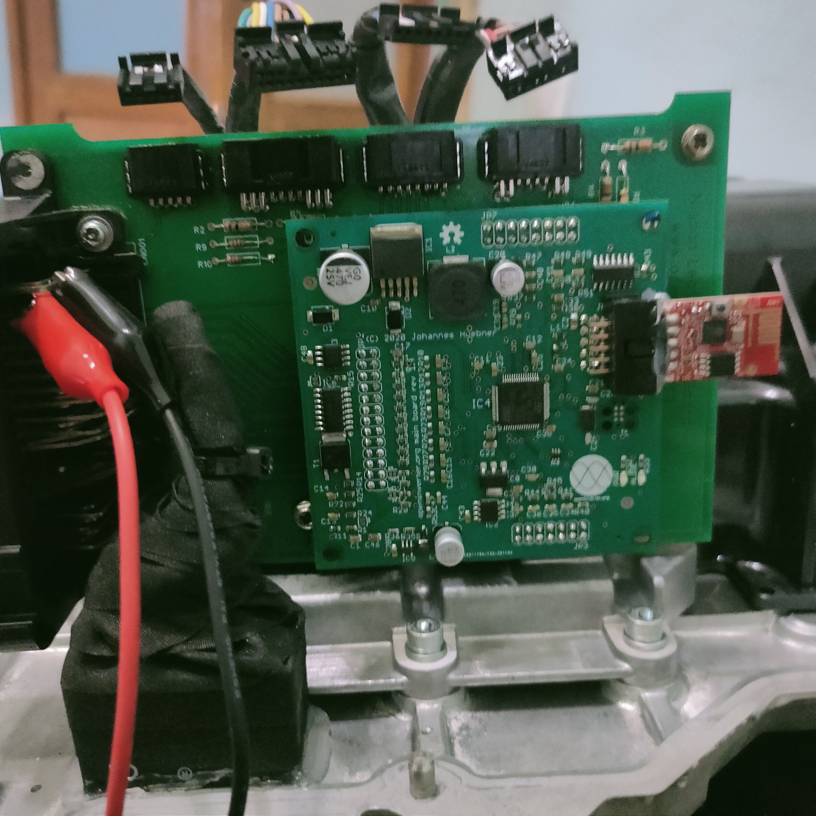

On pin 4 of the JP7 connector, I have + 5v. The high voltage battery is disabled. So there should be no tension there? Which side to look for the problem?
When disconnecting all wires from the inverter to the adapter board, the voltage on pin 4 changes to 3.4v. The error remains.
Posts: 6735
Has thanked: 378 times
Been thanked: 1559 times
Re: Leaf Gen2 and EM57 Bench Test Problem
which version adapter board is it? Can you post a picture?
Renegate2020
Posts: 52
Joined: Tue Dec 01, 2020 6:20 am
Location: Odessa UA
Post by Renegate2020 »
V3+ Nissan Leaf adapter board
Posts: 6735
ok, that's super proven I also run this version myself.
Renegate2020 wrote: Sat May 28, 2022 12:24 pm On pin 4 of the JP7 connector, I have + 5v. The high voltage battery is disabled. So there should be no tension there? Which side to look for the problem?
So R2 pulls the udc PWM signal to 5V via 10k. Then it is divided with a 47k/(10k+10k) divider so it should idle around 3.5V

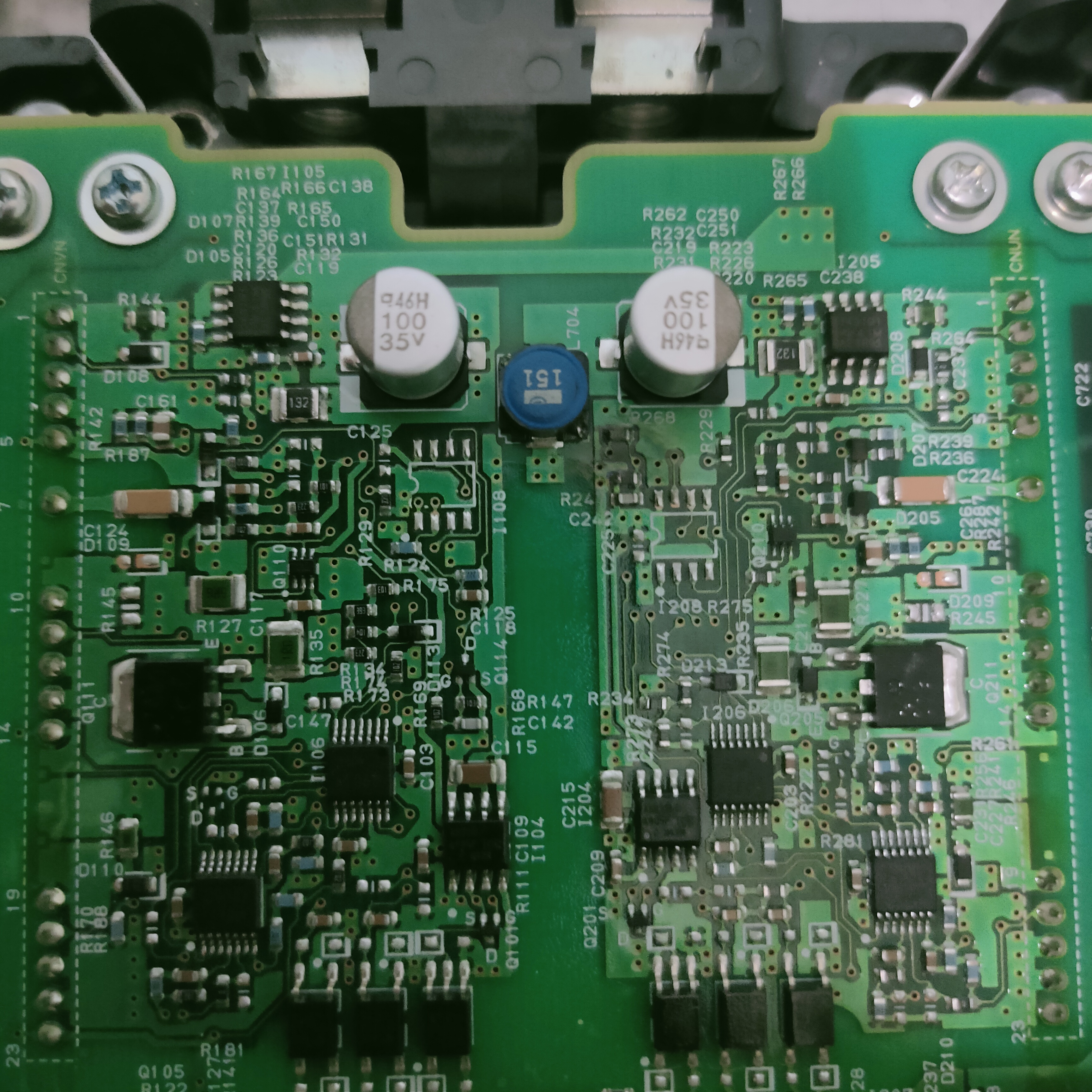

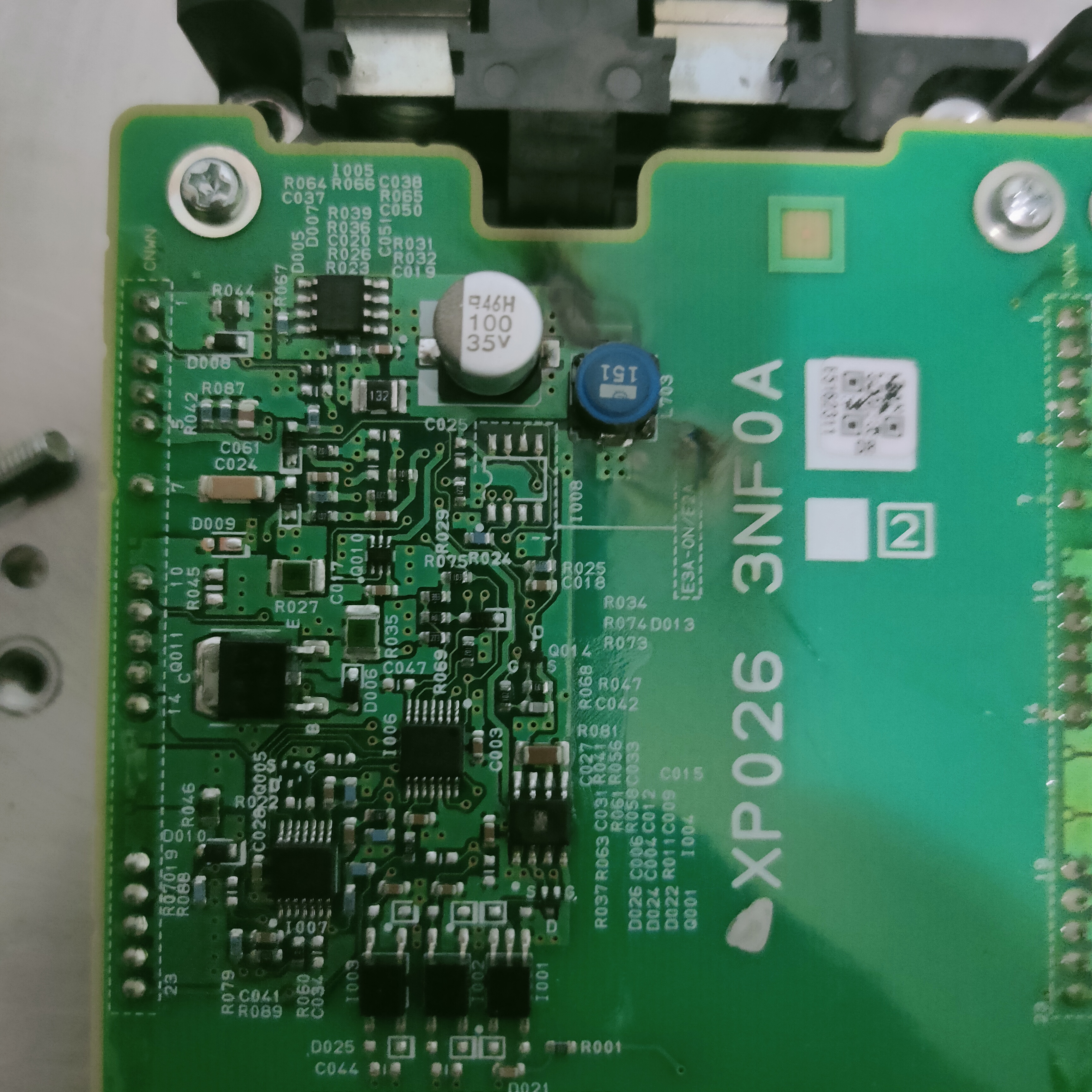

I disassembled the inverter a bit and such a nuisance. Could the reason be in uncontrolled regeneration?
Posts: 6735
I found these inverters to be pretty invincible (and Zapatero too). But that mosfet looks quite unhappy and it seems the inductors let the smoke out...
