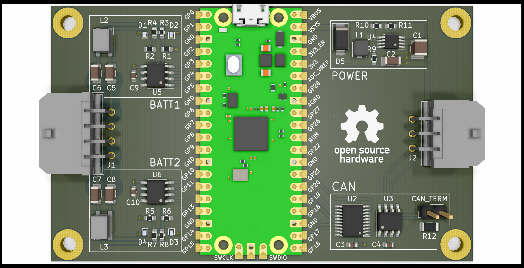

I recently acquired some LG 16S battery modules. Each module contains an integrated BMS slave board with voltage measurement and bleed resistors. At the heart of these is a TI bq76PL455A chip. This chip has a daisychain communication protocol allowing up to 16 modules to be connected in a chain and controlled.
I have developed a BMS for these modules, allowing them to be monitored, balanced, and connected to a CAN bus. It was necessary to develop custom hardware to communicate with them. Full open source hardware, software, and documentation can be found here: https://github.com/catphish/lg-daisychain/
The module supports the following functionality:
* Automatic balancing of all cells in the chain
* Pack and cell voltages transmitted on CAN bus
* Temperatures transmitted via CAN bus
* Balancing target can be set via CAN or standalone
Some photos of the batteries and my BMS module:
I don't know how many of these batteries exist, or whether there are other batteries out there using this same chip, but hopefully this will be useful. I will certainly be using it in my own projects.
I have also built a version of SimpBMS that works with these modules. This is only very lightly tested, and probably requires more work, but could be useful for anyone wishing to integrate these batteries: https://github.com/catphish/LG-BMS

Nice project!) Are you have isolation at CAN BUS?
catphish
Posts: 966
Location: Dorset, UK
Has thanked: 99 times
Been thanked: 197 times
Re: BMS for bq76PL455A based batteries
Post by catphish »
dimonlipko wrote: Sat Dec 11, 2021 12:03 am Nice project!) Are you have isolation at CAN BUS?
My BMS module is powered from the low voltage system, so the CAN bus is not isolated, however the interface to the battery slave boards is isolated (both in my board and in the batteries), as the slave modules are powered by the HV batteries.

I've built a second version of this with two slave BMS connectors. This will allow me to manage my full 18 module pack with a single device. It also matches the form factor of my new charge management unit, which adds the missing connectivity for EVSE etc.

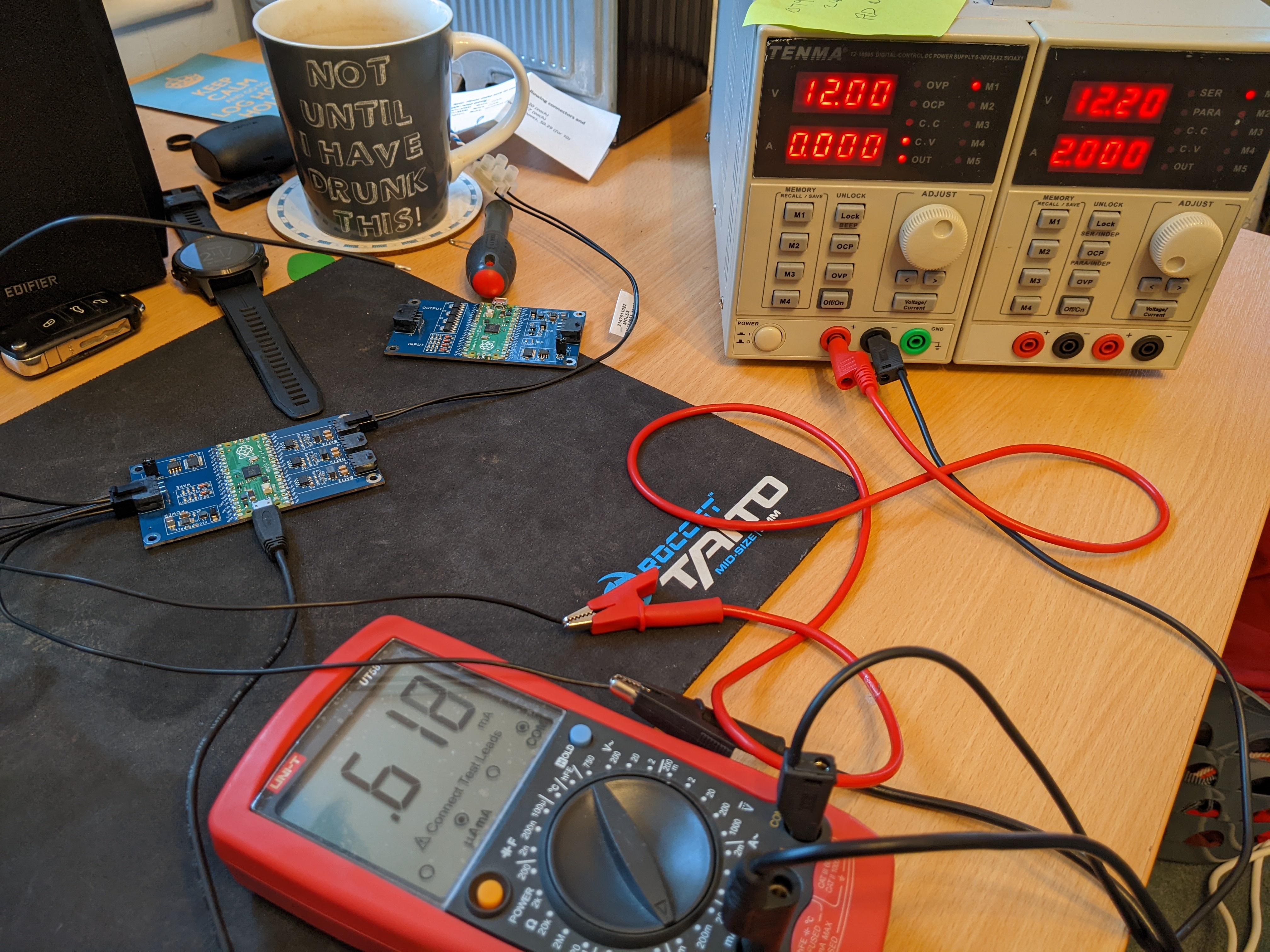

How are the Pi Picos for power management? As having multiple micros running when the car is powered off can start adding up quickly.

tom91 wrote: Sat Dec 25, 2021 10:54 am How are the Pi Picos for power management? As having multiple micros running when the car is powered off can start adding up quickly.
It's not nearly as impressive as the STM32, but it should draw 5mA at 3.3V when it's sleeping waiting for a pin wakeup, 25mA when running, and about 10mA when seeping with a timer. So with the right code, I hope to achieve at worst 20mA (3.3V) for the 2 boards, or 10mA from the 12V battery.
This isn't awesome, but hopefully a lead acid battery can maintain this for a while. I haven't implemented any kind of 12v voltage monitoring, so will have to be mindful of this.
I will do some real testing with my own code and report back when I can. In the meantime, there's a video here with someone else's tests, on which I am basing my assumption. These match up with the datasheet.
To elaborate on my previous post, the current situation is that at 12V my boards consume approx:
* 10-11mA when active
* 6.6mA with the CPU core stopped and CAN active (this is my main idle state)
* 4.8mA fully sleeping
Unfortunately, I forgot to connect the sleep line of the CAN line driver to the MCU. If I did, an estimated 2.5mA reduction could be achieved by putting the transceiver in low power RX-only mode.

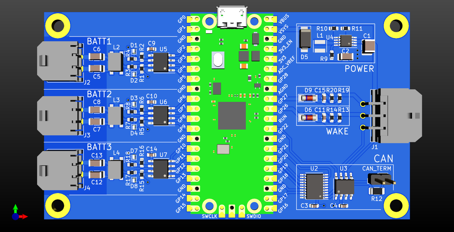

Following testing of the v2 board, I have made the decision to build a v3 board, with the previously mentioned improvements. New design features:
  • 5v - 12v power supply
  • 3 x bq76PL455A daisychan interfaces - separate connectors for better HV isolation
  • 1 x CAN
  • 2 x 5v-12v "wakeup" inputs
  • Readily available Molex micro-connect sockets
In order to improve battery life when idle, the new design aims to add a low power sleep mode, shutting down all CPU clocks, all daisychain interfaces, and the CAN interface. It will then be woken by a voltage on either of the wakeup inputs, which I imagine would come one each from the charger and the ignition switch. This allows battery monitoring to be enabled only when needed, and then for the module to shut down on its own after any necessary balancing is complete.
Schematic at https://raw.githubusercontent.com/catph ... ti-bms.pdf
Once I have the boards, and I've had an opportunity to write the power management code, I will update again, and hopefully have a finished device! I will also provided some updated power usage numbers, as I expect significant improvements with the ability to fully sleep the MCU and CAN interfaces.

The new v3 BMS boards arrived yesterday, and after some testing today, I'm very happy to say, I'm now happy with the results. Communication with CAN and 3 x 16 x bq76PL455A modules is working. Idle mode now consumes approx 600uA! The device can be woken by ether of 2 x 12V inputs (one for when charger is enabled and one for when ignition is live).
All hardware and software sources available at: https://github.com/catphish/ti-daisychain-bms/
Let me know if you have bq76PL455A modules and are interested in using one of these.
