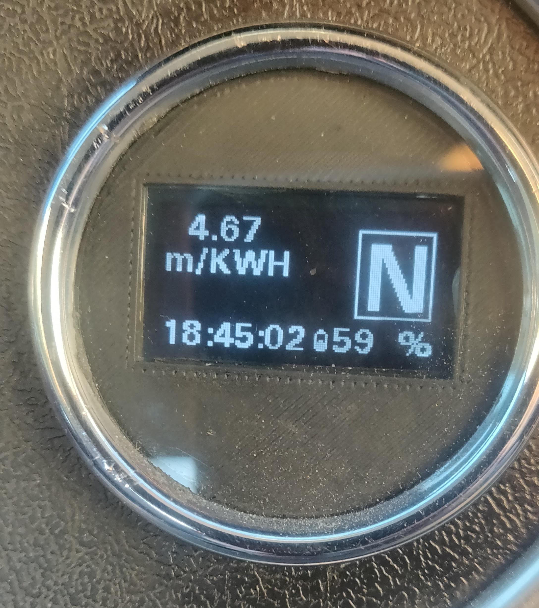

Part 3 is a dash control module:
This receives CAN messages from the VCU and displays useful info on two OLED screens mounted to the old mini instruments.
It also drives a small servo for the speedo and takes care of trip and odometer functions.

The one in the speedo is a .9" 128x32px i2c interface like this one:
https://www.amazon.co.uk/gp/product/B07 ... UTF8&psc=1
The info display (which fits nicely in an old oil pressure gauge) is a 1.3" 128x64px i2c like this:

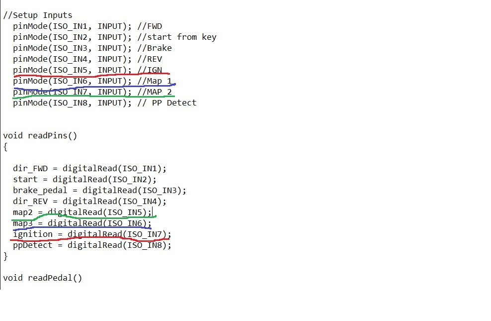

So far I have only discovered this.
I have a non-latching forward-backward toggle switch, I modified the code and found an error in doing so.
#define ISO_IN8 21 // PP Detect - Is this a charging sync?
What speed does MINI with Outlander engine develop?
Enough of the Outlander engine for a comfortable ride?

PP Detect is actually unused in this build, now. - It was there to check if the charge plug from EVSE is connected. This is now done via can.
Speed wise, assuming you mean top speed, I've not actually got it stop accelerating yet, but I'm trying to keep to 10,000RPM which is 82mph on a mini with 12" wheels, and the stock outlander reduction box.

- aot93
- Posts: 213
- Location: UK, West Sussex
- Has thanked: 8 times
- Been thanked: 49 times
No problem to use nextion, It just would not fit in the old mini gauges.
I'm also not a fan of the nextion protocol.
My longer term project is to get this all working on a web interface via an esp32
