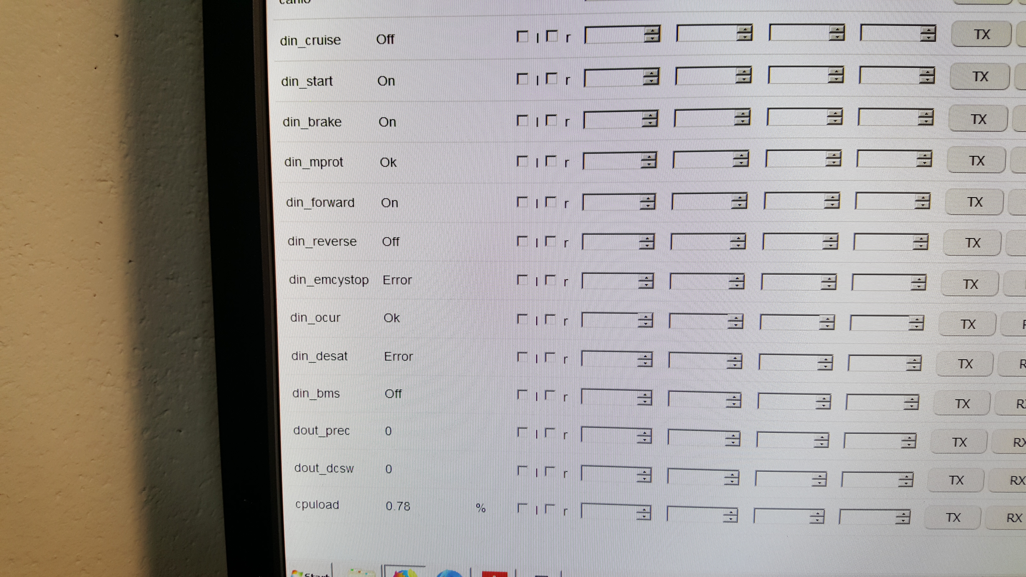

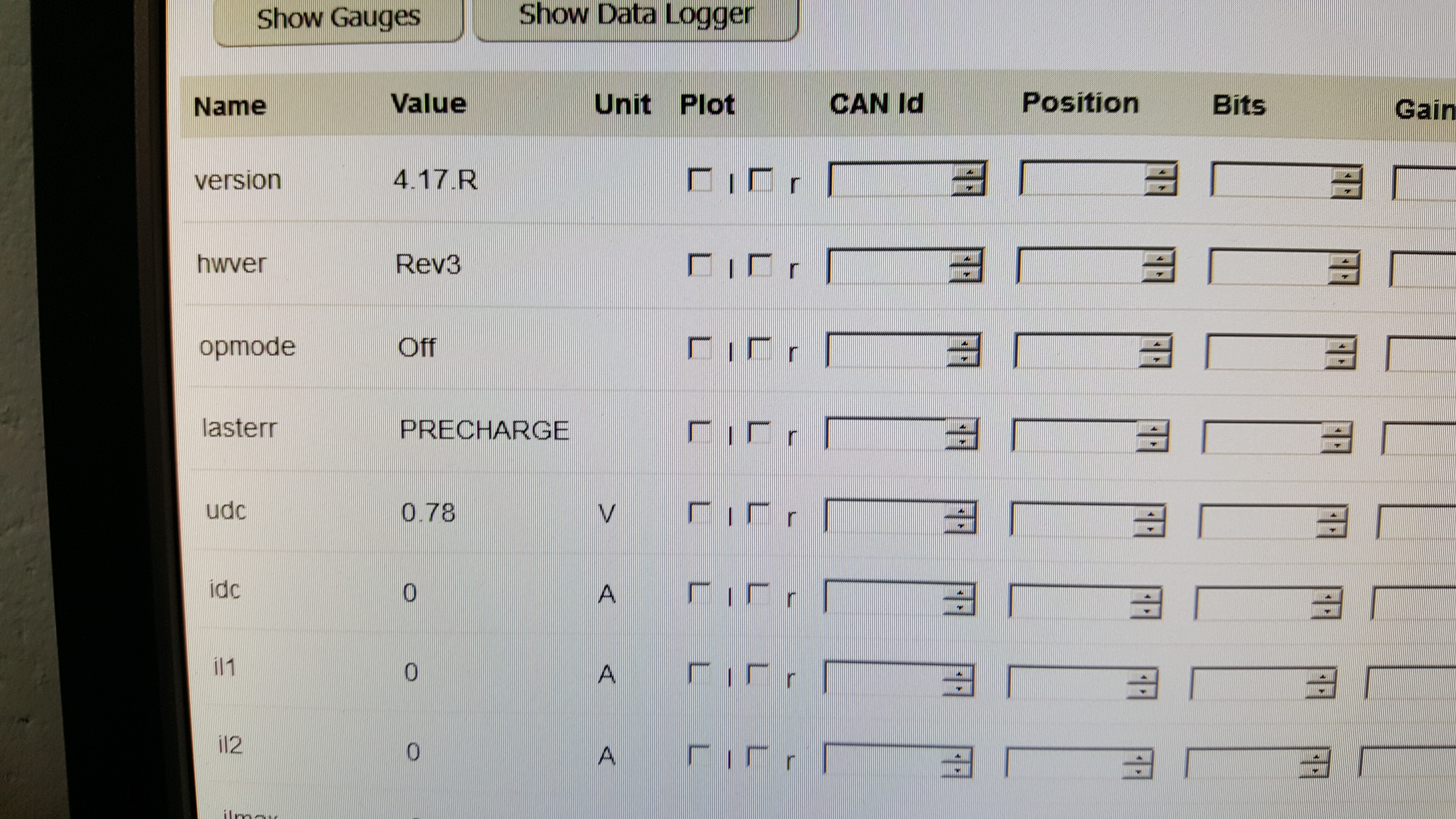

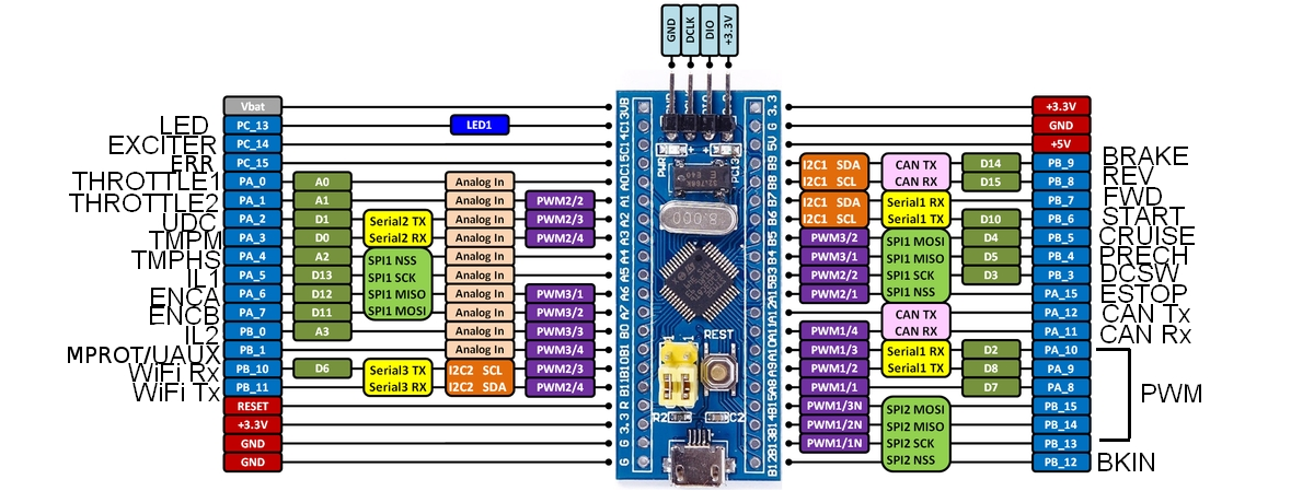

Decided to see if the inverter firmware would run in the so called Blue pill cheap STM32 boards that are available for a few Euros on ebay. Loaded in the bootloader and firmware hex with stlink and to my amazement it works. As the blue pill uses the smaller 44 pin package some pins are missing but I think the important ones are present.

Interesting. If you do most of the communication over CAN then you can afford to lose quite a few of the IOs.

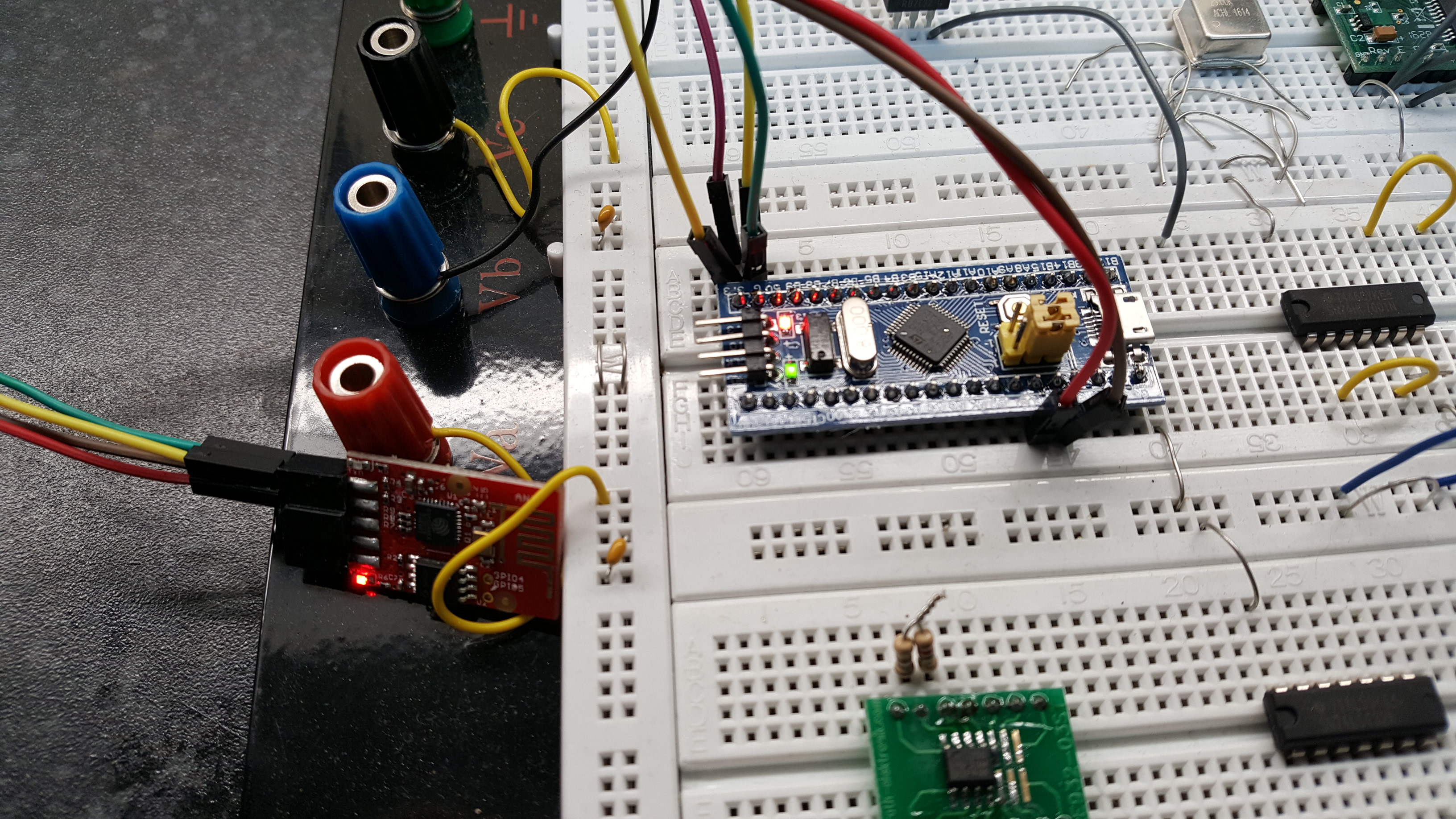

So with some tweaks to the io mapping and deleting some error pins it fits. Tested on a breadboard generating pwm in open and closed loop. Now just need to run a motor:)

Now with resolver exciter generation.

Nice work JB, those blue pill development boards are absurdly cheap. And PC_15 free if needed.

Will adapt the software to detect the Blue Pill. Since TIM3_ETR is missing *maybe* Single Channel encoders won't work. But will look into it later, maybe that pin was never needed in the first place.

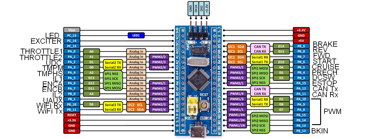

Here's a first try to make a unified software that supports Blue Pill.
I have added mprot again (to have to change less code) and mapped the error output to the yet free PC15
The code is also on github in the bluepill-test branch

Just more thoughts on the mprot pin. It makes sense to tie it to your supply voltage (aka 12V) via the 4k7/1k2 divider to be able to read the uaux value. So it's not really in the way.
The emcystop pin doesn't do anything useful, it is just used to determine whether a shutdown (bkin) was caused by emcystop or something else. So it would make sense to delete it and map something else like brk_out (brake light output) or vtg_out (over/under voltage output)
I also read about the STM32C8T6 to often have 128k of flash instead of 64k. This is somewhat important because the parameters and CAN mapping is stored in the last two flash pages. So if you can't store and reload you're parameters that would be why.
Spacewise bootloader+firmware+parameters would also fit inside 64k so I could do this in the blue pill to be safe.

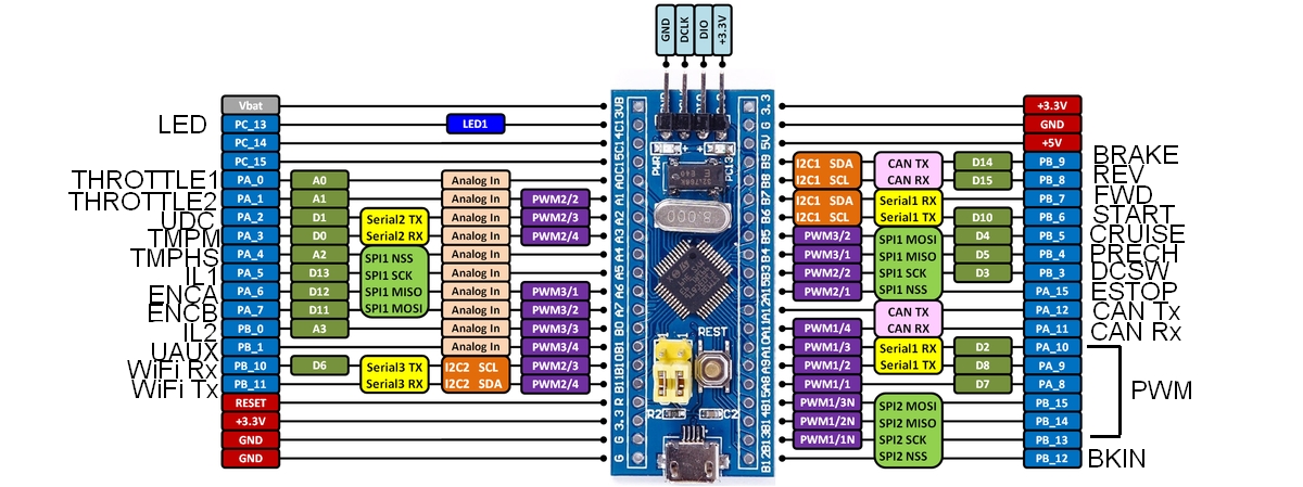

Good evening, is it possible to remove a few more functions from the blue board such as estop, mprot, tmpm a tmpm b ?

Those functions are prevention measures. I dont think it would be good to suppress them.
Hm.... Johannes maybe you could rewrite code for digital temperature sensor like this one.
https://www.maximintegrated.com/en/prod ... 18B20.html
A lot of sensor could be on a single pin.
That would clear at least one pin and then you could merge functions of Mprot and EMGCY stop pins?

Yes giving the pins a think-over is certainly indicated. I'd also like to restore the over current reference that is usually produced by Timer 4. The C8 doesn't have TIM4 or maybe its pins are just not present. In that case I could use TIM4 for the task scheduling and TIM2 for the over current reference.
