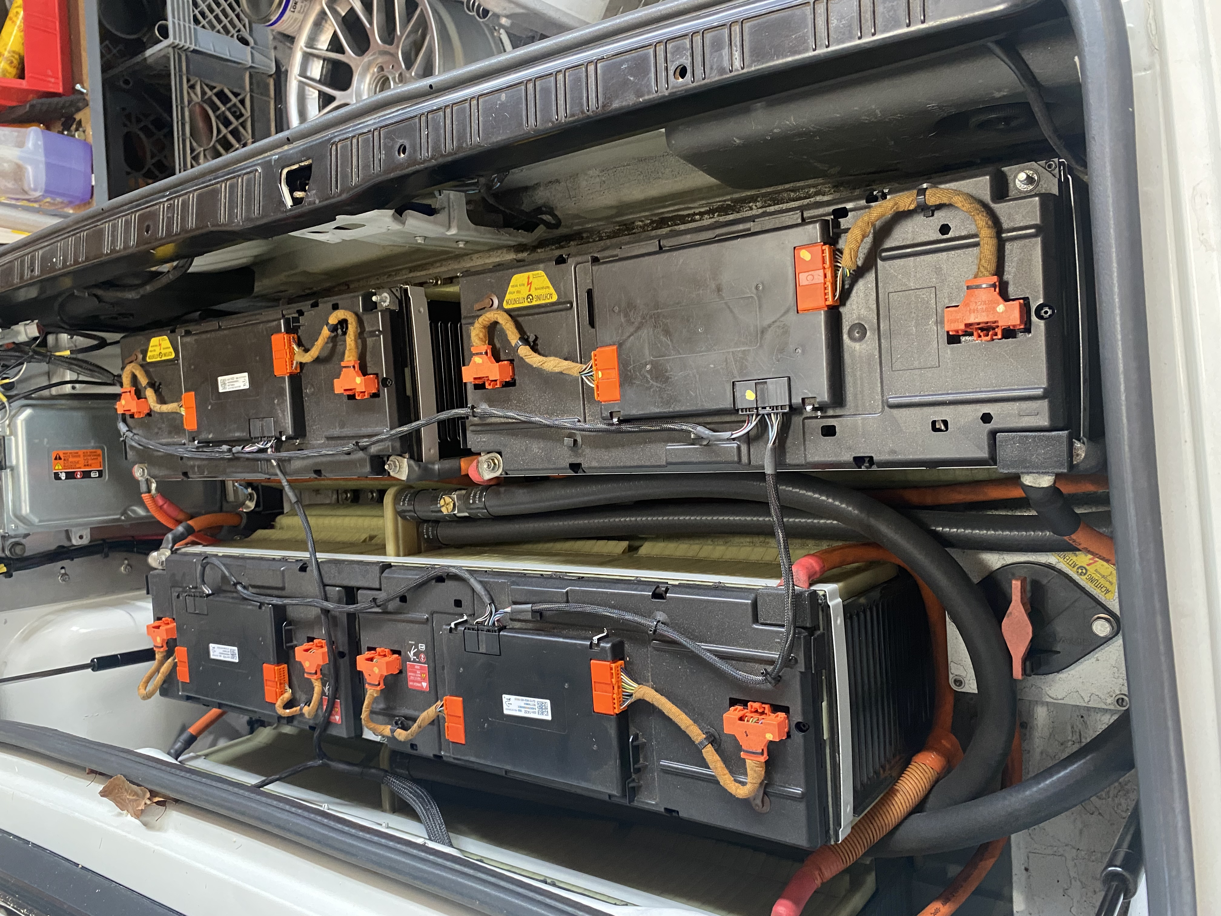

For the last 3 years Ive been running 2 full Chevy Volt packs with each module in parallel. In that time I've only taken the pack below 50% charge a handful of times. Since I have the car apart to redo the cooling system, I've been on the fence about pulling some of the modules out to drop some weight off the car and get some usable trunk space back. Im not sure whether the reduction in weight and will be negated by reduced current capability from a performance standpoint. Curious to hear others thoughts.
The options Im looking at are..
1: Just leave well enough alone.
2: Leave the 2 med sized modules up front, and keep one large one in the trunk to bring max charge to 420v.
3:Pull out one full pack and leave the other as standard 400v.
The primary upside is that I’d get this trunk space back.
