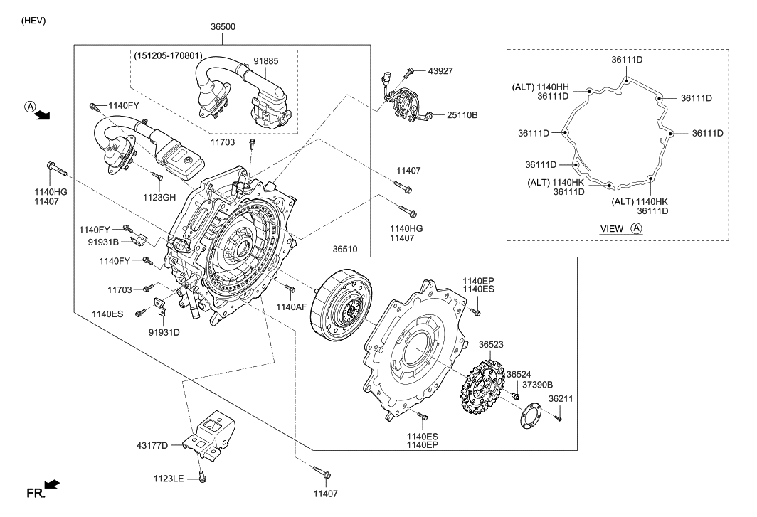

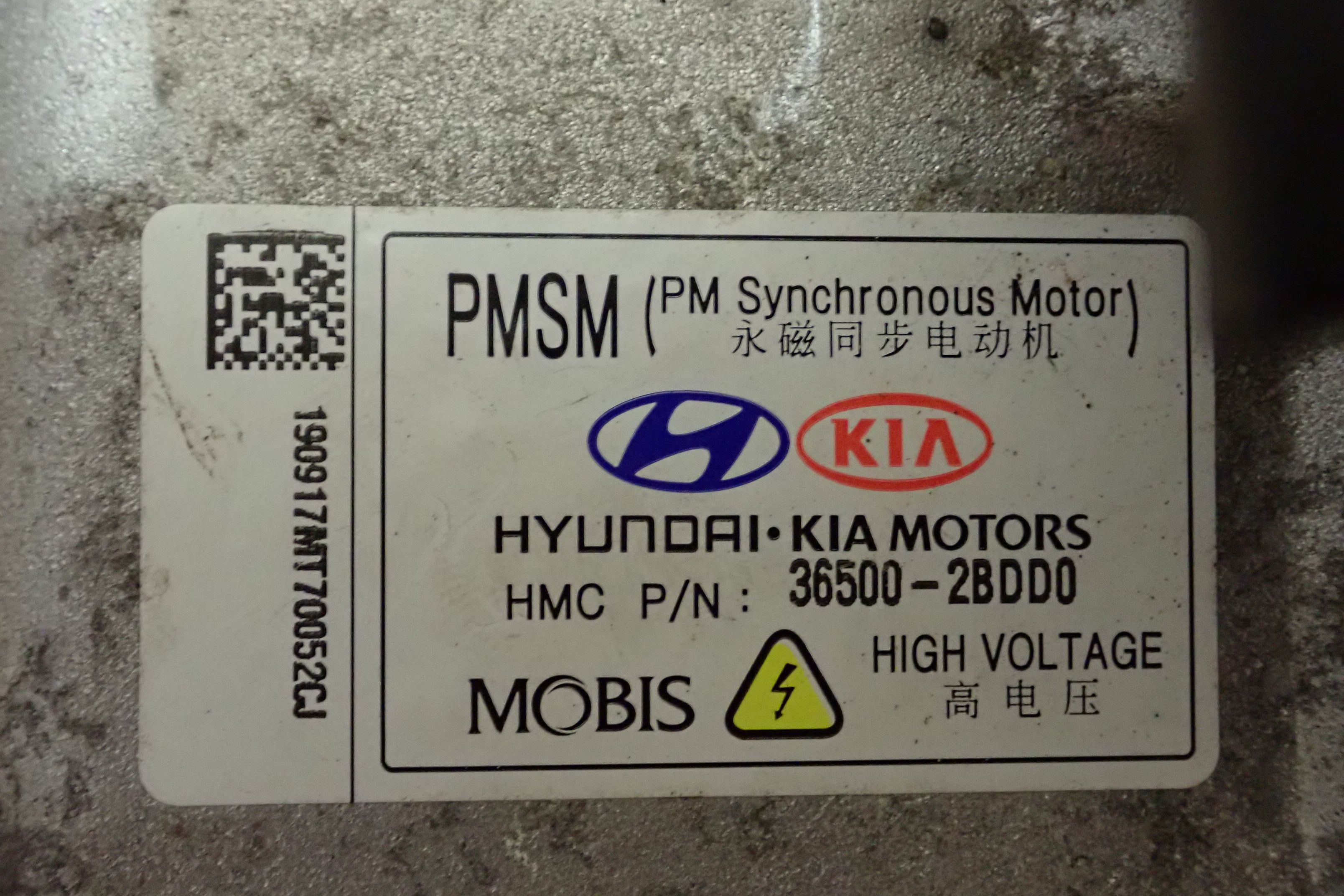

Not sure where I'm going with this but I've bought a Hyundai Oiniq 1.6 Hybrid motor with no real project in mind other than maybe replacing the Honda IMA motor I have in the unfinished project pileup.
The only specs I can find at the moment are,
P/N 36500-2BDD0
Max 32 kW, 43 hp
Max 170 Nm, 125 lb.ft
240V battery
With max power at 5700rpm and max torque at 4000rpm of the combined IC and electric power. Which I guess is skewed by the IC torque and power delivery but gives an indication of usable max RPMs.

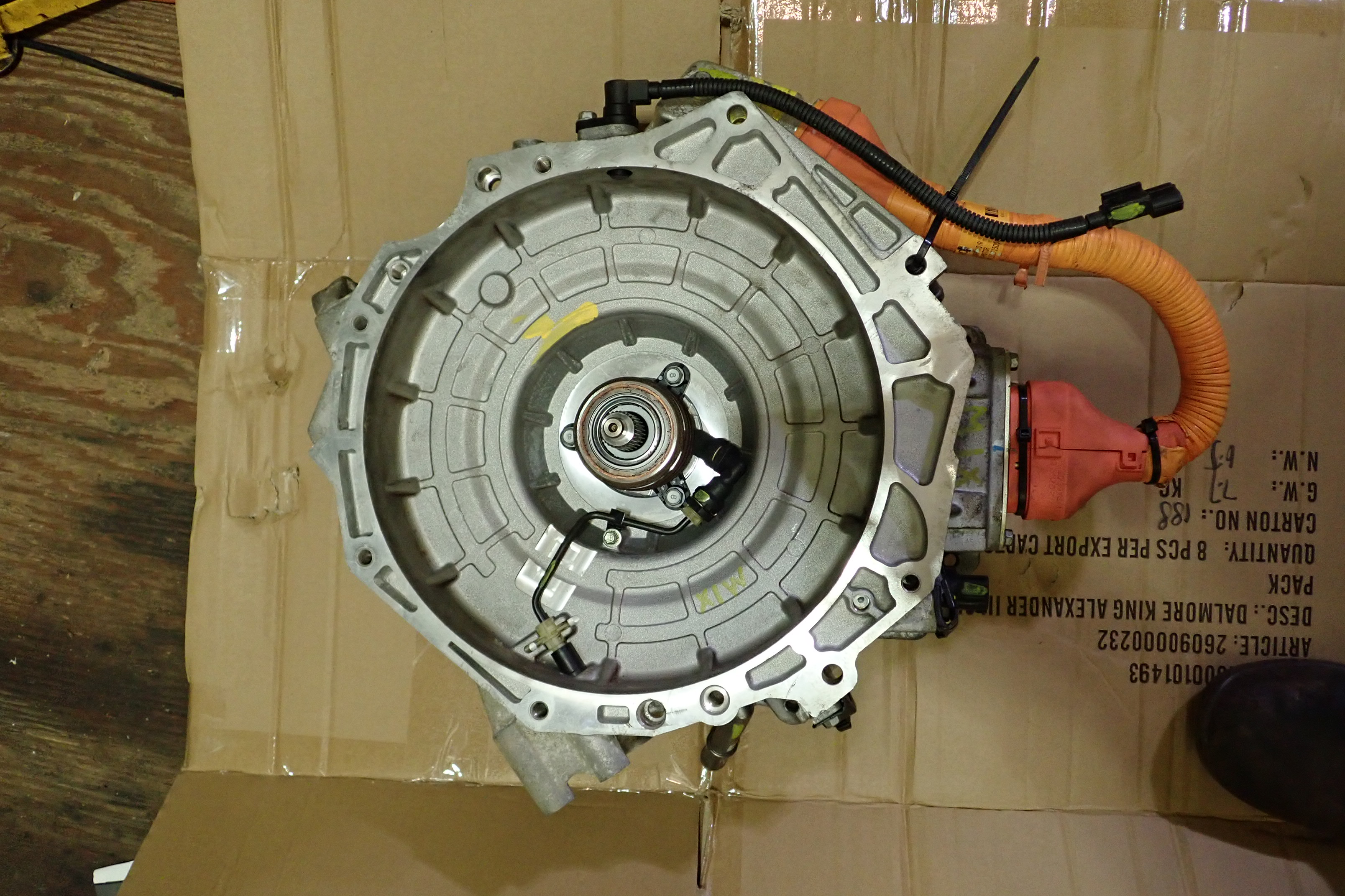

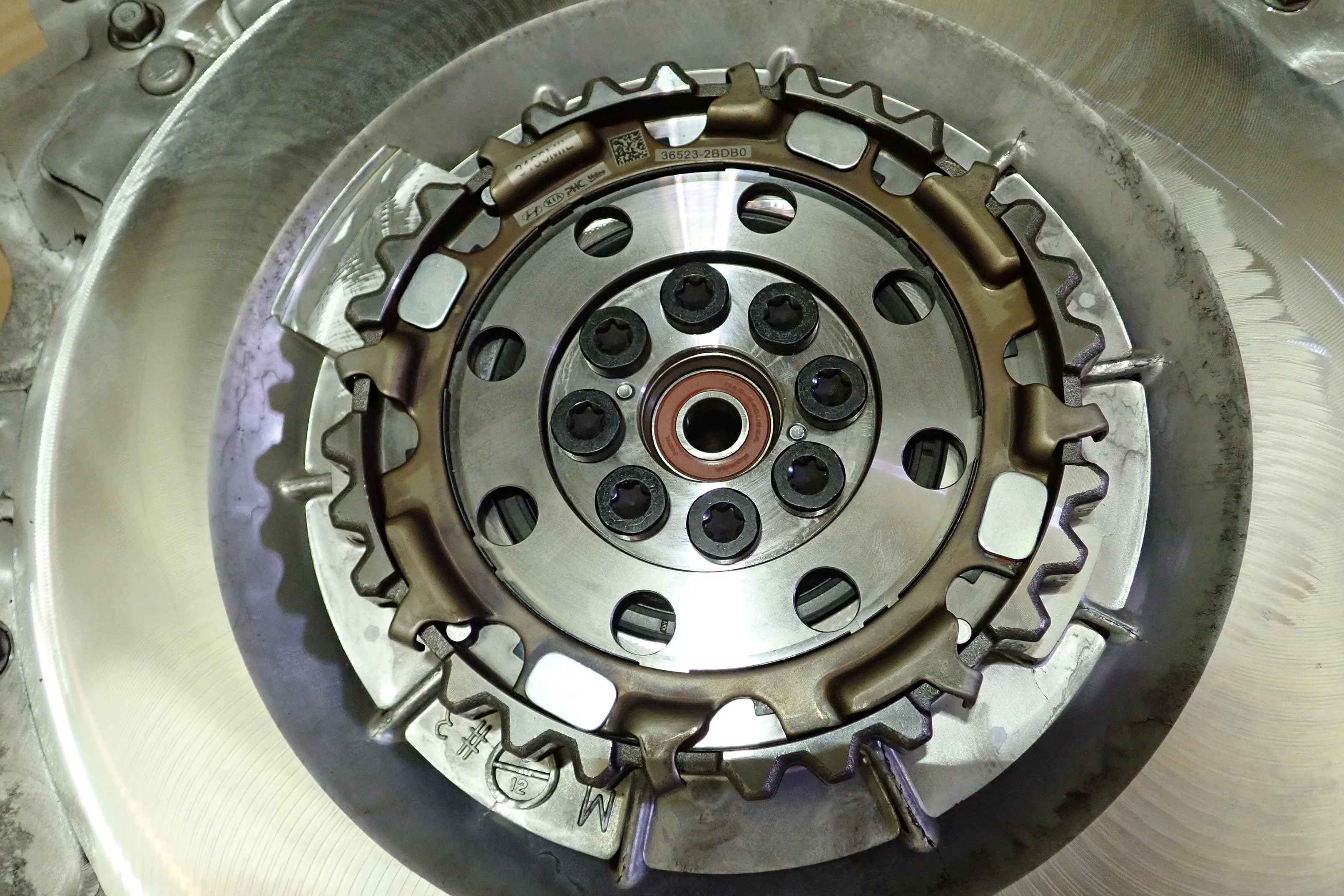

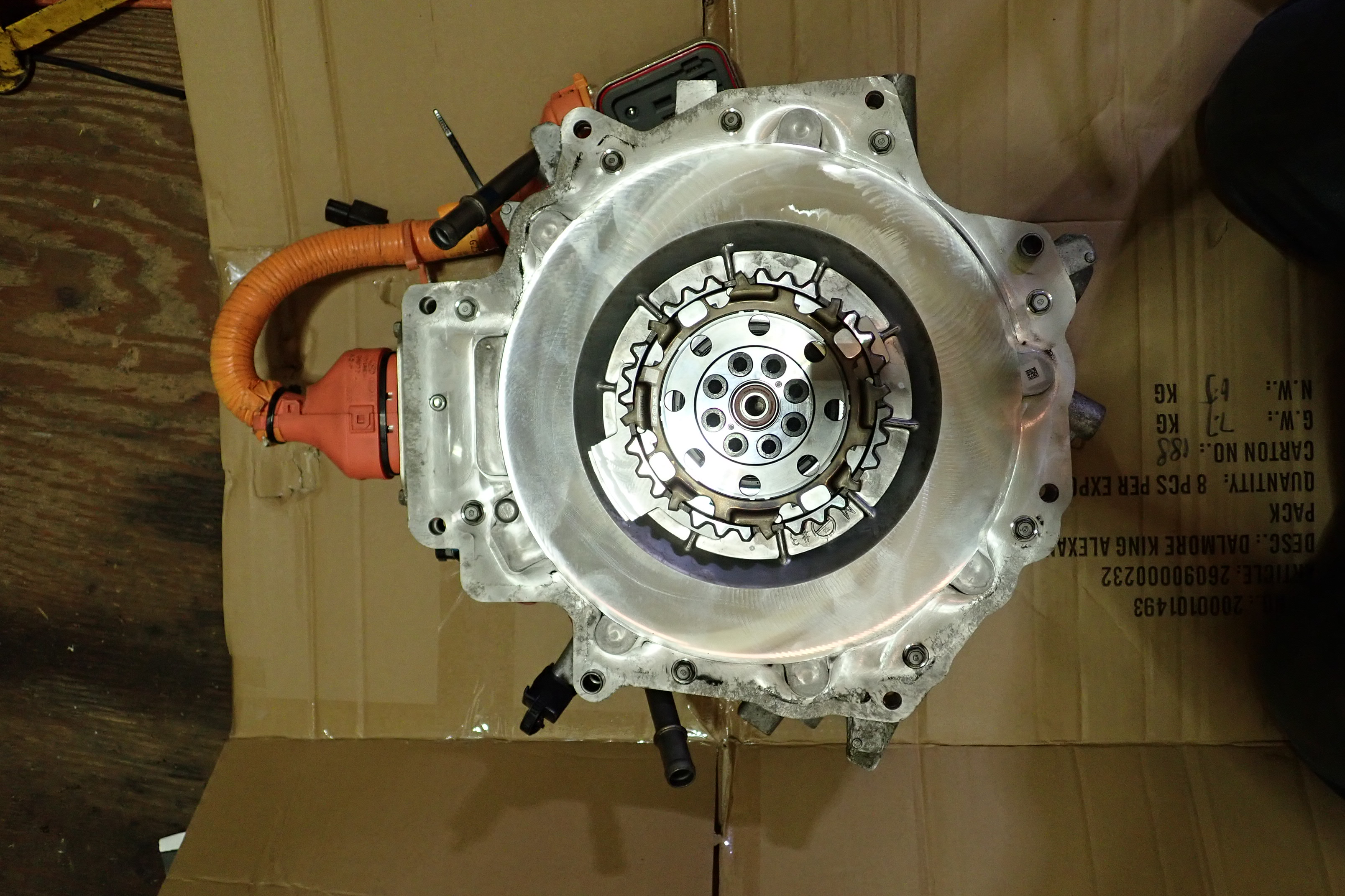

The only other things I know about at the moment are that it's water cooled and appears to have a single roller ball race in the middle which will need a secondary bearing of some sort fitted especially if driving a belt, gear or chain drive with a large side thrust.
Diagram from https://www.hyundaipartsdeal.com/genuin ... 2bdd0.html
