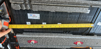

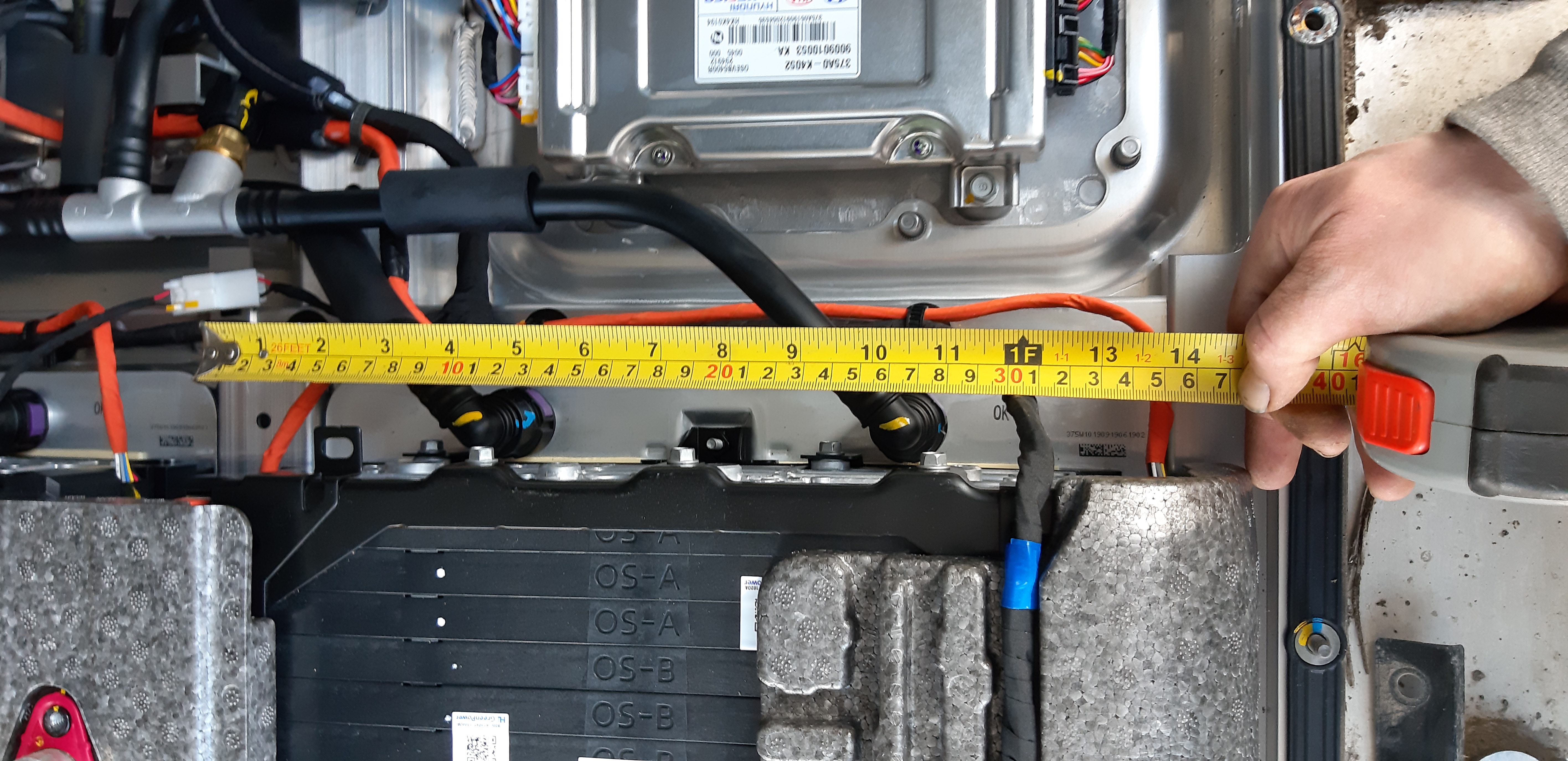

Your in luck I'm hoping to use one and just opened the pack

Awesome, so the measurements you gave me here are the ones of an array of cells? How many cells are in there? Whats the voltage of that array? Send like there is a block metal frame around it?
Kutato72
Posts: 29
Joined: Sat Mar 12, 2022 8:03 pm
Location: Hungary, Tata
Been thanked: 26 times
Re: 64kwh Kona battery
Post by Kutato72 »
The length of the 10S3P and 15S2P modules is 480 mm (+15 mm mounting lugs), while the length of the 9S3P modules is 430 mm (+15 mm here as well). The modules are 105 mm high (+10 mm extra) and 360 mm wide.

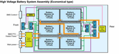

There is a 39 kWh "Economy" version from Hyundai Kona Electric, which contains 180 cells in a 90S2P configuration, ie there are two of the above cells in parallel - its nominal voltage is 330V, its operating range is 225 ÷ 387V, while the "Standard" version is already Contains 294 cells in a 98S3P configuration, i.e., the cells are connected in parallel with a triple; its nominal voltage is 360V, its operating range is 245 ÷ 421.4V.

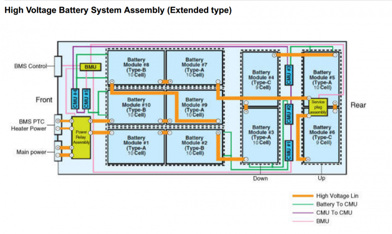

So there are the different modules in the pack?
10S3P
15S2P
9S3P
How is that possible, i thought they all would be the same? How do they make sure energy draw is the same for every cell if the arrays are different?
Many thanks for your knowledge

Based on the photos, you'll understand.

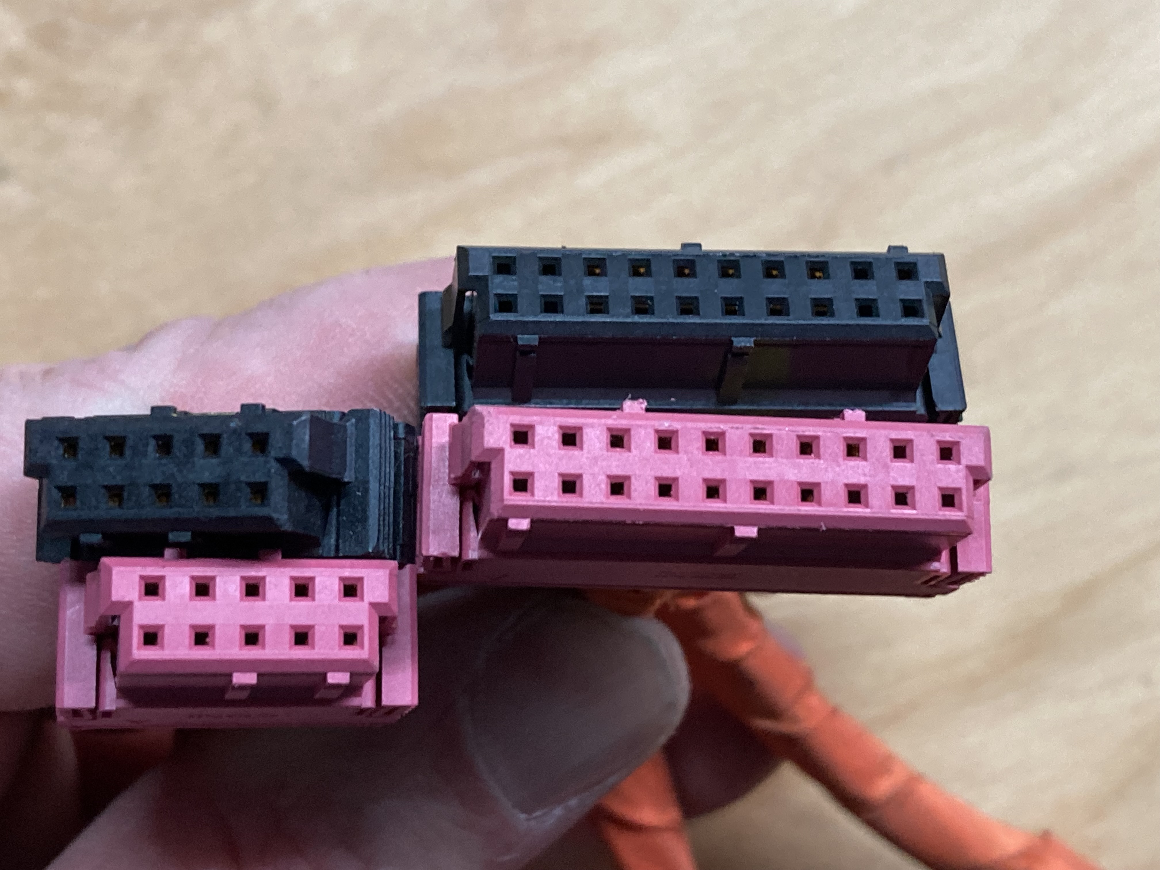

Do you also have a picture of the cell connectors?
Is cell monitoring a master/slave design or do all 98 positive connectors go to three BMS directly?

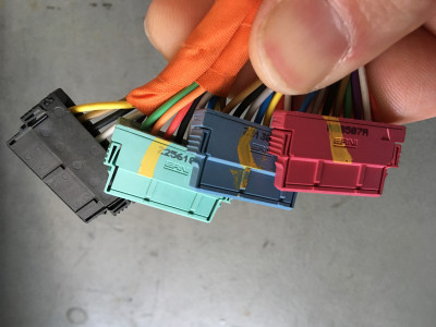

Kutato72
Posts: 29
Post by Kutato72 »
The three types of battery modules have a total of eight (!) different connectors. Their illogical connection is a nightmare. The MAX17845 chip built into CMUs is top secret, with no datasheet, not a programming manual. And it uses an isoSPI bus anyway, not a CAN bus.
