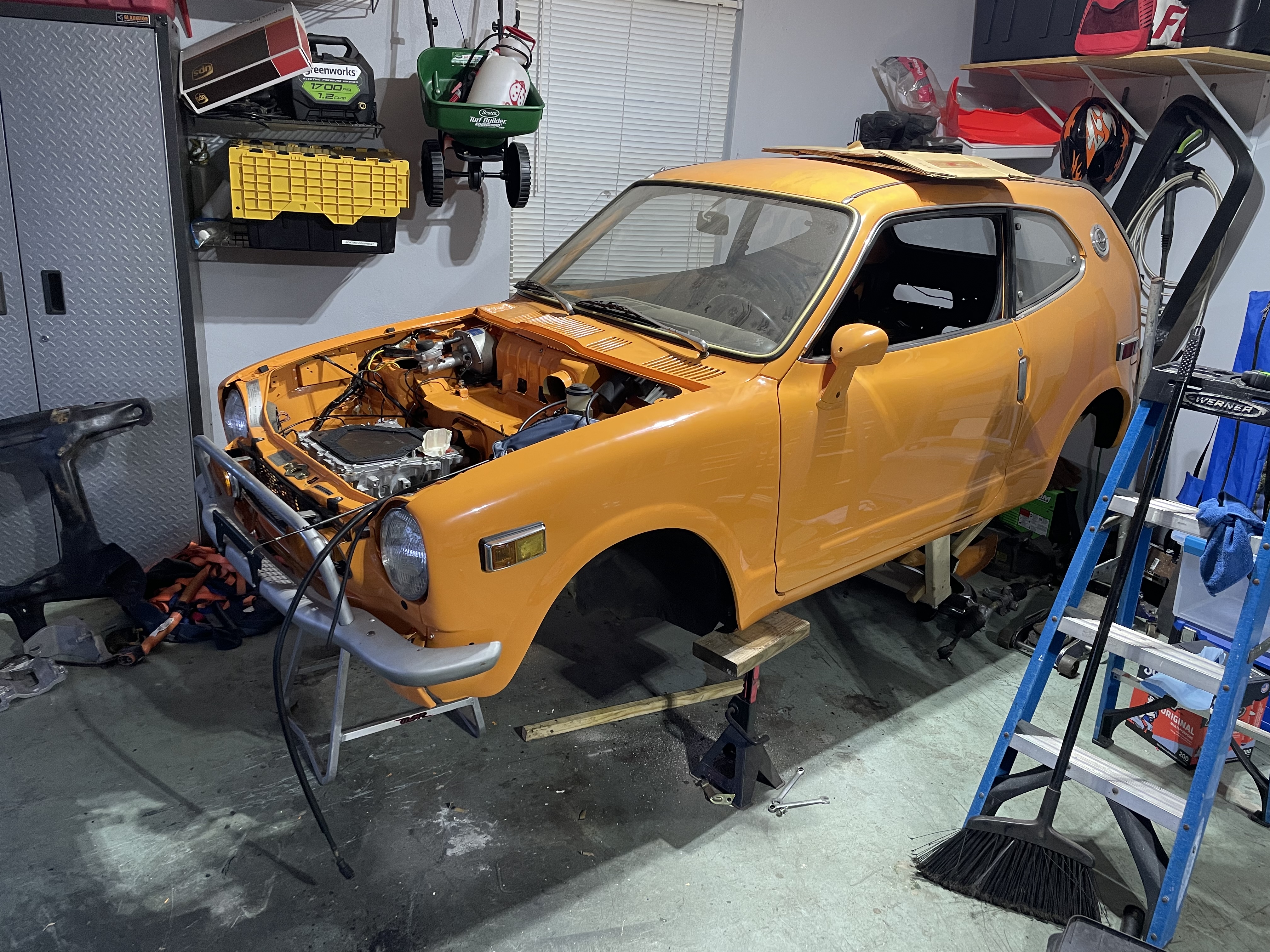

Hello all,

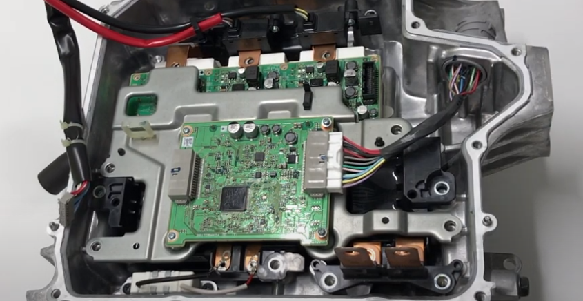

I wanted to start a thread to document my conversion on my 1972 Honda Z600. I'll post pictures later. I purchased a complete 2019 Nissan Leaf motor assembly from top to bottom with all harnesses. What I realized too late was that the inverter for the 2019 model is not the same as the previous Gen 2s, so the adapter board from the Leaf Gen 2 kit does not work. I have the means to have a new adapter board made (I will offer to others) and I was wondering if anyone has access to the pinouts to the connector on the left? I'm hoping that the connections are the same and just a different layout.

Actually a design exists for the Gen3 inverter but it is in some awkward format and I'm not even sure it was published here. Maybe Kelju chimes in.

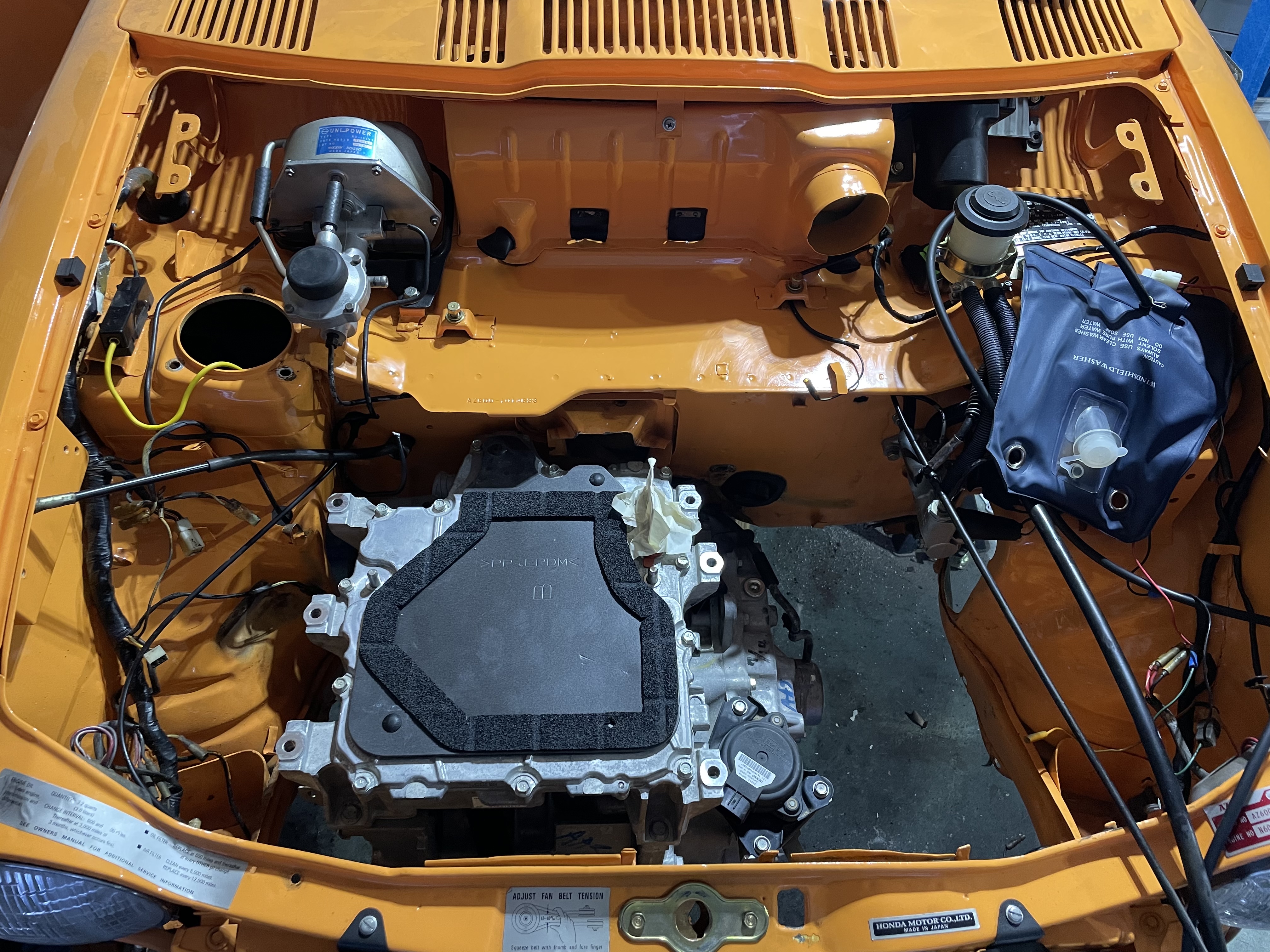

I was think about just rewiring the internal harness to connect to the Gen 2 adapter board and just hardwire the external connector pigtail to the Gen 2 adapter board.
Unfortunately the Gen 3 DC/DC converter and charger are too tall for my application so I’ll have to come up with an alternative. I would like to repurpose the lower unit to get a clean connection with the inverter.

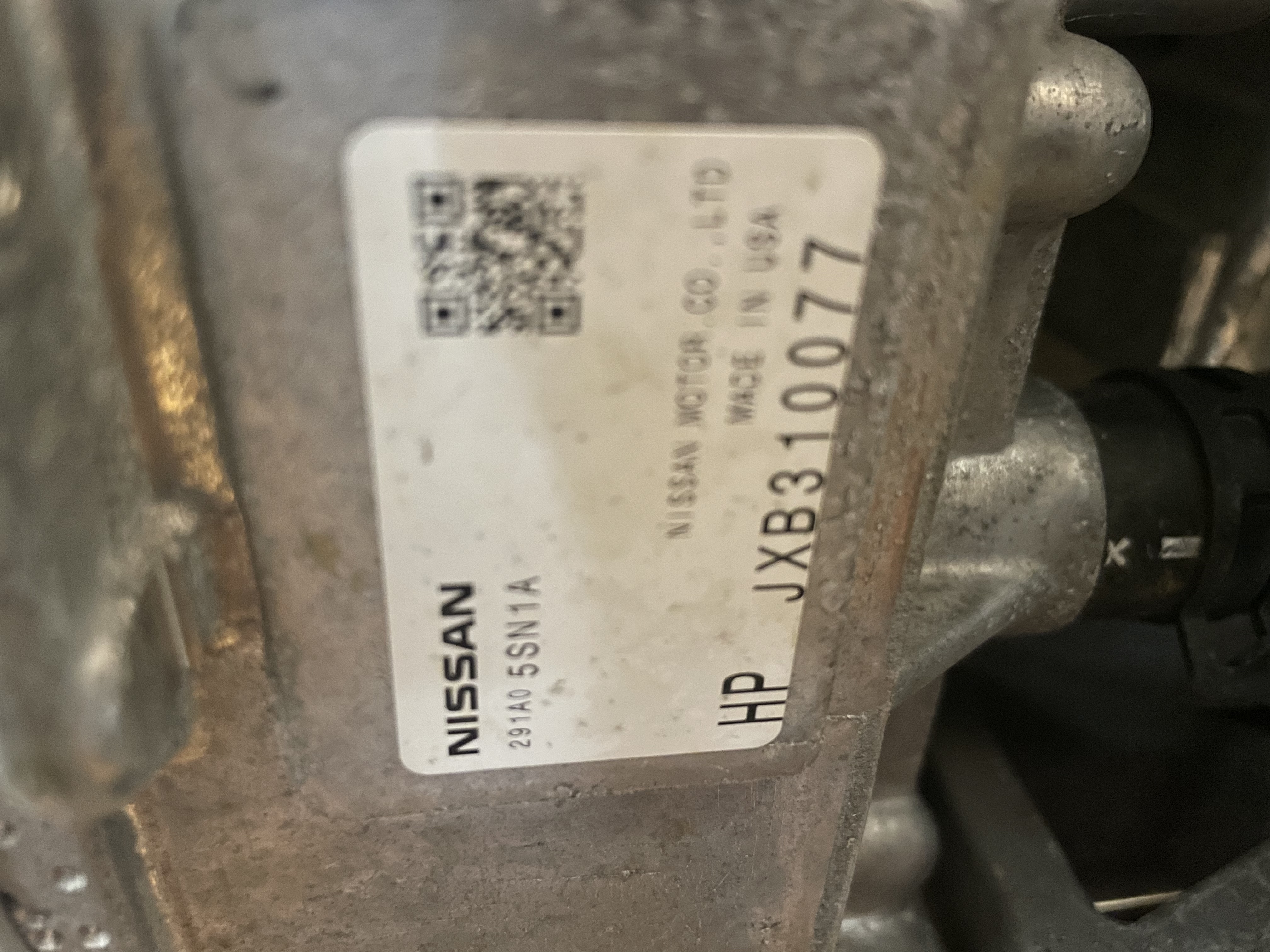

Can anyone confirm if this mine is a 160KW inverter? I believe it is from Dala’s video on his upgrade. I believe the “N” signifies it’s a 160KW.

Hey, very cool to hear you're doing one too! I'm going to try and use the stock hub but I may machine new ones to accept a stronger axle end, we'll see. I was going to try and modify the stock subframe to work but I ended up scraping that Idea and slociviccoupe on this forums is helping me build a tubular subframe from scratch. I'm hoping to have the subframe done by the end of the month and then I have to deal with the steering rack. I have to raise and rotate it to clear the leaf gearbox. I'm going to have to machine off the mounting tabs and use a tube clamp setup to make it work. As for suspension, they make a coilover kit that I plan to use with custom springs. The rear may get a custom IRS setup.
