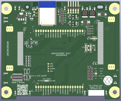

I would like to have an adapter board for Gen3 inverters based on mini mainboard: https://openinverter.org/wiki/Mini_Mainboard
Currently I can't find the time to work on it myself, so was wondering if someone likes to give it a shot? Ideally this would be done in KiCAD.
I have written to Kelju whether I can publish his prior work, if so, I will post it here.

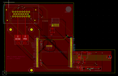

Re: Make Nissan Leaf Gen3 adapter board
Attached is schematic from adapter board. There are some mistakes on it, will comment on the corrections later
Leaf_Gen3_Adapter_A11.pdf
- (25.27 KiB) Downloaded 1207 times
20201112 NISSAN LEAF 2018 INVERTER CONTROL PINOUT.pdf
- (86.49 KiB) Downloaded 1101 times
Cool

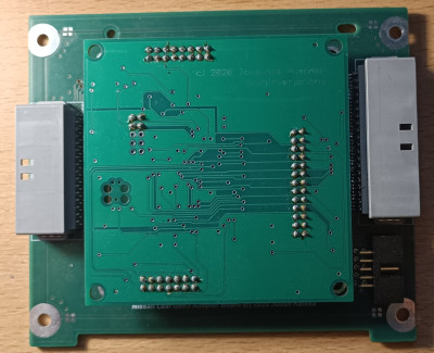

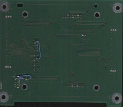

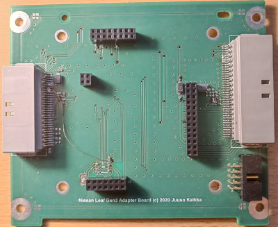

The i3 board uses the mini mainboard. It's just two 20-pin 0.1 in headers
Scanned the board in 300 dpi
Also attached two pictures.
The new design should be based on the mini mainboard as it is smaller, cheaper and lower profile. Also it should use the ESP32 directly soldered to the board.

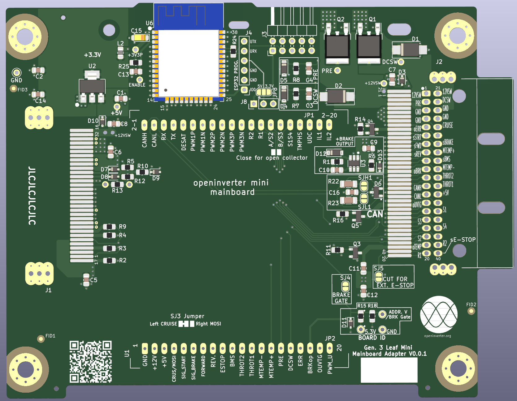

Now the changes that were made:
- Correction of wifi module pins
- mprot pulled up to 12V
- removed the line driver, the STM32 can directly drive the PWM channels in open collector mode
- connected 5V to the inverter connector pin 7, 8, 9
- BMW-i3-adapter-kicad.zip
- (794.9 KiB) Downloaded 836 times

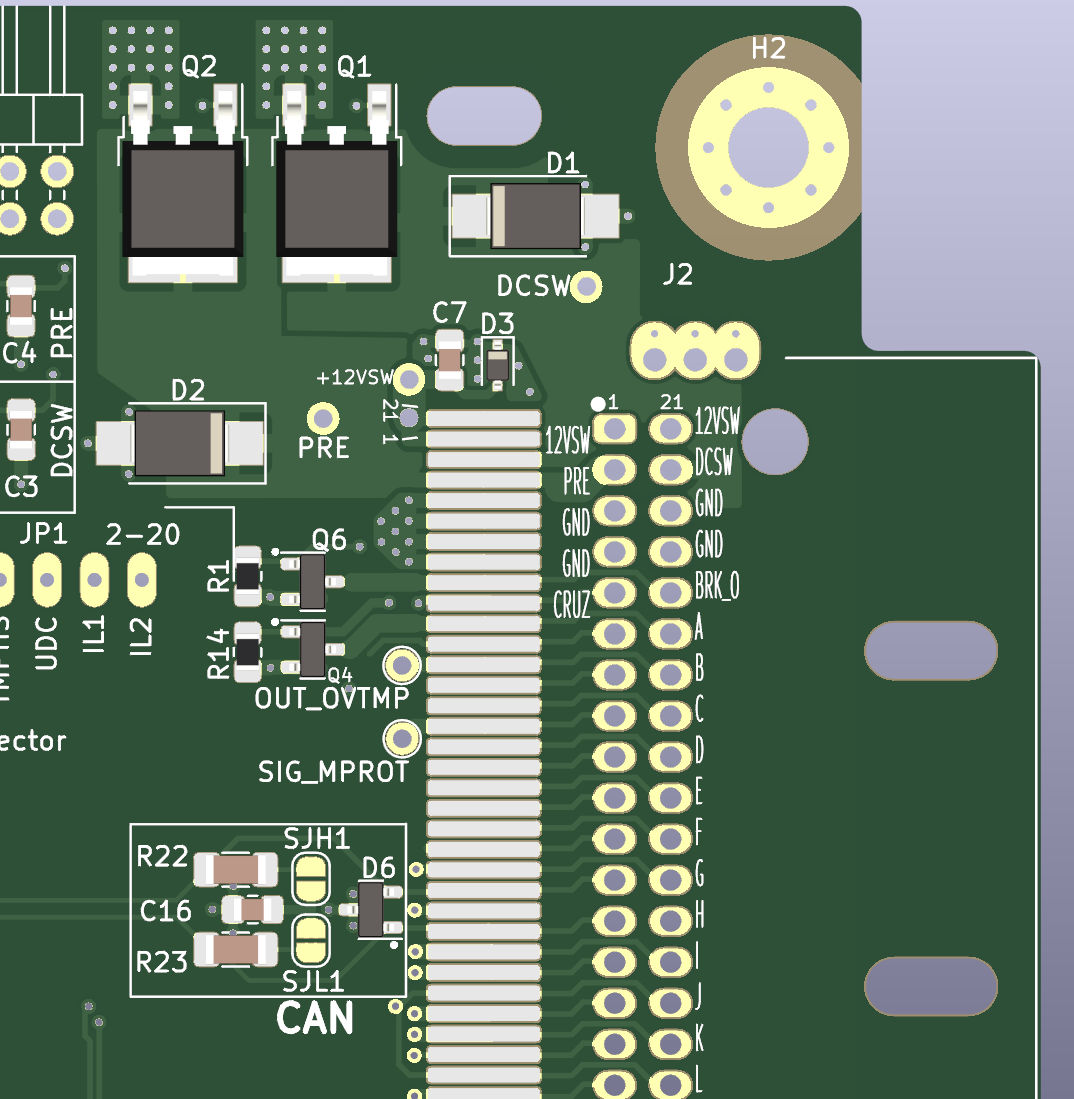

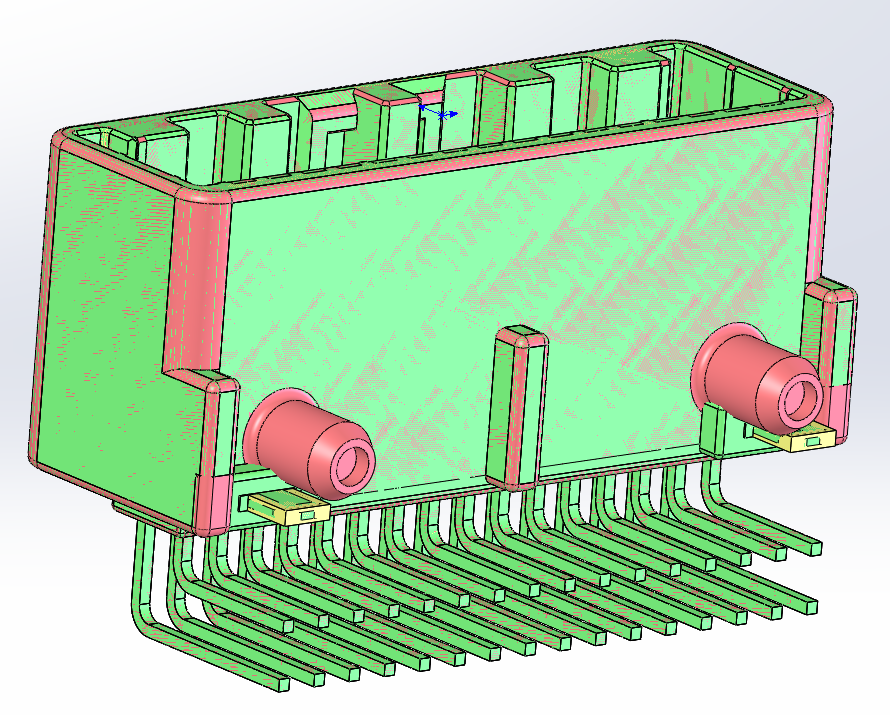

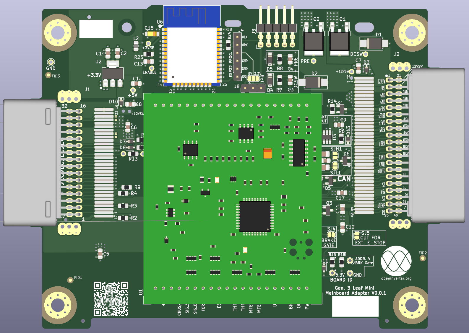

I started a Gen 3 leaf page in the wiki https://openinverter.org/wiki/Nissan_Le ... 8_up_EM57) but I'm having a hard time finding some info.
Questions I have so far working on this adapter board.
Info needed:

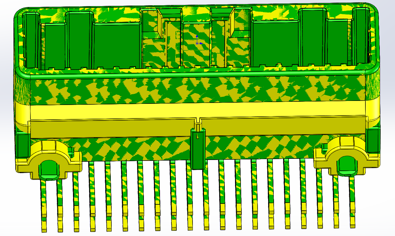

- can someone measure 2 screw holes for me? I can scale Johu's scan image but need a length reference. Any will do but all screw holes and the 2 alignment pin locations would be appreciated.
- Is there a list of pin outs for the 2 Nissan connectors on this adapter board? The round connector pin out is for connecting to the inverter, that makes sense to be in the wiki but doesn't do much for making this board. I have the early attempt designspark schematic pdf, can I trust it?
- Anyone have the part #s / footprints for the Gen 3 Nissan connectors required?
Design questions:
- Does it make sense to have the mini main board be separate? Worth pulling everything into 1 board?
- The 6 fet driver lines do not seem to have pull downs on them in the adapter board or the mini main board. Catphish had this note for the Tesla boards, https://github.com/damienmaguire/Tesla- ... t/issues/7 I think these pull downs should be added here as well unless they will be added to the mini main board...
- In the same logic / safety thinking I believe we should also add pull downs for the pre-charge and battery contactor fets.
Anyone have some design input / info for the above?
I'm pretty rubbish at measuring, all I can tell you is the board is scanned with 300 dpi.
Plus it requires significant current to trigger them. That's why I prefer NOT to have a separate driver chip with super sensitive inputs that act like an amplifier.
EDIT: I prefer not to have freewheeling diodes with cathode on 12V on board as in some setups they will reverse power the circuit
Personally I prefer to do the complicated routing only once plus I can order a larger quantity of generic mini mainboards to get me through the next chip crisis (let's hope there isn't one any time soon)Does it make sense to have the mini main board be separate? Worth pulling everything into 1 board?
These operate opto couplers directly by pulling them to GND, so pull-down is not what you wantThe 6 fet driver lines do not seem to have pull downs on them in the adapter board or the mini main board
Agreed, plus gate resistor, plus TVS across drain-source and as catphish prefers even across gate source.In the same logic / safety thinking I believe we should also add pull downs for the pre-charge and battery contactor fets.

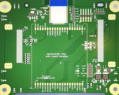

I'll scale it from the connector lengths and work from there. I'll make a pdf of the board to print @ 100% and we will have someone try it before fab.
Understood. I made a Kicad footprint & symbol for the mini mainboard to help simplify future adapter board work.Personally I prefer to do the complicated routing only once plus I can order a larger quantity of generic mini mainboards to get me through the next chip crisis (let's hope there isn't one any time soon)
I'm glad I asked. Thanks for connecting the opto dots!These operate opto couplers directly by pulling them to GND, so pull-down is not what you wantPlus it requires significant current to trigger them. That's why I prefer NOT to have a separate driver chip with super sensitive inputs that act like an amplifier.
Thanks for mentioning the freewheeling diode note.
Mini mainboard looks to have 470 ohm gate resistors inline already, The rest I will add.
Johu, do you have any raw pcb's / gerber files with the Nissan connector footprints? I can scale those too but I don't know what they look like under the plastic / pins.

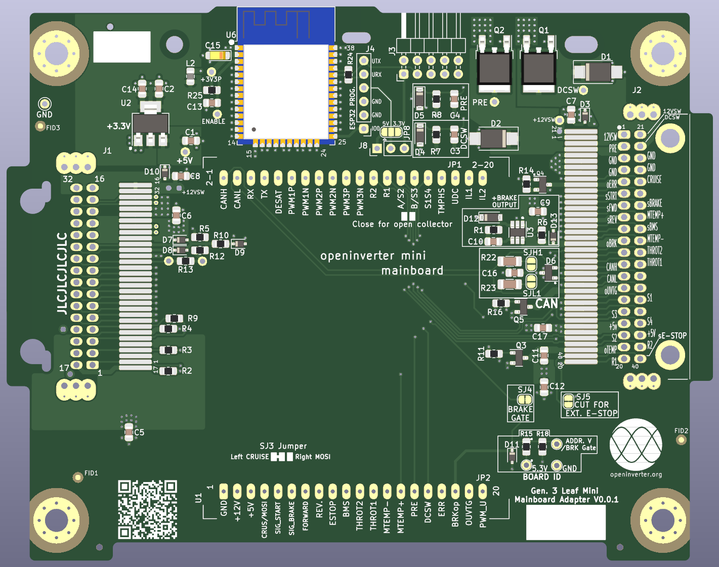

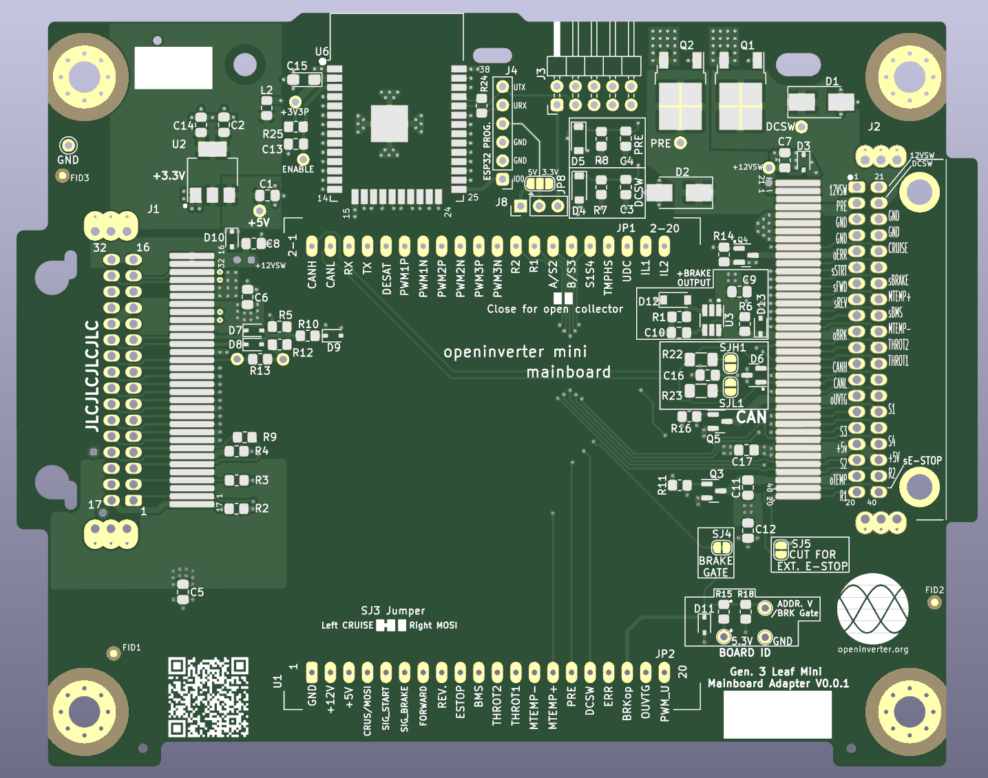

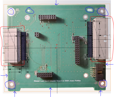

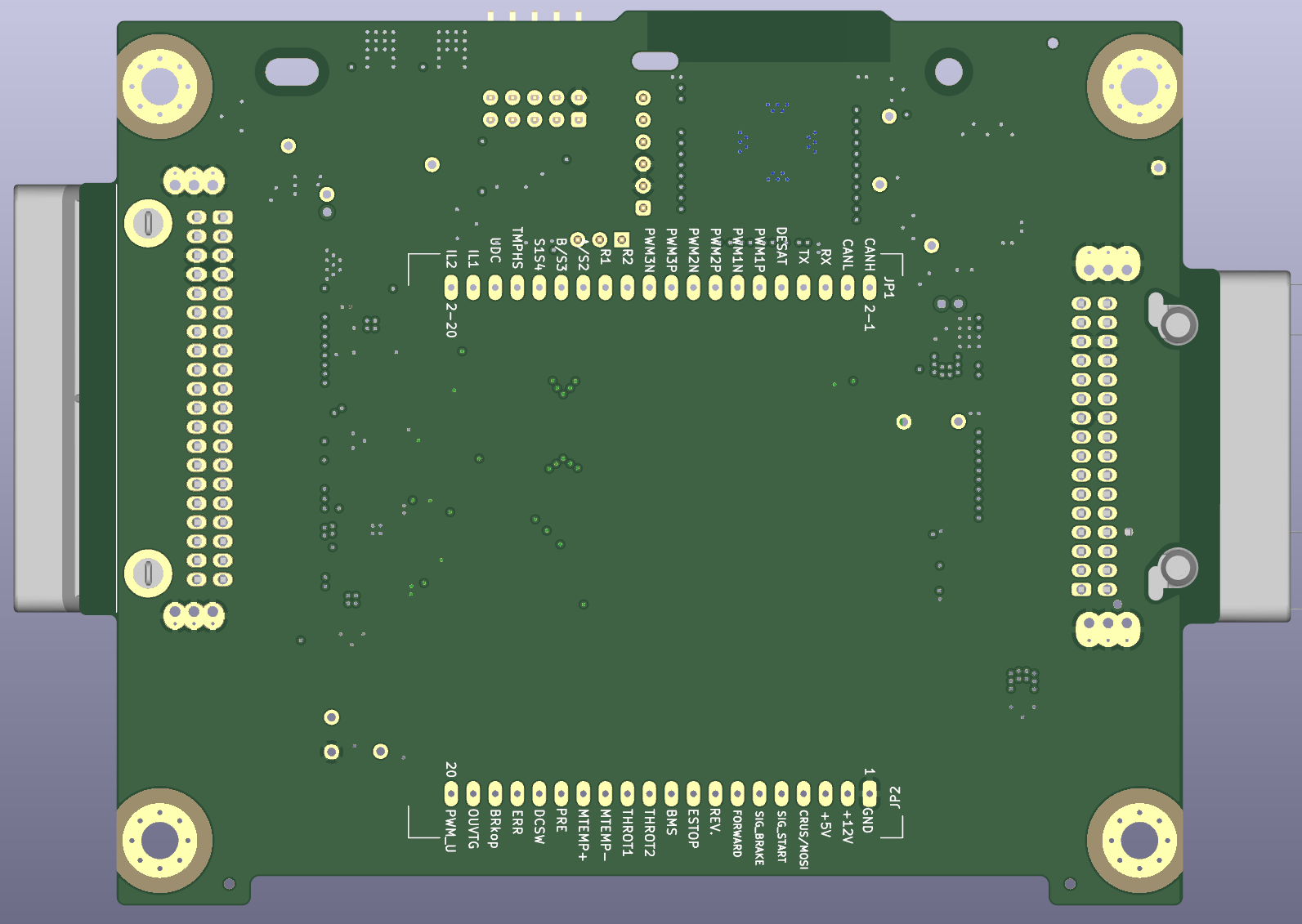

If someone has a gen 3 leaf inverter and is willing to check fitment, please print whichever of these pdf's fits your paper size.
Things I'm asking for help to verify (I don't have one of these inverters): - The 5 holes and 1 slot all line up at the same time. If they don't line up, please line up the bottom left mounting hole, center the top left mounting hole on the line, and take pictures of the other holes.
- Board edges are close with holes aligned.
- if after those are verified cut your print along the red lines and across the terminals of the connectors. This should give a nice reference to use to check pin width and pin spacing for the 2 connectors.
The above will help verify the mounting & locating holes are in the correct places and will help me draw up footprints for the connectors.

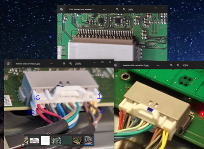

If there is some pin numbering on the connectors that you could share it would help a bunch.

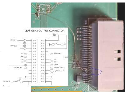

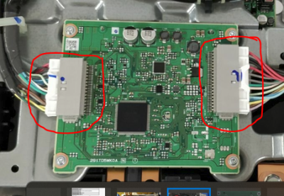

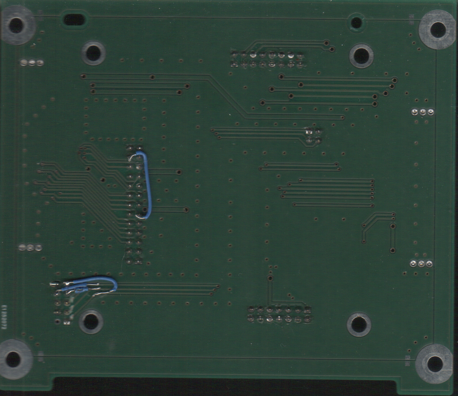

I could only figure that you meant the blob of solder on the above.
So 28, 13, 29 get 5v?
Can you confirm that's what you meant in the picture above?
and left row is connector pins bottom, right is connector pins top and lined up in order?
and the 40 position connector is setup the same?

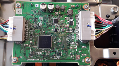

Edit, found a picture of the Nissan controller (credit boekel @ electric car forum) that was clear enough to see pin labeling.

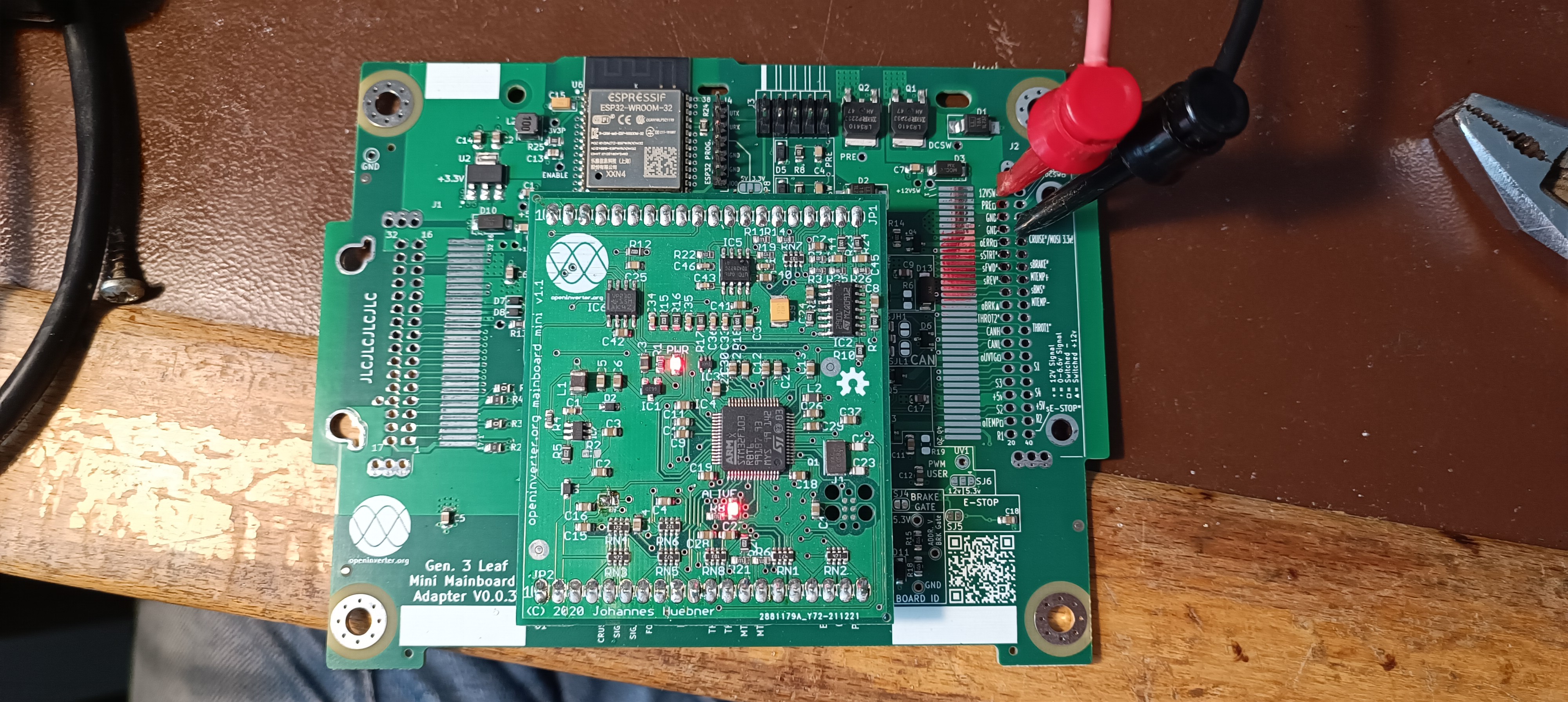

Just tested on mine and it fits perfectly.
Trying to remember why I connected 5V to 3 pins not just the one that Kelju marked out. Reading here: viewtopic.php?t=980
Here's something on the 5V viewtopic.php?p=23161#p23161

I went through all of that but did not find anything definitive. From this image of the 32 pin connector I can see terminals 5, 12, 15, 21 are empty. It looks like positions 31 and 29 are empty as well. From what I'm seeing pin 13 is missing something and also not labeled in Kelju's schematic. Its a grey wire like pin 28, so I think that's 1 missing 5v.Trying to remember why I connected 5V to 3 pins not just the one that Kelju marked out. Reading here: viewtopic.php?t=980
I'll make sure 5v is where it should be on the adapter board, kind of sounds like this may have been an issue from your link / previous digging. Maybe one of the tiny fuses blew during testing?
Thinking of fuses, you want all the fuses on the adapter board removed, (from Kelju's design) correct?

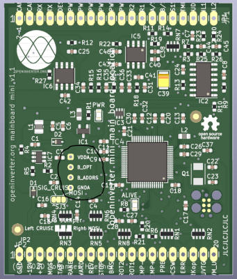

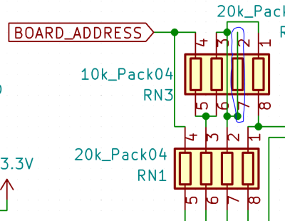

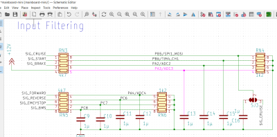

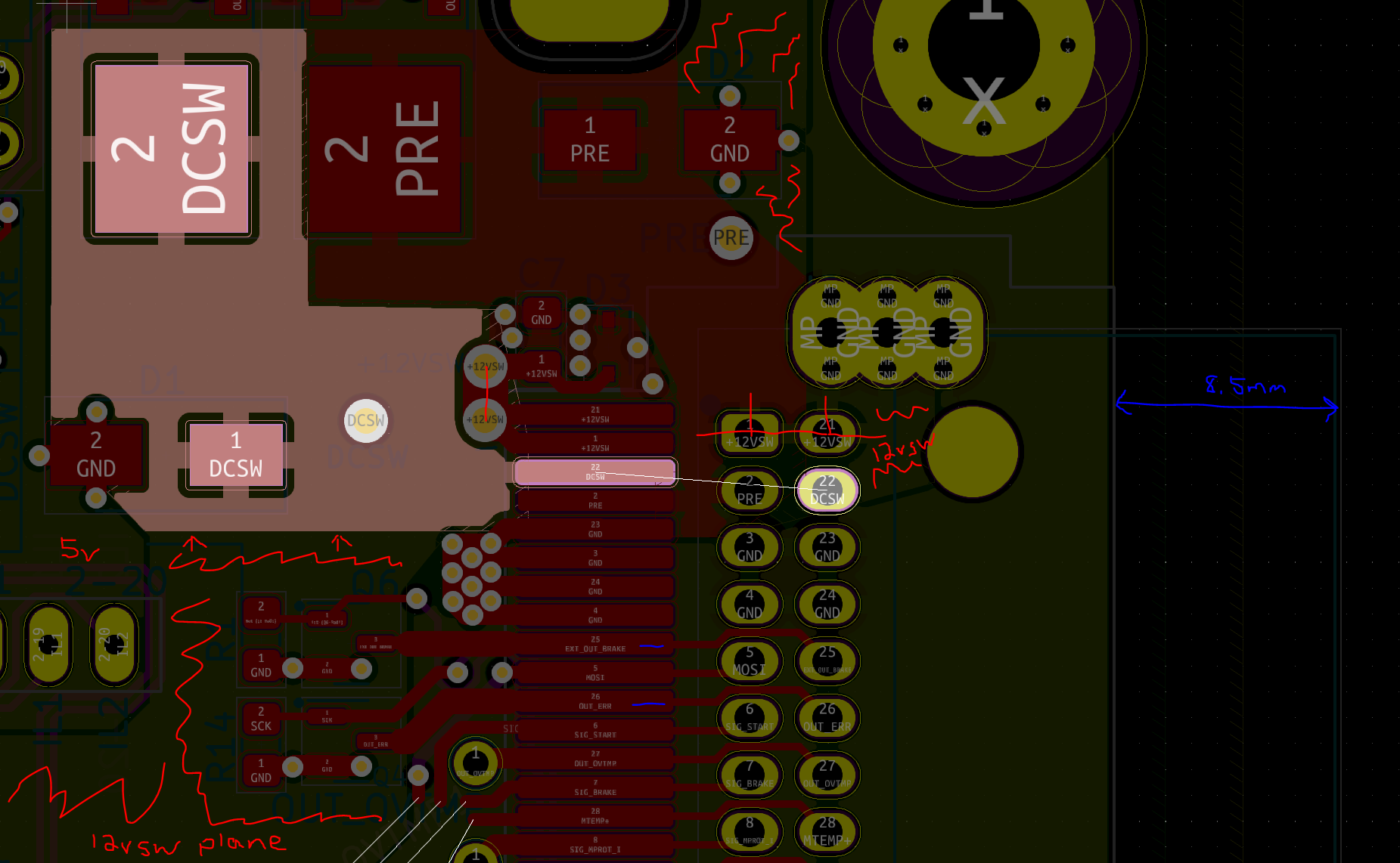

Swapped this to the ESP32 Wroom, copied the V6 / V8 Tesla boards. Or did this mean something else?

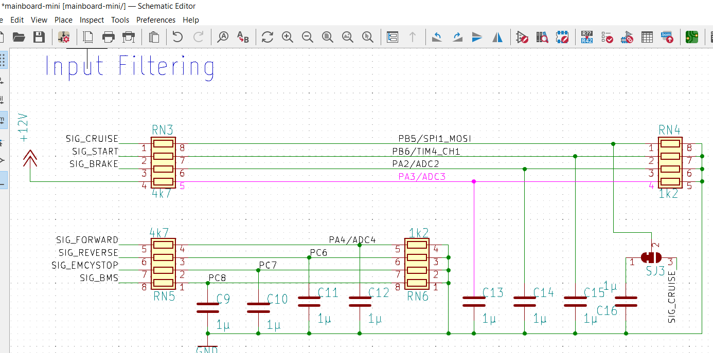

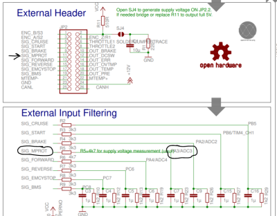

This is confusing me. In the mini mainboard there's this, PA3 is MPROT but it does not go to either of the 20 pin connectors to get out of the mini mainboard, looks like it was dropped going to the mini.- mprot pulled up to 12V
v3.4 has it, Does this just need a 12v pullup for the rest of the inverter to run and the mini mainboard ignores MPROT?
Sorry for all the questions. Referencing Kelju's work, mini mainboard, v3.4 mainboard, bmw adapter, and tesla stuff for the ESP32.

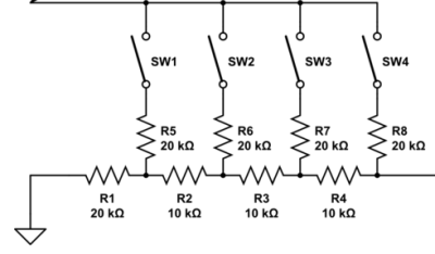

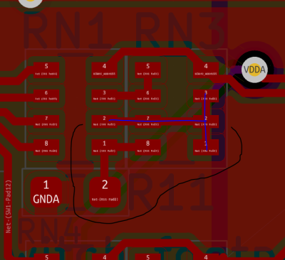

Has anyone considered using something like a R-2R resistor ladder network on the adapter board to set an address (specific voltage) for the adapter board / mainboard settings?

Indeed mprot is no longer brought out on the mini mainboard, it is just used locally to measure uaux.
Only emcystop is left as a hardware shutdown pin. You can either pull it high or bring it out on the header with a cuttable solder-jumper that can be opened in case someone wishes to use emcystop.
Yes, thought about, never done
Alternatively a "variant" parameter must be introduced.

Thanks for the background on that. I'll pull it out as a test point and add a shorted solder jumper.johu wrote: ↑Wed Sep 27, 2023 8:07 am Indeed mprot is no longer brought out on the mini mainboard, it is just used locally to measure uaux.
R-2R network address..
So 2 analog pins with a 4 resistor R-2R network for each should cover it? I'll look for a spot on the mini main board where a connector for this might fit and add an unpopulated footprint for it on this adapter board.Yes, thought about, never doneSo software will just detect it as Rev3 mainboard. That's actually ok for the Nissan board as there is no special handling. But on the upcoming Prius board some special Prius code won't be run because of lack of detection. Would need to devote one pin to that so one functional pin would have to go.

Resistance I've hit so far looking into it:
- JLC doesn't carry R-R2 resistor networks. Can use a few resistor networks / arrays in its place. Could purchase parts too but that's a pita. JLC is also out of some of the arrays used in the mini mainboard. Their ever revolving in stock / out of stock is challenging.
Pros I've found:
-looks like you have a few extra pins on the STM32 in the mini mainboard (if they don't have a complicated history / other uses elsewhere..) I did not check other boards yet. I really like this route because if you haven't used these pins in the past / other boards you could enable a pull up / pull down / no pull routine to check if the pins are connected to anything. From that you'd get old hardware that needs configuring or new, addressed hardware.
-Do you have a STM32 pin assignment history to check that we're not crippling old hardware / unnecessarily complicating code to work around a new feature?
-Seems to be room on the mini mainboard for some components for this addressing and to drop to the adapter boards with a header if desired. I haven't checked other adapter boards yet.
Sometimes I know enough to be dangerous but I'm not aware of mistakes I'm making. I'm not sure how many errors are coming over from the first prototype. My plan was to post the schematic here and crowdsource people checking it. I have 16 traces left to route but expect some rework. Basically thinking this will likely be a prototype.

2nd post for where I am with this.
Adapter board so far:
I chose to go 4 layer because of how tight this is and the original design reference images. Bottom layer is connected to the 4 mounting holes along with the plane ring around the outside on top like the Nissan board. Inductor footprints around the outside, will set them to dnp. Should make for a nice shield.
I did mostly 0805 sized components so they can be swapped if necessary. Also this still has some 0R resistors where they were in the original. Can drop these once we know things are working / connected correctly. Some unknowns still there.
Added solder jumper CAN resistors on the adapter board. 60ohm - 4.7uF to gnd - 60ohm with a solder jumper for each resistor to can lines. If this is the can end point it should help people use CAN correctly, easily, & filter some noise which will hopefully reduce struggles across the disciplines & forum support. Footprint for a can TVS right next to Nissan connector too.
I drew up the Nissan connectors but the dxf / footprint looks off from the first attempt board. I copied the same sketch / dxf, not sure how it happened or if it's an issue yet.
I also extended the pads to help with hand soldering.
I have the 2x05 old WiFi / comm header in currently. Not sure of use cases people might have for it. Planned to just leave this unpopulated.
I set the ESP32 boot delay R & C to the commonly recommended 10k resistor & 1uF. Not sure how / why 4k7 / .1uF was chosen but can easily switch back.
Also added the 499R inline to esp32 TX line from the datasheet "to filter 80mhz harmonics".
Broke out unused pins on a 2x05 footprint with labels.
I added notes in the schematic on what pin names were to help cross reference the mini main board and Kelju's schematic.
Added short traces with vias off the unterminated Nissan connector pins if we need to connect something along with a 4 pin header top right.
I have some cleanup to do before asking for others to check it. I'll hopefully post it in the next few days. If anything jumps out to anyone please feel free to pick it apart with some ideas how to fix it.
I think I'm moving the contactor fets to the top right and moving stuff up top to the left to make room.
- Posts: 599
- Has thanked: 218 times
- Been thanked: 178 times
I would love for someone or a few people to look this over, done in KiCad 6. I think I'm done besides cleaning up part numbers, checking the dip switch footprint, rotations, gerbers, etc. I feel like I can't see straight at this point.
I added an 8 pos. dip switch. Could potentially have all 8 on one analog pin but it starts to get tight. Need to discuss implementing this, if its on the mini mainboard or adapter boards, and implementing it elsewhere if it makes sense to keep it. Thinking is the dip switch can go away once addressing is defined, or half could go away to leave 4 option settings if it helps, or switch to solder jumpers.
To make the R-2R thing work with JLC inventory its 3 components instead of the 1 R-2R for 4 positions, so 6 components + dip switch, 2 analog pins. There's an unused position on one of the resistor arrays, I shorted across the resistor to make routing cleaner and easier, I know this will likely throw anyone looking for a loop. Blue circle and blue T shape. Schematic is ugly because its all squished on one page. There's a separate 20k resistor (R11) like R1 below. Doing this, The connector pokes through in a decent spot on the i3, mini mainboard, and this Gen 3 leaf board. Definitely need to verify the 32 & 40 pos. Nissan connector footprints too.
Please critique, ask why did you... poke fun, whatever. A bunch of other info in the few previous posts too.
Just tagging you johu. Where / how do you want this posted?
The adapter board is looking good.
I'm not a large fan of electro-mechanical elements in "challenging" environments (so dip switches or trimmers).
One last attempt to make this backwards-compatible and omit the extra pins. Maybe first we should clarify the goal - we want the software to be able to detect which adapter board it is running on, right?
So you could just connect a high-impedance voltage divider to brake_out that SW could read at startup and then switches the pin to output. The brake light will be too slow to actually light up, should the coded voltage be above FET threshold.
So you could have 47k pull-up to 3V3 or 5V if more convenient and variable pull-down for each adapter board variant forming a voltage divider. The lowest one would be 2k7 to not interfere with the 220R series resistor.
So there could be these steps (assuming 5V pull-up)
2k7 - 0.27V - 337 ADC digits
3k3 - 407 digits
4k7 - 564 digits
6k8 - 783 digits
8k2 - 912 digits
10k - 1088 digits
and so on up to 82k. I think this should allow for enough variants and have sufficient distance between the codes to not mis-detect.
3k3 - 407 digits
4k7 - 564 digits
6k8 - 783 digits
8k2 - 912 digits
10k - 1088 digits
- Posts: 599
I was thinking this first batch would be a prototype and the dip switches would make testing code convenient. My replies are very wordy though. I understand your hesitation here for production.
Older posts,
jrbe wrote: --Would you feel better with smd dip switches on the universal main boards / resistor dividers on the dedicated boards?
We're mostly on the same page with this.jrbe wrote: Thinking is the dip switch can go away once addressing is defined, or half could go away to leave 4 option settings if it helps, or switch to solder jumpers.
Agreed.johu wrote: we want the software to be able to detect which adapter board it is running on, right?
I think I wrapped my head around this now. At the worst you might get a brake light flicker if they're leds.So you could just connect a high-impedance voltage divider to brake_out that SW could read at startup and then switches the pin to output. The brake light will be too slow to actually light up, should the coded voltage be above FET threshold.
But if the divider voltage ends up above the fet threshold the brake lights never turn off, right? Or is this output held low until brakes turn on? Strong enough to pull the divider below fet turn on?
I'm completely open to whichever way you'd like this to go. I'm not sure if you want to do testing or if you know this will work with the rest of the brake circuit connected. I'm not familiar enough to know how this will work with everything connected. I think there will be some unexpected results at the low, high, and fet turn on ranges.So you could have 47k pull-up to 3V3 or 5V if more convenient and variable pull-down for each adapter board variant forming a voltage divider. The lowest one would be 2k7 to not interfere with the 220R series resistor.
3k3 - 407 digits
4k7 - 564 digits
6k8 - 783 digits
8k2 - 912 digits
10k - 1088 digits
**edit** and whatever circuitry the end user adds to potentially skew the reading.
If you think this needs testing I can add unpopulated voltage divider circuit footprints to the adapter board.
And separately I can make a simple R-2R circuit & separate weighted/stepped resistor circuit pcb for testing if it helps. Can do dip switches and solder jumpers to make testing easy. I can skip all this if you'd rather just breadboard it.
I have all unused pins on this adapter board broken out to vias or headers to make testing, measuring, modifying, etc. easy.
