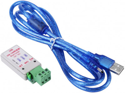

CANable: USB to CAN Adapter
$29 SOLD OUT
USB to CAN Analyzer CAN-BUS Intelligent Converter Adapter With USB Cable Support XP/WIN7/WIN8
AMAZON - $37
I hope to see if this can work as a bare minimum entry level solution,
I have not seen nor know of any of our Open Inverter Reverse Engineers (OIREs) use this particular tool,
if you have experience with it, please do share, feel free to update this thread as you wish
Manual: NA
Tech Support: NA
Pros Cons
cheap you must download and install drivers in addition to the software
only one CAN channel
Final Thoughts: though I somehow managed to get this gizmo to actually see/read CAN Bus messages it is NOT worth the headache, the interface is to arcane, so I actually returned it, and I hate doing that, but it sucked that bad!

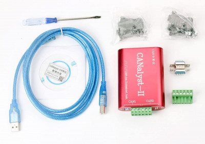

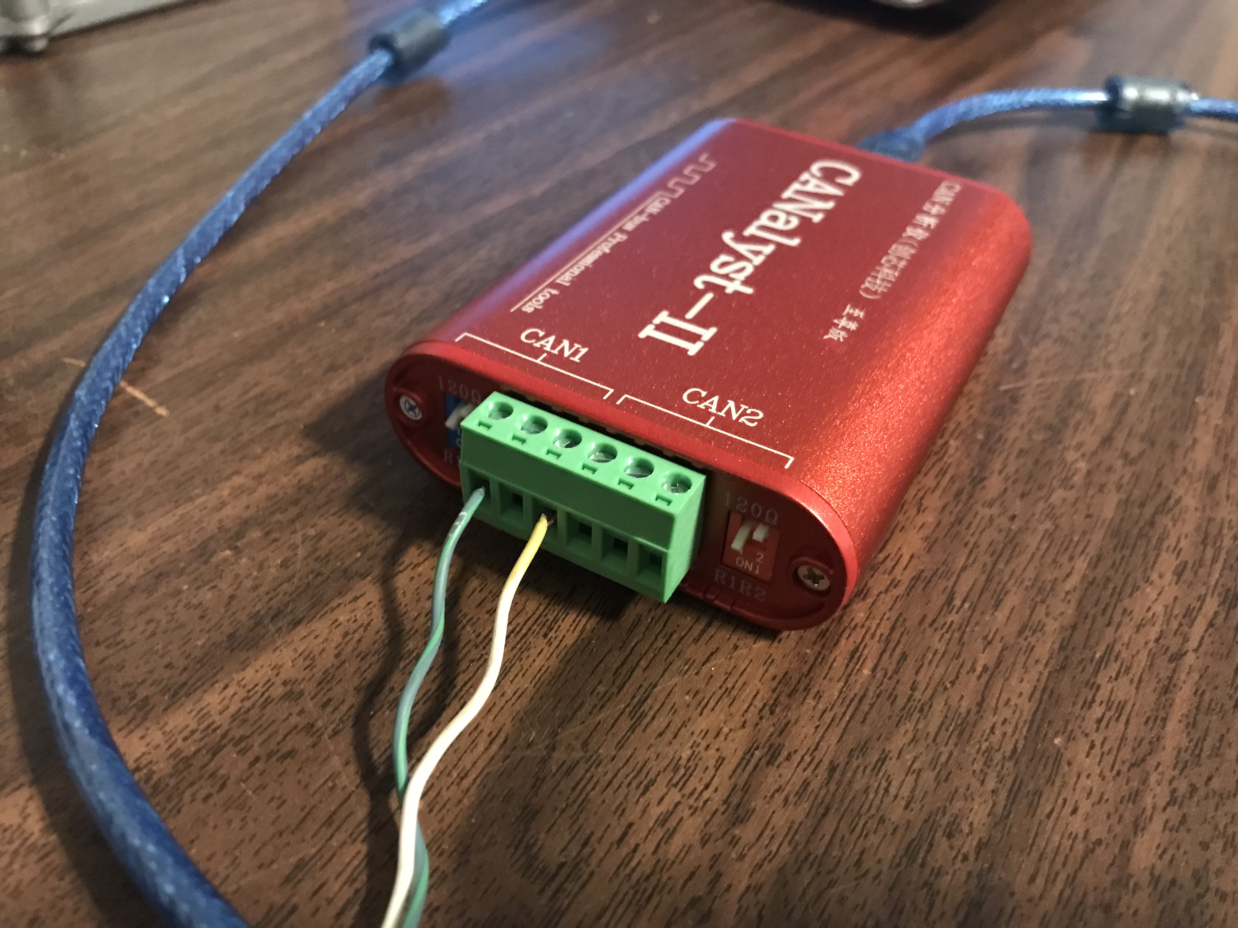

CANalyst-II USB to CAN Analyzer CAN-Bus Converter Adapter Support ZLGCANpro
AMAZON - $84
as seen in action by Mr. Arber Kramar a mechanical engineer Ampera/Volt DCDC or APU
Manual: In Chinese
Tech Support: actually pretty responsive via email
Pros Cons
has two CAN Bus Channels
Software comes with driver
(only one thing to install)
Download site is in Chinese
Manual is in Chinese
Final Thoughts: I really wanted this thing to work out, it is a well made piece of hardware however it is pretty much for analyzing/reading CAN messages only, and not really for sending multiple commands simultaneously, so if I hadn't waited too long I would have returned this one as well.

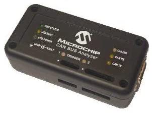

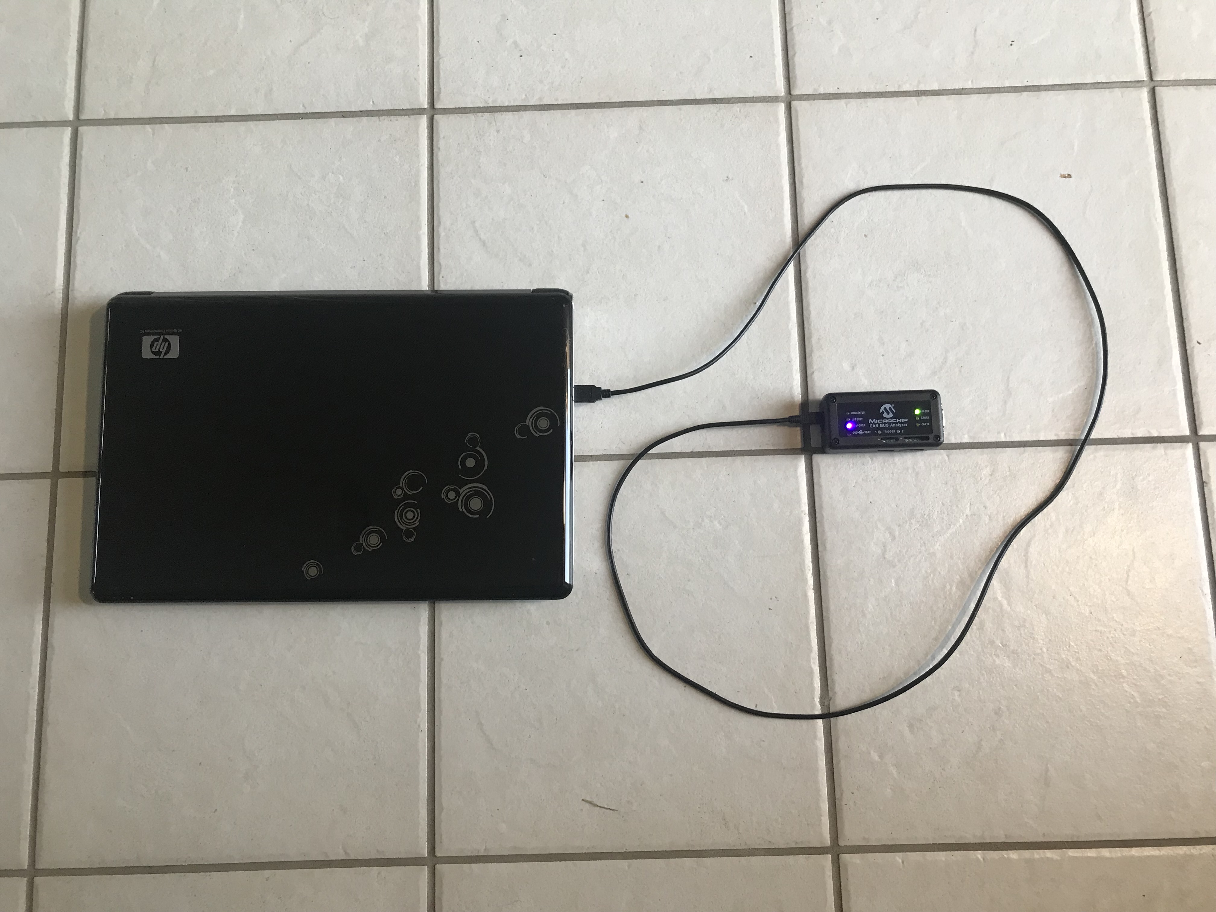

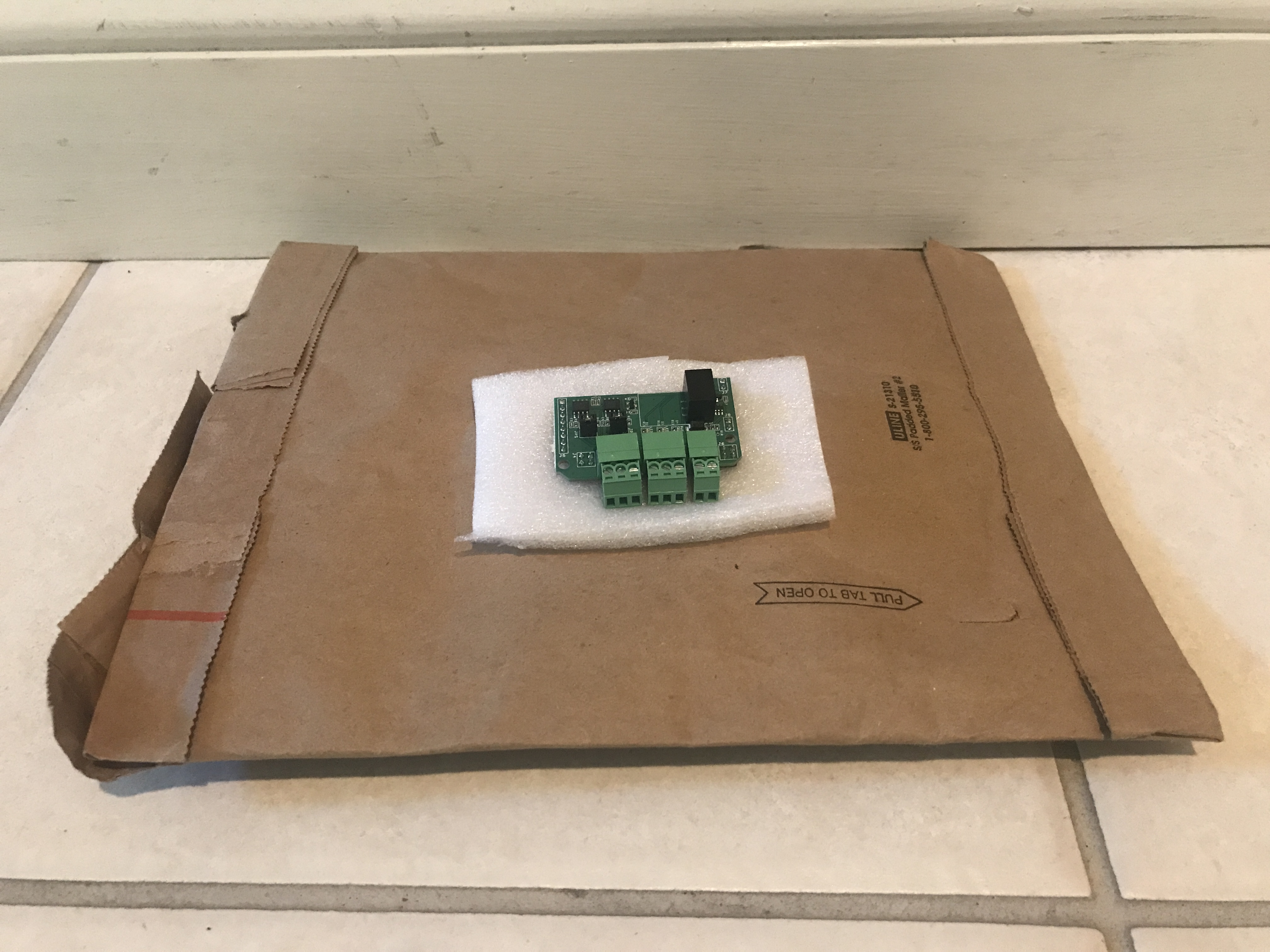

MICROCHIP APGDT002 CAN BUS ANALYZER TOOL, CAN 2.0B, ISO11898-2
AMAZON - $170
Or direct from: Part Number: APGDT002 CAN BUS ANALYZER TOOL
Manual:
CAN-Bus-Analyzer-Users-Guide-DS50001848C.pdf
(907.26 KiB) Downloaded 1053 times
Tech Support: http://support.microchip.com

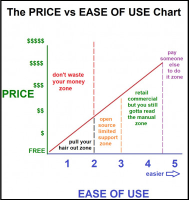

we will rely on this Price to Ease of Use chart to rate our reverse troubleshooting (ha ha) tools
Price To Use Chart.jpg (42.67 KiB) Viewed 21169 times

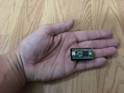

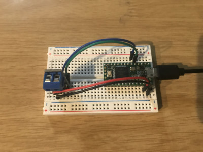

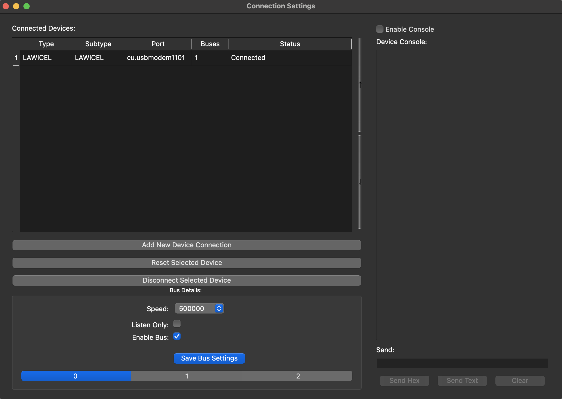

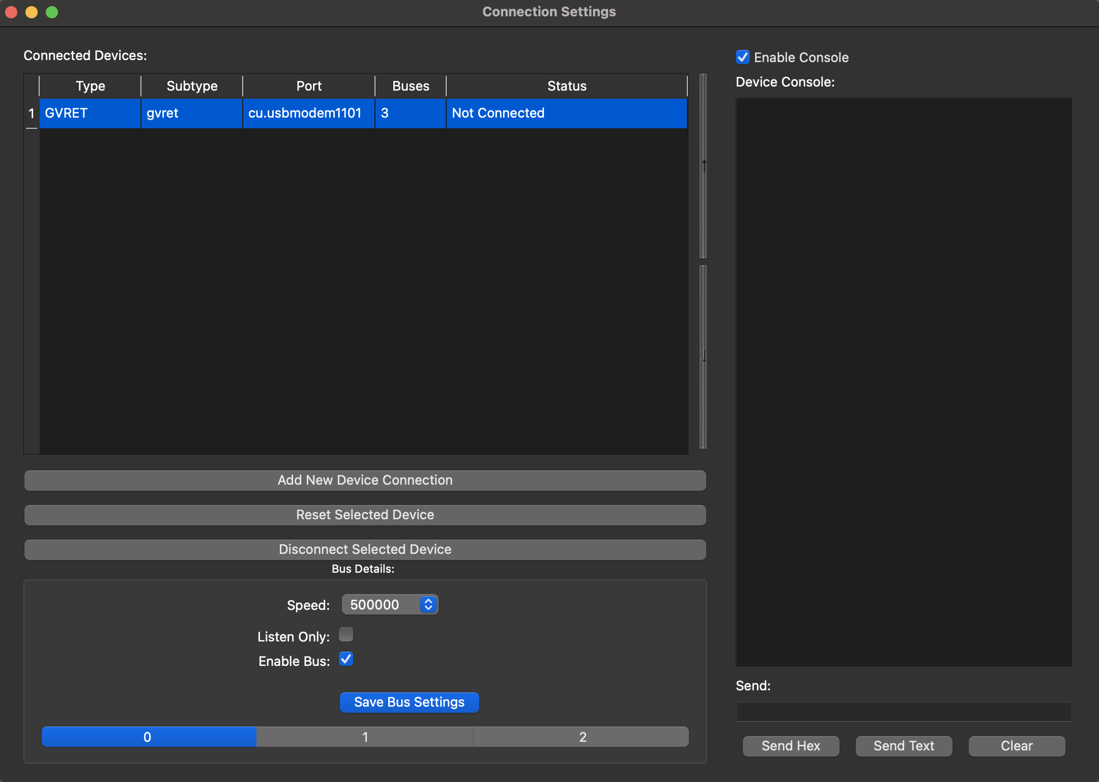

SaavyCAN on the Teensy hardware platform
Collin small.jpg (4.72 KiB) Viewed 21322 times
SaavyCAN Bus Analyzer Software: FREE
available on the author's Collin Kidder's GitHub
Hardware: $25 for the Teensy 3.6 controller board (must be version 3.6) plus an additional $10 for the CAN transceiver board
available on AMAZON FYI: Currently SOLD OUT (as of 4/29/2022)
additional Software required for the hardware: FREE
  • Arduino IDE
  • Teensy-RET (Reverse Engineering Tool)
yes these are that tiny!

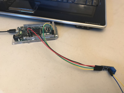

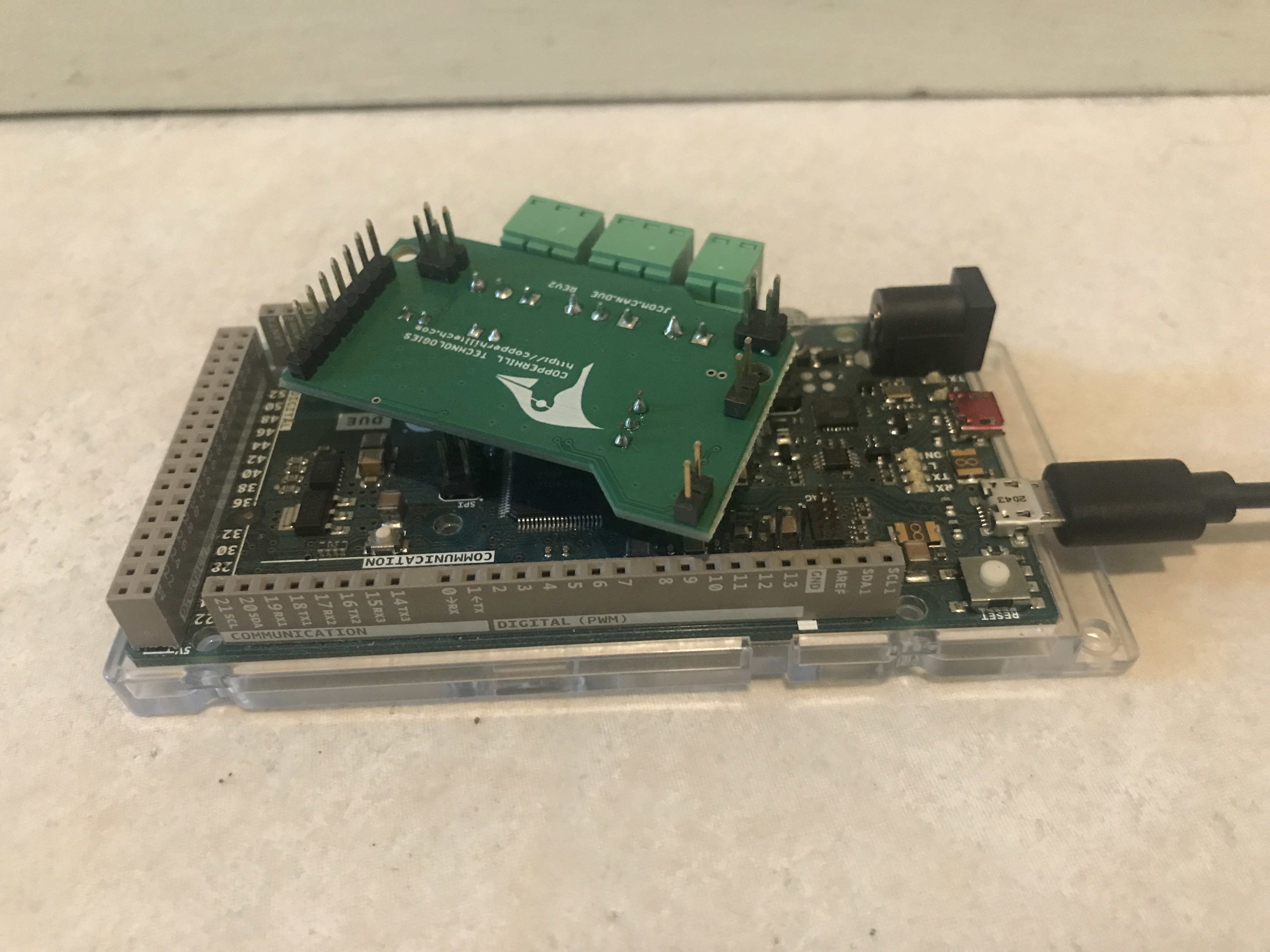

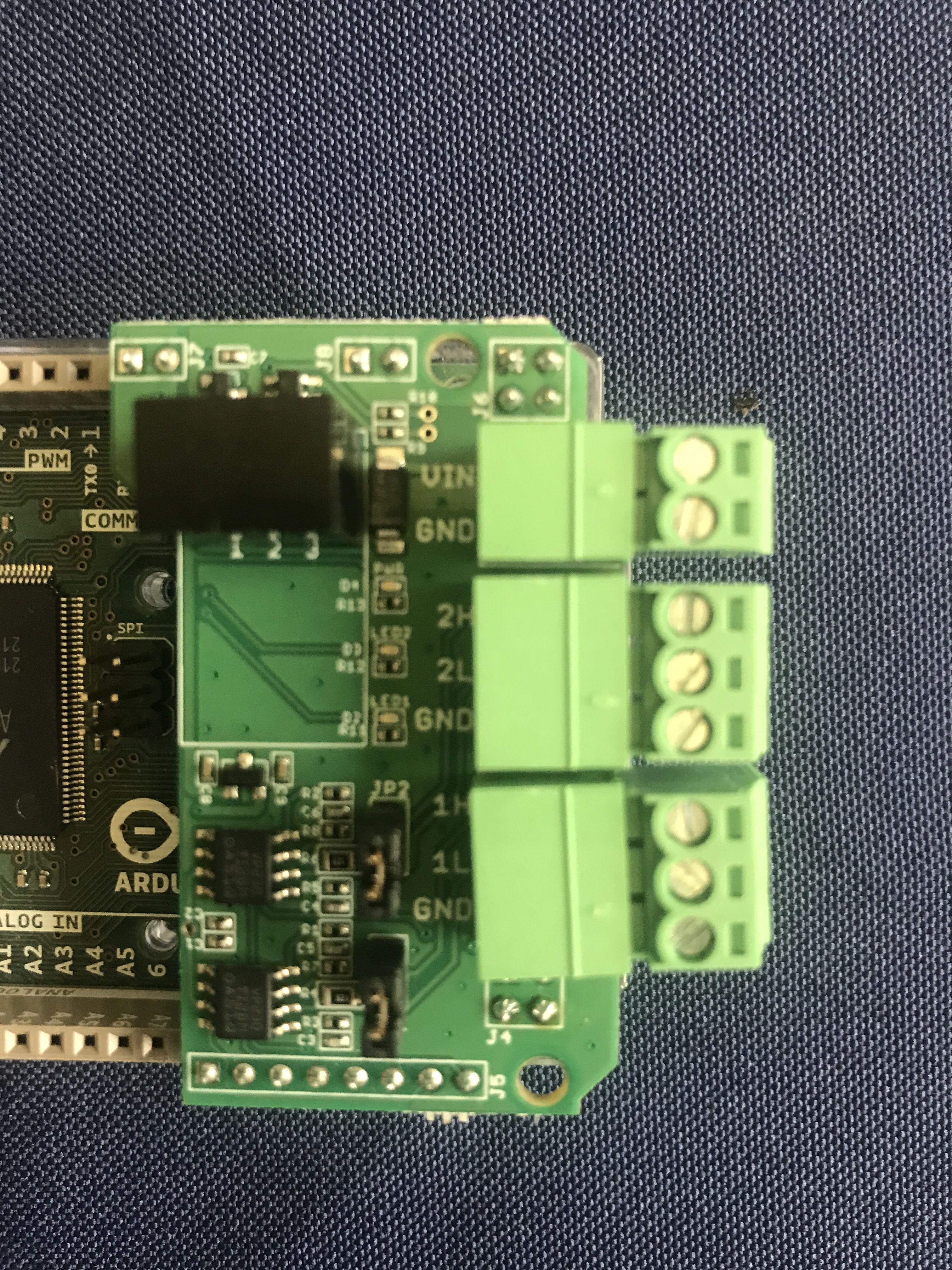

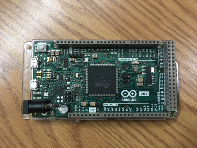

SaavyCAN on the Arduino DUE hardware platform
Hardware: $35 for the Arduino Due controller board (strongly recommend the green name brand board especially if it is your first Arduino product instead of the cheaper generic blue or black ones) plus an additional $10 for the CAN transceiver board
available on AMAZON FYI: Currently ON SALE 30% Off (as of 4/29/2022)
  • Arduino IDE
  • RET (Reverse Engineering Tool)

we will also rely on this Price to Ease of Use chart to rate the open source / roll your own troubleshooting tools
Pete9008
Posts: 1801
Has thanked: 102 times
Been thanked: 351 times
Re: I think I CAN, I think I CAN...
Post by Pete9008 »
I've got the bits to set up SavvyCAN here but not used them yet.
Have had a go with the software though and it does look very good.

Pete9008 wrote: Fri Apr 29, 2022 6:29 pm I've got the bits to set up SavvyCAN here but not used them yet.
nice, which bits, on what platform, ie the Arduino Due or the Teensy? post some pics if you [ahem] CAN

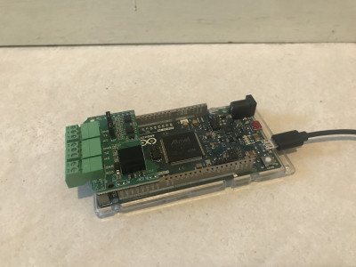

Pete9008
Posts: 1801
Post by Pete9008 »
Gregski wrote: Fri Apr 29, 2022 6:34 pm nice, which bits, on what platform, ie the Arduino Due or the Teensy? post some pics if you [ahem] CAN
:lol:

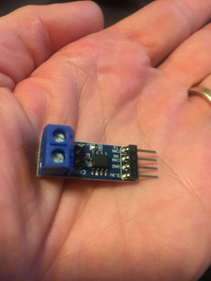

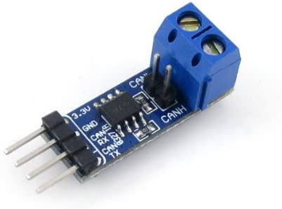

The Due, exact one you have pictured above. I could only get a TJA1050 board (5v not 3v3) to go with it though and I've seen a couple of posts saying they don't work well together so we'll see...
Software is easy to install on 64bit Linux, bit of a pain on 32bit though. May have to compile it from source to get it working on the laptop :(
I think there is also a wireshark plugin that can handle the CAN protocol but it looked a bit involved setting it up. SavvyCAN looked a lot more straightforward.
Pete9008
Posts: 1801
Post by Pete9008 »

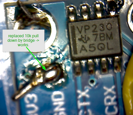

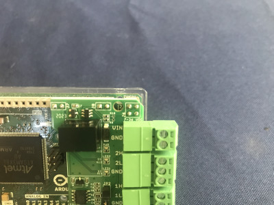

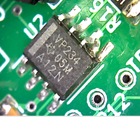

This prompted me to have a go with the boards I have here. I followed this guide https://openinverter.org/wiki/CAN_bus_with_Arduino_Due which pretty much covers all the setup.
Overall it works but there are a couple of issues that may need sorting. Firstly my Due board, which appears to be a genuine Arduino (same as the one pictured above), refuses to start properly following a power cycle and needs a manual reset. Seems there is a design flaw an some boards which can be fixed by adding a resistor, see https://copperhilltech.com/blog/arduino ... res-reset/
Also make sure you get a 3v3 transceiver board, for example something based on the SN65HVD230 should work fine. Mine is based on the 5V TJA1050 which needs a potential divider adding on the Rx output to get it to work with the Due 3V3 inputs.
Also if you use a Due board rather than the proper GVRET candue board then it's missing an EEPROM which means it can't save the configuration. This means it needs reconfiguring each time the power is cycled (although the sketch could be modified to make it default to whatever is needed).
Both GVRET and the SavvyCAN software looks good, I've only scratched the surface with them and apart from one small issue it works fine. The issue is the Temporal Graph window in SavvyCAN - no idea what it is doing but it is the first time I've seen Linux lockup so I'd advise treating it with caution.
Overall this setup looks like it should work well but I think you may be right with the commercial offerings being quicker to get going. I'm going to stick with this though.

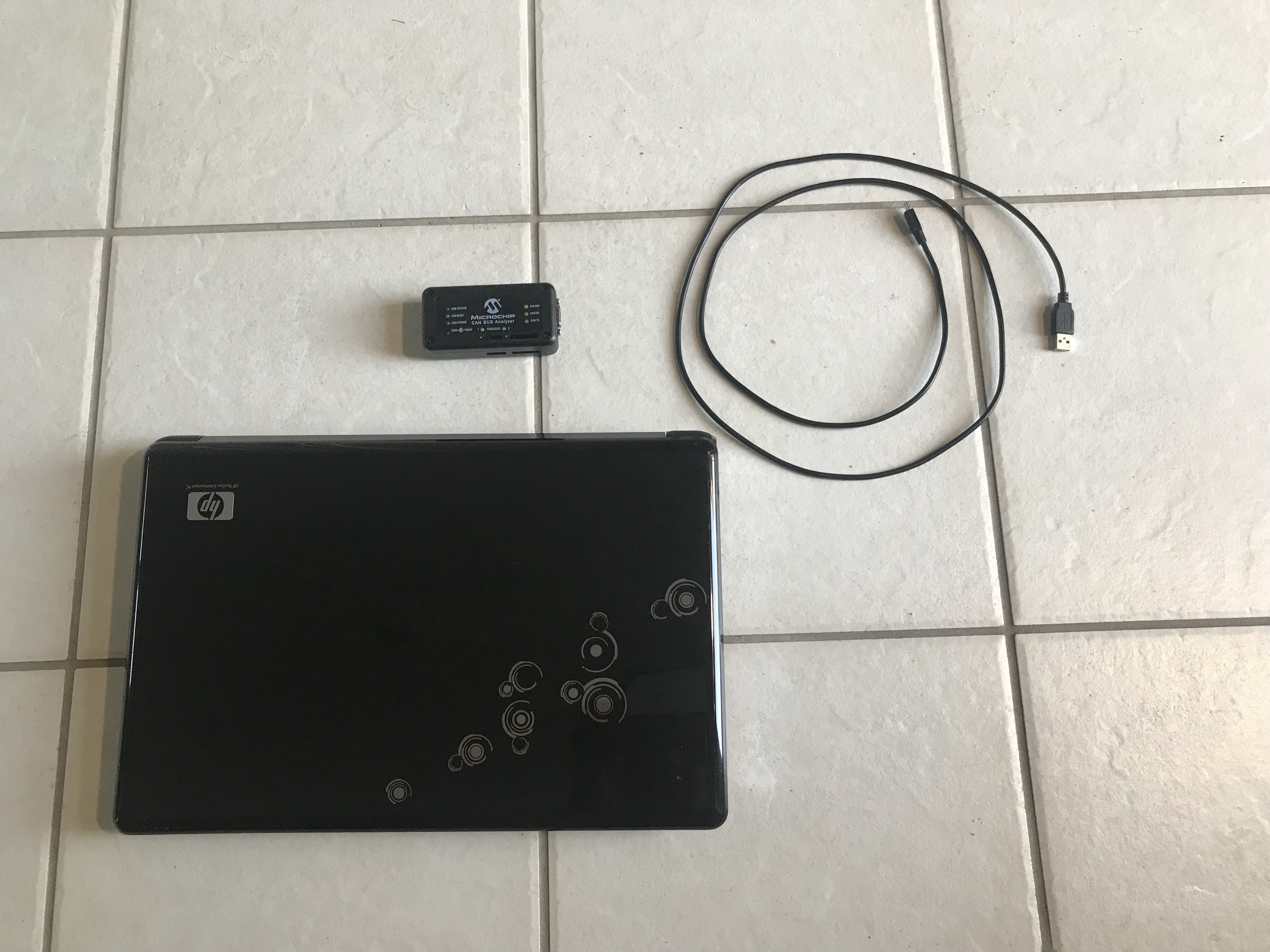

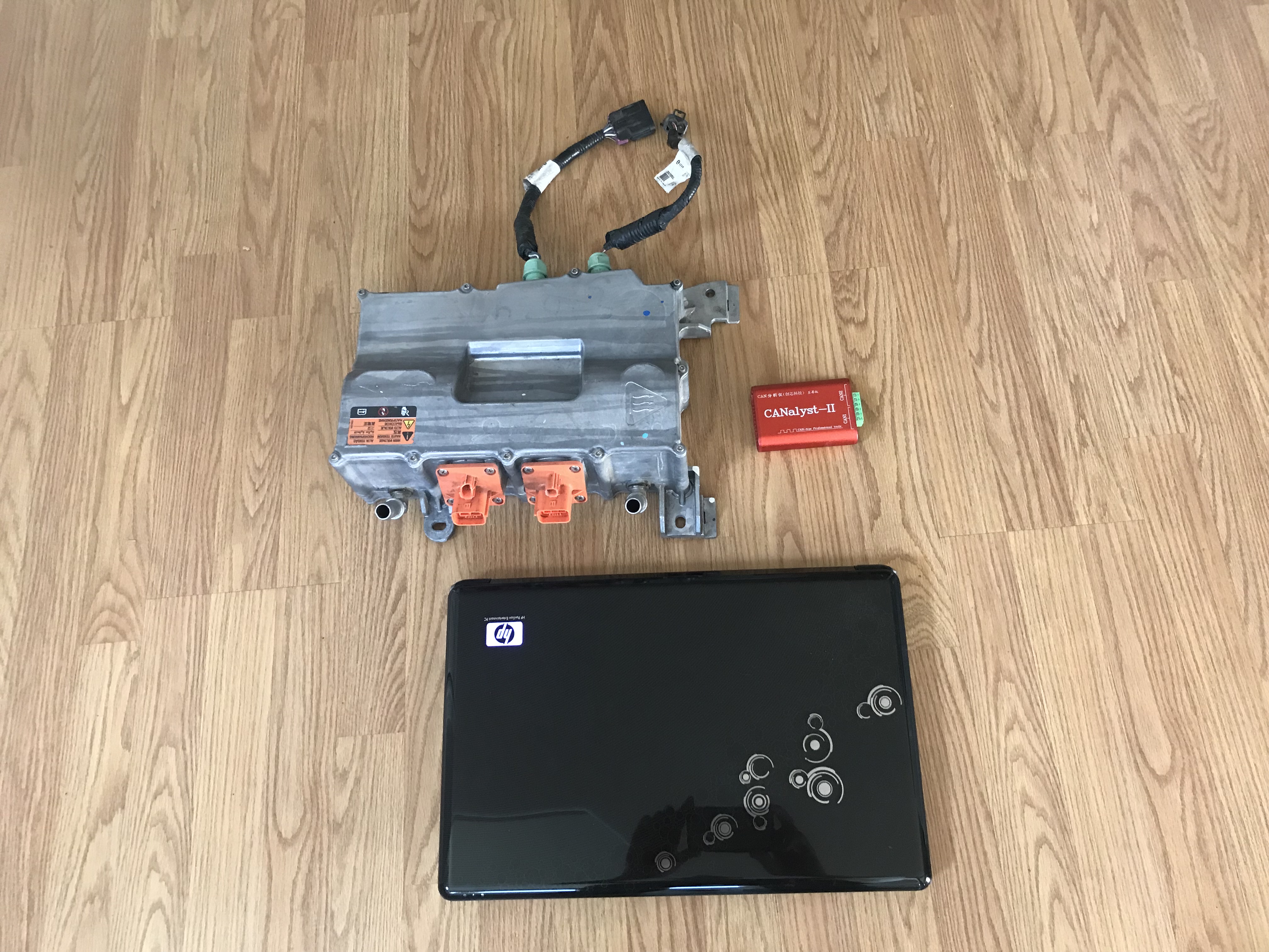

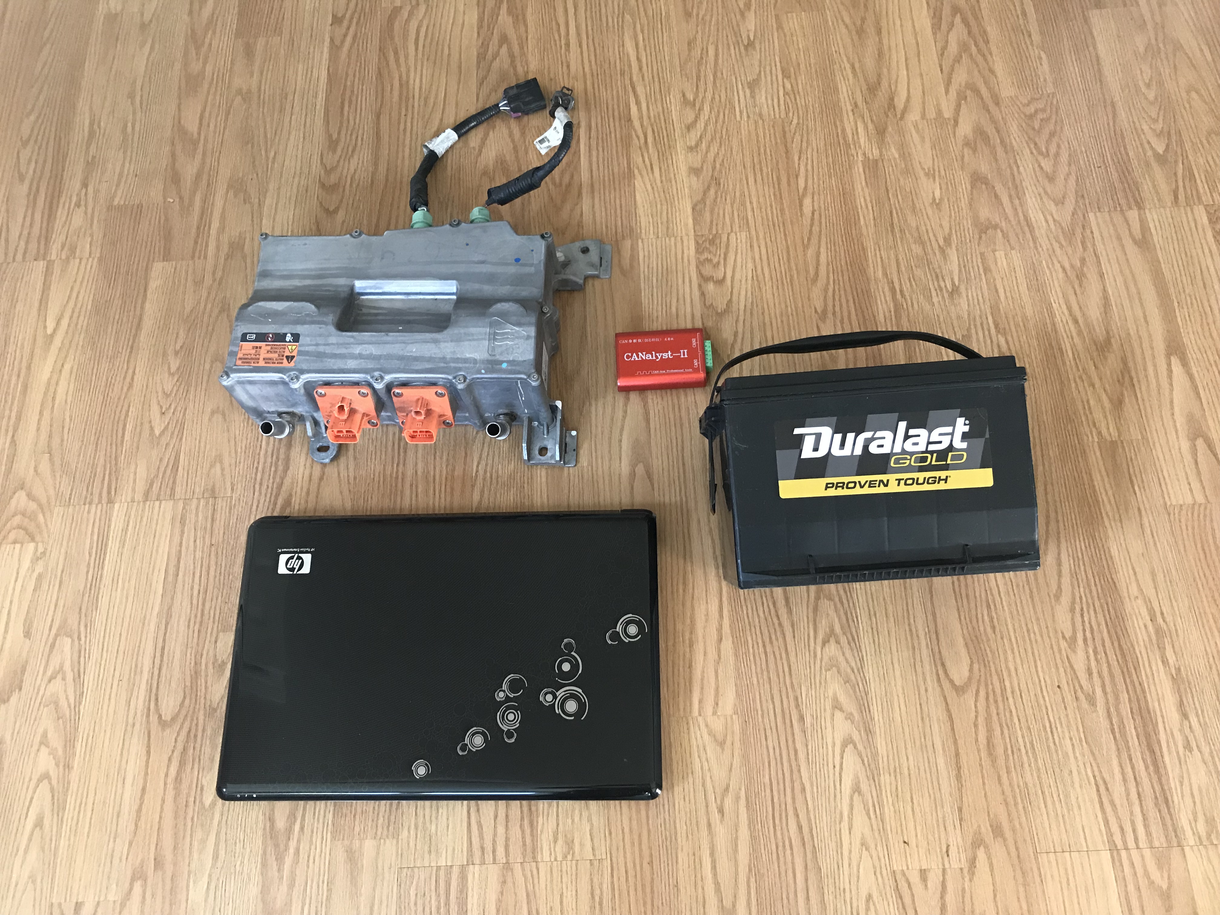

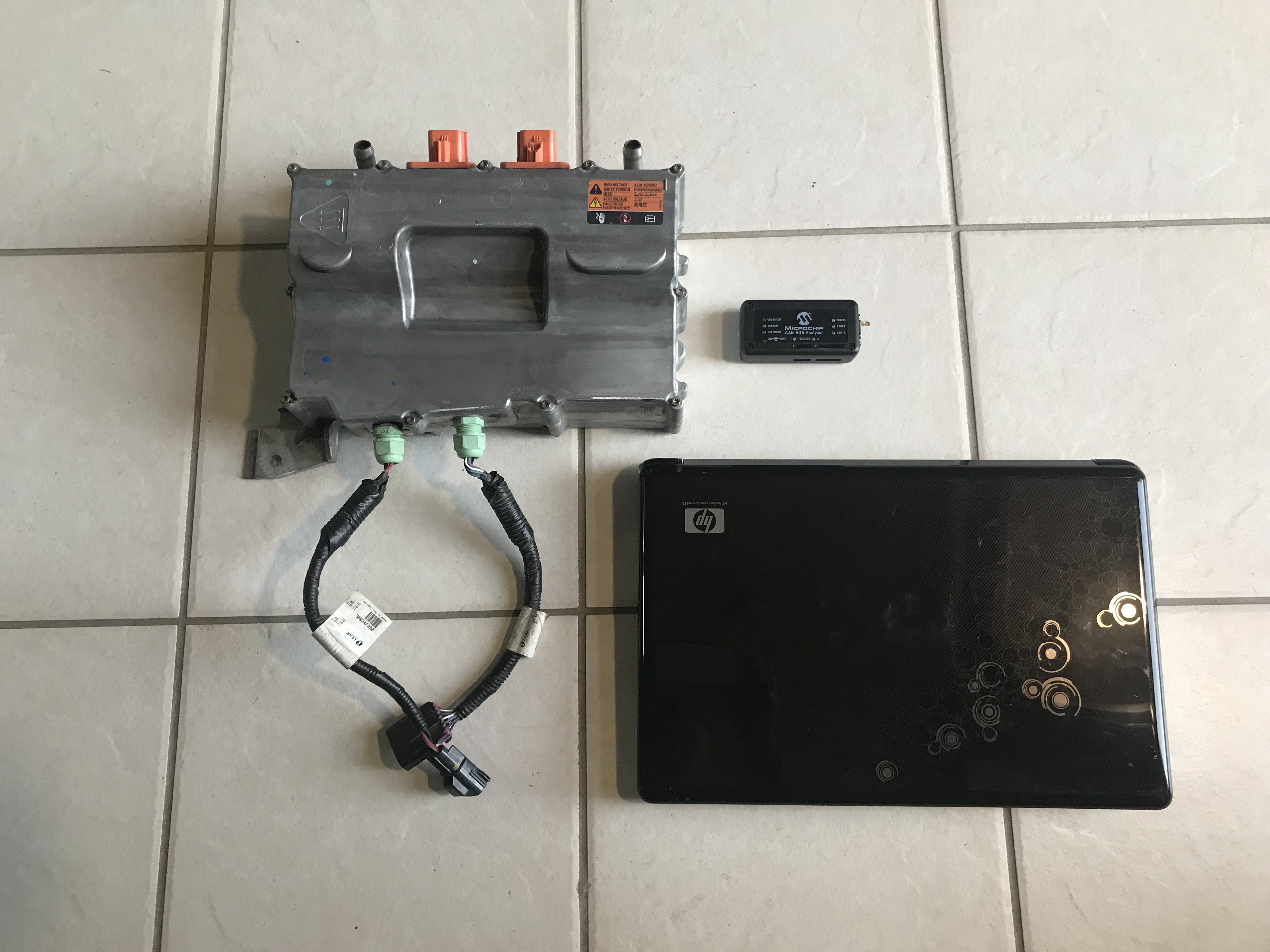

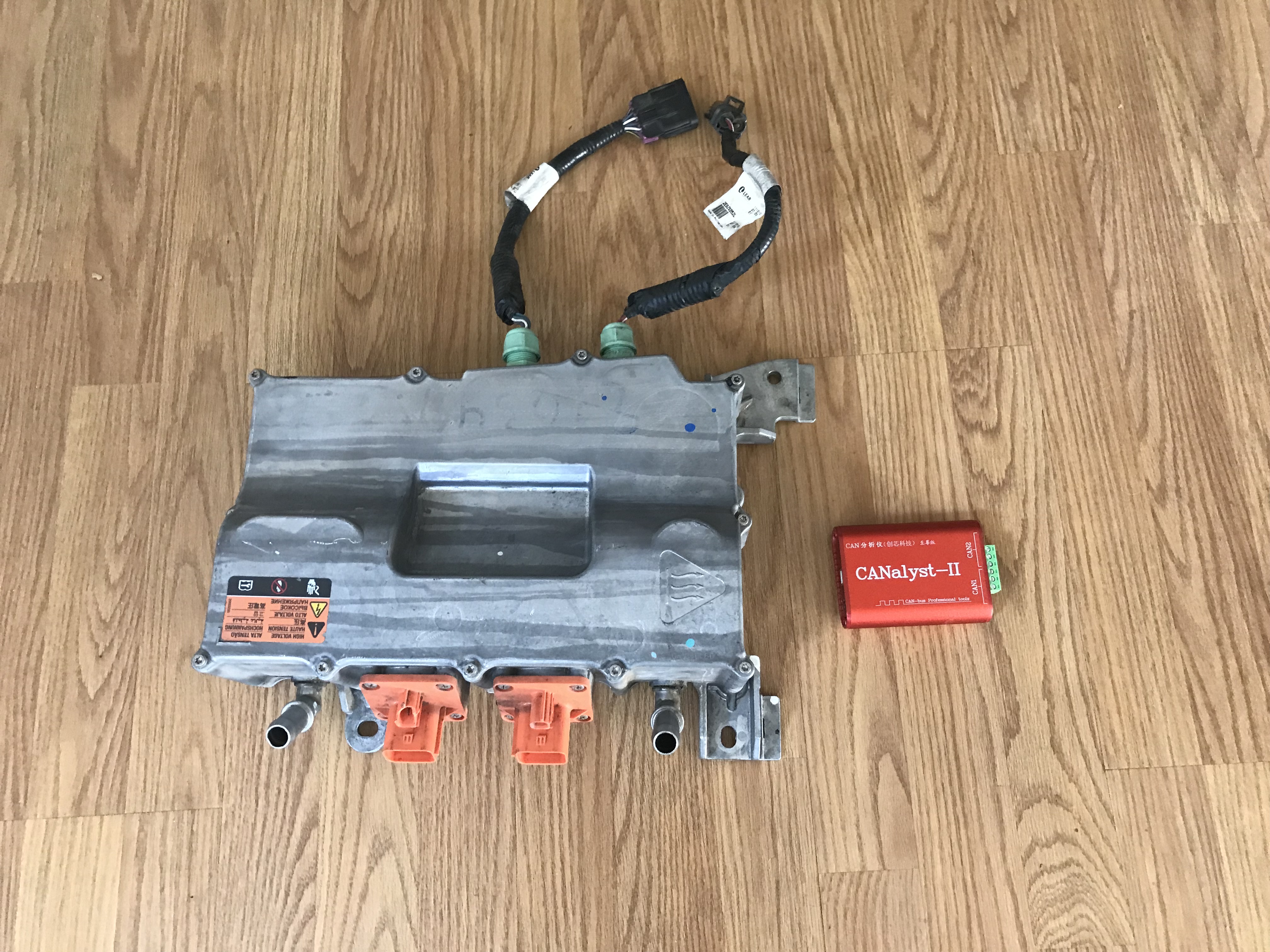

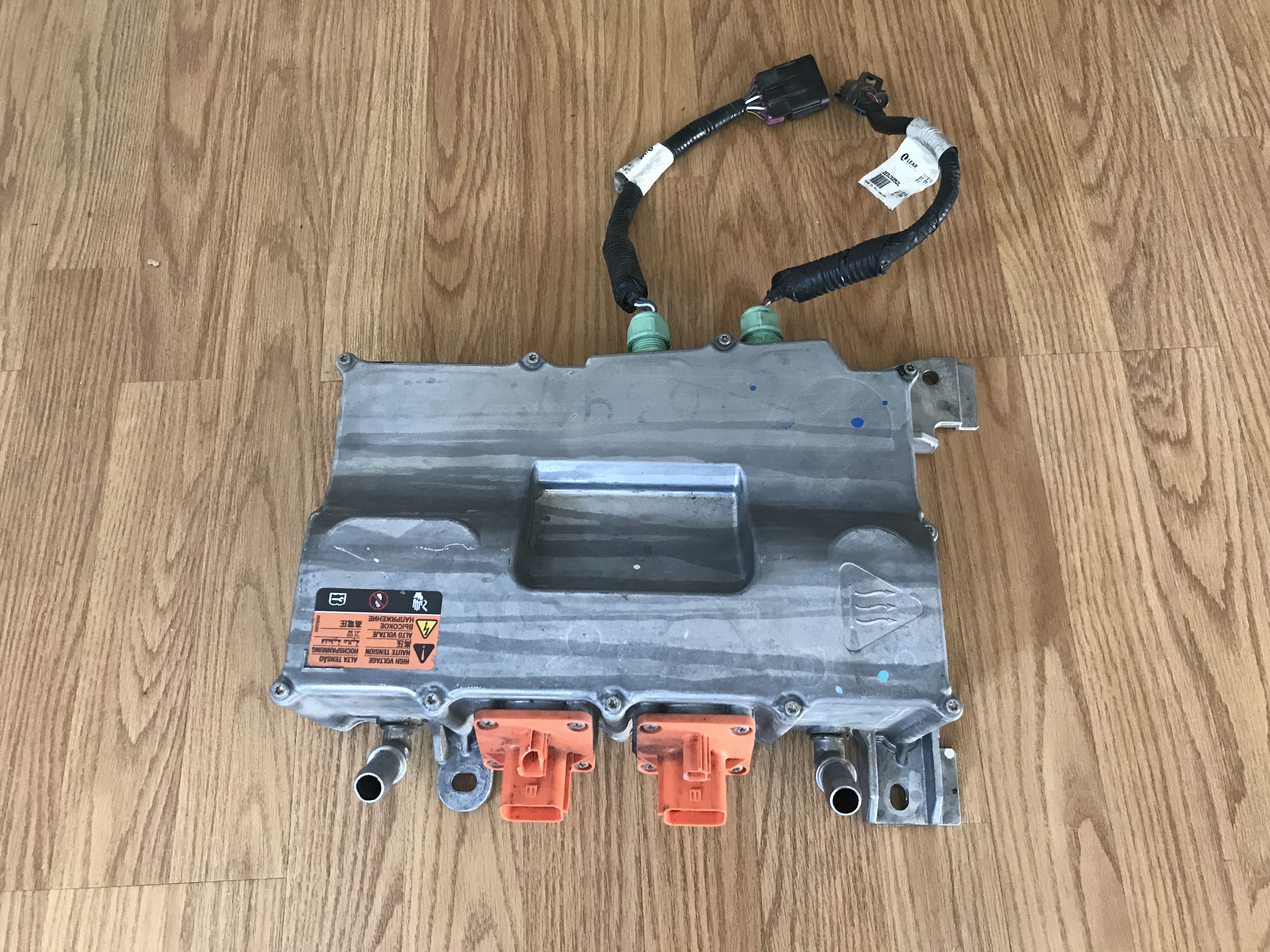

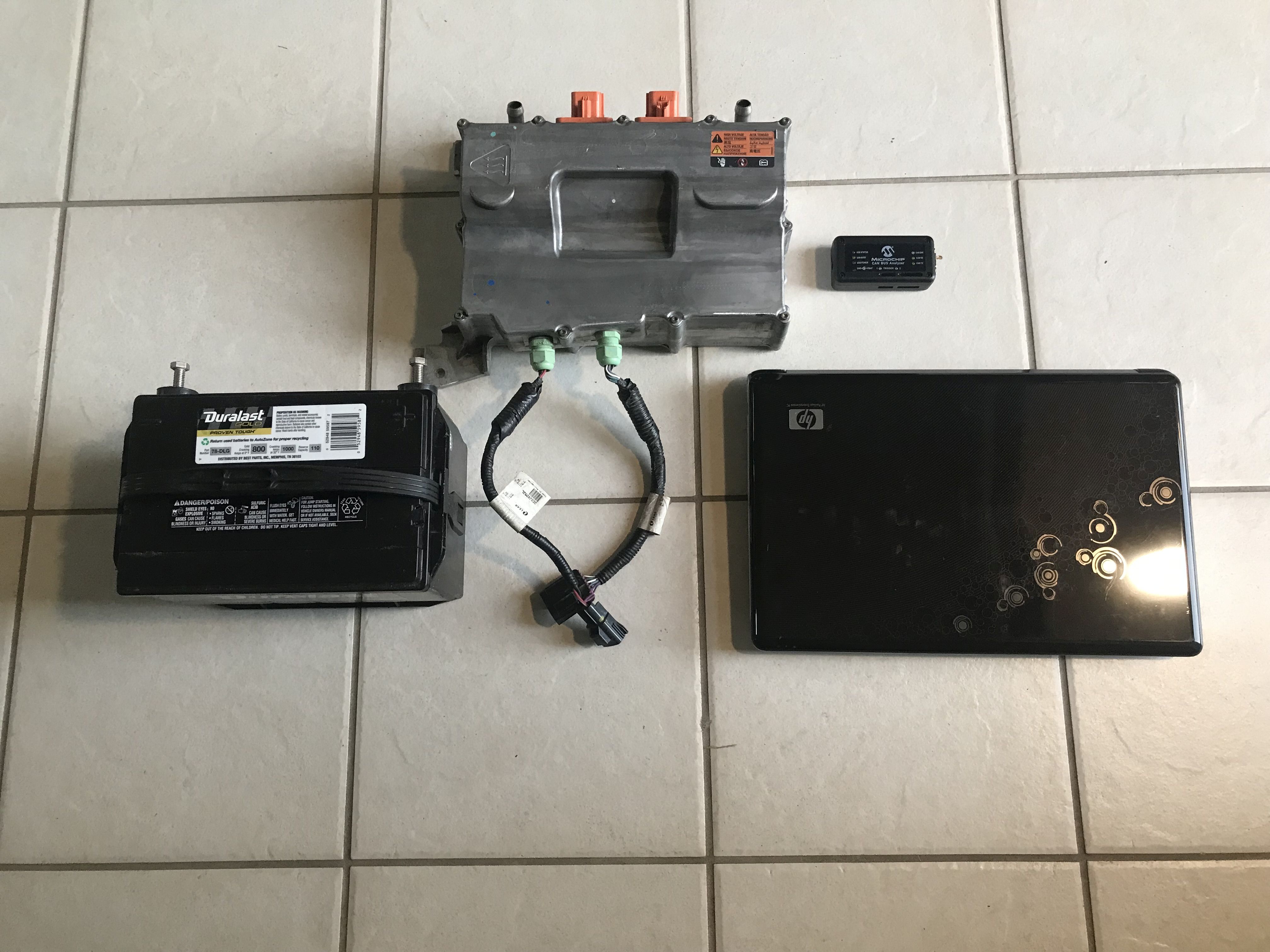

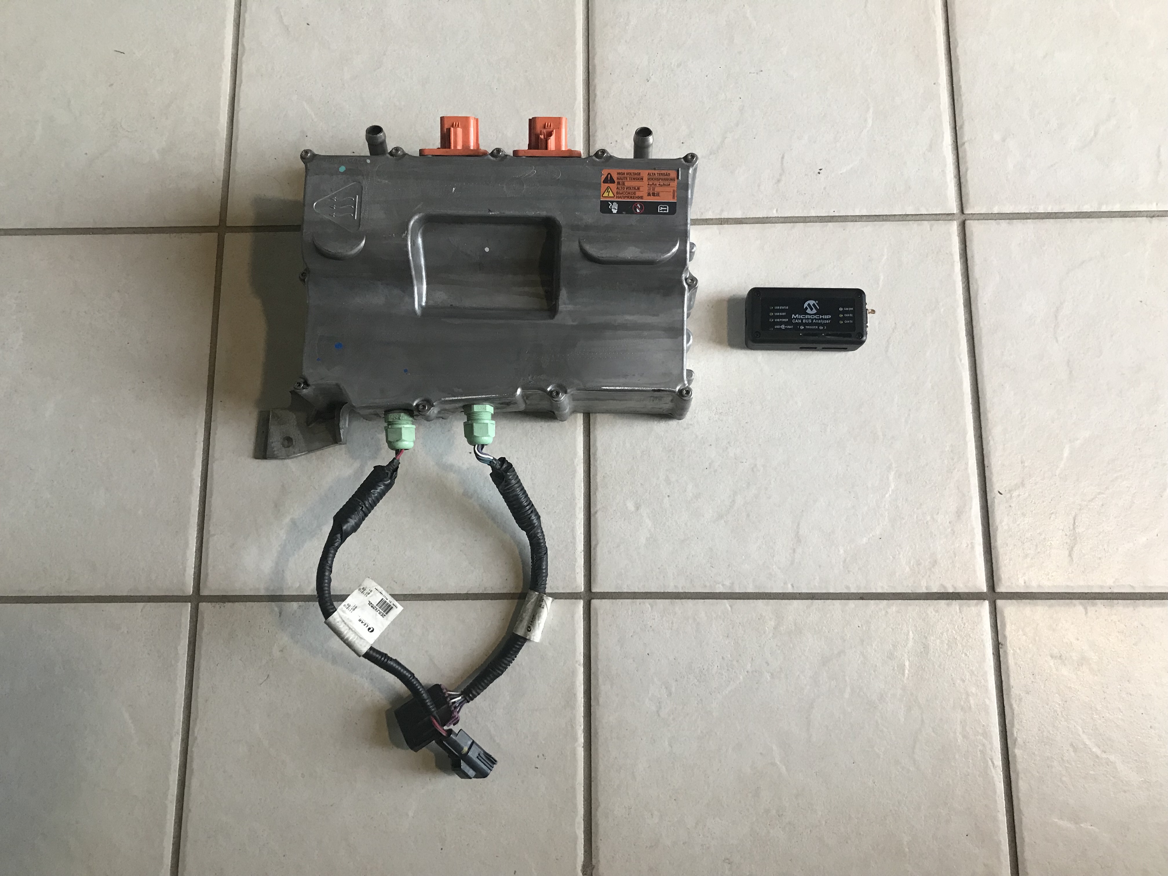

so I'm gonna cut my teeth on a Chevy Volt Gen 1 onboard charger
and a CANalyst-II pink thingie (yes I am aware of SavvyCAN but for that we need to know how to use Arduino, and yes it's easy once you know how, but I am trying to keep the complexity down so bare with me please)
and a laptop in my case running Windows 10
and a regular car battery (yes a bench power supply would make more sense, but chances are regular folk most likely don't have one of those, but they will have a car battery)
DISCLAIMER: this is a non electrical engineer tutorial, in case you were fooled

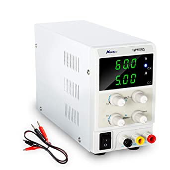

What the hewk is a bench power supply?
well it's one of these $85 dollar white boxes with knobs on it that you plug into the wall and it takes Alternating Current (AC) and through some sort of VooDoo magic pumps out Direct Current (DC) so make your electronic device which you plug into it think it is running on battery power, the beauty of such a machine is that using the knobs you decide how much voltage 0 to 60 for example on some and how much amperage 0 - 5 comes out, so instead of buying 9 volt battery you just set the dial on 9 volts, and instead of buying a 12 volt car battery you just turn the knob to 12 volts
bench power supply.jpg (11.22 KiB) Viewed 21271 times

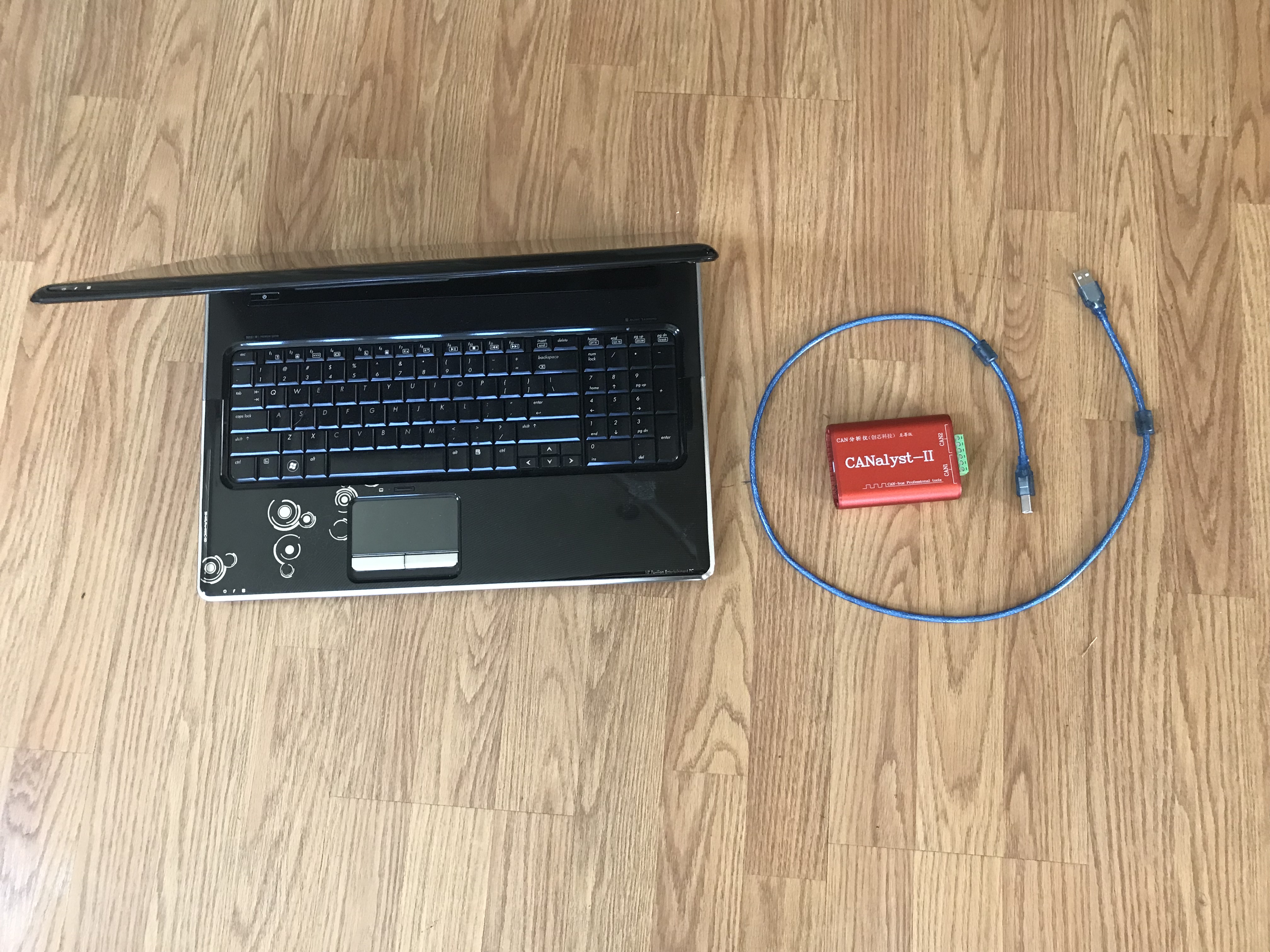

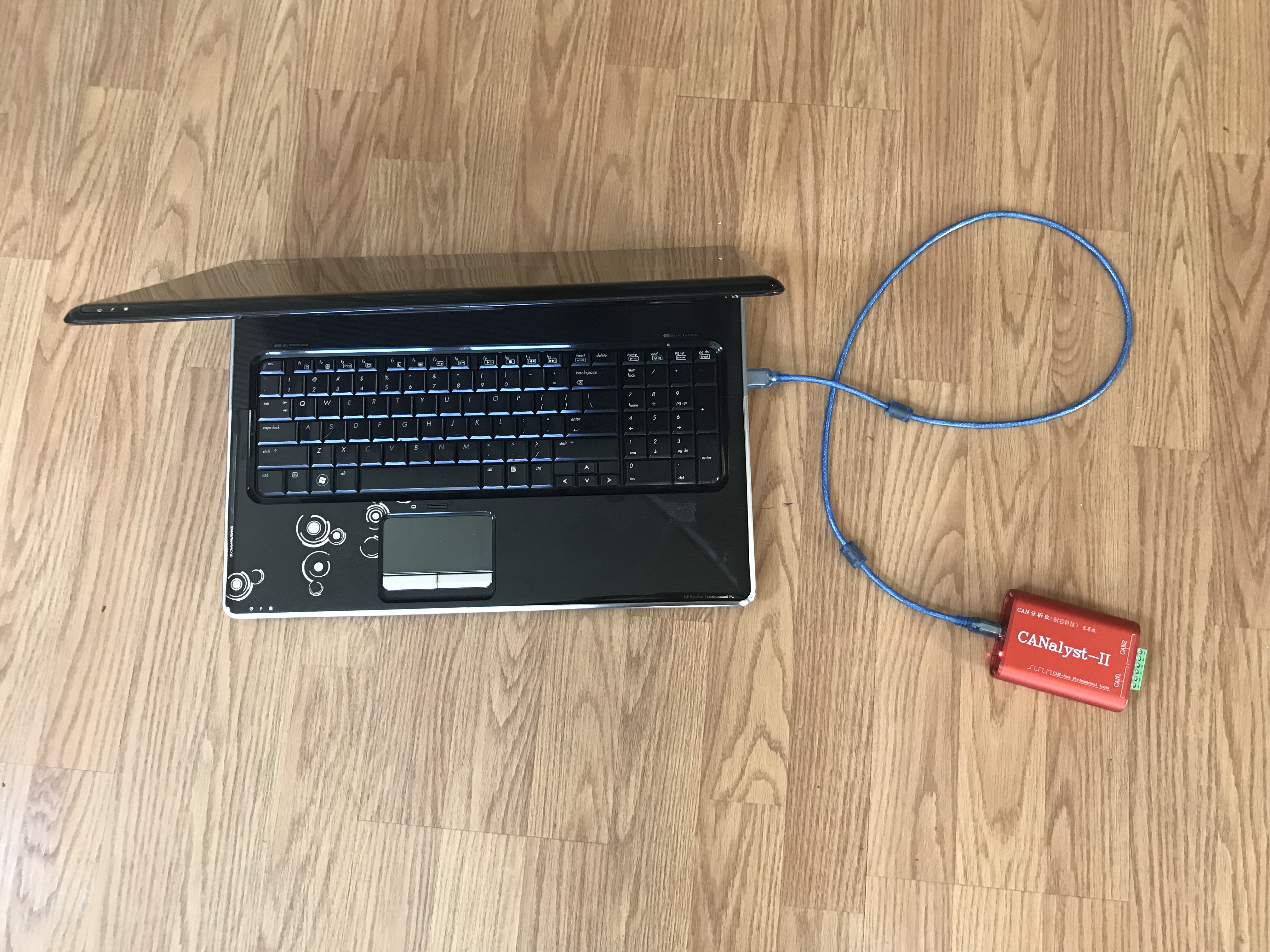

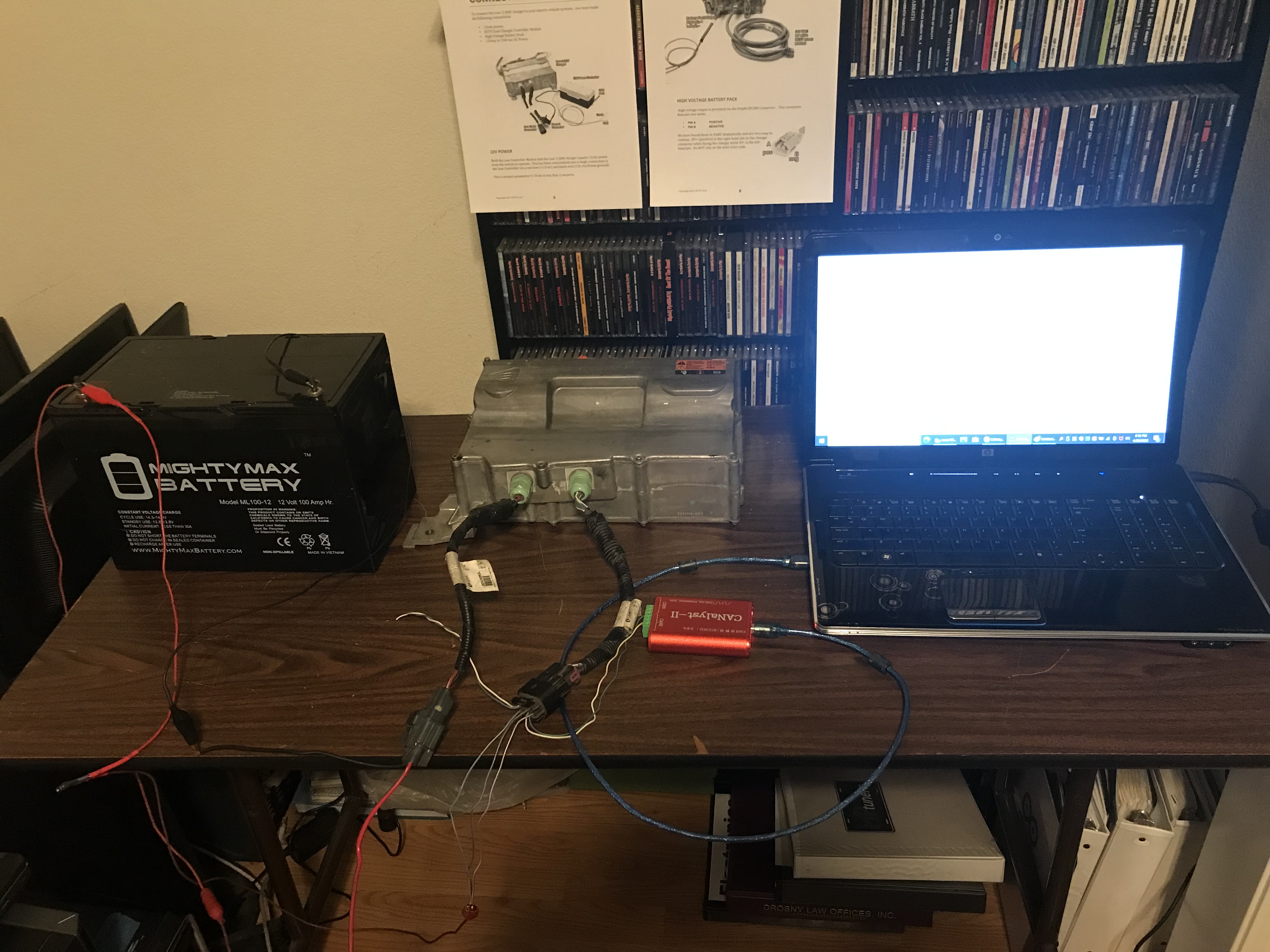

so the CANalyst-II connects to the laptop using one of them old big square plug USB cables, that comes with it (yes I am aware of Savvy CAN, but I am trying to avoid downloading Arduino IDE and chasing down libraries, and visiting GitHub, you know the drill) so the first pass is with the plug and pray out of the box solution, fingers crossed
Gregski
Posts: 3164
Has thanked: 633 times
Been thanked: 1610 times

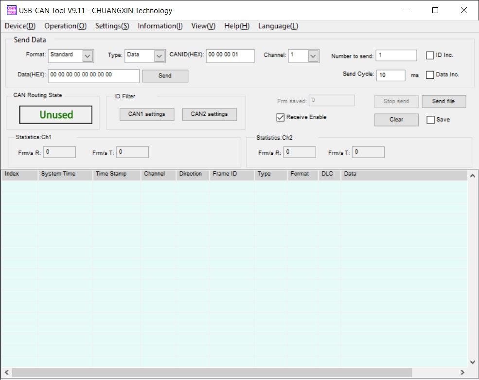

Post by Gregski »

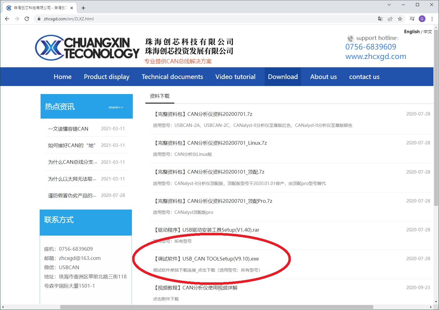

the CANalyst-II needs software, if you Google for it you can find it, download it, and install it
User Friendly Level: -2

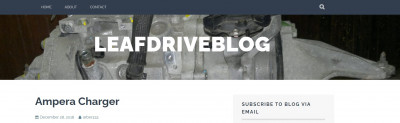

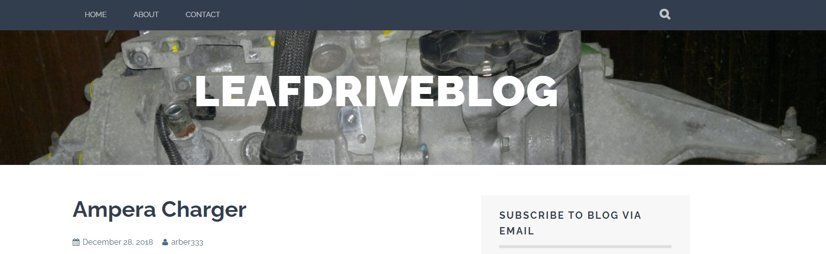

since I am using a Chevy Volt gen 1 onboard charger as my CAN controlled device (your mileage may vary) I head on over to Mr. Arber Kramar's website called LEAFDRIVEBLOG next
whoa, how did I find that?
well first we start with this forum, from the beautifully organized landing page we know we want a Chevy product so we click on Chevy/Opel/Vauxhall/PSA that takes us to the Chevy subforum where one of the top threads just happens to be Chevy Volt Gen1 Charger and the very first reply by Mr. Jack Bauer points us at https://leafdriveblog.wordpress.com/2018/12/28/ampera-charger/
Gregski
Posts: 3164
Post by Gregski »

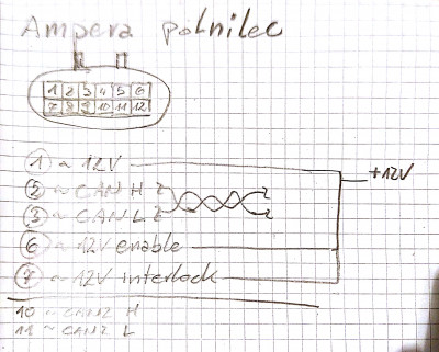

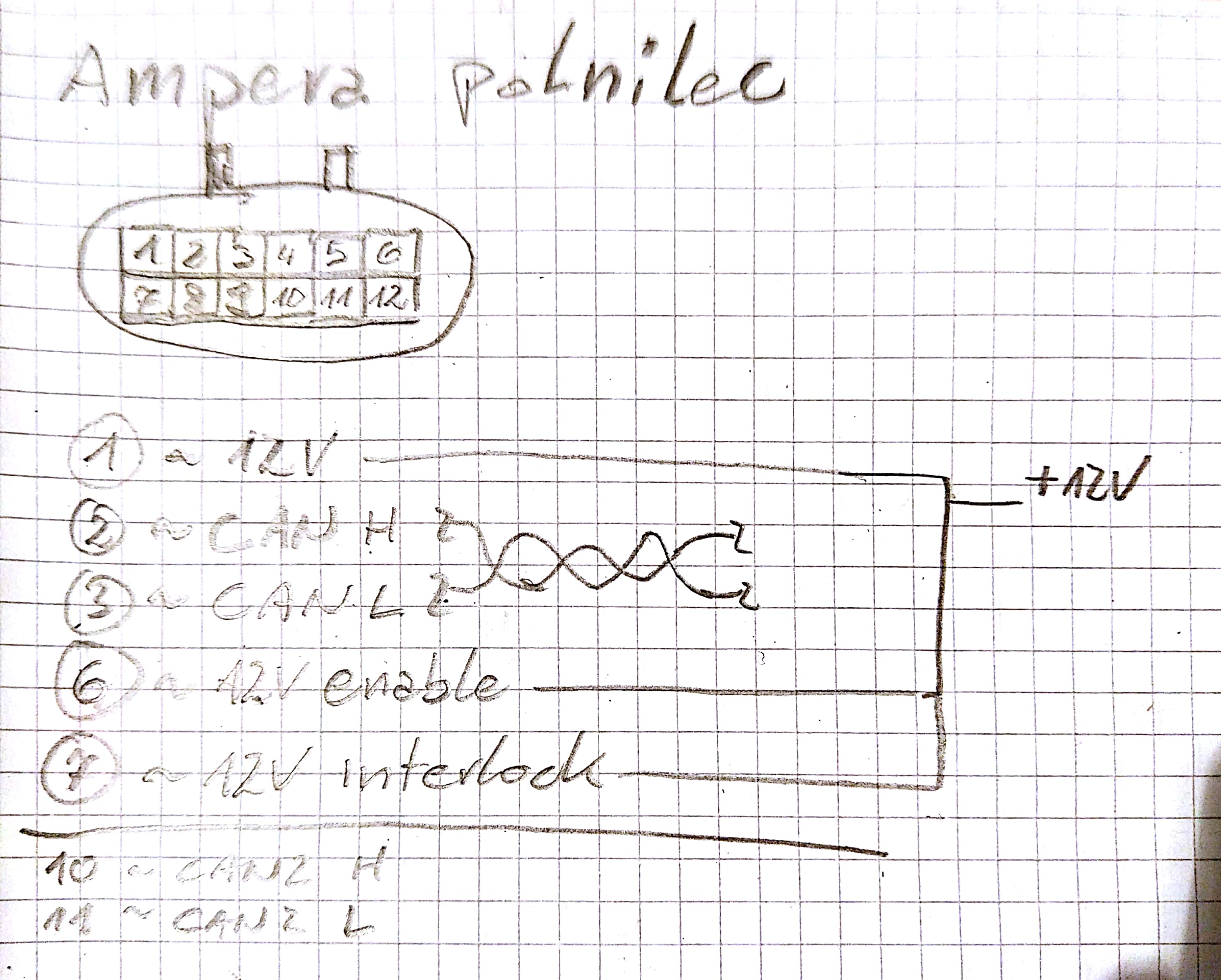

so one of the first things that we have to do is make a physical connection of what ever CAN bus scan tool we are using to what ever CAN enabled or CAN controlled apparatus we want to control or reverse engineer
at minimum there is a handful of wires to connect
1. one wire for CAN high signal
2. one wire for CAN low signal
3. usually a 12 volt constant power
4. usually a negative or ground wire
5. and usually a key on / ignition on 12 volt power
or some sort of combination of those, but the first two for sure always
for this we seek out what is called a Pinout Diagram, basically a chart or a table or a picture or a napkin with a bunch of numbered of dots representing pins of some sort of connector or a color code chart of a bunch of wires
Gregski
Posts: 3164
Post by Gregski »

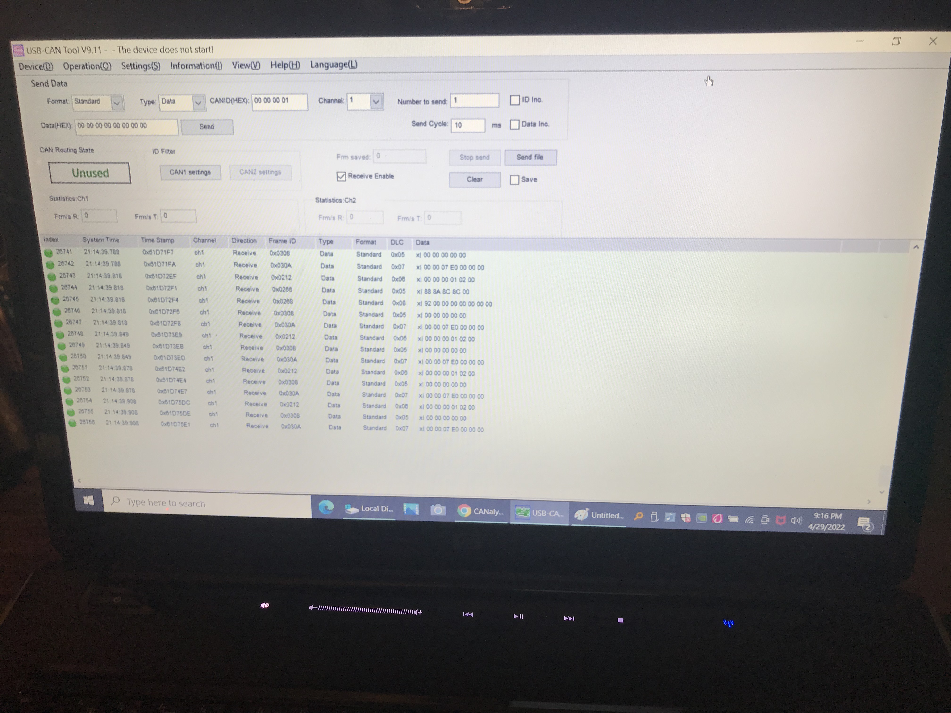

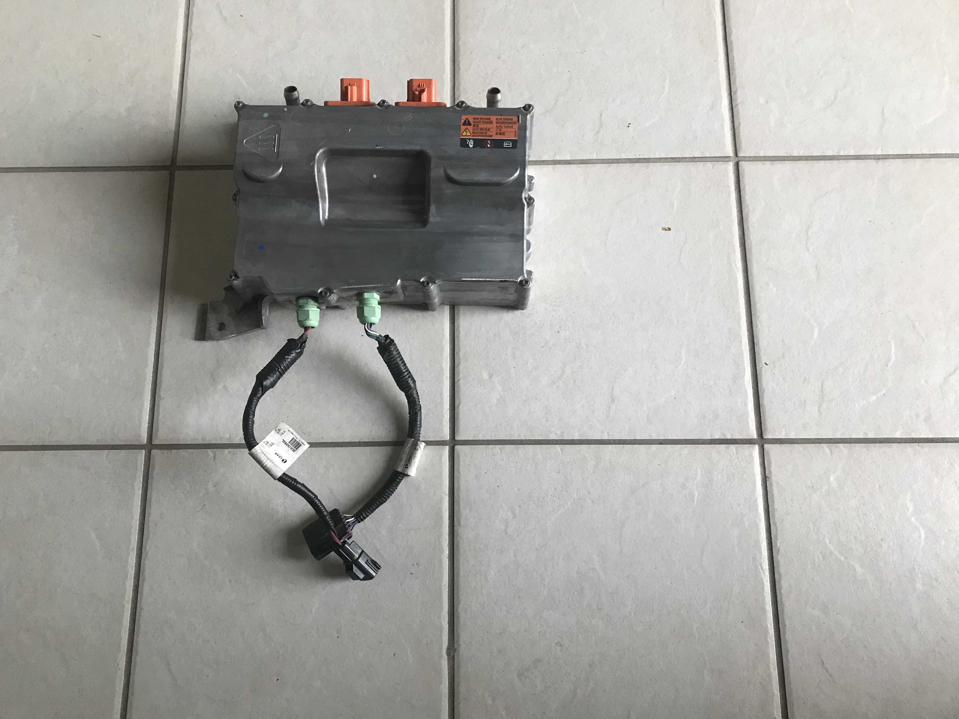

alright so here it is with the minimum wiring required to get some CAN traffic going, at this time we can READ the CAN messages flying by
so just to level set, there is no high voltage battery pack connected yet
the charger is also not plugged in to a J1772 plug connector wall charger what ever you wanna call it
yet we are already seeing CAN messages on the screen in our CANanalyst-II software

I am not saying this pink box is better than Savvy CAN by any means, and I will most likey end up using Savvy can in the end, I am just demonstrating that a Neanderthal like me could get this working using a store bought tool like this CANanalyst-II
I literally did not configure anything inside of it's software to get this to work, all I did was click on the shortcut on my desktop and it opened up and then I connected two wires to it, CAN high and CAN low, both of which are nicely labeled on the screw in terminals, I then connected three (thin) wires from the Chevy Volt Charger to the positive terminal on the battery, and the negative and positive leads to the battery on the 12 volt output side (medium thick wires)

Gregski wrote: Sat Apr 30, 2022 4:33 am so we are going to connect the high voltage AC and DC next, bearing in mind the following from Mr. Kramar
" Be aware however you can cause damage in charger if you connect it to HV while 12v is active.
So connect inert charger to HV first, then connect the AC lines and only then attach LV connector."
Well let me chime in on your nice presentation. Volt gen1 charger is one of those thingies that need a heartbeat signal transmitted along the command signal. As long as heartbeat is there charger will listen to commands as they are on my blog.
Sadly Canalyst CAN only transmitt one telegram repeatedly. Howevwe i did notice it has a script option but i havent come that far because i use Canalyst as a monitor and DUE for issuing actual commands.
Maybe for your first application Volt DCDC converter would be easier to implement. See also if you can connect some 12V light bulbs to have an indication when you get DCDC to 14V :).
Gregski
Posts: 3164
Post by Gregski »
arber333 wrote: Sat Apr 30, 2022 6:21 amWell let me chime in on your nice presentation.
Yes, please do, always!
arber333 wrote: Sat Apr 30, 2022 6:21 amVolt gen1 charger is one of those thingies that need a heartbeat signal transmitted along the command signal. As long as heartbeat is there charger will listen to commands as they are on my blog.
Ah, thank you just learned something
arber333 wrote: Sat Apr 30, 2022 6:21 amSadly Canalyst CAN only transmitt one telegram repeatedly. However i did notice it has a script option but i haven't come that far because i use Canalyst as a monitor and DUE for issuing actual commands.
that is EXACTLY what I wanted to and needed to hear, as I could not make out how in the world I would send commands via CANalyst-II and how you were doing it on your website, another lesson learned
arber333 wrote: Sat Apr 30, 2022 6:21 amMaybe for your first application Volt DCDC converter would be easier to implement. See also if you can connect some 12V light bulbs to have an indication when you get DCDC to 14V :).
it may come to that, but stubbornly I must [ahem] charge on
again 1,000 thanks for chiming in, you or anyone else are more than welcome to sprinkle in as much knowledge as you can spare

alright, let's see what this MICROCHIP can do, it's black so it's gotta be good
Gregski
Posts: 3164
Post by Gregski »
same concept here, just a bit less arcane USB cable
