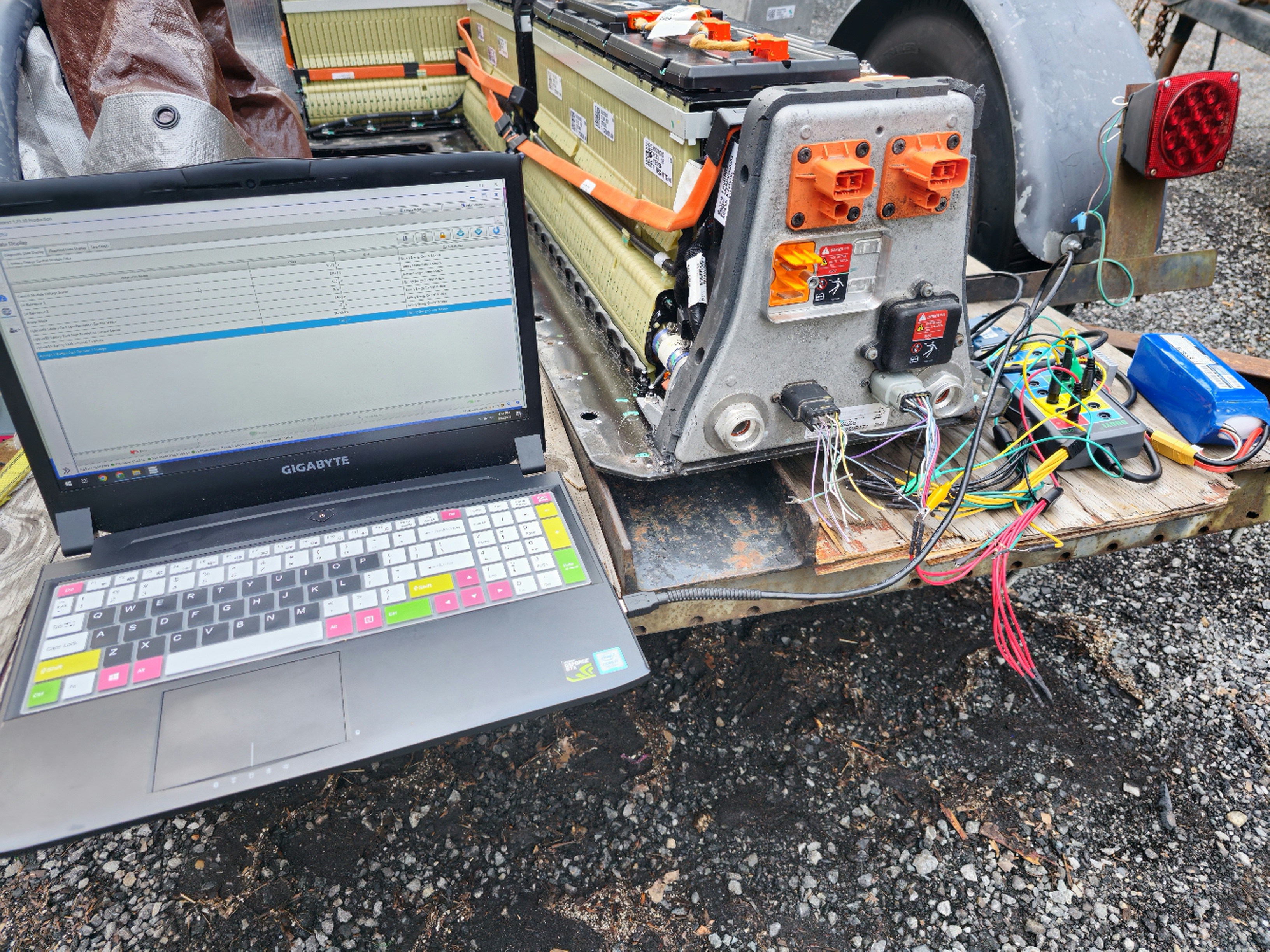

Post by brianbri6 »
You need to externally power the becm and connect to the HS CANBUS with GDS2 it will read the Voltages.

Post by KimchiKimKim »
brianbri6 wrote: Sat Sep 02, 2023 2:32 pm You need to externally power the becm and connect to the HS CANBUS with GDS2 it will read the Voltages.20230809_104729.jpg
How did you get GDS2? I didn't think you could get it without being a service center.

Resistance measurement would be good,if you have the some base data to compare it to and HV DC resistance tester
But other than that, custom hardware + software + inverter,
then a good old cycle test to see the remaining capacity on pack level, while checking cell voltages, as seen above, some bit of wiring and stuff.
