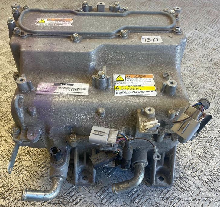

Hi, has anyone taken a 3D scan of the Outlander front transaxle and inverter? Just wondering, before I build basic CAD models to package my Panda.

I've FINALLY got my Outlander front motor and gears turning so getting close to cutting metal...
My plan is to take out the Panda engine and transmission and put in the complete Outlander front transaxle. Not sure yet if I will remove the generator from this lump and make a blanking plate for it, but it is not that simple. It may help the weight distribution after putting 88kg of BMW battery in the boot.

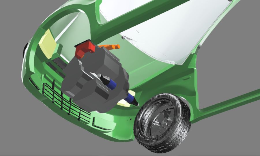

Interesting, thanks. I've built a simple transaxle model in 360 and found a Panda CAD model and it looks like it fits... Just about. Not much room for the inverter - my next challenge.
I'll share the model when I've checked a few more measurements on it.
I think I can achieve equal length driveshafts although I need to put some structure in the vehicle CAD model (I'm not yet ready to take the engine out and try it for real). Does anyone have advice on acceptable drive shaft angle range at rest position? I'm trading off height above the transaxle for the inverter, ground clearance and driveshaft angle. Thanks.

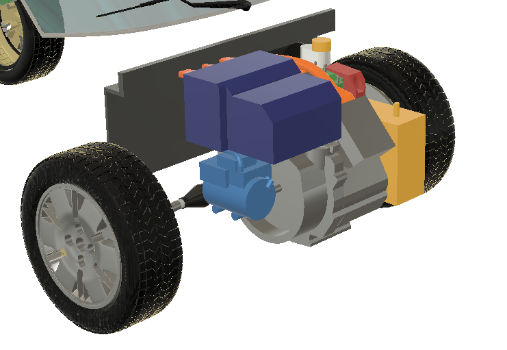

Wasn't so easy to make it all fit. The Panda brake booster is rather large and the pipes around the master cylinder are all over the place, which I don't want to touch, but I think I've got it all in. Equal length driveshafts don't seem possible. I might need to extend the inverter<>power cables. I really wanted the DC-DC / Charger in there as well, which is a bit of a squeeze.
I've attached the Fusion 360 models of the Outlander parts if they are any use to anyone.
