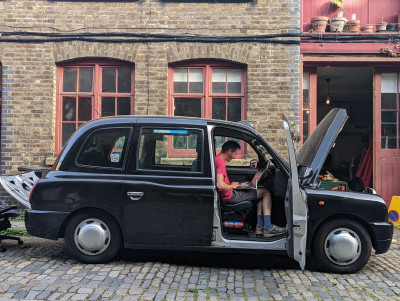

For 3 weeks in June I was travelling around the UK to help folks at clipper automotive implementing rapid charging on their awesome electric black cabs. Stayed in a nice private room and biked to work every morning through Burgess park. After 1 week we had CHAdeMO implemented. The week after that we drove around London trying various fast charging stations.
When charging at Ikea a guy with a Nissan Leaf also just arrived and I explained to him what we were doing. "Are you Johannes?" we asked. I was puzzled. Turned out to be forum member aot93 :) To help curing our issues with CHAdeMO he even ripped open his Leafs wire harness so that we could take a log of an "official" CAN bus session. Great!

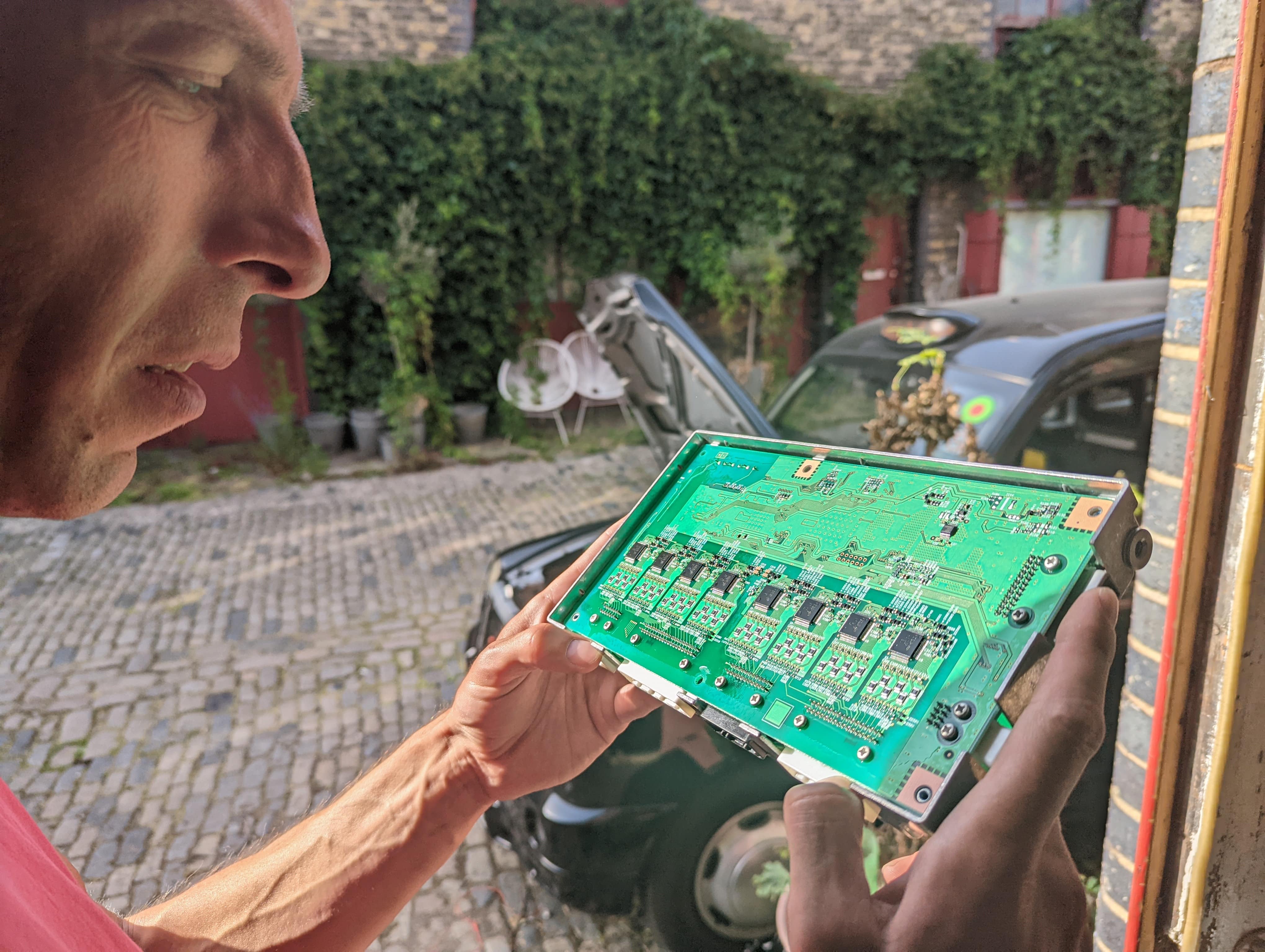

After some charging we decided to start towards Fishguard (that's were the Ireland ferry leaves) on Thursday. Due to a silly mistake we had welded contactors the day before and in the morning I set about freeing them with a hammer. Now the clipper battery boxes with 1/2 pack each are wired up to split the pack up to 1/4 when the safety disconnects are pulled. That sounds pretty sane at first because you're down to like 100V maximum. But the Leaf BMS doesn't expect there to be a continuity break so guess what happens if current wants to flow while the disconnects are out... Yes crackling sounds and a very wounded PCB.
So we put in the only remaining BMS only to find it not working as well. Already thought about booking trains to get to Ireland but then I found just one resistor between adjacent chips had blown - for whatever reason. Replaced it and were back in the game.
