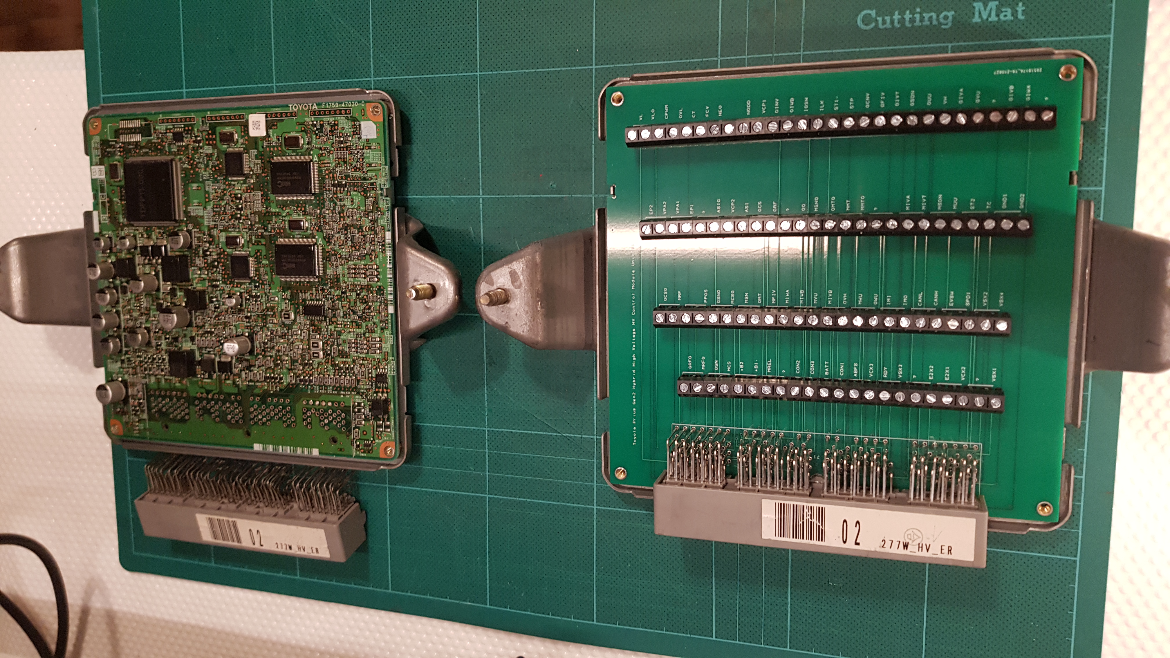

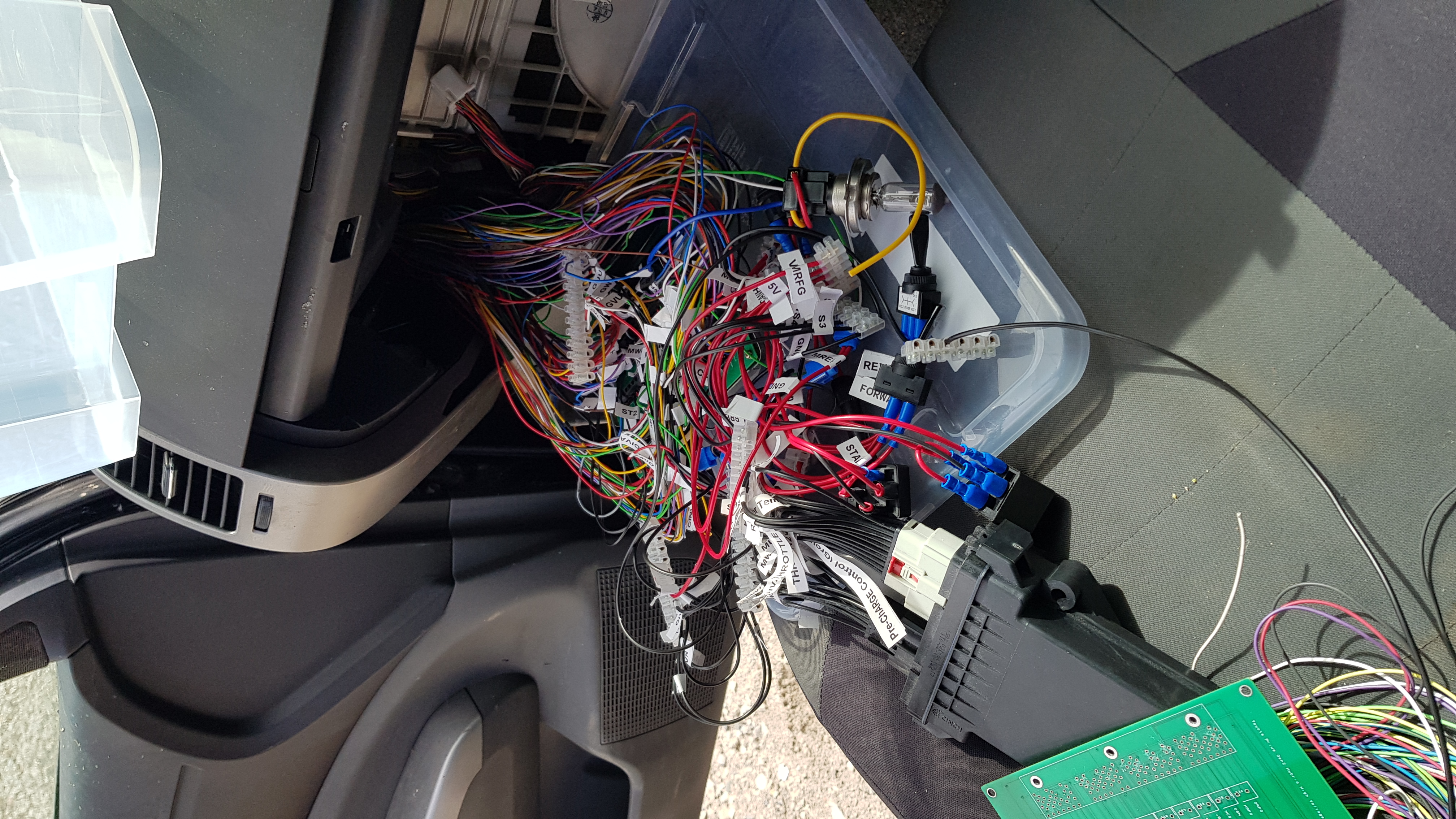

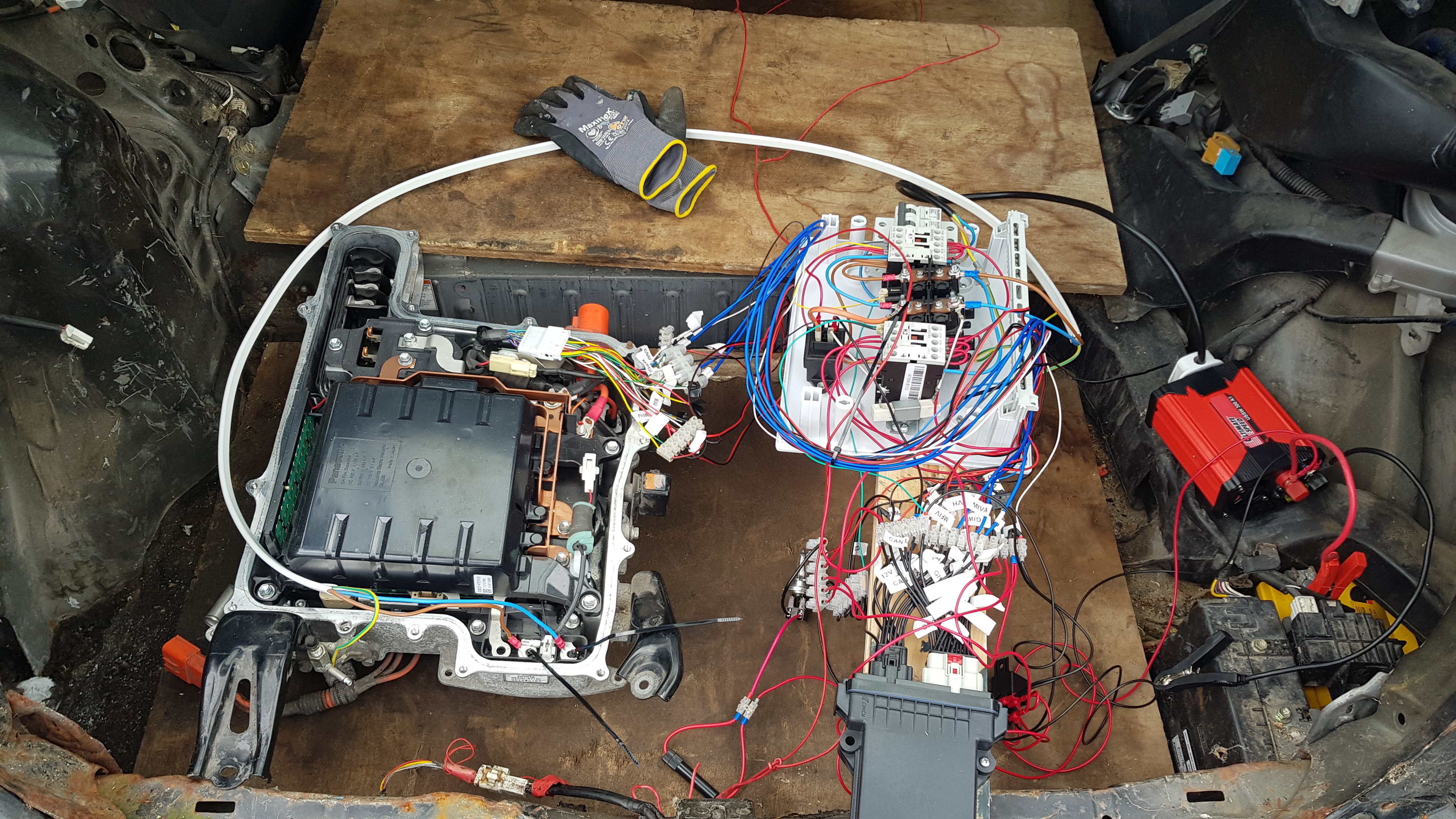

Prius gen2 have all the connections needed to run it located behind the glove compartment (Hybrid Vehicle Control ECU and Engine Control Module).
I've designed a board that fits in the original Hybrid Vehicle Control ECU case and create a man in the middle setup for connecting for example the Toyota Prius™ Gen2 inverter controller - community edition https://openinverter.org/shop/index.php ... duct_id=63.
Please note that there is a few issues on the current board design (see issues in in github link below)
For more info see wiki in github link below.
https://github.com/hakanrolsson/PriusHVConnector
I have boards available if someone want one.

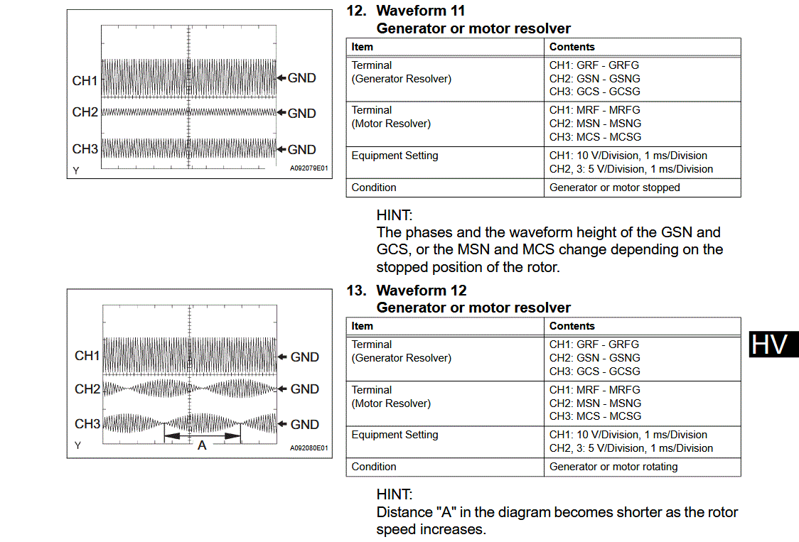

20220814 Connected encoder from MG2 to openinverter (MRF,MRFG,FMCS,MCSG,MSN and MSNG). Connected MCS,MCSG,MSN,MSNG from OEM Hybrid Vehicle Control ECU to GCS,GCSG,GSN,GSNG (MRF,MRFG left disconnected). Switched to FOC software. See angel plot in post below.

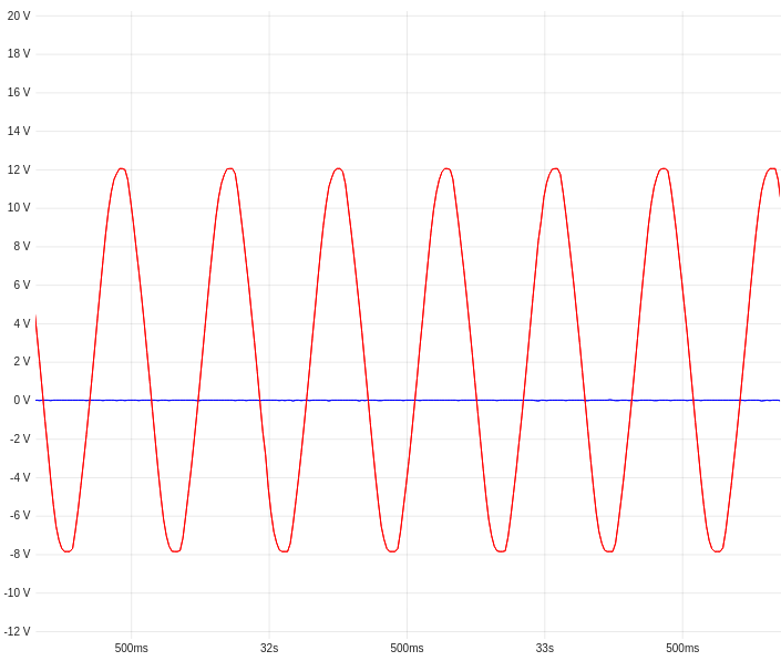

Got MG2 to work in reverse. In drive the OEM controller trips and opens the contactors.
Getting Code P0A78 probably because I have MIVA,MIVB,MIWA and MIVB but not MUU, MVU, MWU, GUU, GVU and GWU connected to the OEM controller.
Without MIVA,MIVB,MIWA and MIVB connected to the OEM controller it will not close the contactors.

Would be interested in your syncoffs value amongst your other parameters. Good job

Hmm, no Idea why the OEM ECU is opening the contactors when I try to FOC tune... When moved GVIA, GVIB, MVIA, MVIB, GWIA, GWIB, MWIA, MWIB from OEM ECU connecied to GViB and GWIB I don't see any "power transfer" on the screen any more also no voltage on GViB and GWIB from controller. no codes more then P0A87 (MUU, MVU and MWU disconnected), P0A7A (GUU, GVU and GWU disconnected) and U0100 (Engine ECU disconnected).
I'll hook up the computer and capure some CAN logs next time to see what's up.

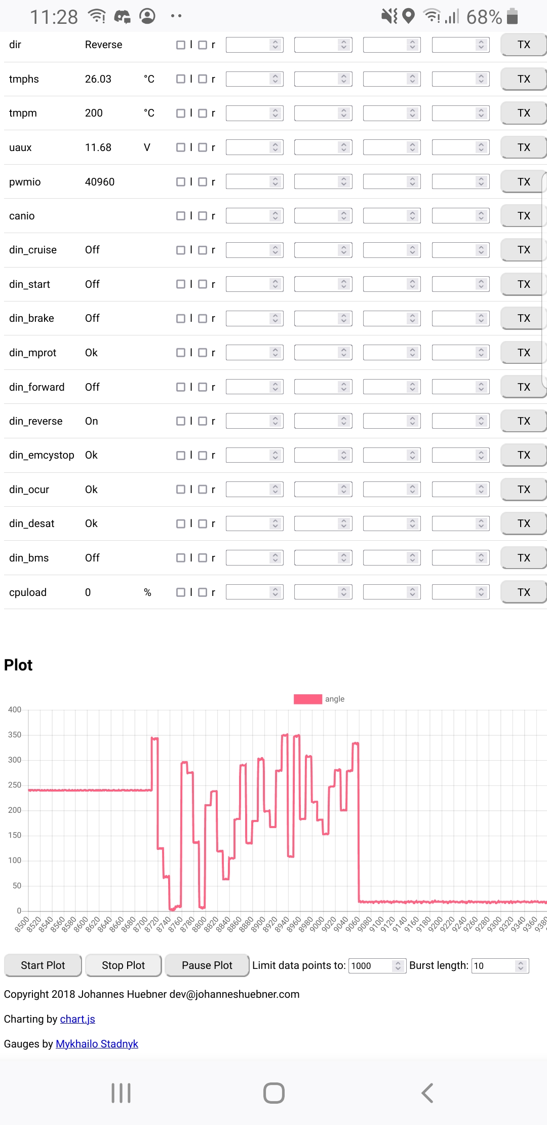

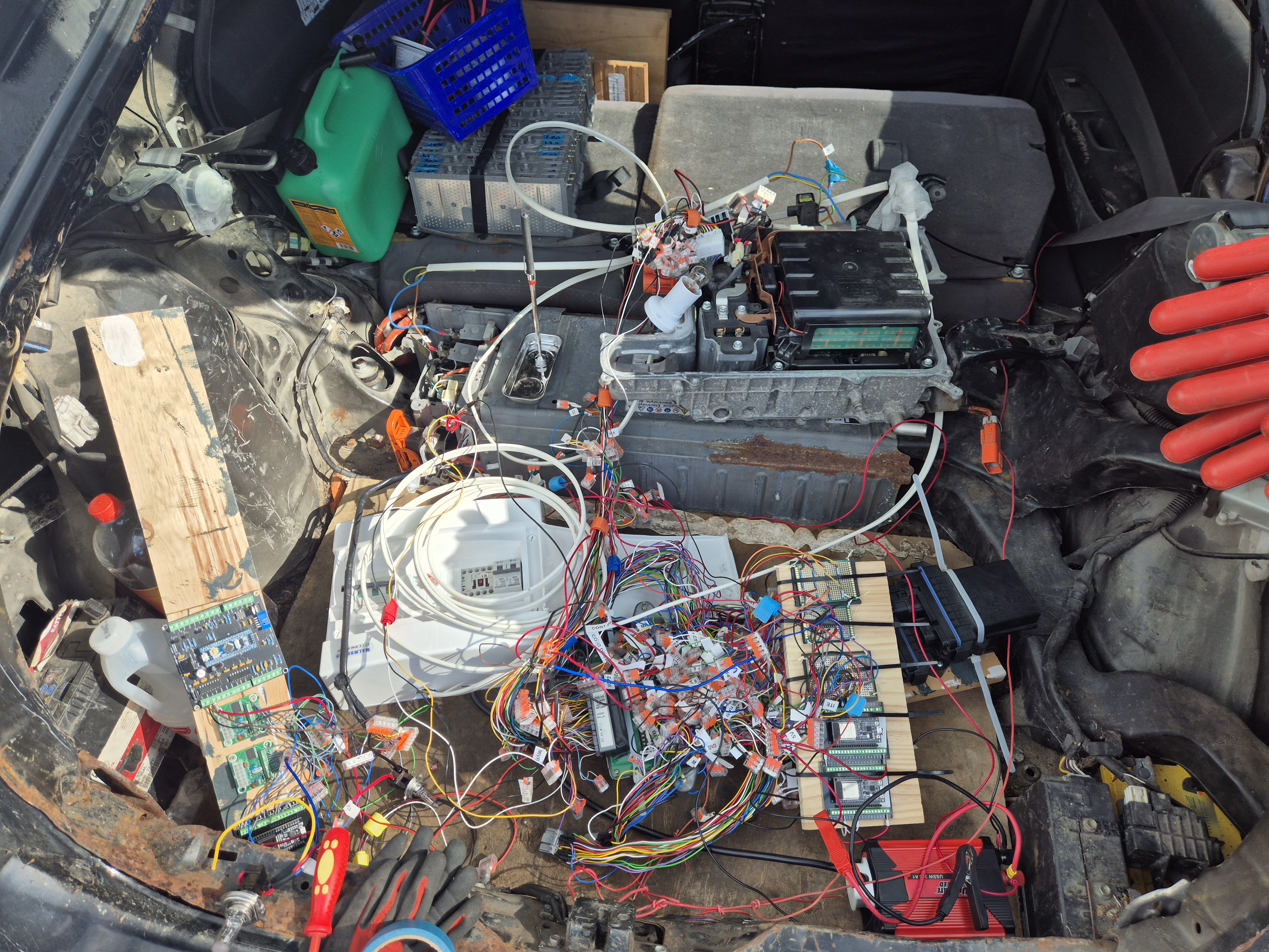

Getting DESAT error when trying to do FOC tuning (probably the same error as before). I now have access to Techstream to trouble shoot.
I've started work on setting up SOC spoofing etc. to keep the OEM ECU's happy.

I have found all the issues and fixed them on back of the board with extra wires (also documented in github with bug reports).
I was able to run in reverse with openinverter VCU in manual mode with stm32_sine (see post above)
Currently trying to figure out how to spoof the inverter input/output to keep the OEM CPU happy.
I'm using the work of Electric Auto Association - Plug in Hybrid Electric Vehicle http://www.eaa-phev.org/wiki/Prius_PHEV ... #CAN_Tools and Attila Vass to identify CAN bus frames.
pm me your address and I can send you a board.

After spending time trying to keep the OEM HV ECU's happy I decided to cut it out of the loop for now. I now have wheels spinning in FOC with accelerator pedal. Still some tuning to do. Next need to figure out charging. I really like the idea of using the controller and as charger too like @johu and @RetroZero but I want to keep my AC control and I need to bypass the boost converter when I get a bigger battery.

First drive with openinverter, I'm running with @Johu parameters download/file.php?id=19655 viewtopic.php?p=48233#p48233 (only changes voltages lowered and wired accelerator pedal) and firmware download/file.php?id=19972 viewtopic.php?t=2809 I'll update the wring in the github wiki https://github.com/hakanrolsson/PriusHVConnector/wiki for the board.

My 12v safety bulb caused the desat.
Using 330w 1A Inverter to create 240V AC gives me 260V DC on buzz bars bucked to 160V DC
Next:connect a heater element and "real" 240V AC.

Built a 2nd more configurable board using ferrules and Wago connectors. Got 12V DCDC converter working (just disconnected NOOD from Hybrid Vehicle Control ECU). Car now has a backseat and an exhaust again.

Made a fork of Johannes stm32-car and created a prius-gen2 based on the audi-a2 branch (https://github.com/hakanrolsson/stm32-c ... prius-gen2) that reads can message 0x540 (shift leaver position) and set drivesel.
