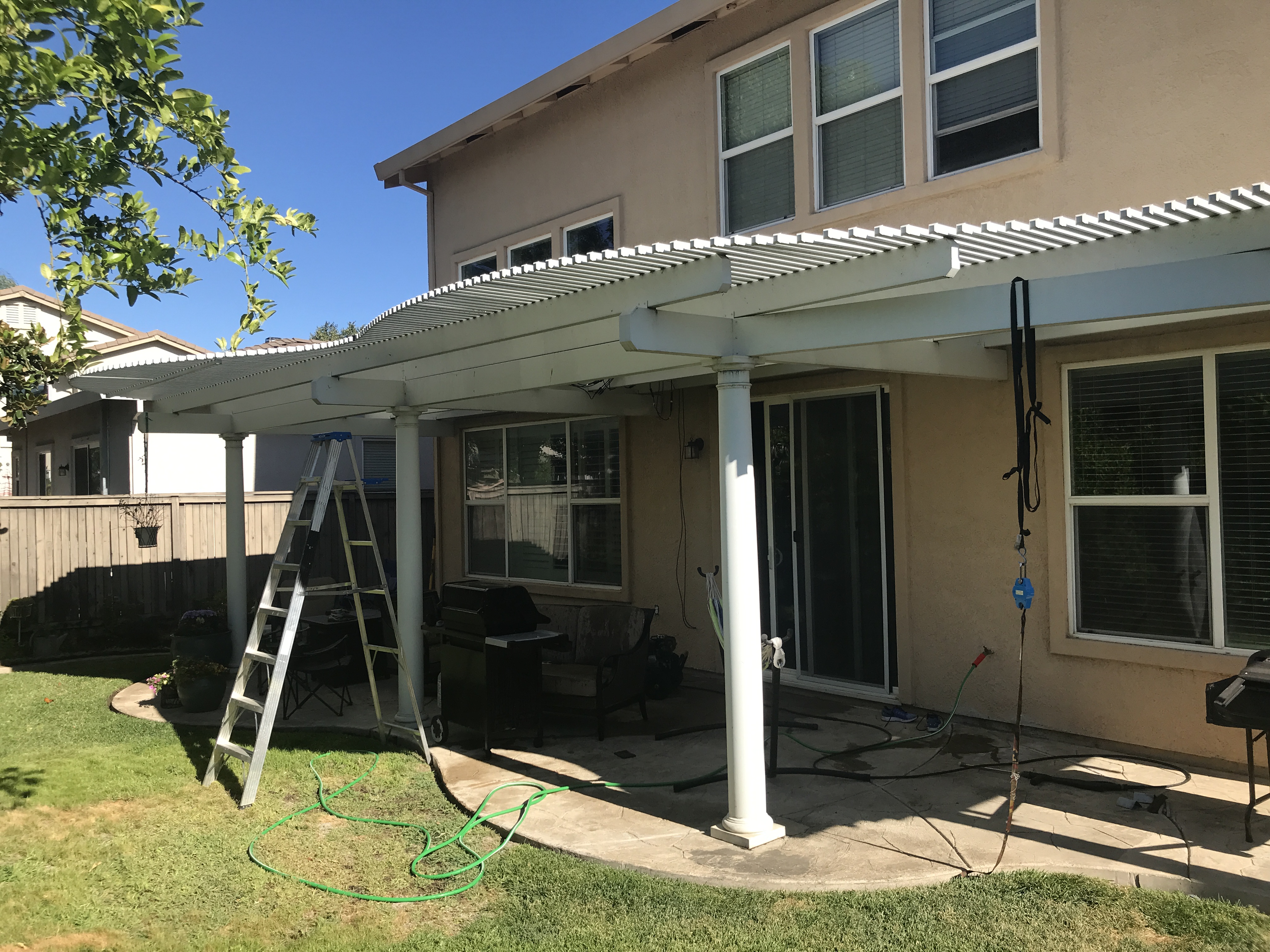

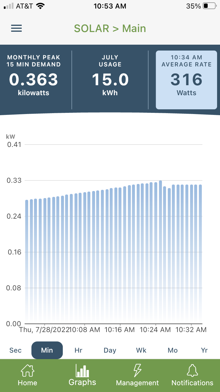

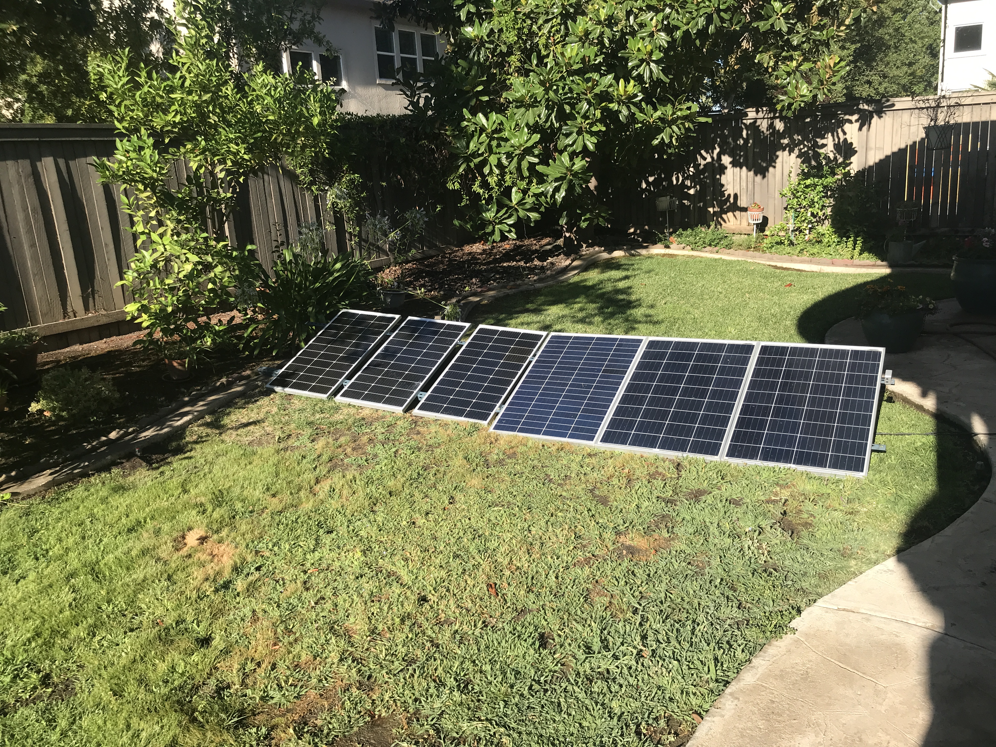

so I am learning about solar panelism, figure it goes hand in hand with EV conversions right? and so here I am in July in California going why are my 100 watt (12 volt) solar panels only "producing" max at 60% efficiency if you will, for example my six 100 watt solar panels only get up to 363 watts, yes we are assuming optimal angle to the sun, unobstructive line of sight, etc well then I see this ladies video where she brings up things like Standard Test Conditions aka STC 25°C / 77°F can you say mind blown!!! here I thought the months of July and August when the temps get upwards of 100°F would be my best production months, and now I am realizing that may not be the case, who knew? I welcome any of your comments and feedback and as always please be gentle I'm learning here
this was just a pic for demonstration purposes, the panels have been moved to a new location since

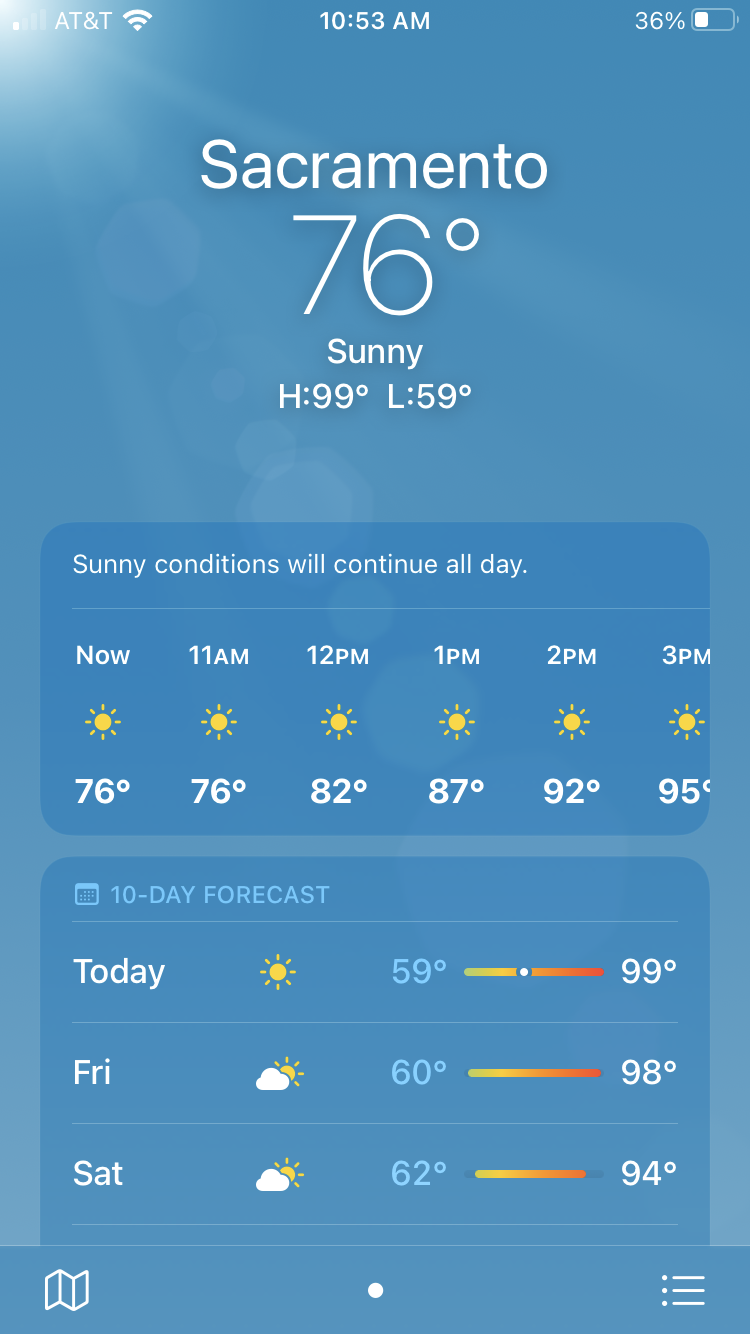

Re: Newb Asks: Does heat effect solar power generation?
well the temp at the minute is near perfect 76°F yet my powerism suction sucks, I'm capturing 316 watts and it should be closer to 600

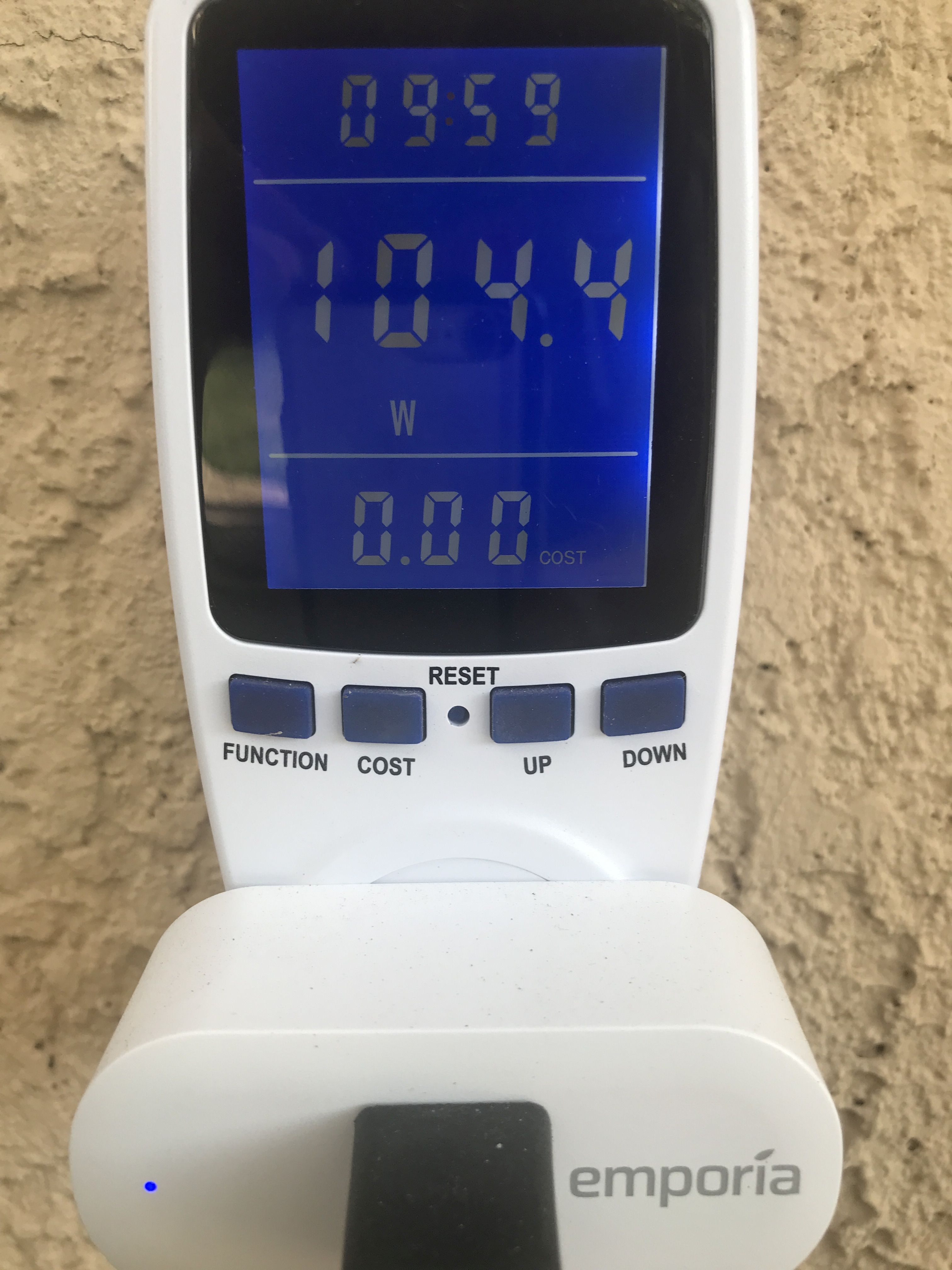

I hear you but 7500W divided by 8450W still gives you 89% efficiency max whilst mine only do 60%, so I will try replacing my 12 volt inverter with the same kind just rated at 24 volts and connect my panels in pairs ie series to yield 24 volt strands, and see if things run more efficiently, fingers crossed

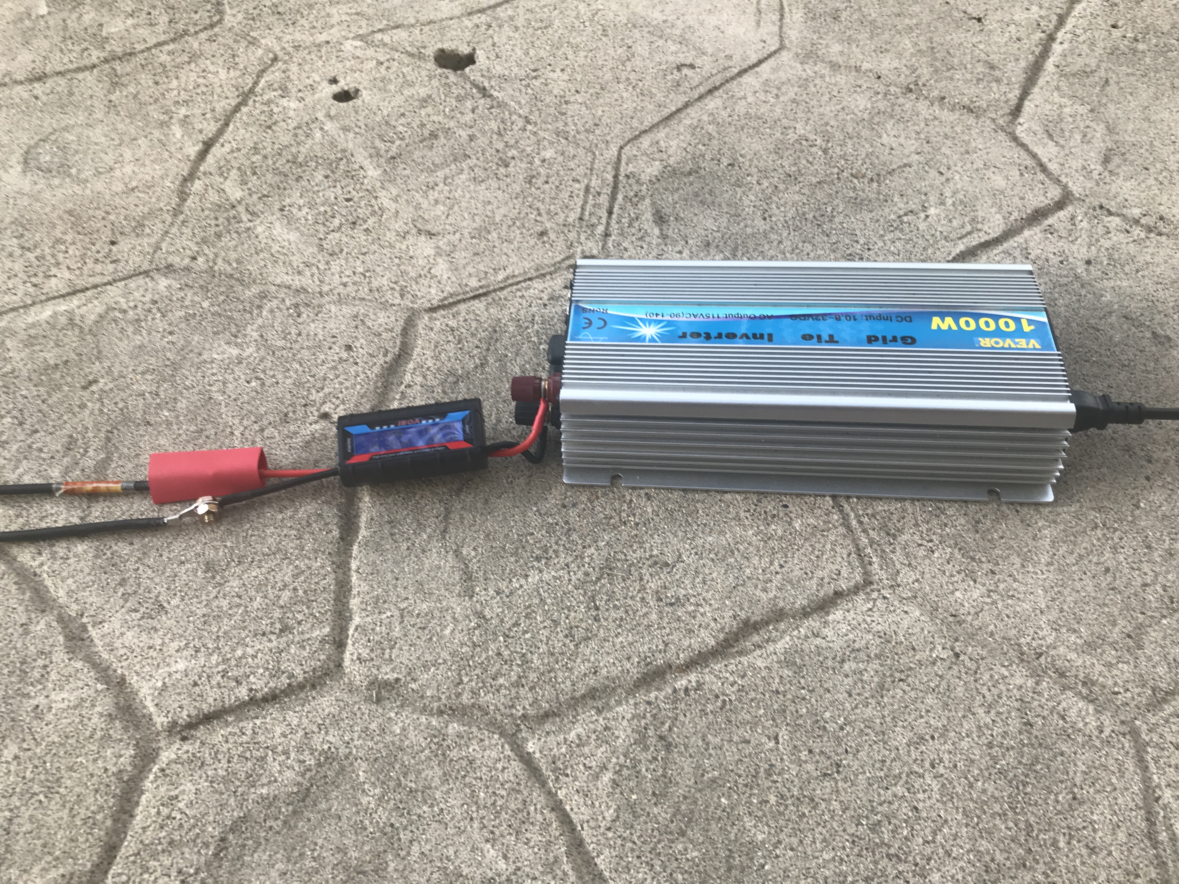

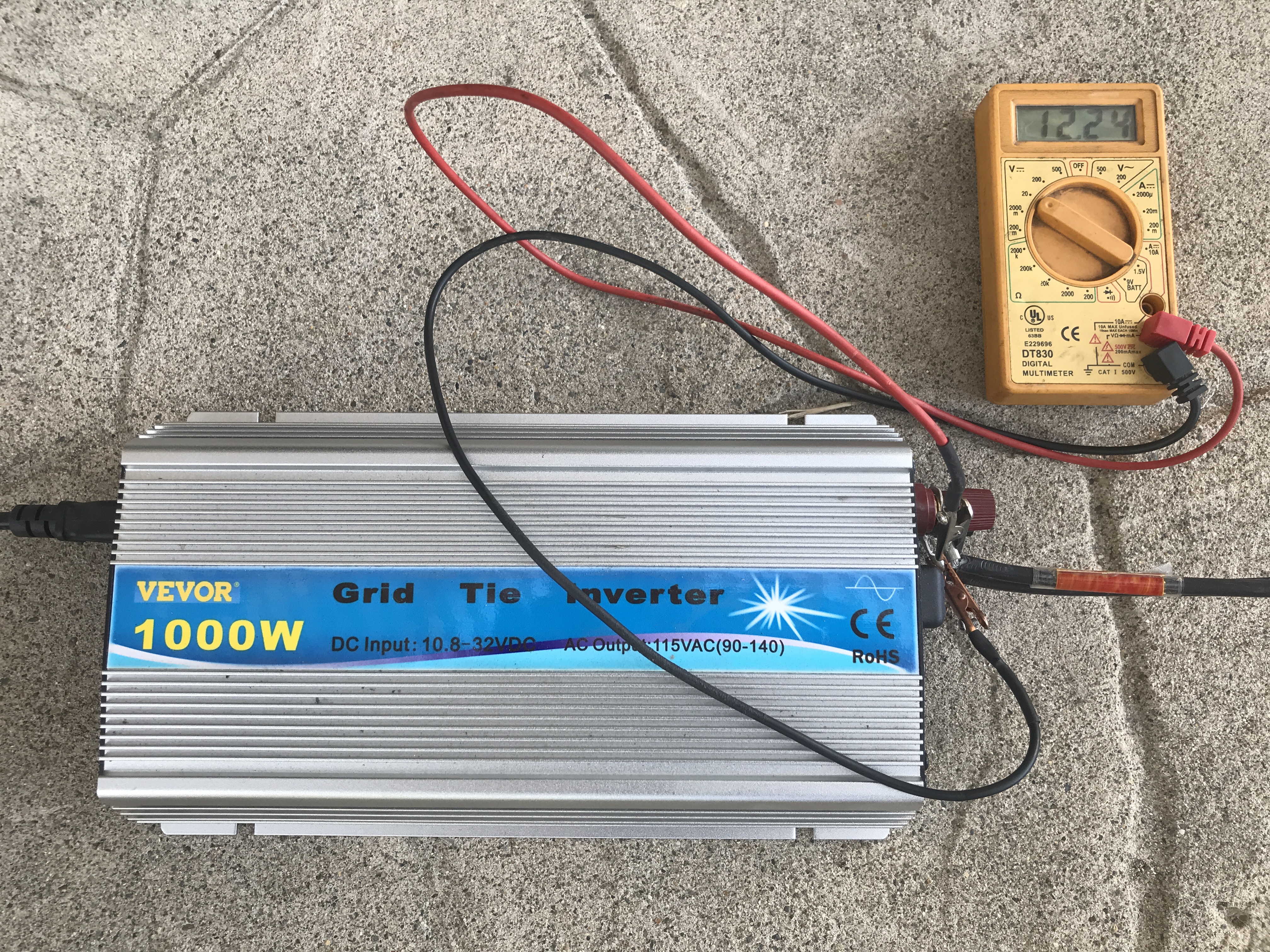

this is my current cheap Grid Tie Inverter off of AMAZON
these are great because no batteries required you just plug this thing into the wall

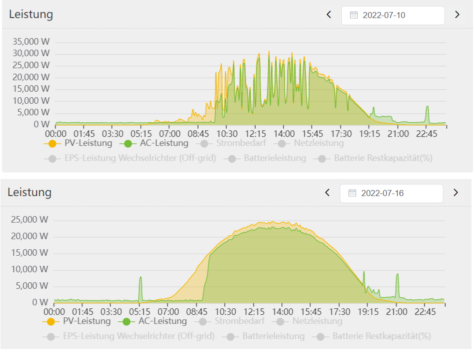

These are two pictures of my 32,760kWp system. The first is a day with passing clouds. The individual DC peaks reach 31.4kW. The second is a hot, sunny day. The maximum value is at 24.5kW

It's not "efficiency" - being a Youtube superstar, you need to stop using that term.
Your problem, based on your photo, is shadows. You cannot have ANY, or the entire array collapses in power generation trying to cook the dark photovoltaics.
NO SHADE. Not a SPECK, or production goes to poop.
Same goes for that hodgepodge of different modules you've connected in series...nope - can't do that either. All photovoltaic cells in a series string (which includes other modules) need to be matched, not those four or five solar module variants you picked up at Goodwill (a store in the US that resells items to the poor that people discard). The bigger cells will cook the smaller ones instead of giving their power to Cheap Charlie Human.
Friends don't let software friends do hardware design

so just to clarify all my panels are connected in parallel not in series, and here are three identical 100 watt panels, same make and model, part number, specs underperforming, they should be drawing closer to 300 watts than they are to 100 watts total

Might be worth mentioning that the cheap grid tie inverter will piss away another 20% in heat losses and poor mpp tracking. I compared mine to the more expensive Enecsys module inverter and remember a rather significant difference between the two.

thank you I was afraid of that, do you think bumping up to the 24v model of the same manufacturer's inverter would improve efficiency? the one I am using is only 12 volts

Won't help much, I've got the 24V model

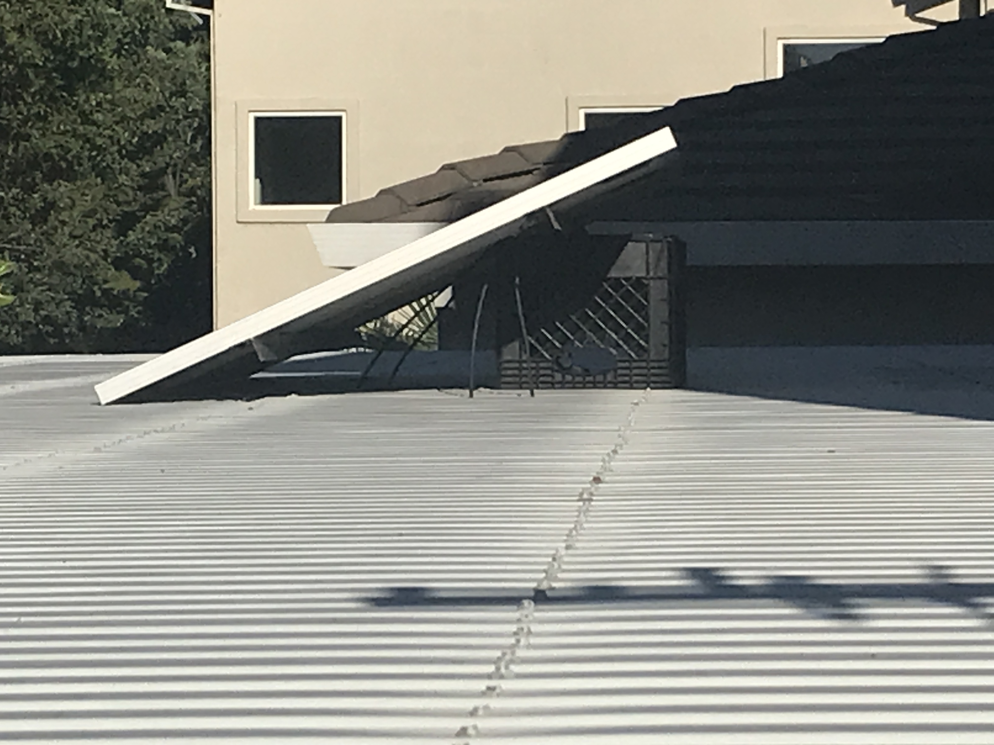

What i figured from my setup is that PV panels down below make 30% less than those on the roof.
Even light shade will cause panel reduction. Must be some light refraction from all sides or something, but it is true. Maybe you would want to fix those panels up high somewhere out of all shades and out of reach of pets and other animals (kids)
thanks, this is where they live on top of the patio coverarber333 wrote: ↑Mon Aug 01, 2022 7:53 pm What i figured from my setup is that PV panels down below make 30% less than those on the roof.
Even light shade will cause panel reduction. Must be some light refraction from all sides or something, but it is true. Maybe you would want to fix those panels up high somewhere out of all shades and out of reach of pets and other animals (kids).

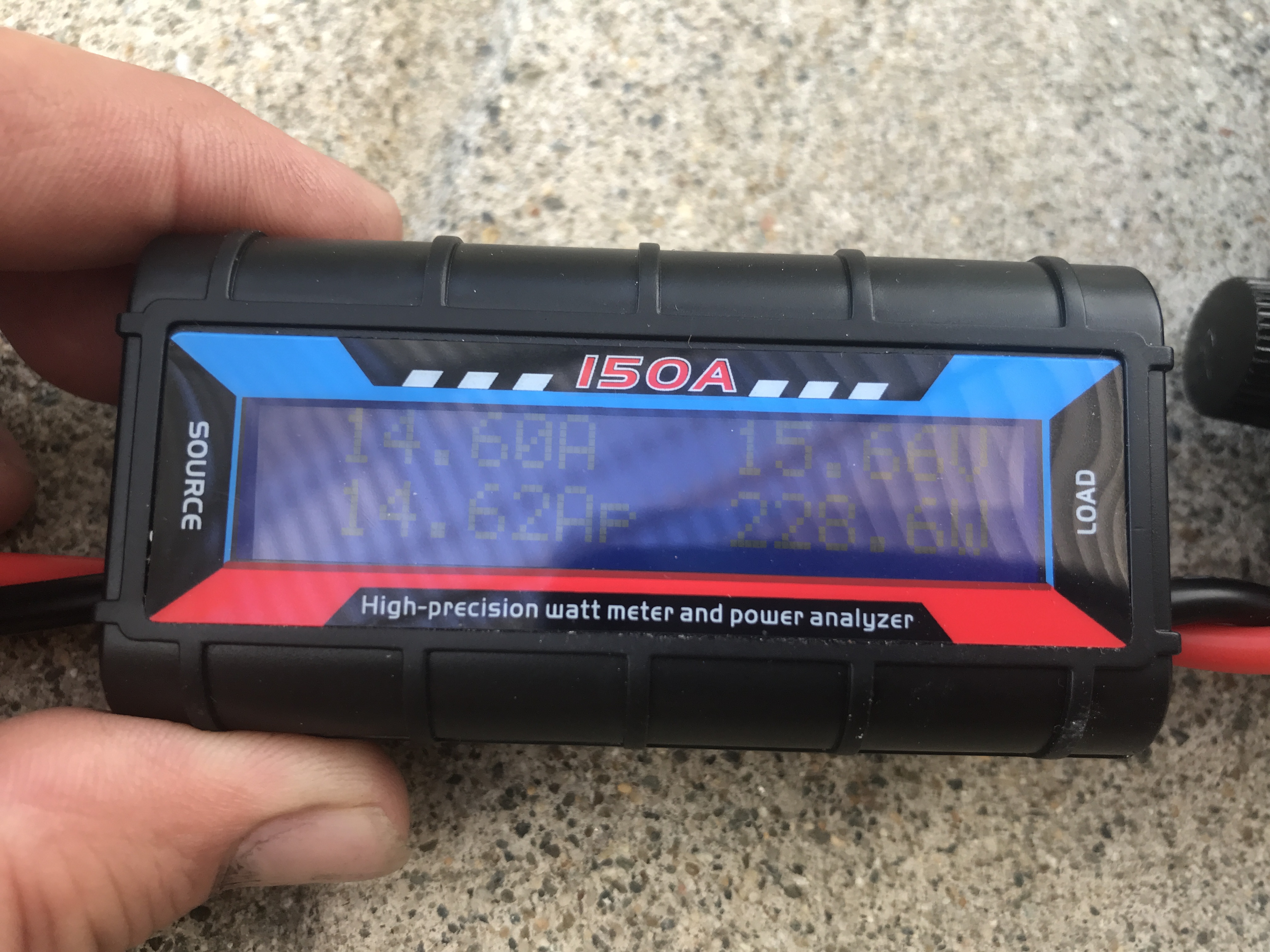

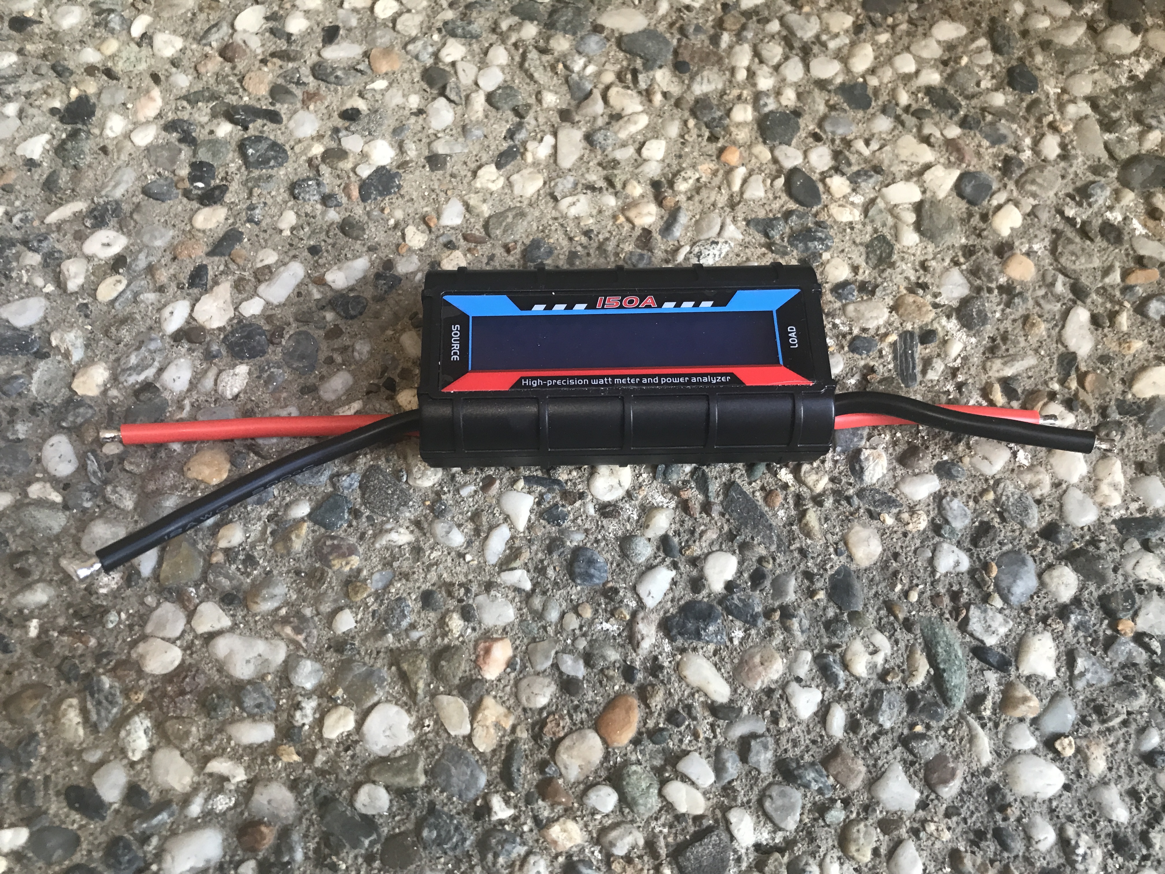

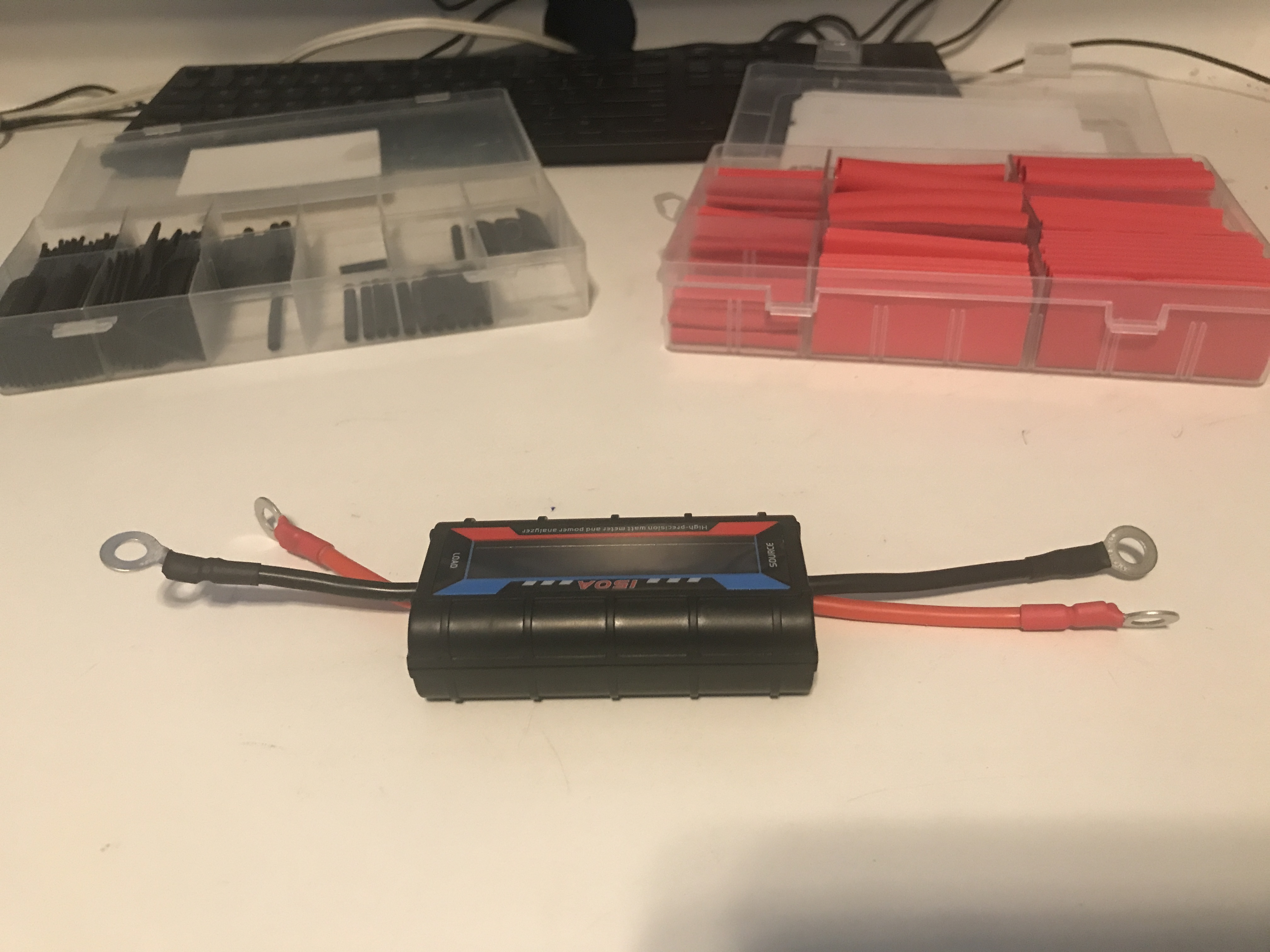

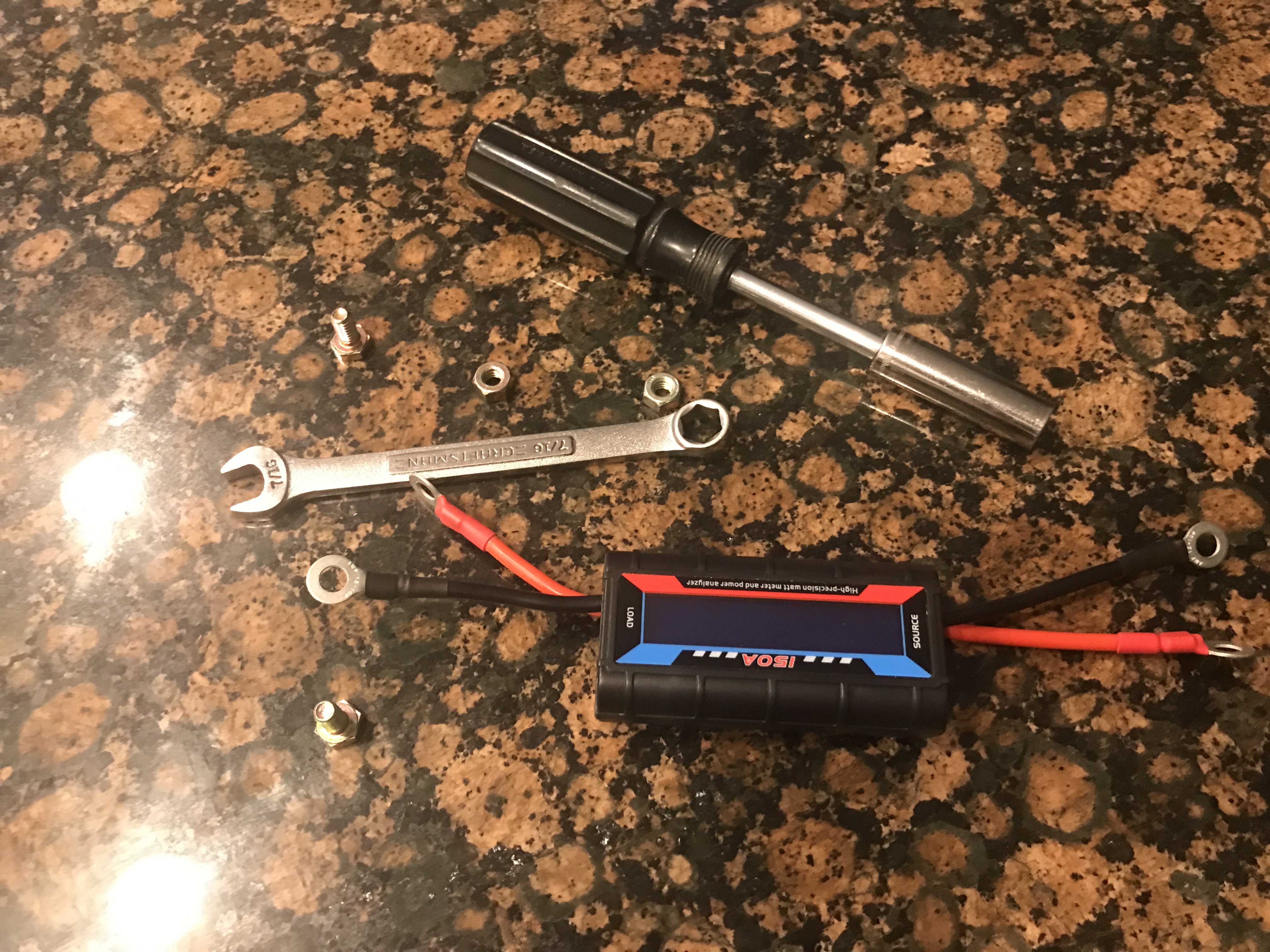

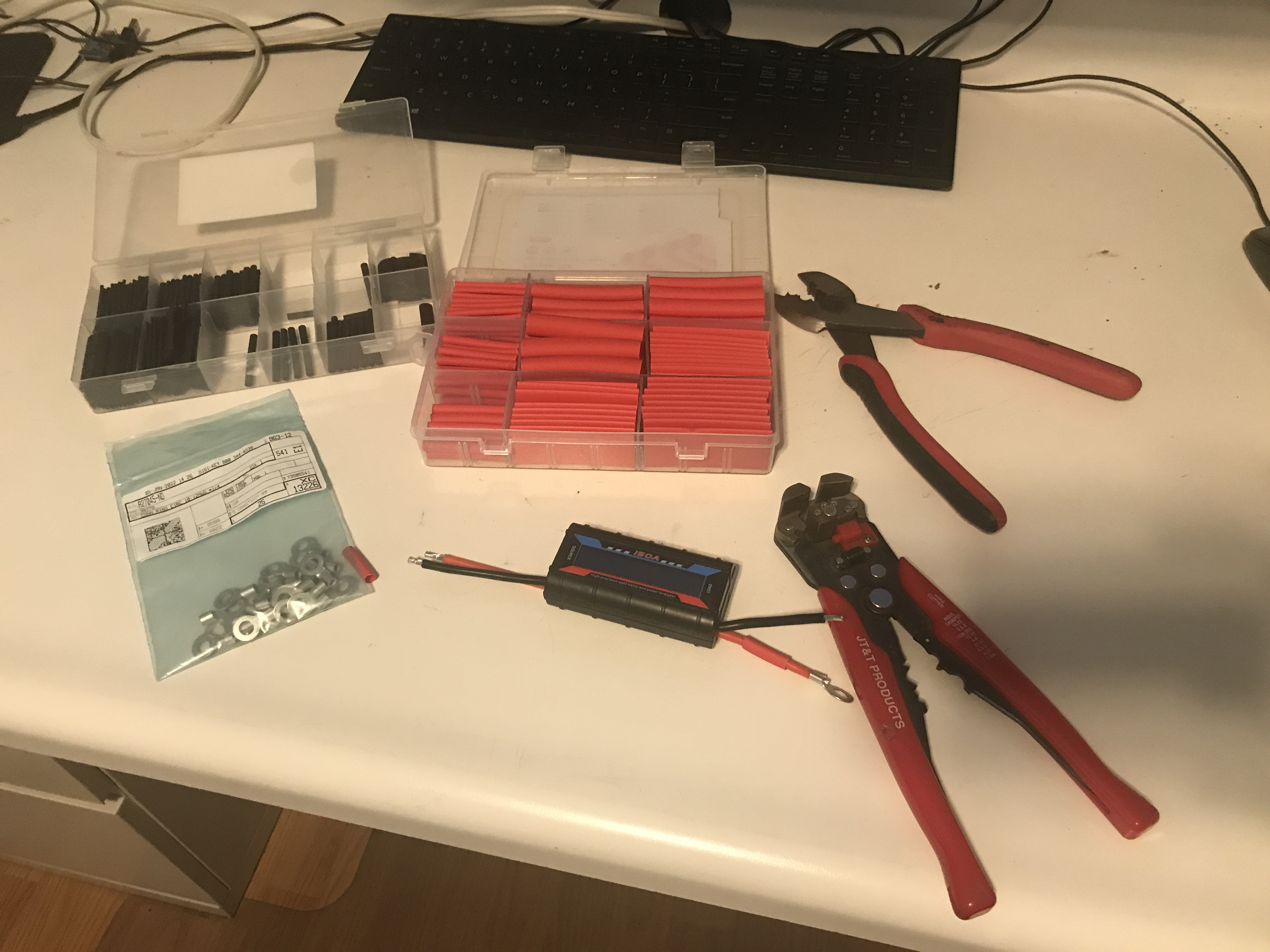

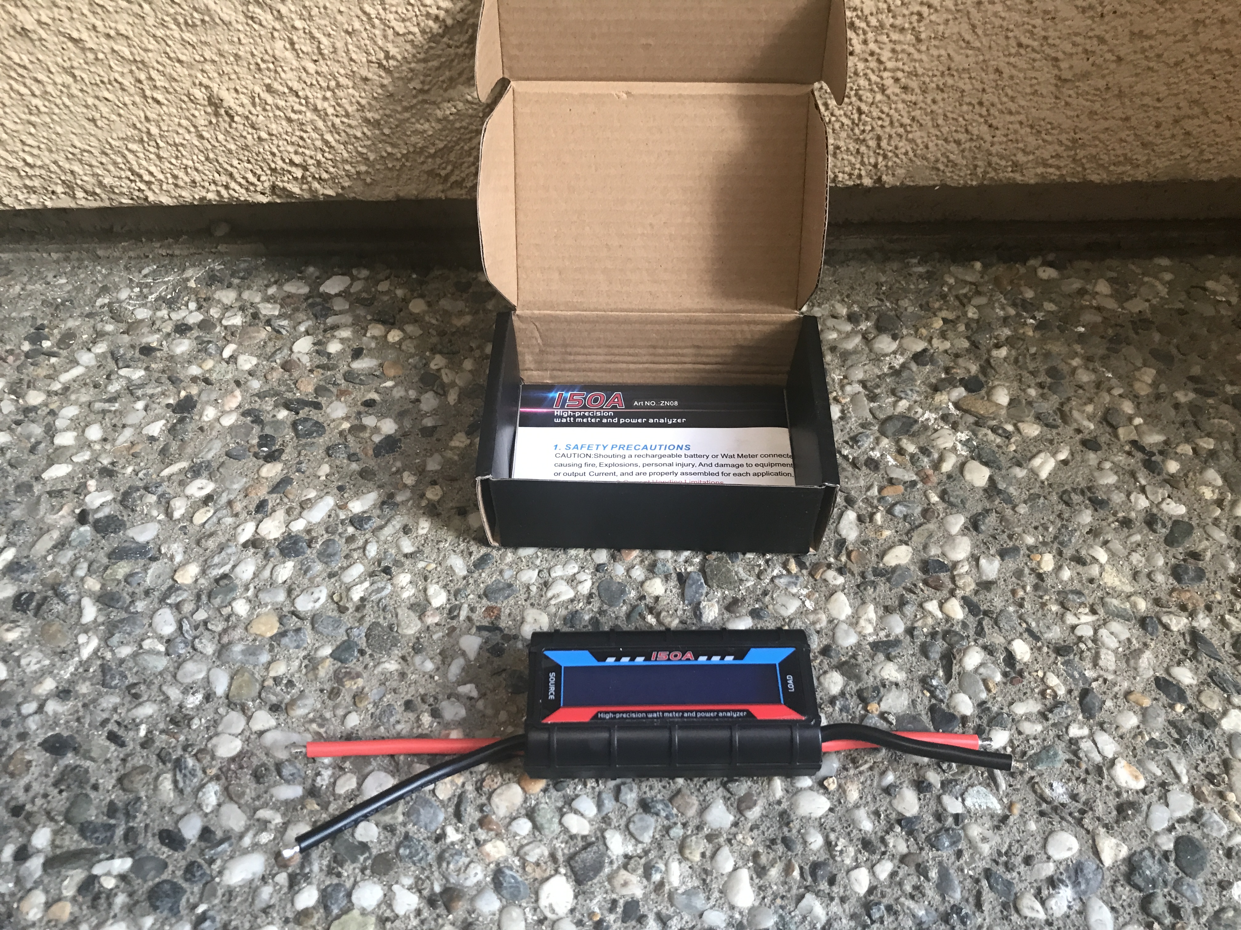

determined to prove Johannes right, I decided to throw some money at the problem, to get some INFORMATION
so far I have been monitoring what comes out of the Inverter ie the AC output but now let's see what's actually going in

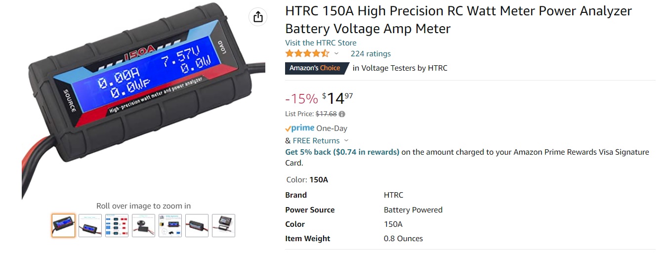

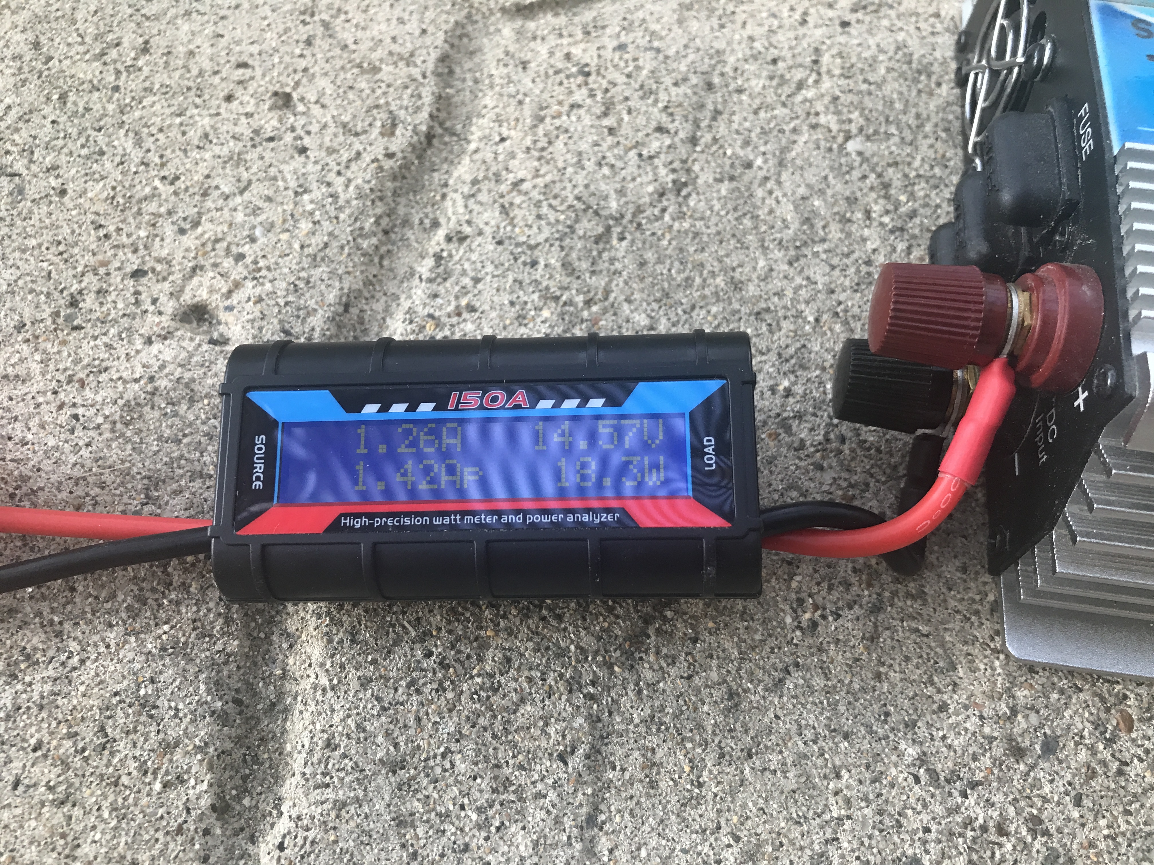

Now this thing will do ONE out of THREE things that I like these sorts of meters to do
1. It will show us data in real time (Volts, Amps, Watts, & even Amp Hours)
2. It will NOT log any hysterical data for us to have a record over time with
3. It is not blue toof nor WiFi meaning we have to be where it's at to see the data
[ all of this pronounced: better than noffin' ]
and the best part is no CANBusin' required my kinda gizmo, just wire it up and it goes....

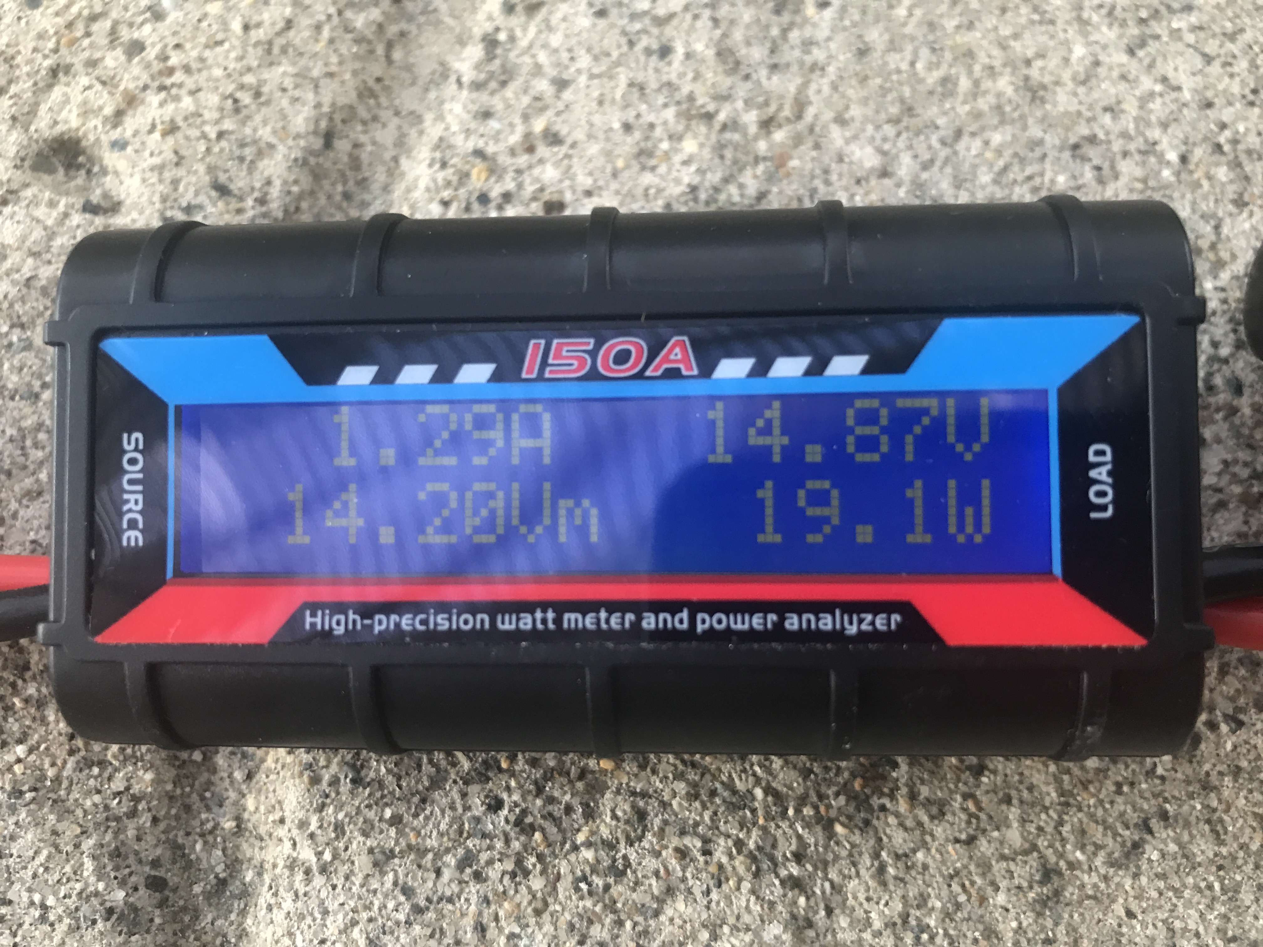

ok this was early in the morning like at 7:00 AM before the sun woke up so it was only reading 19 Watts but at least it be a working! Yes

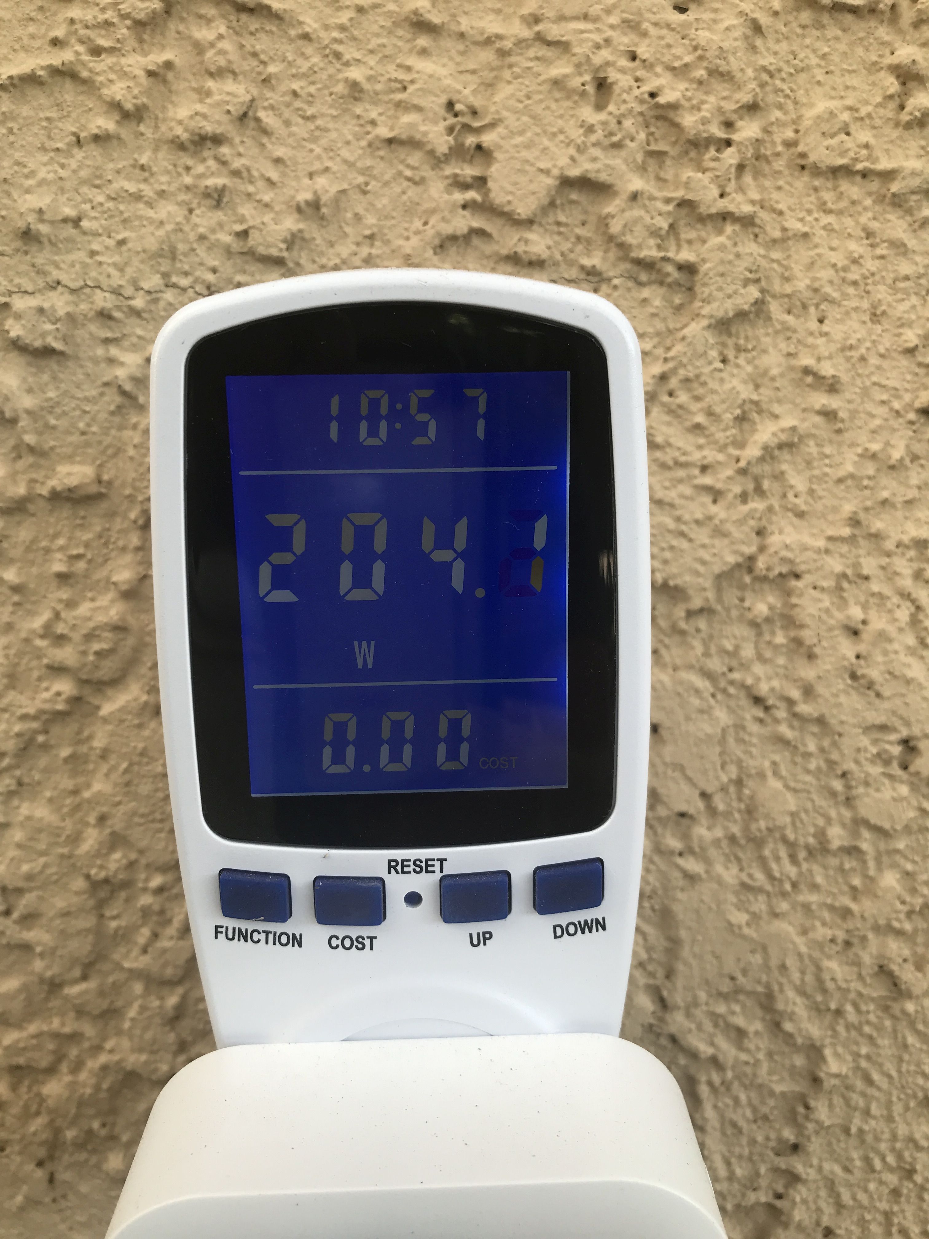

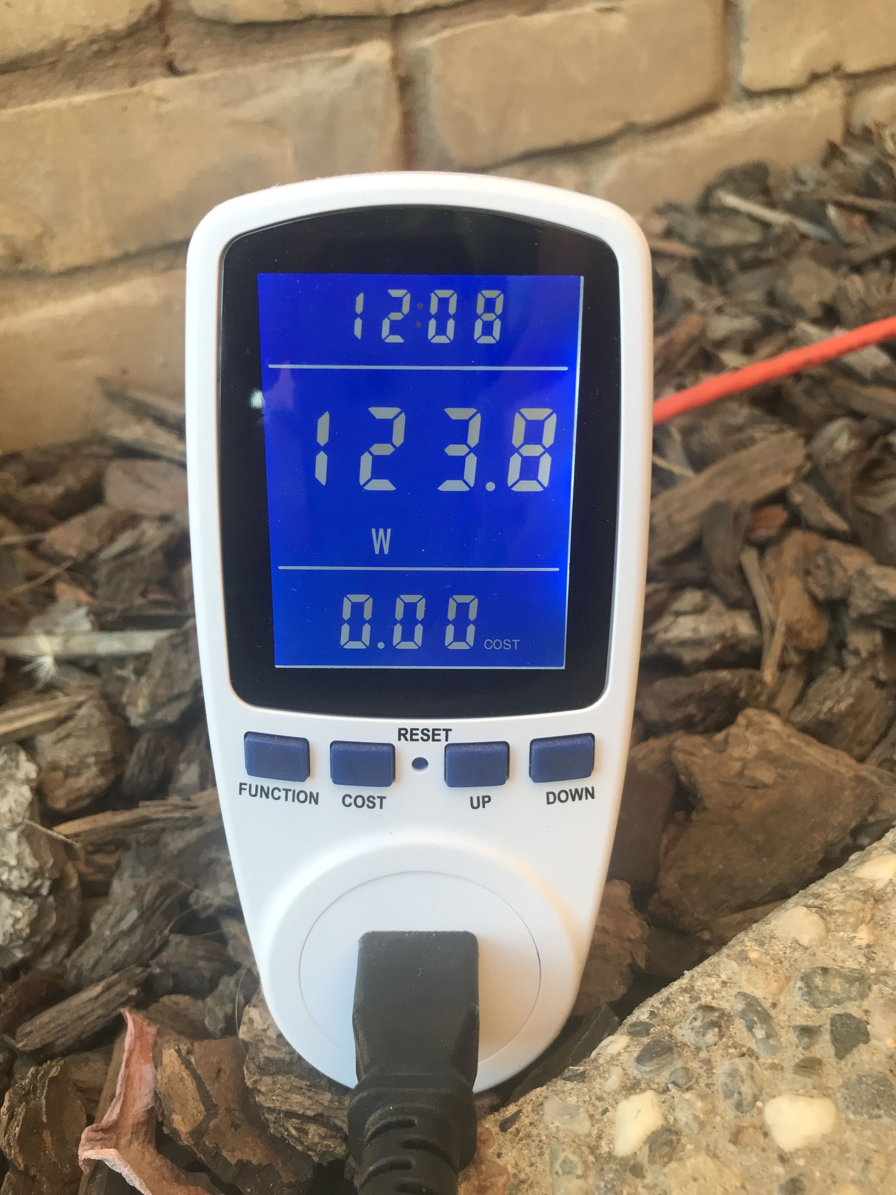

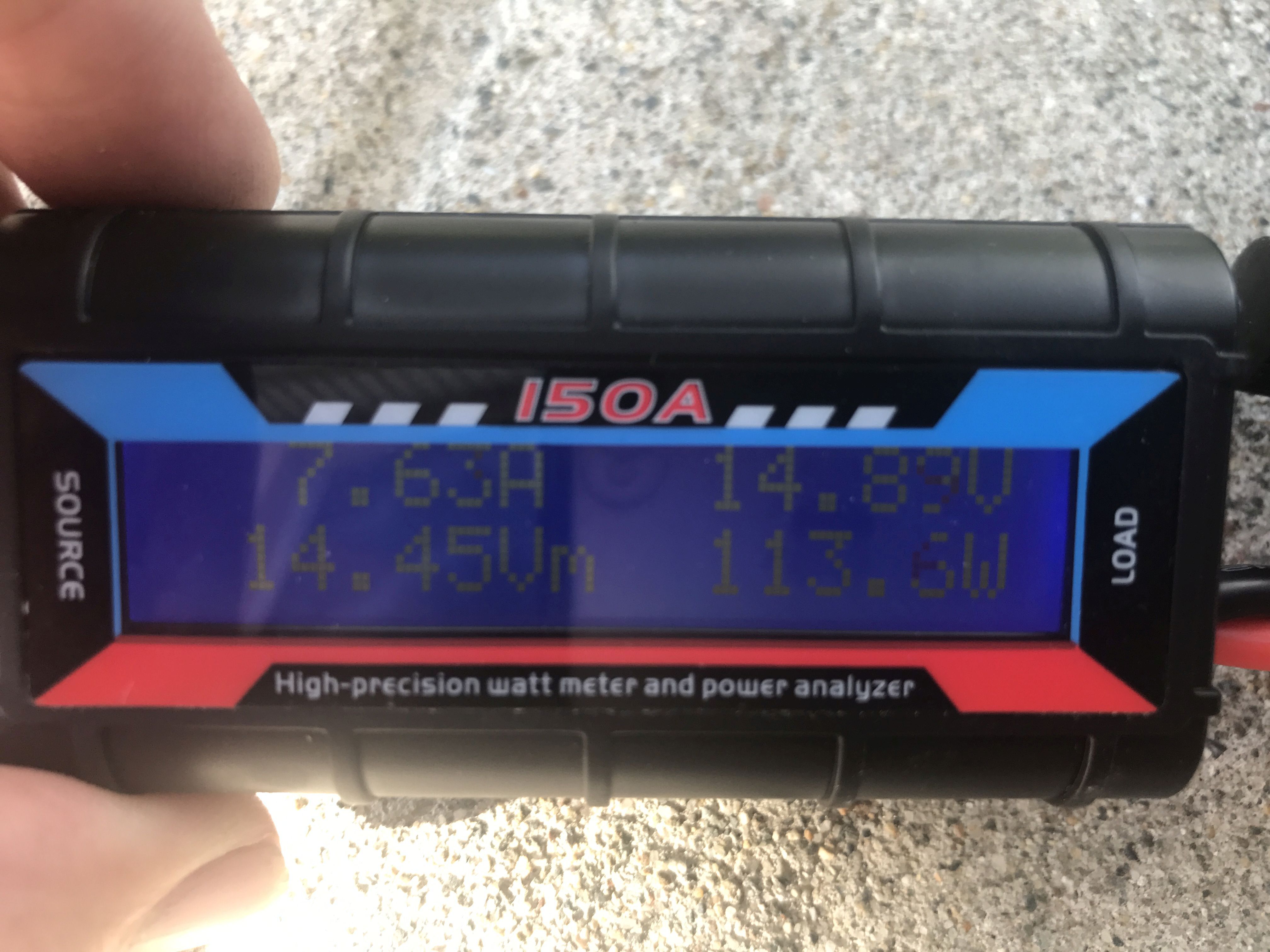

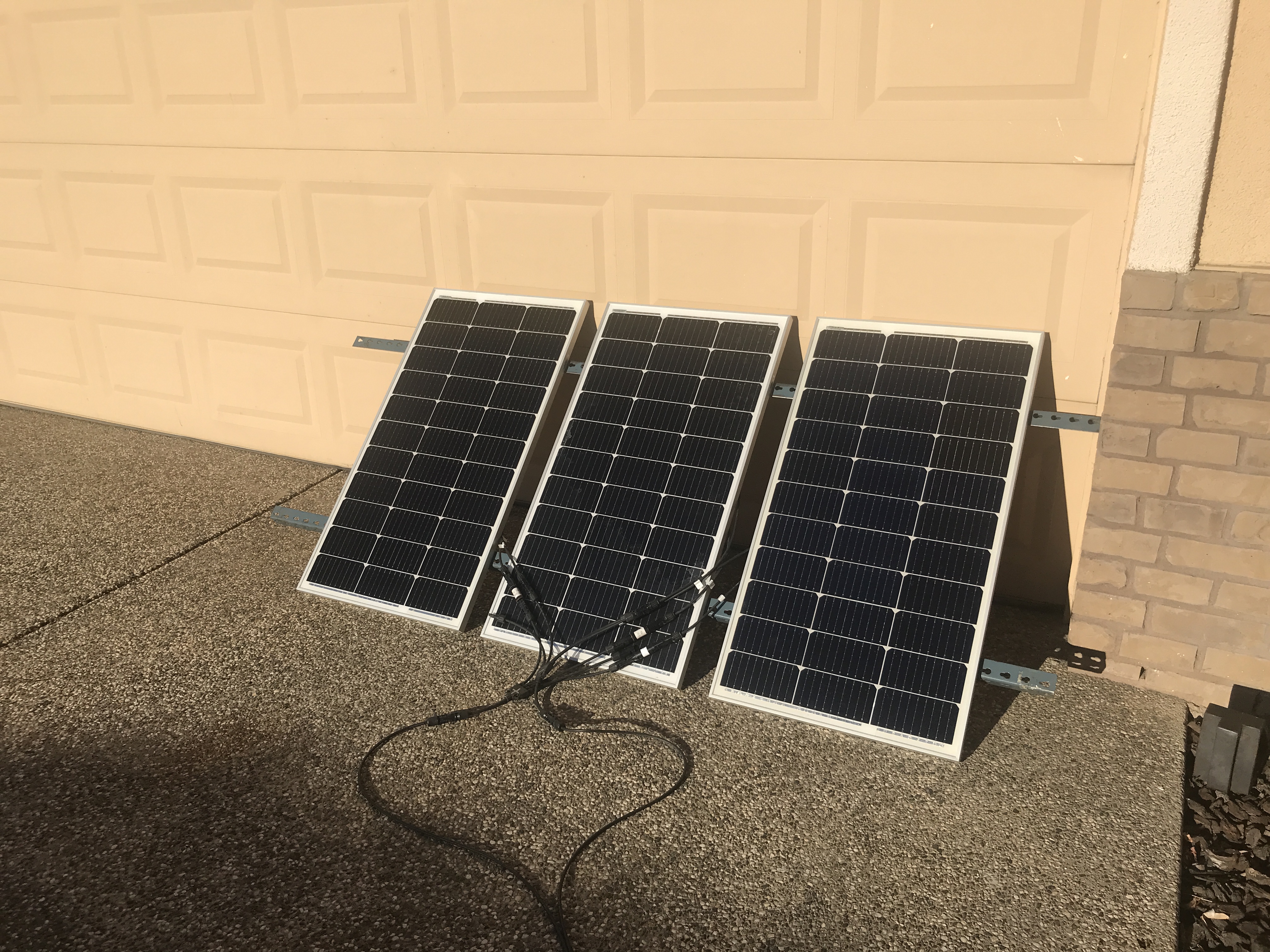

100 WATT REPORT Update
alright we have some data to compare, at about 72°F early in the morning in August we had 113 watts DC coming in to the inverter and 104 watts AC coming out, so that's 92% efficiency when it comes to how the sausage is made unless I am missing something, of course we will do this throughout the day as temperatures rise, the idea being check out the effects of heat on the inverter itself not the solar panels
- Gregski
- Posts: 3158
- Has thanked: 630 times
- Been thanked: 1607 times
200 WATT REPORT Update
76°F of morning sun
228 Watts DC input
204 Watts AC output
89% efficient
76°F of morning sun
228 Watts DC input
204 Watts AC output
89% efficient

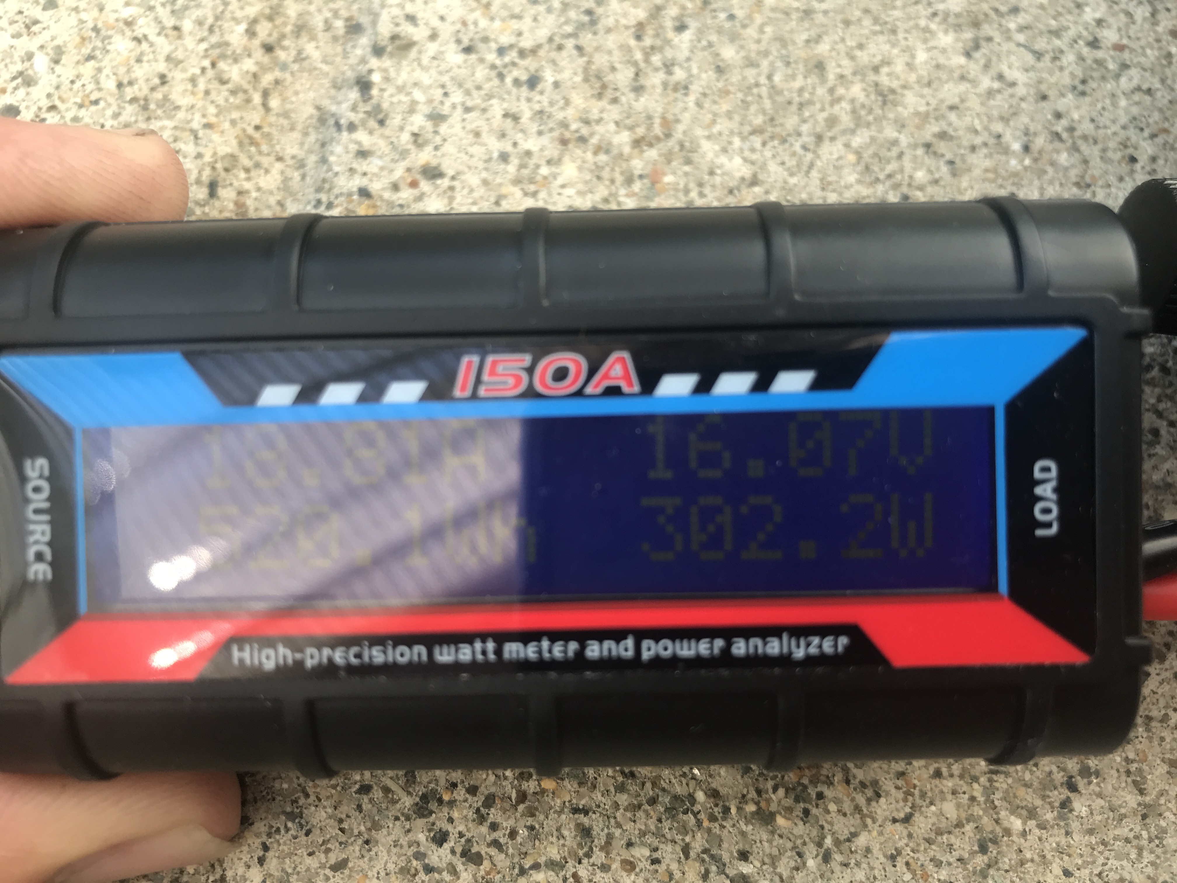

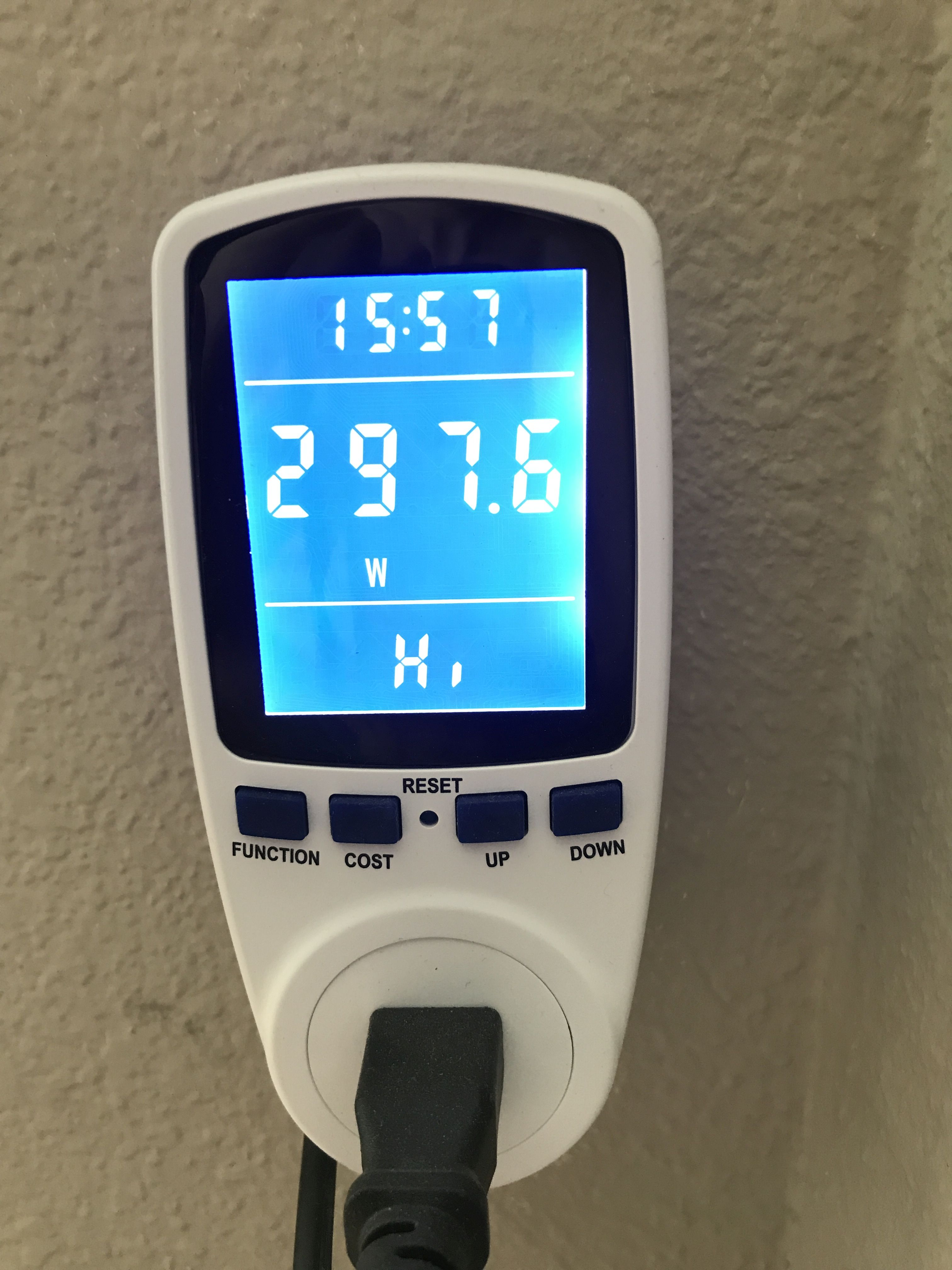

300 WATT REPORT Update
82°F of late morning sun in August
302 Watts DC input
300 Watts AC output
99% efficient
302 Watts DC input
300 Watts AC output
99% efficient

Were the measurements made with 3 or 6 modules? With 3 modules it would be a good value! The measured AC value could be corrupted by an imperfect sine wave.

modules? or did you mean panels? I am currently using six 100 watt Windy Nation solar panels, and I'm beginning to think they suck!muehlpower wrote: ↑Thu Aug 04, 2022 6:35 pm Were the measurements made with 3 or 6 modules? With 3 modules it would be a good value! The measured AC value could be corrupted by an imperfect sine wave.
