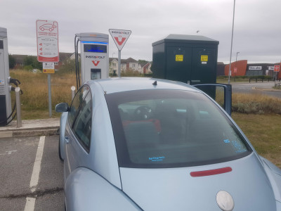

Posted: Sun Jul 31, 2022 6:58 pm
by Bigpie
Dont recall advertisements, but they look like this
Pretty much stumped so taking a punt, dont suppose you have any logs from these units to compare with?
