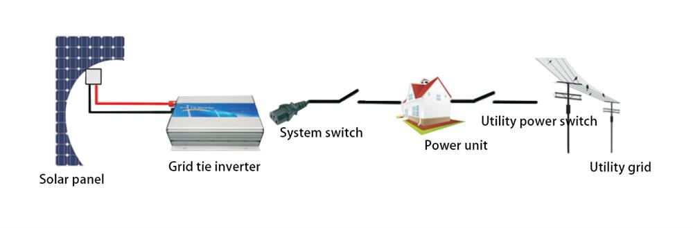

  • What the hell is a grid tie system?
    • one that requires no batteries
  • Well, how much you gonna spend?
    • hopefully less than $1,000
  • Do you need a license / permit for that?
    • Hell no, well (maybe)
  • Is it safe?
    • Yes, the system shuts down when you shut down the mains in your electrical panel for service.
  • Is it legal?
    • Check your local ordinances I guess

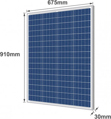

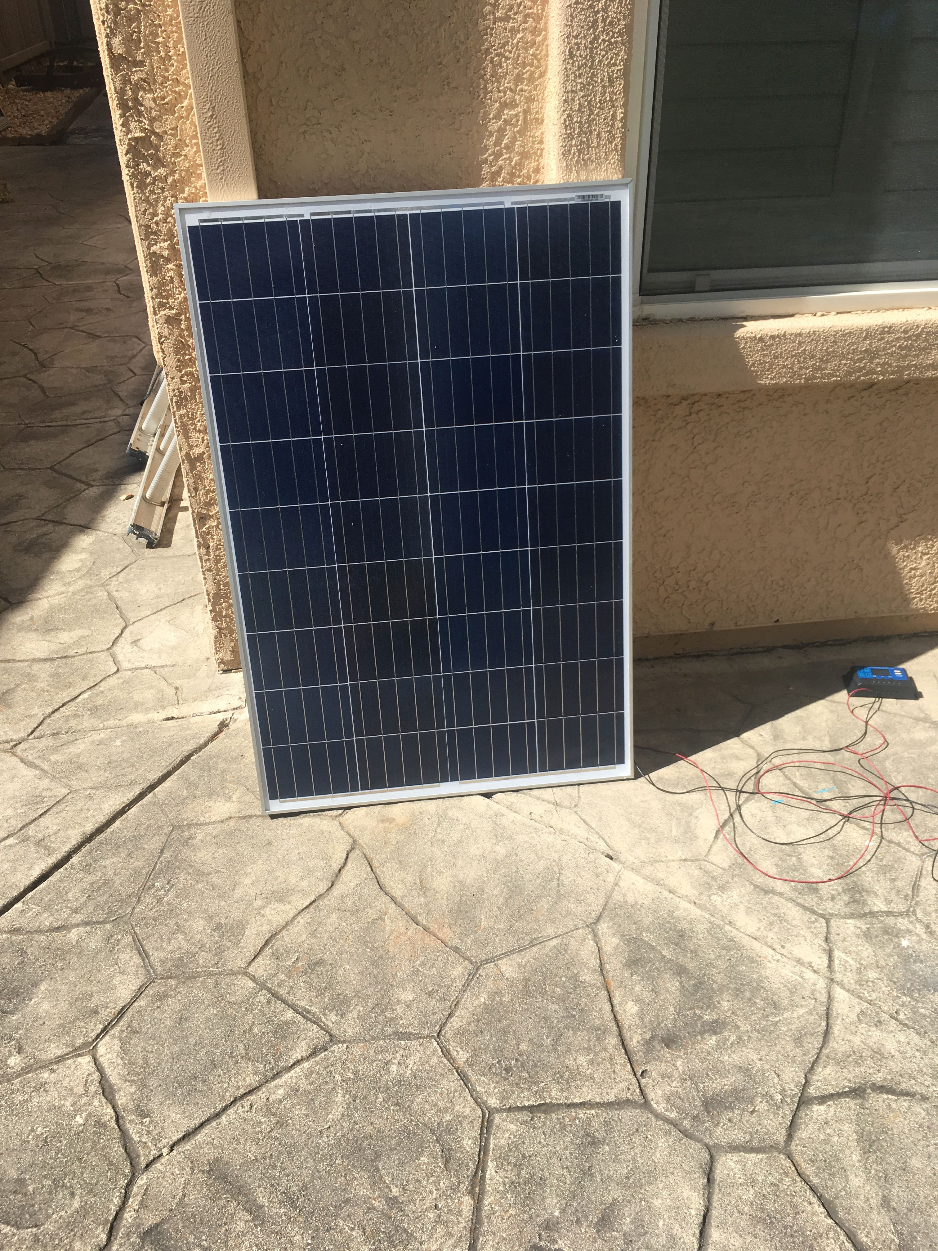

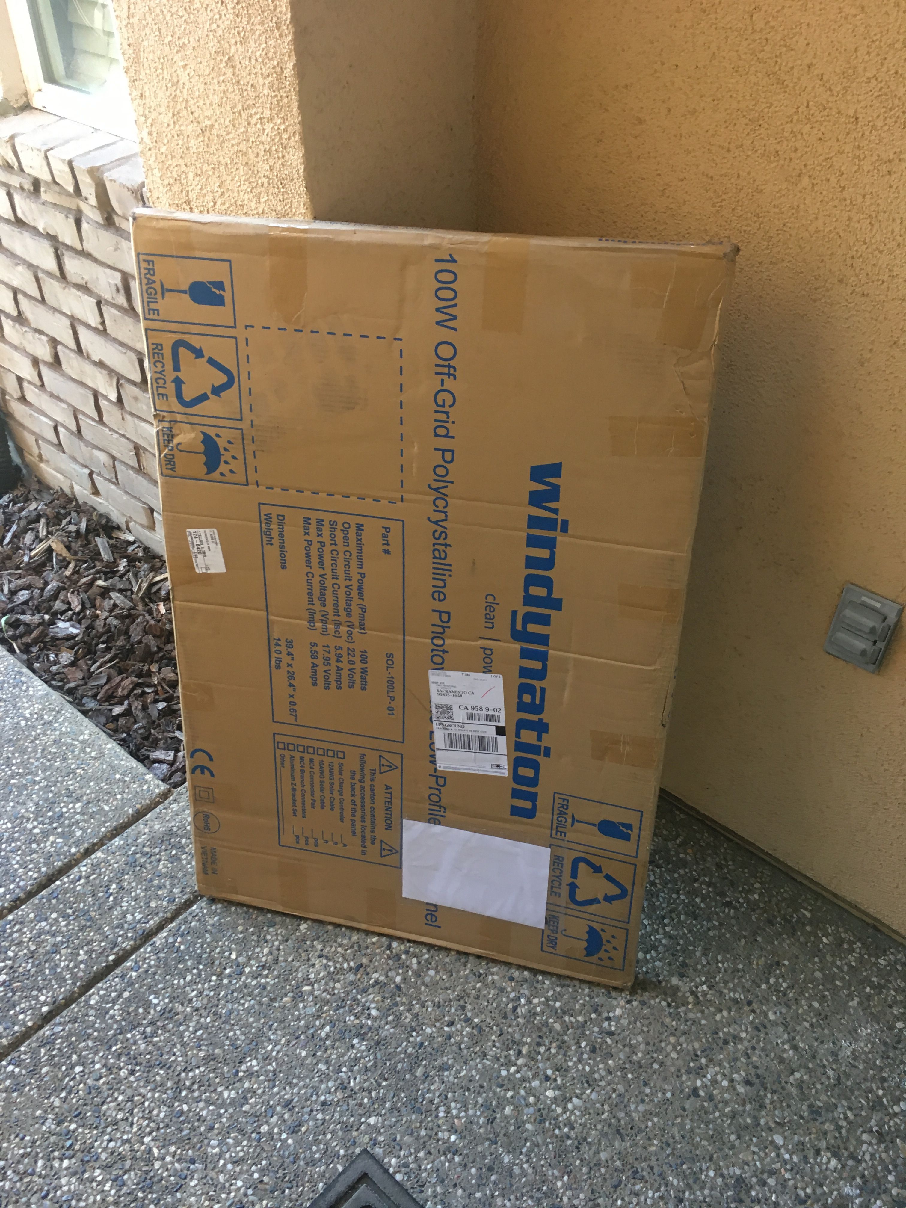

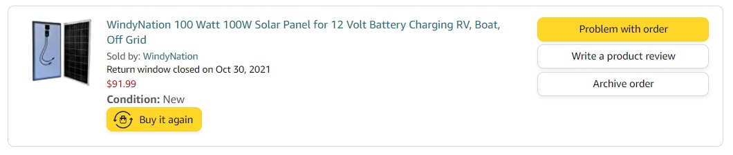

so it all started with a solar panel, yes ONE
I literally went out on AMAZON and bought the cheapest 100 watt solar panel I could find [May 2020 BC (Before C0v1d) $77 bucks), it just happened to be from a company I guess you can call them that, that calls itself WindyNation
My requirements: buy a 100 watt solar panel so I could do the math easily as I add them up, 100 watts, 200 watts, 300 watts you get the idea
again I knew nothing at this time

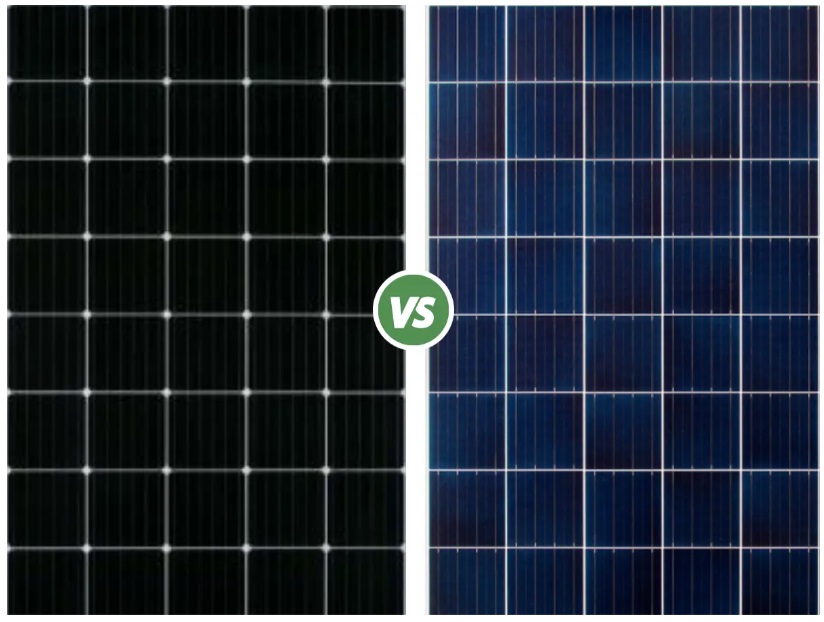

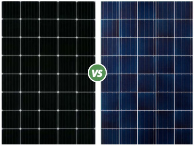

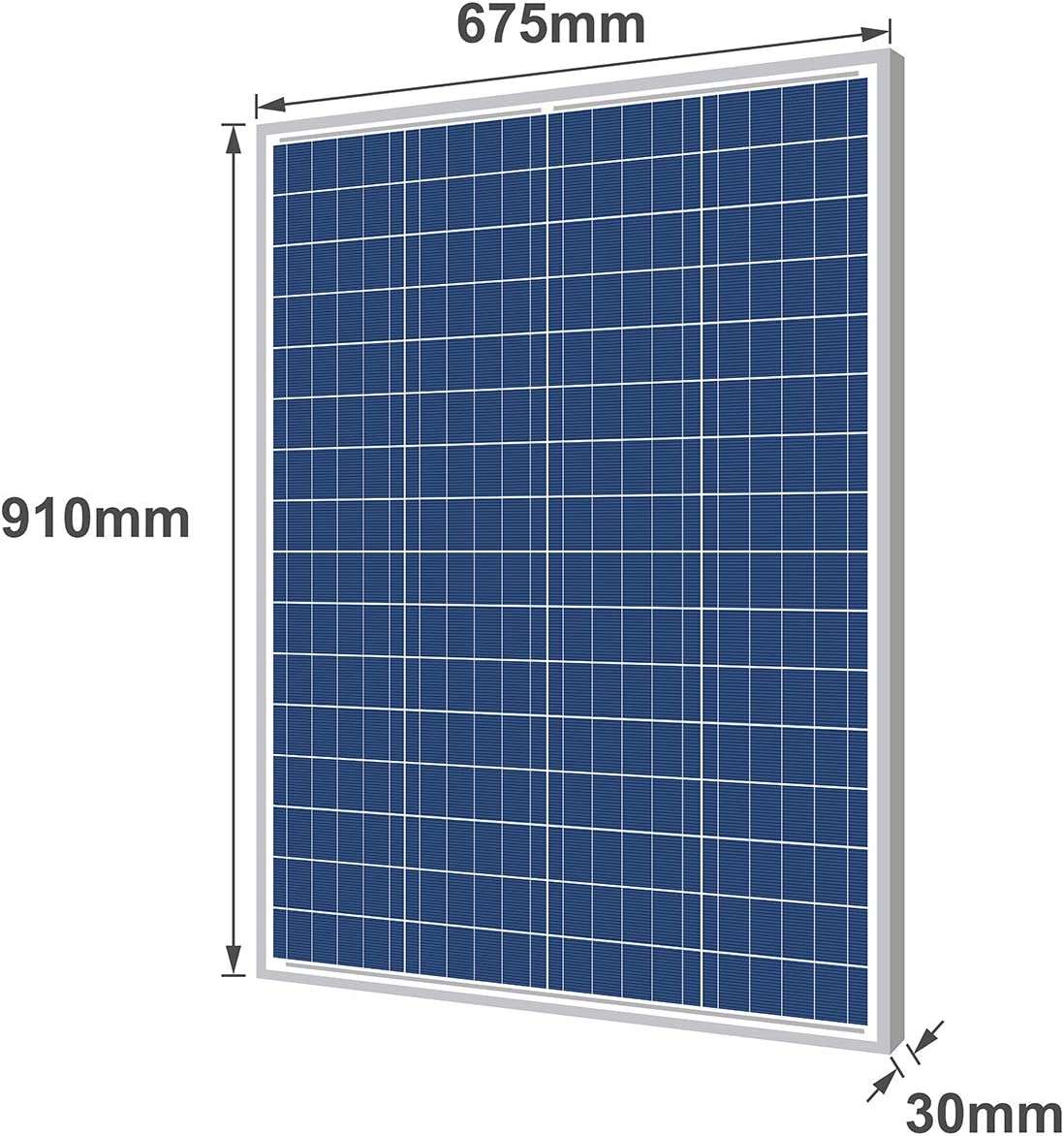

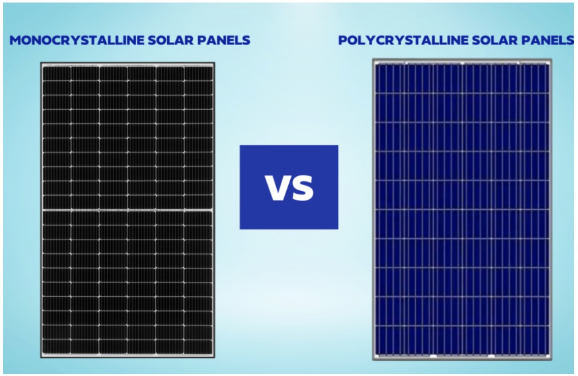

LESSONS LEARNED:
Lesson #1. there are two types of solar panels (probably more but at least two) later on we will learn more about this but for now we have:
1. Polycrystalline (we'll just call it Poly)
  • it tends to look blueish
  • has white grid lines on it
  • old tech
2. Monocrystalline (we'll just call it Mono)
  • it tends to look blackish
  • has white grid lines and little diamonds on it
  • new tech
there, how's that for Science for ya?

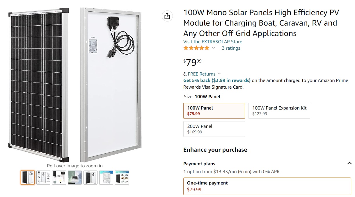

... and now some Solar Panel Math (SPM)
One solar panel = $79.99

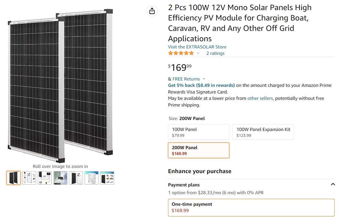

but wait, if you act now, and buy two of them, it's only ten bucks more than if you bought them individually = $169.99

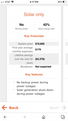

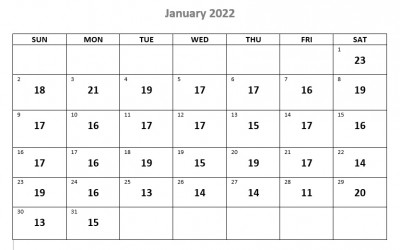

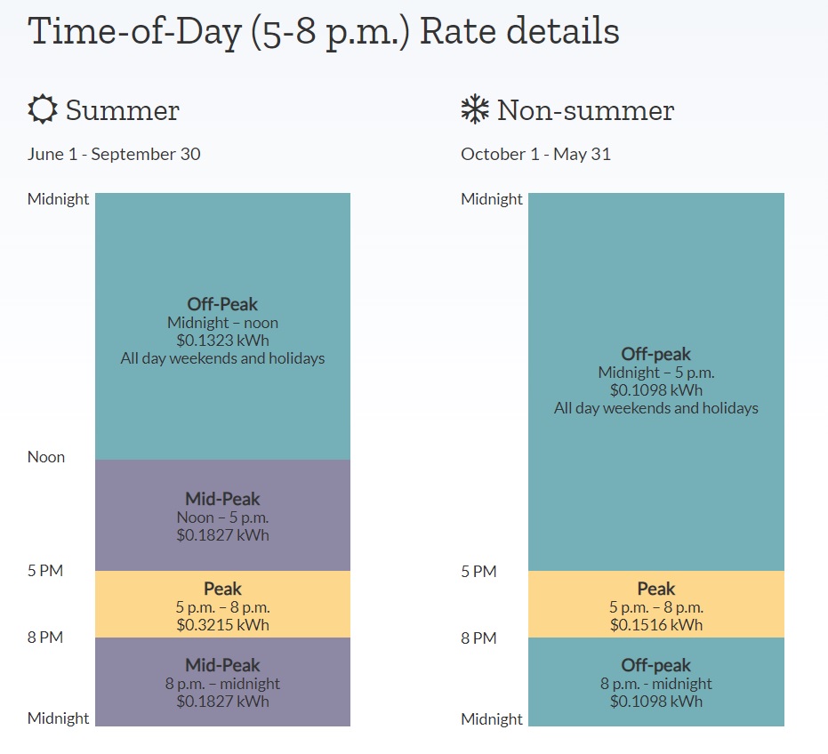

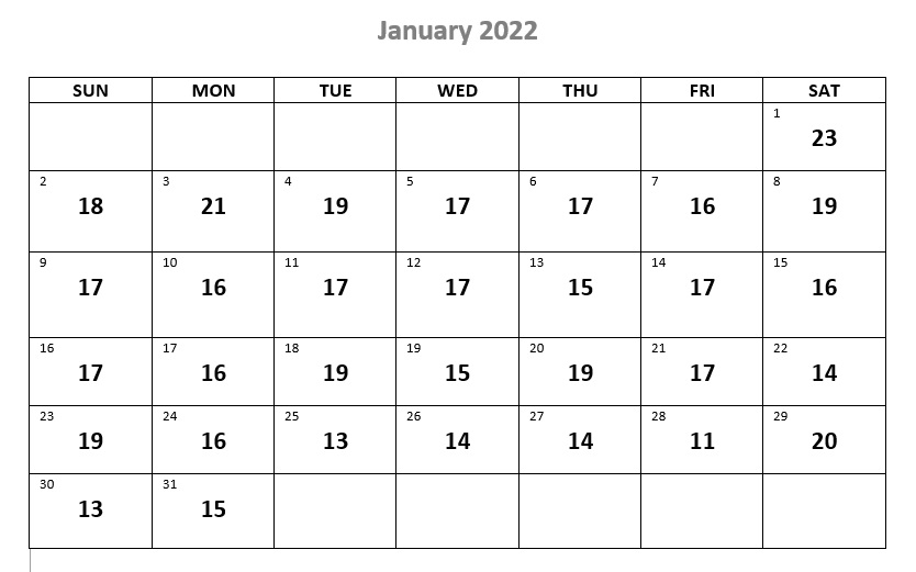

thank you and I am glad you asked, we pay an average of $200 per month, and that is a great segue into the section on reading your Electricity Bill, in Sacramento we can get our electricity from one of two companies, mine is called SMUD (pronounced like mud just with an S in front of it) Sacramento Municipal Utility District, and their pricing strategy is what you would get if a Credit Card Company and your Cell Phone Company had a child aka confusing, I happen to have something they call Time-of-Day (5-8 p.m.) Rate which comes in either their Summer or Non Summer flavors:
this is my January 2022 usage calendar that I made based on their utility bill with a daily average for the month of 17 kWh, I said I made this because their billing cycle is deliberately confusing and spans across two partial months type of thing: the big numbers are kWh (we have a larger two story house which faces North)

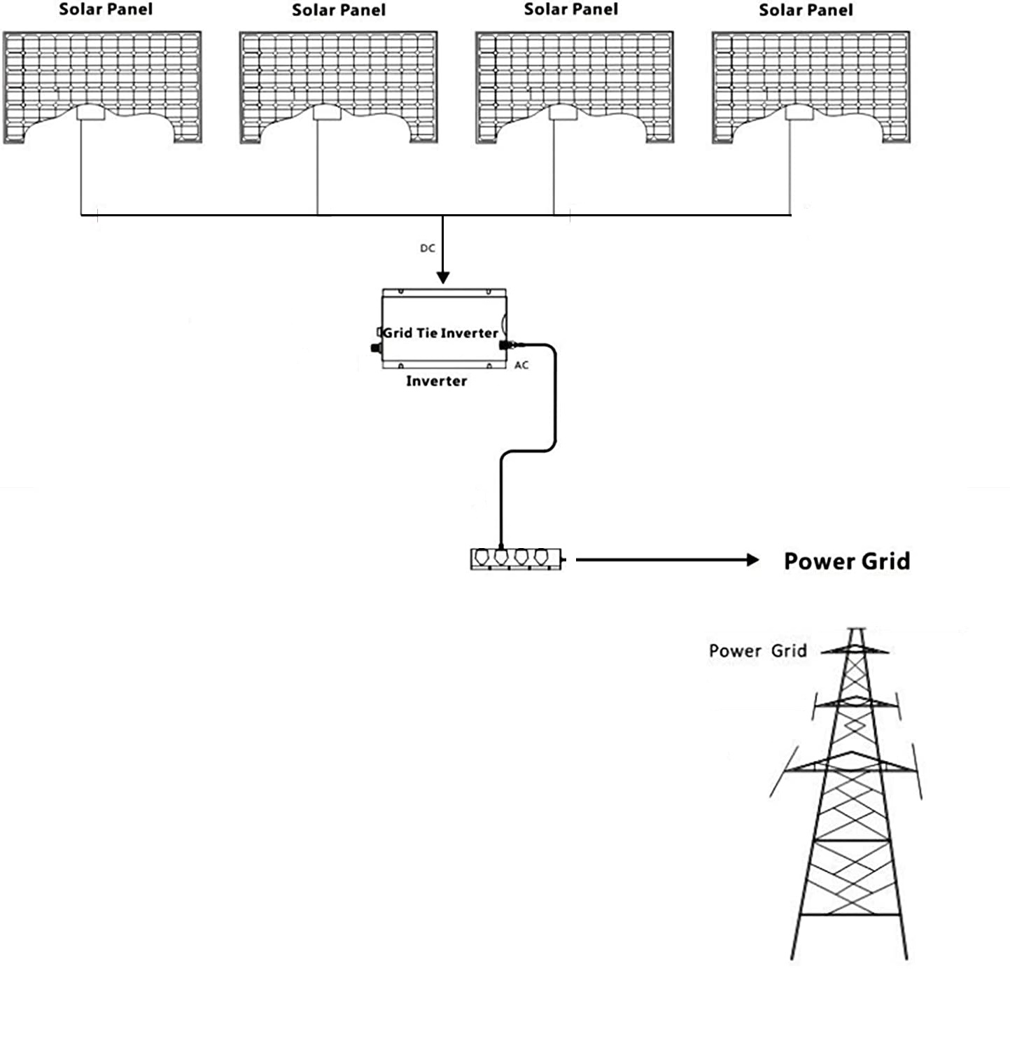

Grid Tie simply means No Batteries needed, that's right this system is so basic, so simple, there are absolutely no batteries at all, this is why I was so excited to try it, and share it with you all.
Gregski

so all you need for this Grid Tie system to work is two things:
1. Solar Panels
2. a special grid tie Inverter

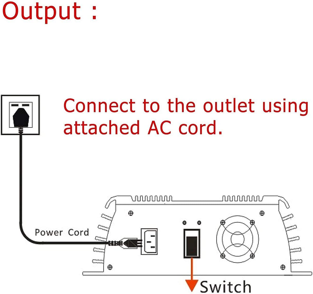

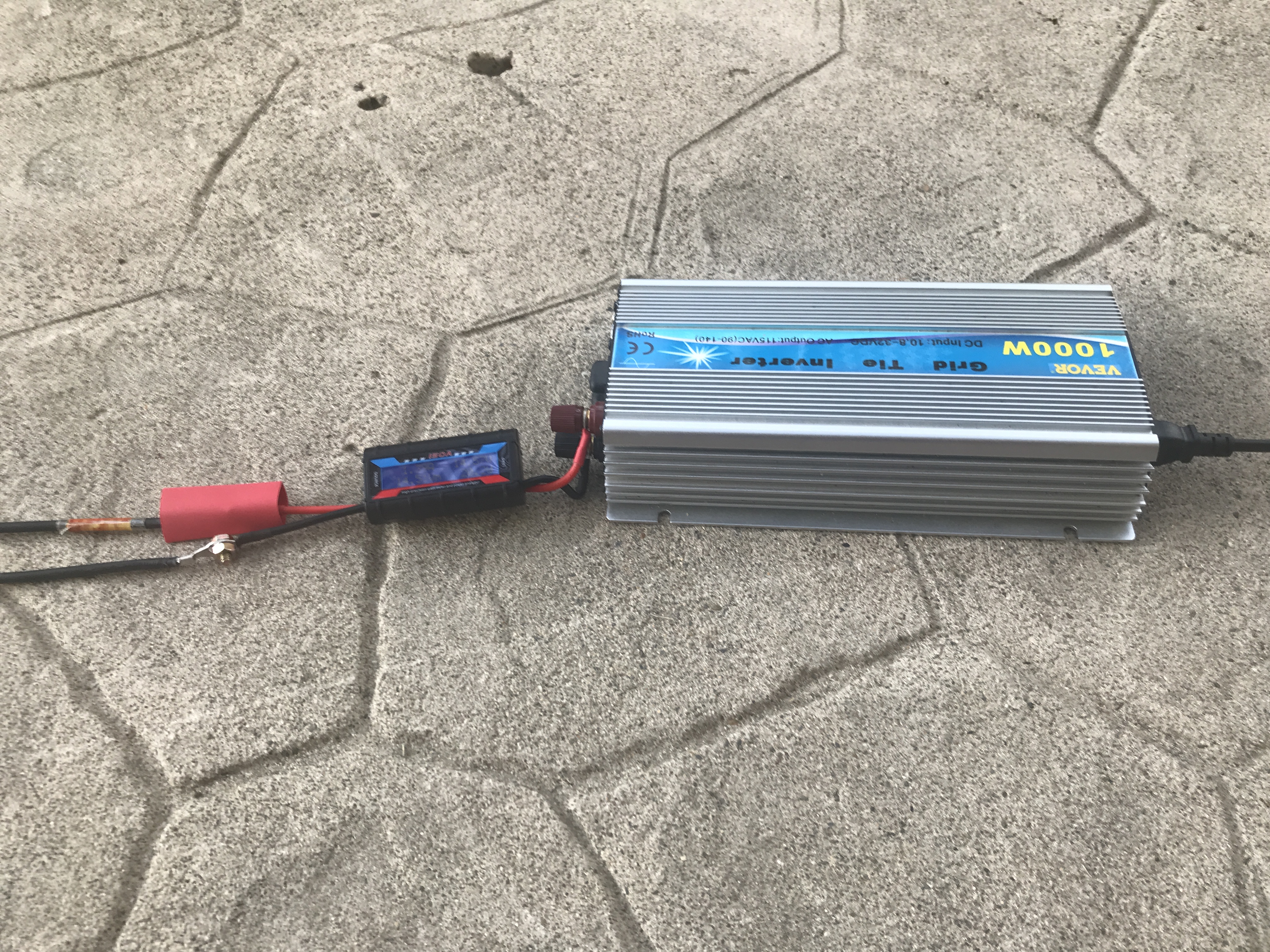

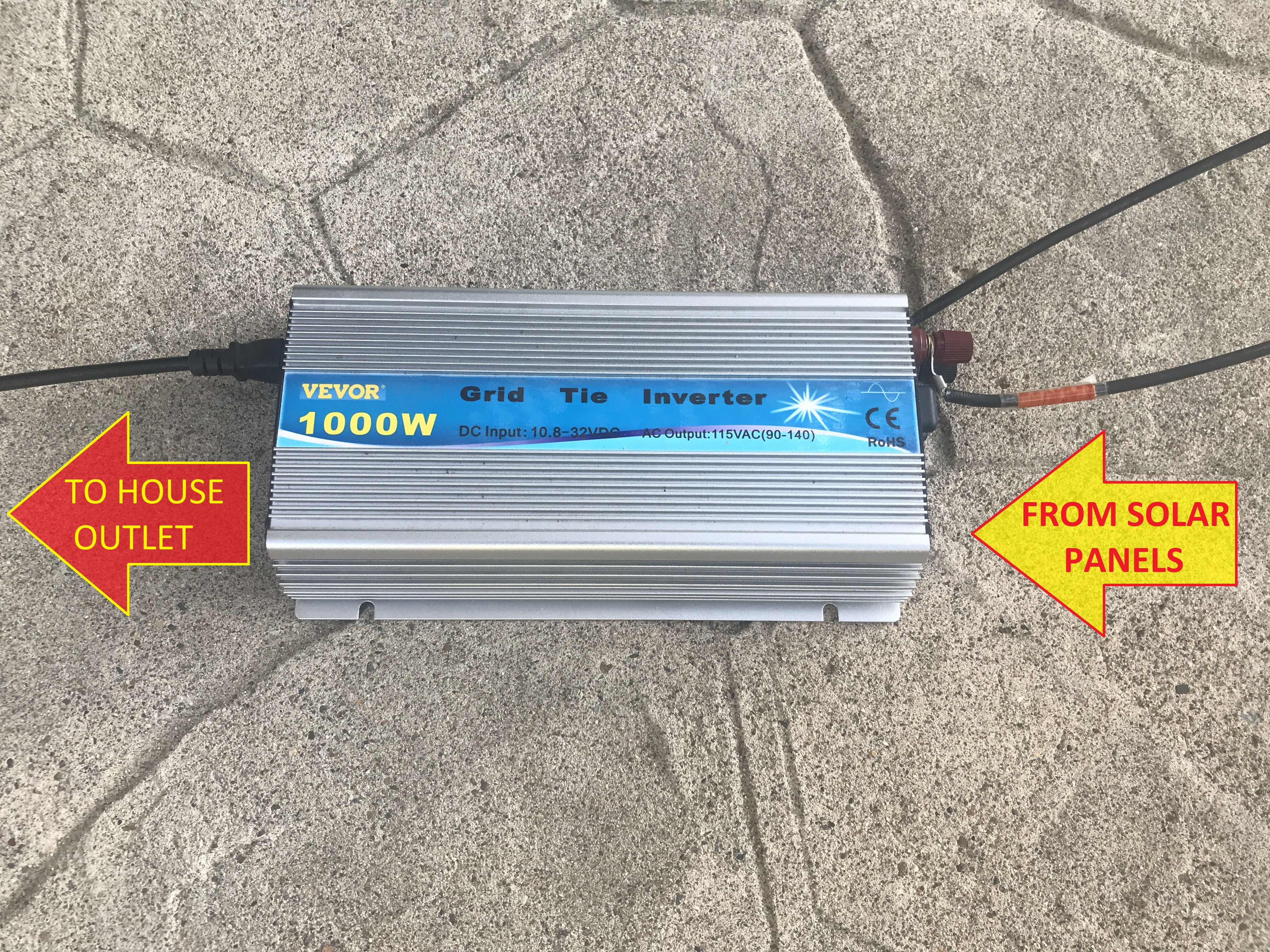

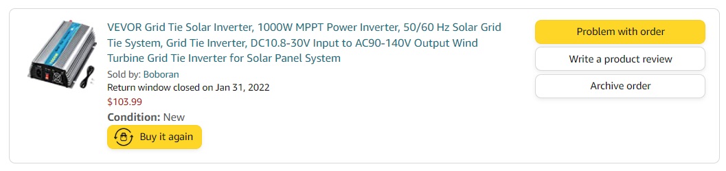

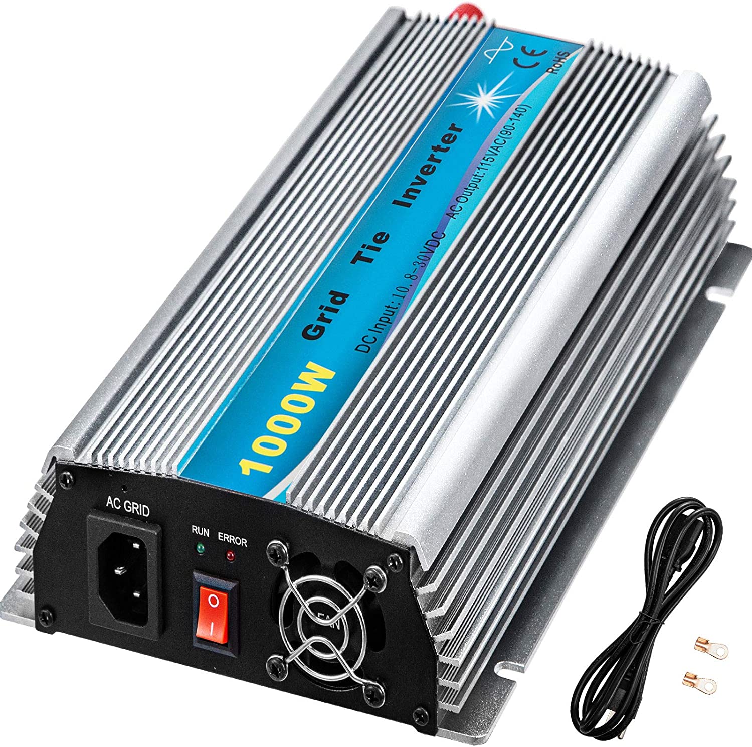

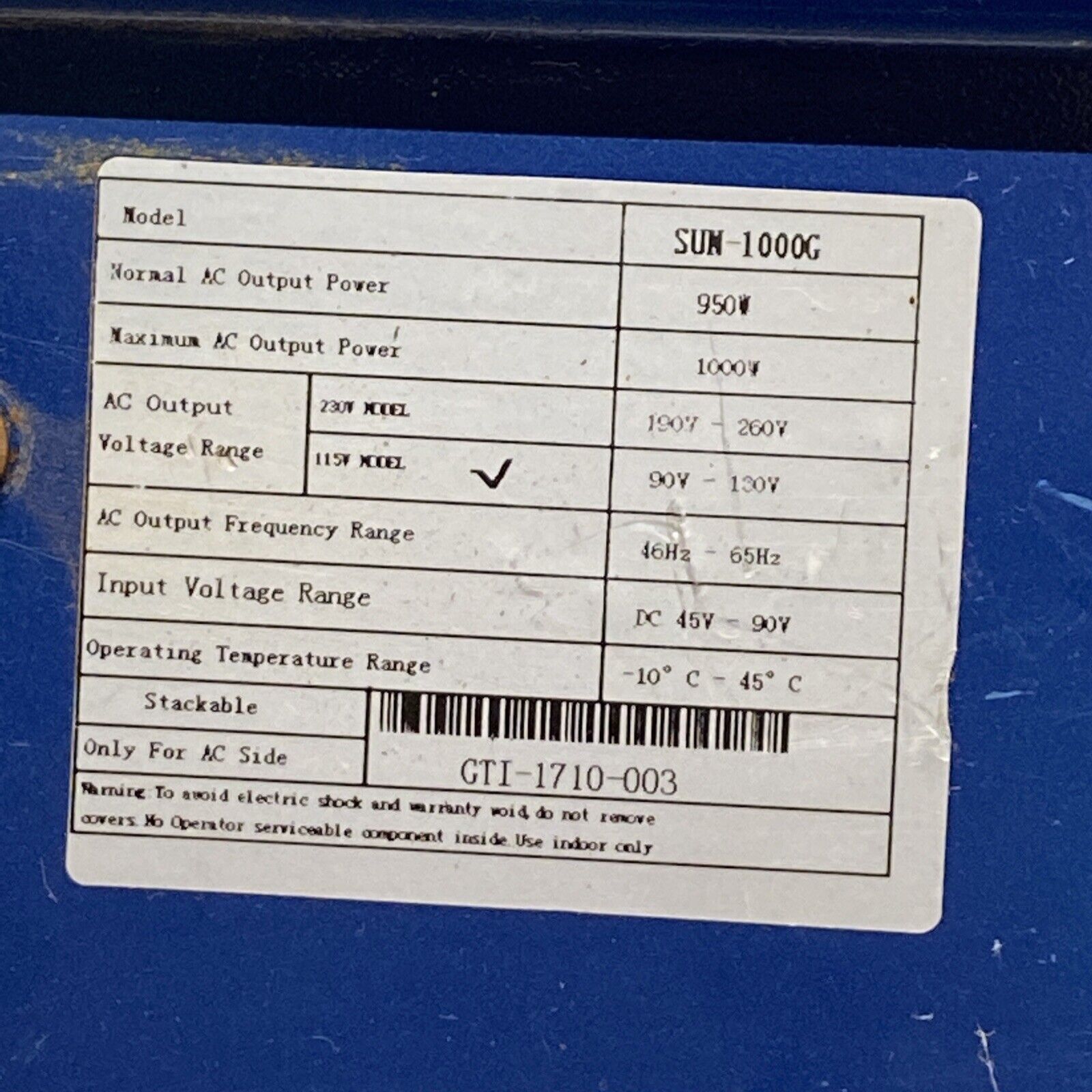

so I went out and bought this 1000 watt grid tie inverter from a company that called themselves "Vevor" (more on this later but these days I see half a dozen fake name companies selling the exact same box type of thing) again off of AMAZON for only $104 bucks, keep in mind this was before the pan dem ick
once again like a fool I only picked the 1000 watt unit based on it's round number spec and nothing else, I think there may have been a smaller 500 watt one as well that I passed on

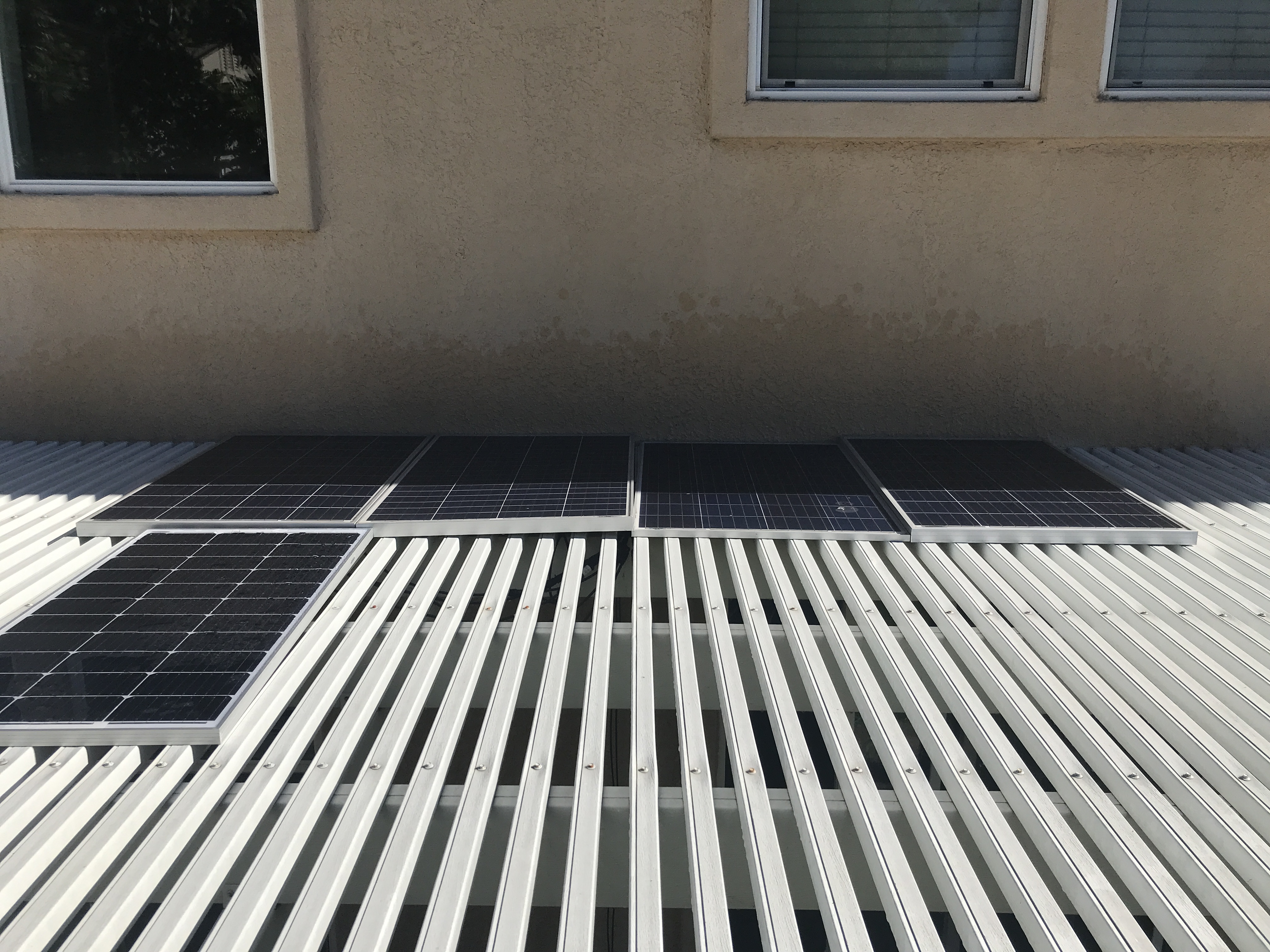

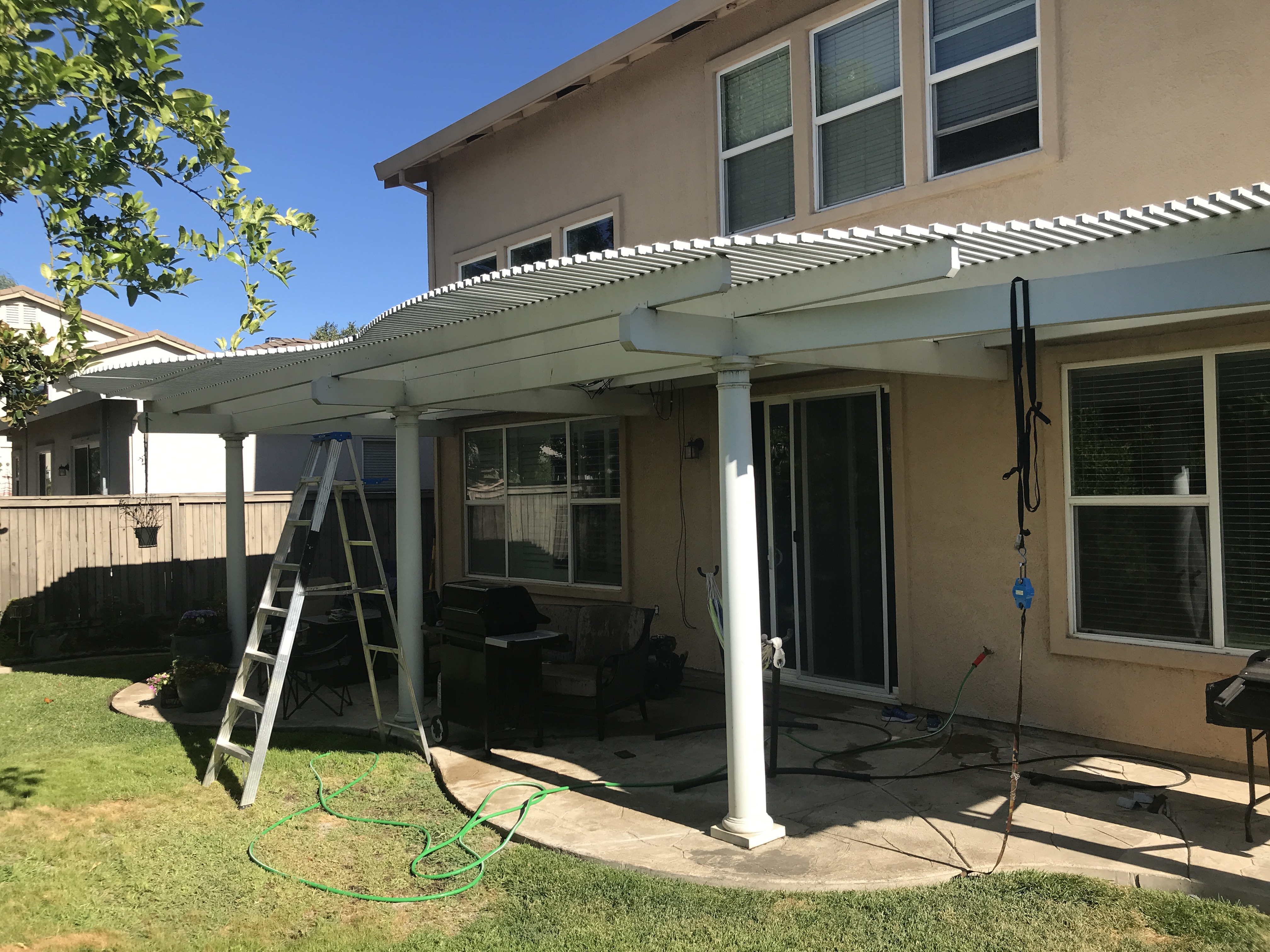

so as the months went by, I would get one new panel every month and throw it up on the patio cover, yes flat, totally horizontal, yes I'm a moron
again this is full disclosure and we learn from our mistakes, at least my back yard faces South, that in the Northern Hemisphere turns out to be desirable (more on this later)
the patio cover is big, so I thought I would cover it all with $100 dollar 100 watt solar panels, and start selling electricity back to our utility company, and make millions !!!

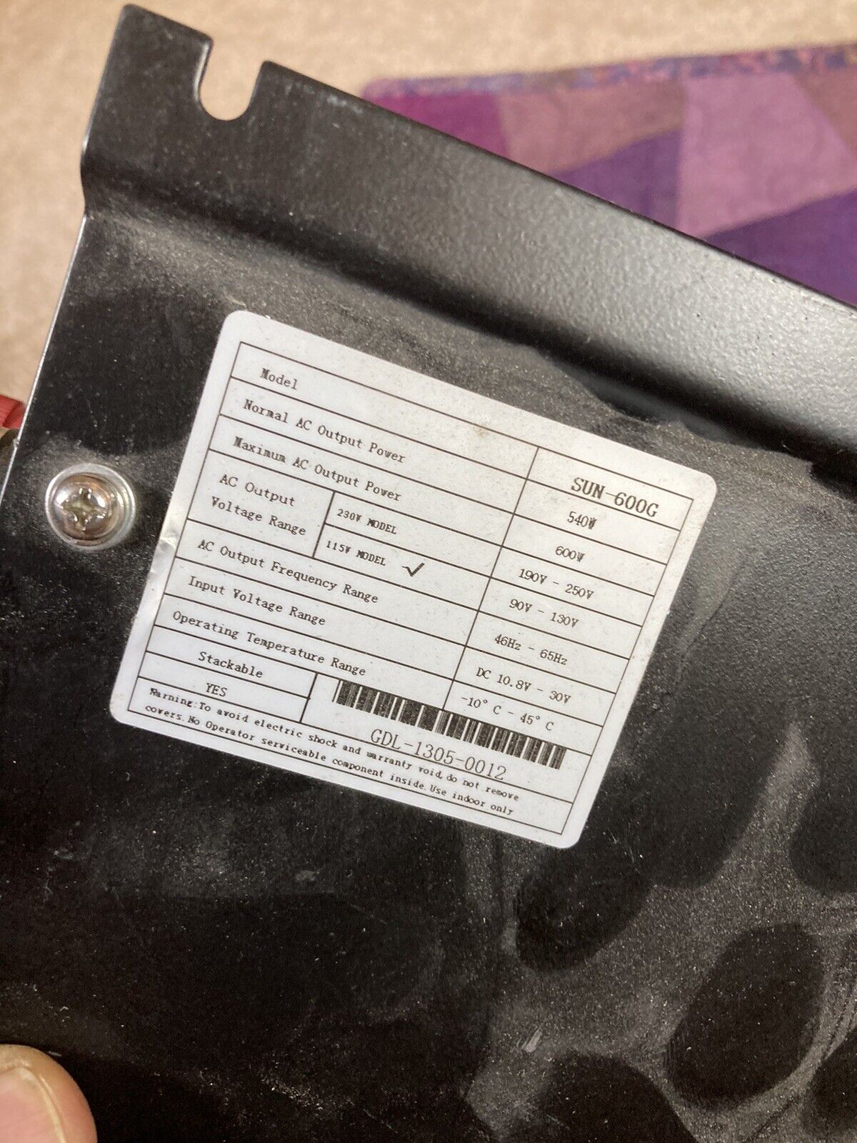

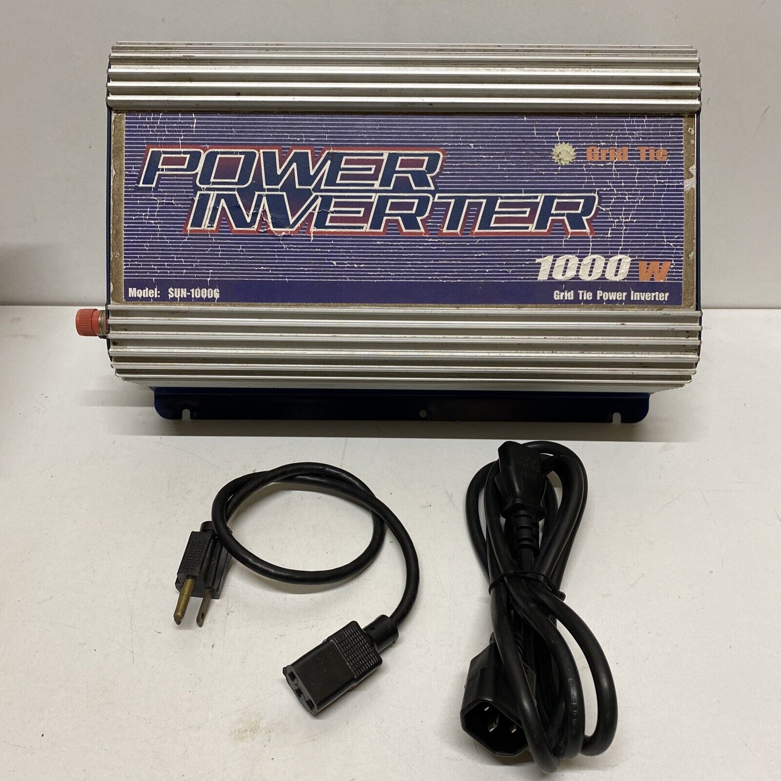

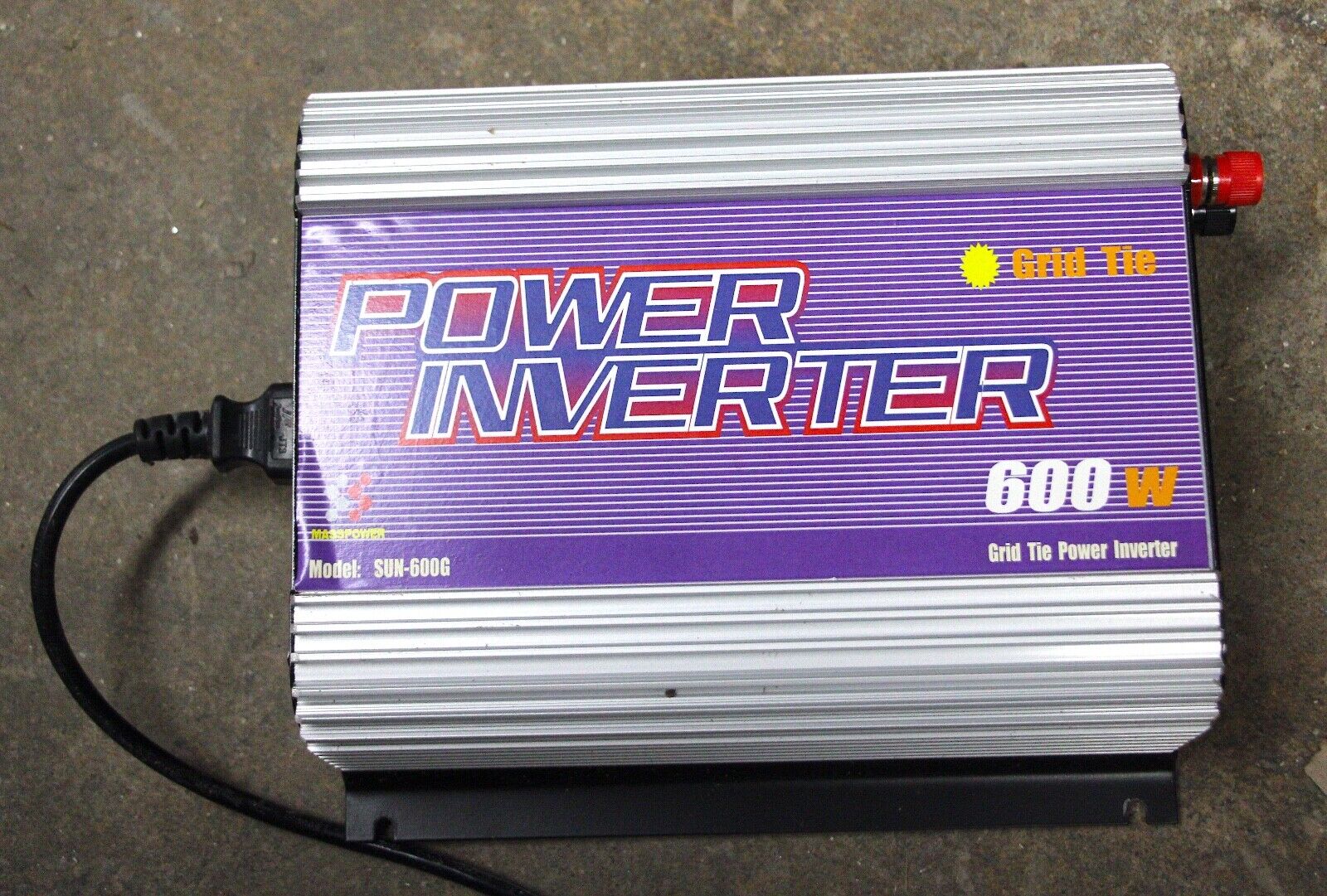

for funnsies here is a little HISOTRY or Chronology of these grid tie inverters, I have tracked them back to 2014 let me know if they go further back
I honestly just recently saw these SUN units (funny how YouTube works, you can't find what you need when you search for it, then it magically appears a few days later in your recommends)
Model: Sun-500
presented by Jeff from Missouri Wind and Solar back in Apr 9, 2014 Sun Grid Tie Inverter Plug and Play Install | Missouri Wind and Solar
Model: Sun-600G on eBay
Model: Sun-1000G on eBay

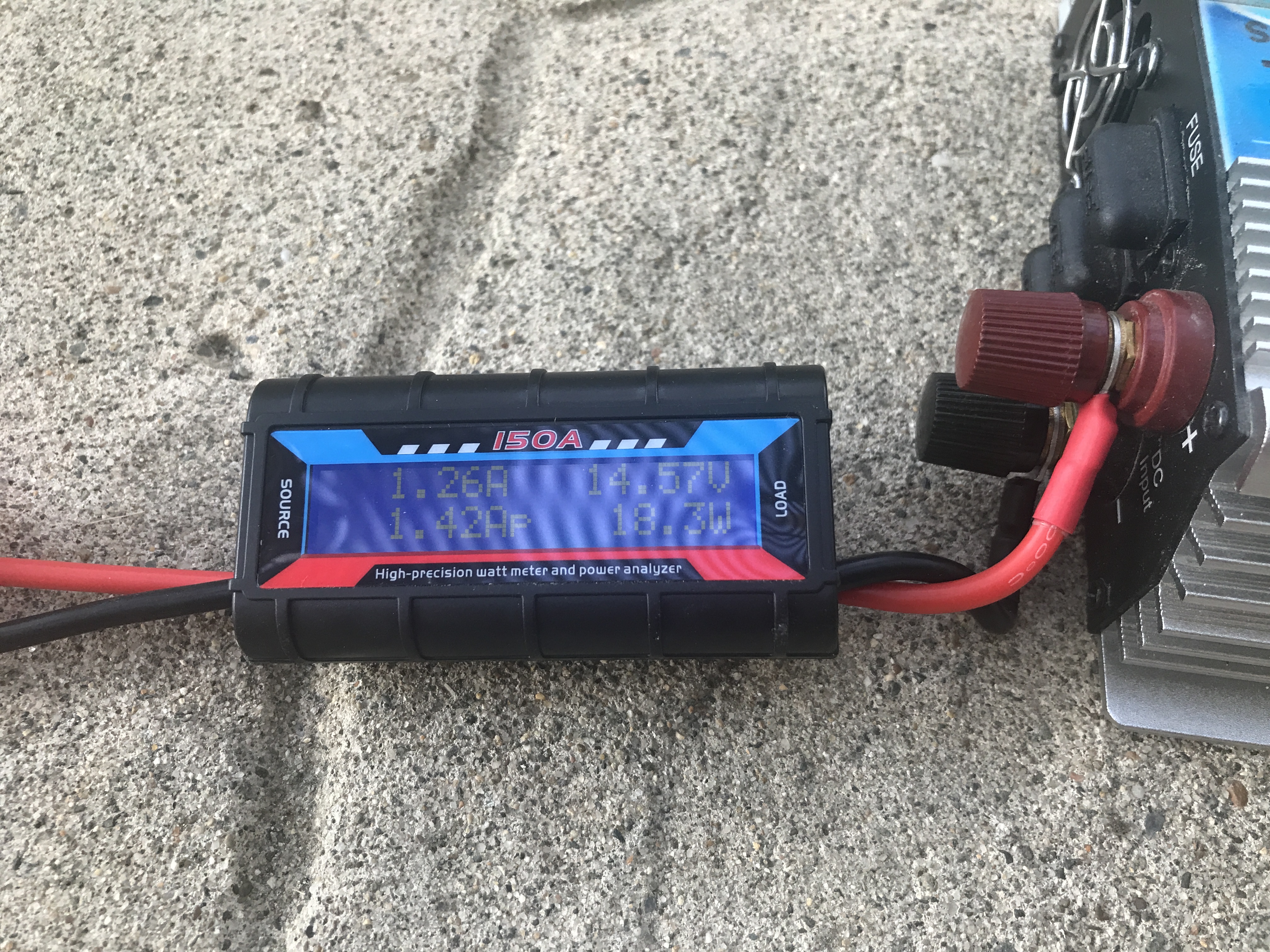

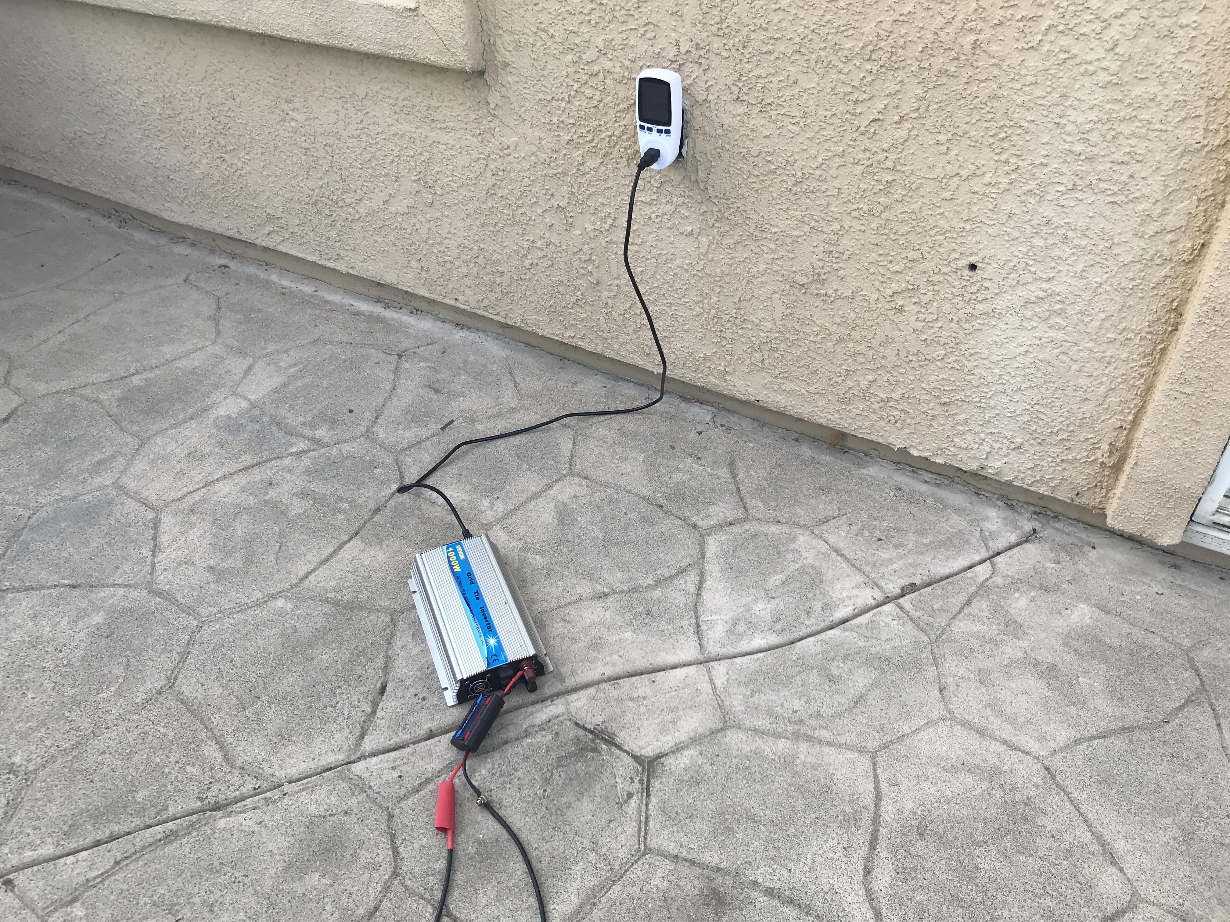

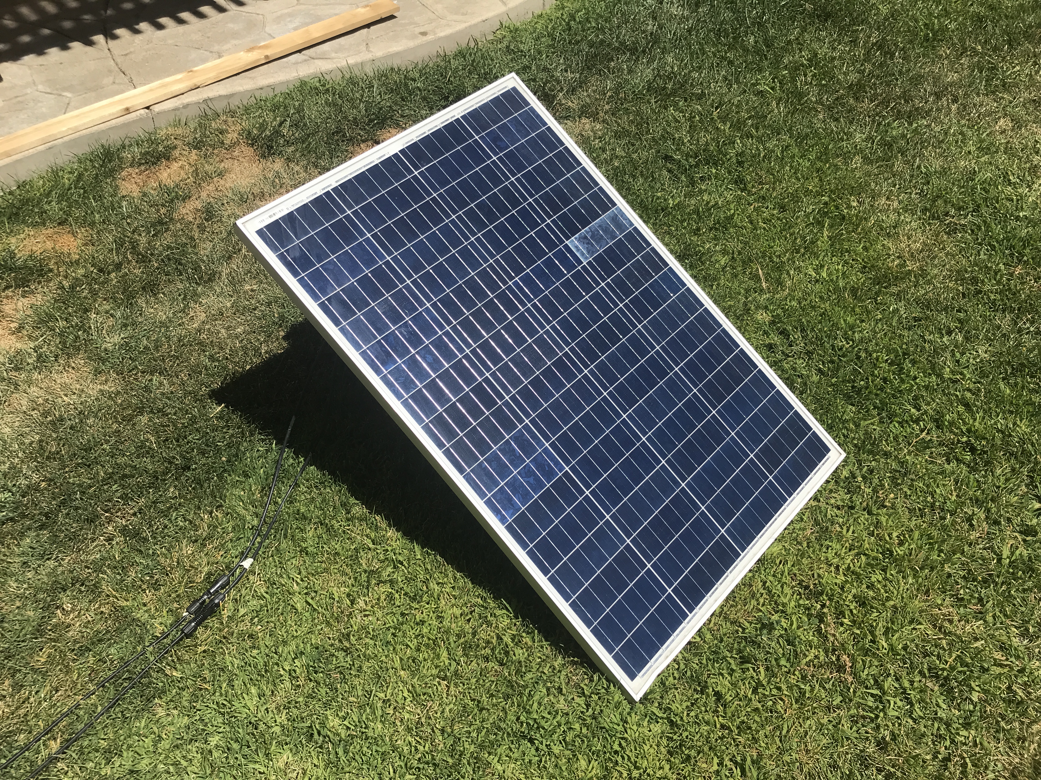

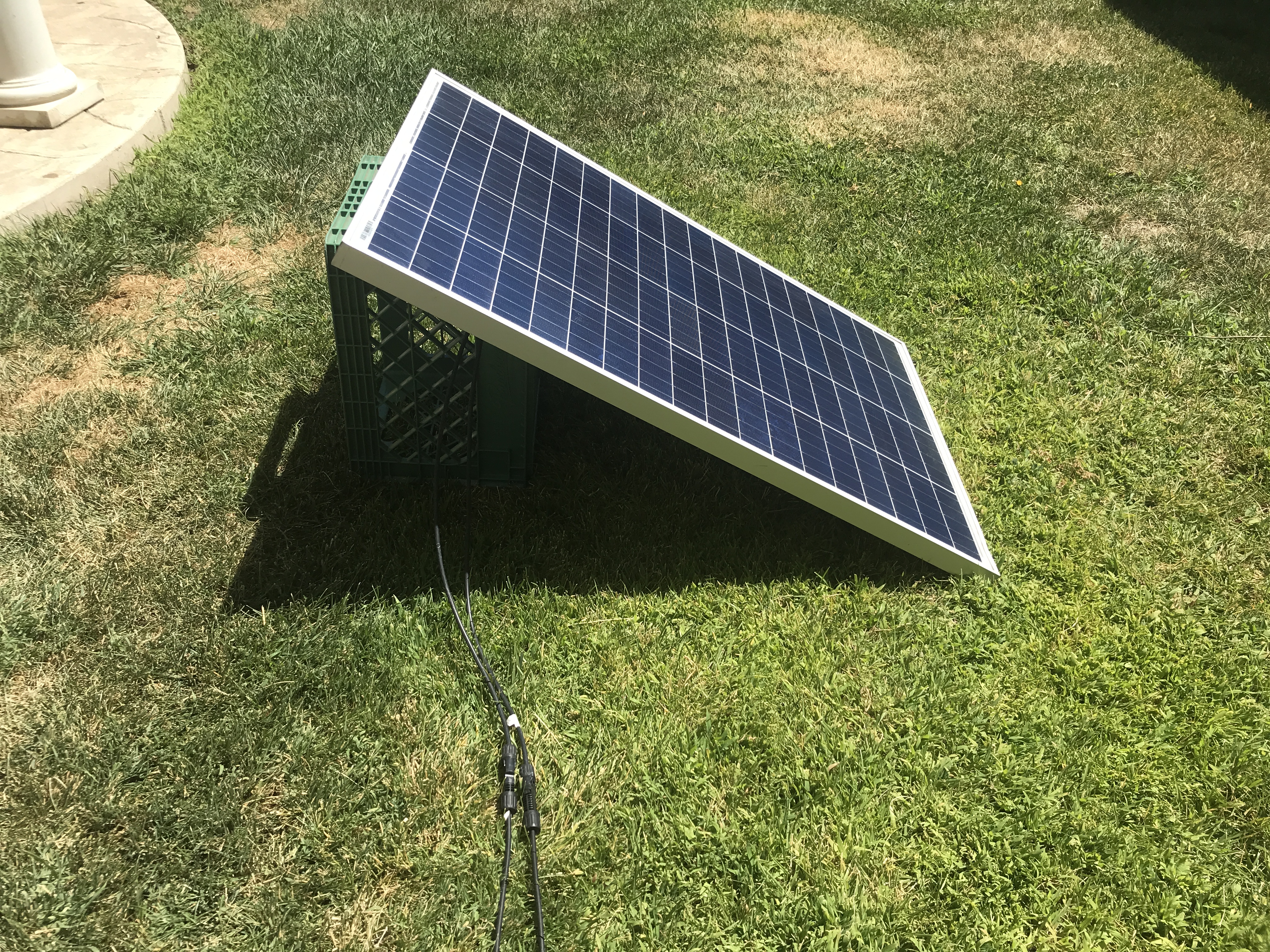

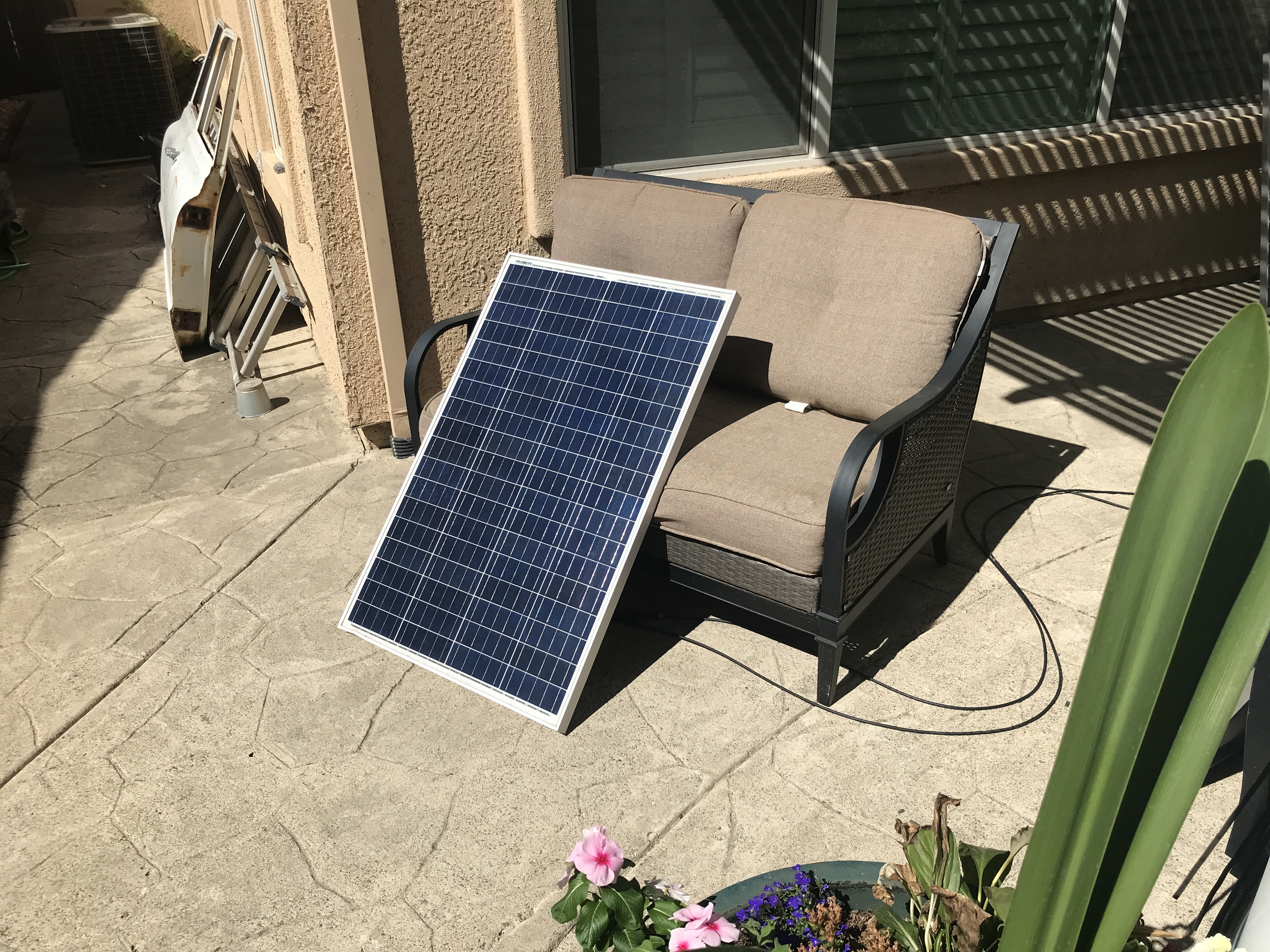

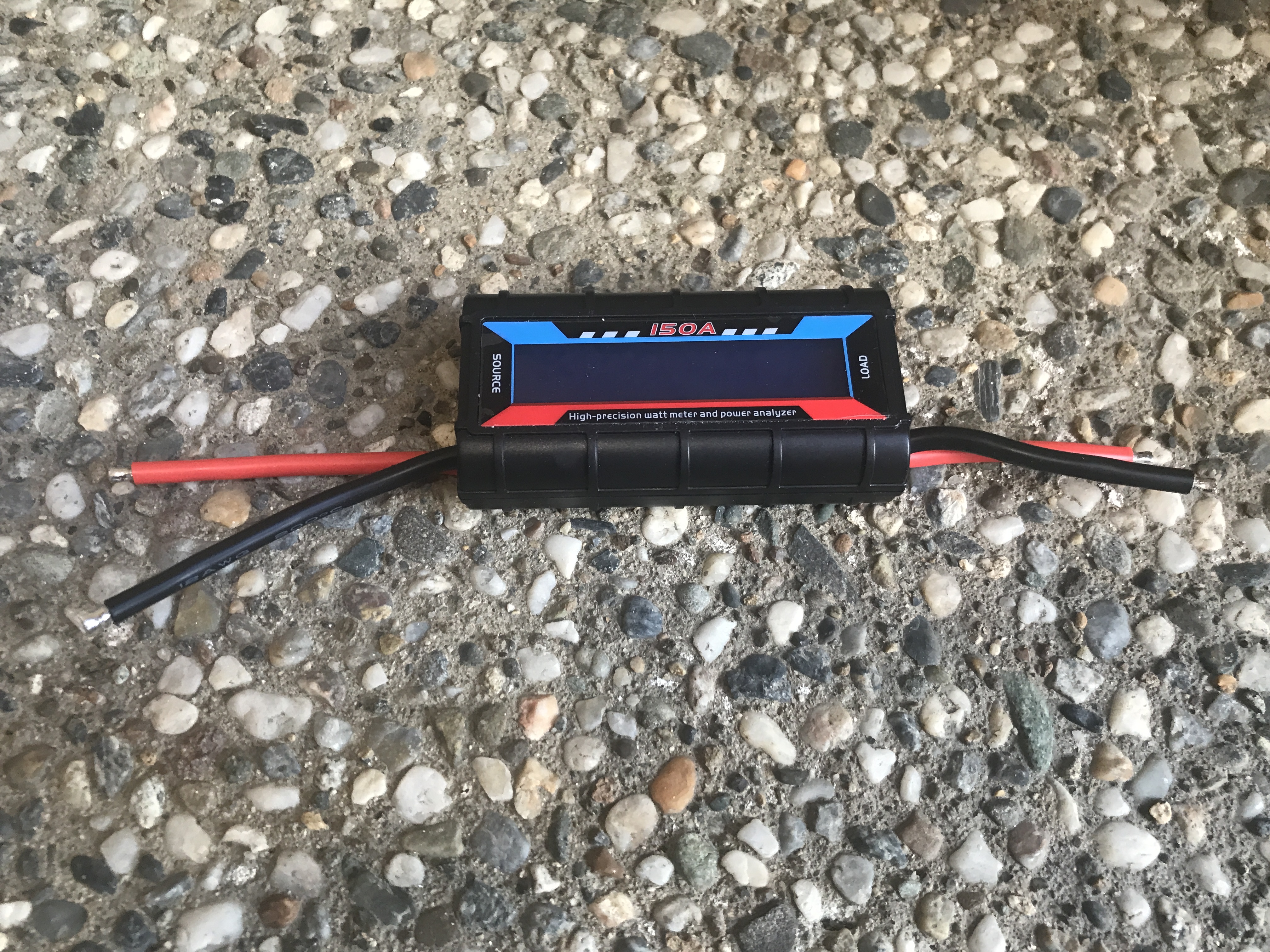

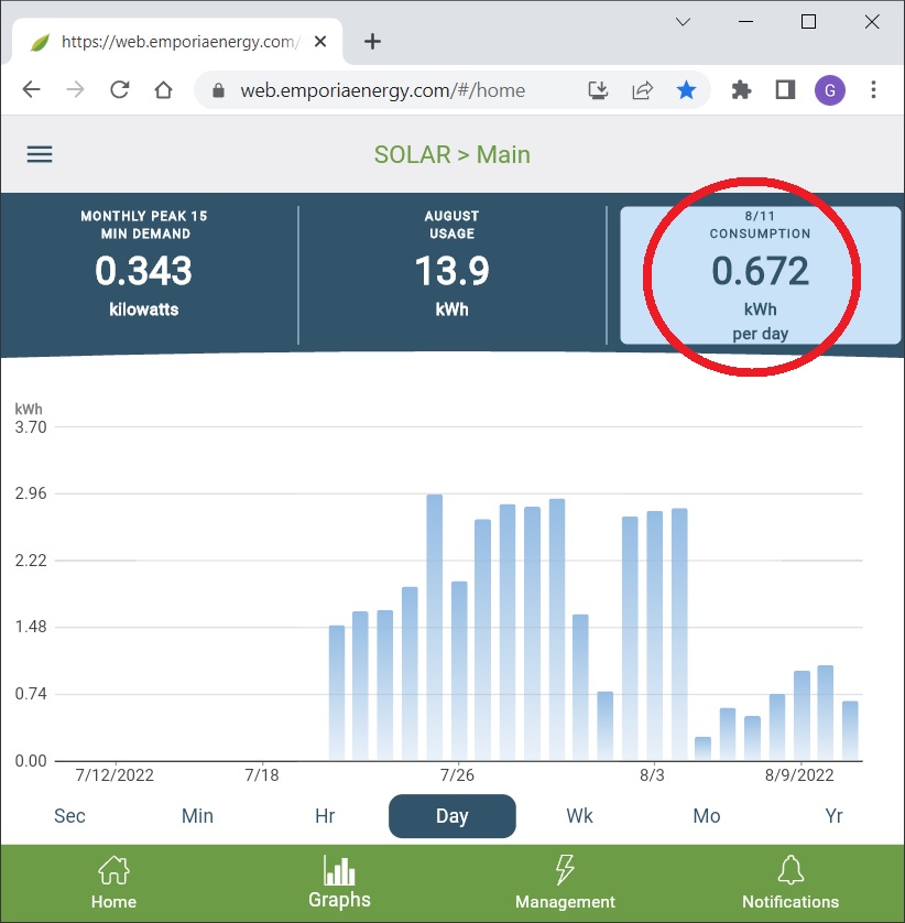

THE MINIMUM $200 DOLLAR SETUP
man learning about this is so much fun, so today I decided to see how much sun could a Greg catch if a Greg could catch some sun with just one panel, a blue Polycrystalline mind you (pronounced: "older less efficient supposedly technology")
Full Disclosure: yes I made a part time job of it, as I kept moving it manually to ensure full sun catchability, but that was not the point, the goal was to see how wide I could cast this single 100 watt 12 volt panel net and how much sun I could capture
this took place in Norther California in August 2022
  • so in the morning we started around 7 am and the panel was pointed East
  • around 11ish we pointed it South
  • and maybe at 4ish we pointed it West
no I am not going to rotate all 10 or so of my panels eventually manually, this was just a fun little test

so one panel/inverter combo pulled, produced 672 Wh of energy in one day, my inverter cost $104 and that panel cost $92 this means that for $1,000 dollars I can get one inverter and 9 panels so this $1000 dollar system has a potential of generating 672 x 9 = 6,048 Wh or 6 kWh for short in one day that's amazeballz
of course this $1,000 limit is just some arbitrary number I came up with so my next goal is to keep adding panels to this 1000 watt inverter to see what's the most watts it can invert, knowing a 1500 watt house circuit is my limit (120 volts x 15 amps circuit x .80 safety margin = 1,440)

Post by Scrappyjoe »
I bet you 20 imaginary bucks you pop your inverter with 9 panels. I mean I hope I’m wrong but it seems too good to be true given the insane quotes I’ve received for an installed 5kw solar system.
Scrappyjoe
Posts: 211
Joined: Fri Feb 25, 2022 3:16 pm
Has thanked: 55 times
Been thanked: 32 times
Re: The Greg's Grid Tie Solar Project
Surely you mean you captured .672kWh with your single panel? Aka 672Wh?
Gregski
Posts: 3171
Has thanked: 635 times
Been thanked: 1611 times
Post by Gregski »
Scrappyjoe wrote: Fri Aug 12, 2022 7:50 amI bet you 20 imaginary bucks you pop your inverter with 9 panels. I mean I hope I’m wrong but it seems too good to be true given the insane quotes I’ve received for an installed 5kw solar system.
that's exactly why I am doing this to prove that you don't need to spend booku bucks on this, you're on, challenge accepted, and nothing says you can't use multiple inverters, so even if you run 5 of these that's only $600 bucks
I bet I will be able to connect as many as a dozen to this beauty, keep in mind these 100 watt panels pull at 70% efficiency at best so 70 watts each if that, I had 6 connected already and plan on reconnecting 6 today I took things apart to add these meters on the DC side
