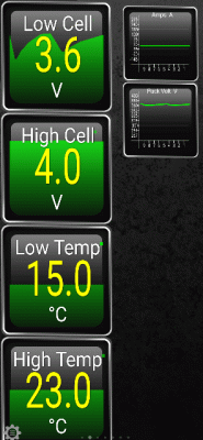

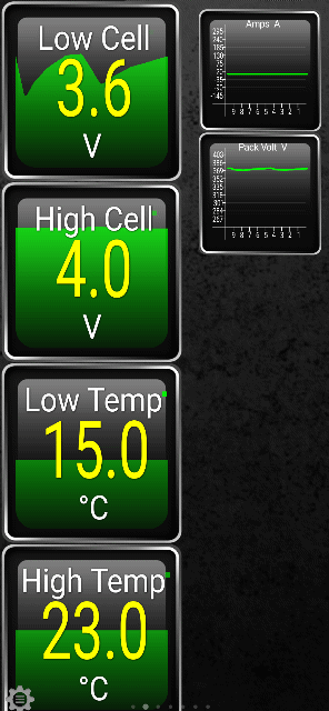

Thank you for the advice. I have been mostly self taught writing code so somethings hit a new roadblock and get a learning opportunity.
The OBD2 Emulation code is working with the Torque Pro app now, its a gif so lick to see the data moving :D
