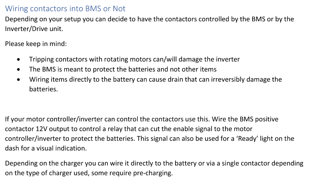

Contactors are low side driven, i.e. pulled to ground by a switch in the inverter or simpbms. You could just hook them up in parallel. If either of the two wants them to close, they close (wired or)
The reason we don't recommend the BMS to run the switches alone is you don't want them to open for some stupid reason while driving. Depending on the logic of SimpBMS that might not happen anyway. Tom would have to chime in on that.

Contacts should be switched by what ever is responsible for the Battery safety. So it only cares about the batteries and shuts the contactors only when the batteries are within operational conditions. If a serious error occurs it should disconnect the pack, this can end up damaging certain inverters that cannot dissipate energy in collapsing magnetic/spinning fields.
If you have a BMS system (SimpBMS / EVS-BMS / Other) the "easiest" way to do it is have the BMS do the contactors. If you want to not have the batteries disconnect during an error you can have the inverter control them or even have a stand alone way of controlling contactors. This then means you are fully responsible for keeping the batteries in their operating conditions (you are anyway since you are designing building and programming your conversion).

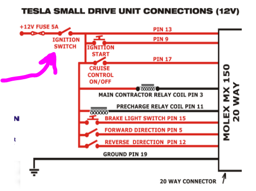

Thanks very much for the reply. I got my SDU board the other day - thanks! I think maybe I should draw a diagram of my quandary but maybe I can explain quickly:
I was interested in the scenario of when the vehicle is at rest and you want to charge: so starting up the charger to spit out 400V but the contactors are open.
I assume when you park the car and switch off the ignition here there the contactors will open:
So how to get them to close so that the pack can be charged? And then when they do close then the inverter will see 400V straight onto its bus unless there is a pre-charge cycle before the charging can begin?

I'm slowly figuring things out from the SimpBMS manual:

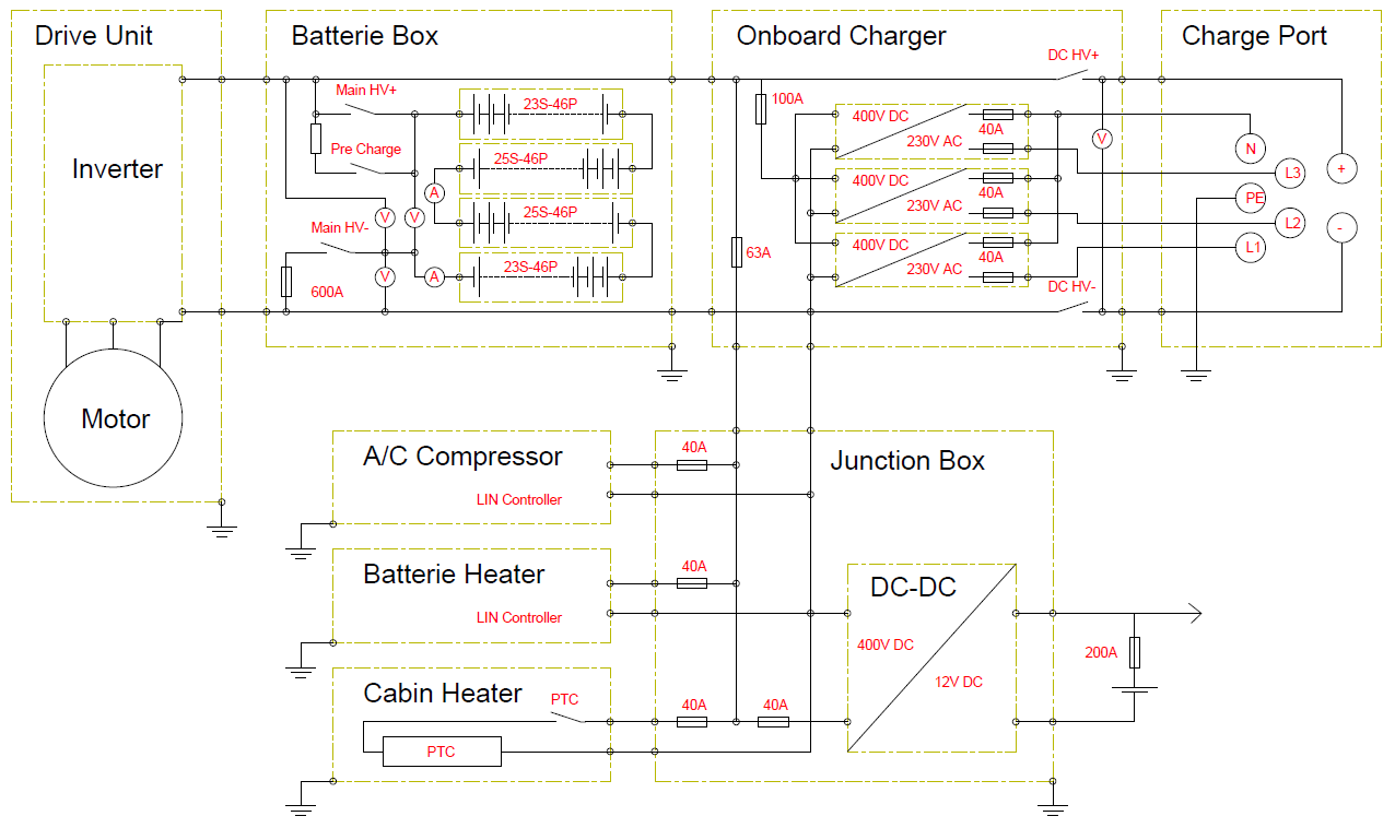

A topic that also concerns me. Here is my current status again. The idea behind this is few, manageable contactors. There is only HV or no HV. Perhaps someone can confirm here that it is not a problem if the drive unit (tesla LDU) is supplied with HV when charging and the charger (tesla gen3) when driving. At least that's how it is with the Model 3. The 12V are switched off. (LDU at charging no 12V, Charger
at driving no 12V)

muehlpower wrote: Wed Jan 25, 2023 10:11 pm At least that's how it is with the Model 3. The 12V are switched off. (LDU at charging no 12V, Charger at driving no 12V).
I feel/think the same, looking at OEM hardware they all (i think) just use one set of contactors to cut the battery off for all HV components at the same time.
To repeat your question:
Do we get the OK to run HV into a
turned off (no 12V) LDU/SDU(/generic) inverter,
turned off (no 12V) gen2/gen3/PCS(/generic) charger and
turned off (no 12V) model-s(/generic) dcdc converter?
I will mark all systems that dont care about HV while turned off green and all that dont like it red.
The list can be expanded if you have more parts where you (dont) know that they (dont) work.
Of course the whole list is kind of useless if all HV parts survive HV while being turned of. But I dont know that (yet).
muehlpower
Posts: 807
Has thanked: 18 times
Been thanked: 188 times
Re: Contactor control during charging/driving
Post by muehlpower »
I have supplied all my devices with HV, without 12V. So far no problems. However, as johannes noticed, it may be that I have small losses at the expense of efficiency. Of course, you also have to note that the route via precharge is always taken and that all devices are at zero power until the main contactor is closed. In my case, this is ensured via CAN / LIN signals and enable lines.
it also seems useful to run the DC/DC converter in both cases, since there is also a 12V consumption when charging. Water pumps and fans for battery cooling are also useful for fast charging and consume a lot of 12V power.

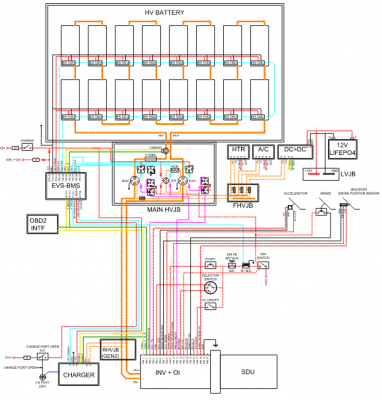

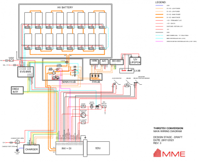

Hi, so I also started out with my idea being around 1) above. I.e. to keep HV away from the inverter when charging but then I didn't have pre-charge on the auxiliaries and more contactors and HV wiring and it seems like its fine to put HV on the inverter when its not doing anything (charging). My Rev 3 diagram in my build post here is like your 1) arrangement: viewtopic.php?p=52044#p52044
So now I've moved onto my next idea which is to use a rear Gen 2 HV JB and just link in the rear charger there so more like your 4) here above but with a "charge switch" on the dash somewhere and hopefully more in line with what Johannes was saying above as well. Like you mentioned this has more 12V wiring etc but less HV wiring. This is shown on my REV 4 diagram here: viewtopic.php?p=52121#p52121
Options 2 and 4 are like you said : more like Elon intended :D
