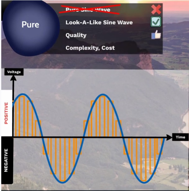

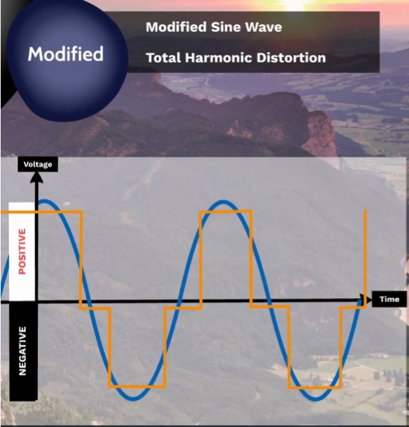

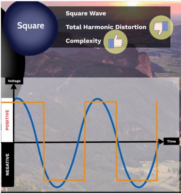

here are some very well put together graphics from this video to wet your appetite
