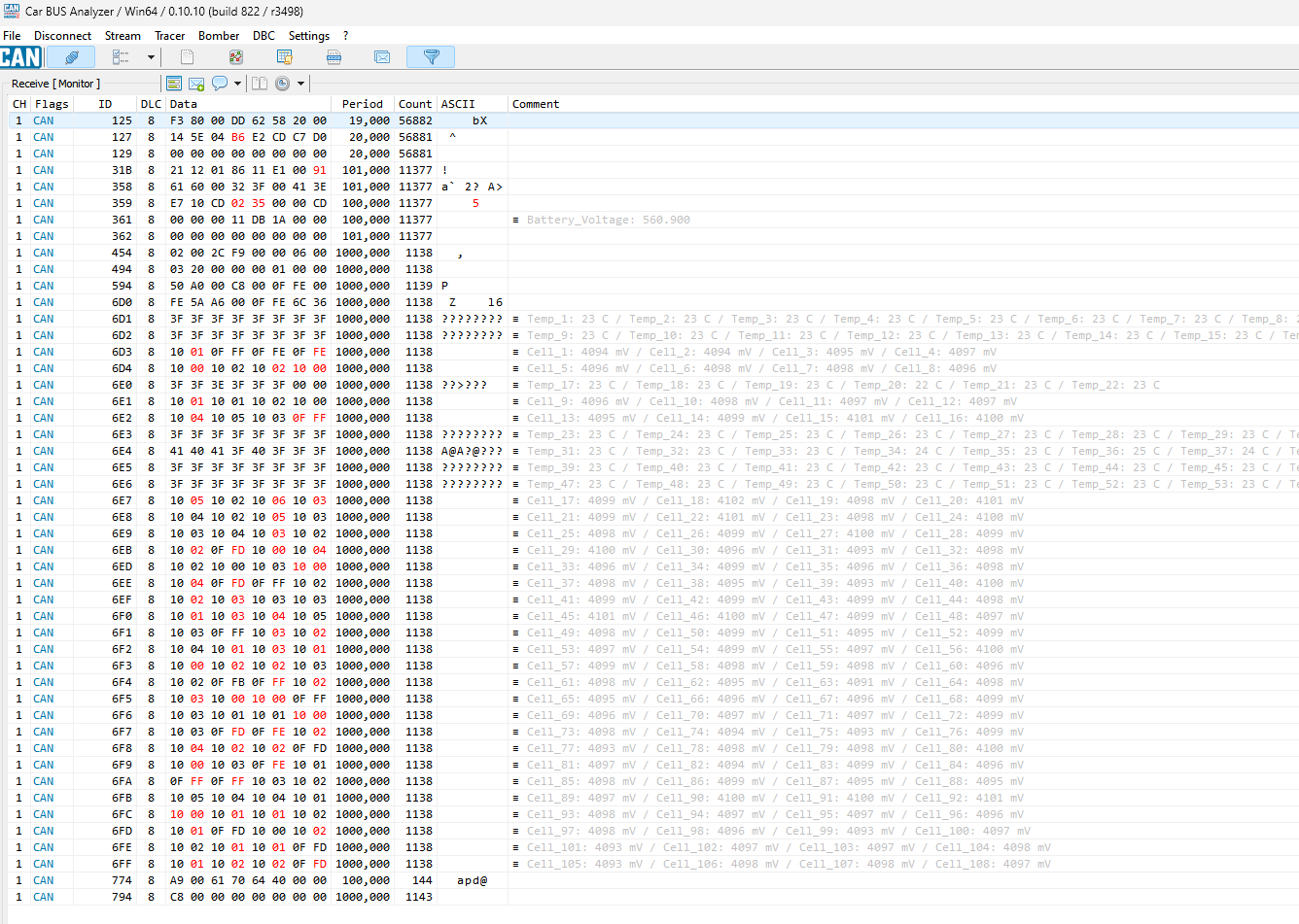

I have only started decoding, some of my findings:
Voltages decoded for all cells, but i dont yet know which cell is in which module! Only the lowest module is known as its accesible!.
Temps seem to be in 6d1 -> 6e6, but have not worked out scaling.
Other observations:
CAN FRAMES:
0x125
on power up
67 40 00 c4 62 58 20 00
on removing the HV measure CON (which has pack voltage on)
67 40 00 00 62 58 20 00
Charging the lowest module with 5Amps through the current shunt
67 40 01 c4 62 55 20 00
back to zero A

I have been playing with this in the last few days. Got a working zombie module to read the cell voltages, unfortunately it's not that practical as it uses most of the available can filters in Zombie so you are not left with much left over to run anything else. Let alone the cell temperatures.
Attached is a canlog of a the BMS master, just with 12v and wake enabled.
Module temperatures I believe are the following IDs. I think the temperatures might be in fahrenheit, one byte per value. Not sure on that though. Seems odd for a BMS from a European manufacturer to use farenheit.
0x6D1
0x6D2
0x6E0
0x6E3
0x6E4
0x6E5
0x6E6
Other IDS apart from voltage, temperatures and what has been details in the first post are as follows. Also included are typical values seen in the log. Most of these do not change for the duration of the log.
0x127
0x129 00 00 00 00 00 00 00 00
0x358 41 40 00 15 47 01 4B 45
0x359 E6 50 BD 18 57 00 00 BF
0x361 00 00 00 01 1D 71 00 00
0x362 no data
0x454 0B C3 2B B7 40 00 14 A0
0x494 0A 60 6A 07 40 0F 80 00
0x594 50 A0 00 C8 00 0F FE 00
0x6D0 FE EA 60 00 0F FE 6C 36
0x794 C8 00 00 00 00 00 00 00

Upon further research on other threads it seems these modules have three thermistors per module. Which match up perfectly with the data from the Can IDs, since 06E0 only uses 6 bytes rather than all 8.
Looks like one byte per temperature reading. No idea which module is which but it's good enough to get a min and max value. I'm thinking it is possibly offset by 50. My log is showing vales around 69-75, which would translate to 19C-25C. The pack was sitting in the sun all morning on a 26C day so its feasible.

Usual european temperature scalings, to pack a temperature into a byte, are
* offset -50°C, resolution 1K
* offset -40°C, resolution 1K
* offset -40°C, resolution 0.5K
Maybe one of these fit.

I have corsa-e battery on bench and also have e-C4 available for can logs,
So far I can confirm that cell voltages are on showing in mV all 108 cells
6D3
6D4
6E1
6E2
6E7 - 6FF
then 54 temperature readings (offset -40C)
6D1
6D2
6E0
6E3 - 6E6
Some logs and DBC file can be found here.
https://drive.google.com/drive/folders/ ... drive_link
I'll keep updating my findings

I've been working on the current sensing and SoC messages this weekend. I'm planning to use it bare bones on my new tractor battery, just have it spitting out voltages, temperatures and ideally current so I can replace the Isa shunt since it seems a shame to not use this one.
ID 0x125
SoC: byte 0, 0.4 scale. That one was quite easy.
Then for current there are two messages:
Load A: byte 2, scale 1
Load: byte 5 scale 1
At first with some of the logs from opelmanta I just ignored Load and got some sensible current readings from Load A. But that only makes sense with low level charging. When running driving logs or fast charging the two values change depending on the load and also charging/discharging.
Here are some spot value examples
No charging or discharging
Load A:0
Load:88
Charging:
Load A: 5
Load: 82
Load A:4
Load: 83
Fast charging 49kw:
Load A: 97
Load: 225
Driving
Load A: 27
Load: 121
Load A: 30
Load: 134
Subtracting 88 from Load when it is over 88 generates some sensible results. As does subtracting the value of Load from 88 when it is under. I can't quite find the pattern to recognise discharging from charging current. Nor the relation between Load A and Load. Load A makes sense for lower amps draws but seems a bit off during higher amps draws like the 49kW fast charging log.
Quite possibly some other bytes might also contribute to current data.
