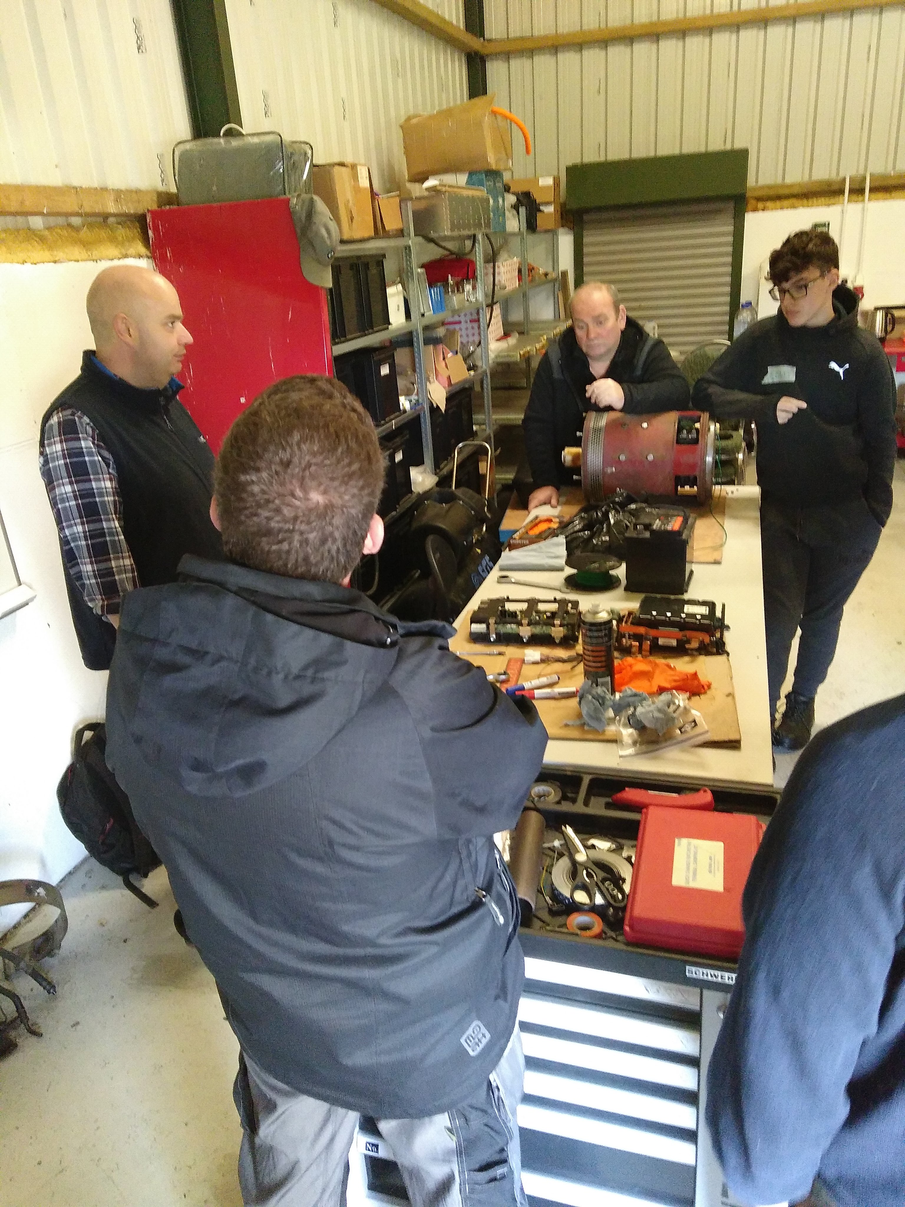

by Kevin Sharpe
On last weeks course the participants built a DC controller using a Toyota Prius inverter... worked very well and available for €100 8-)
