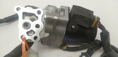

Let's figure out a replacement for the noisy, troublesome external oil pump on the GS450h L110 transmission. I'd like to use one, but not with this problem. Don't make Damien figure this out, he's got enough to do. :)
Here are the facts (which will be updated and collected here, to not have to search the thread)
* There's a second set of optional oil lines sealed with bolts instead of banjo fittings.
* The oil pump's mount has high and low pressure, which Damien said may be good for a 3D printed connector to a different pump, but asked that someone else do it. (been a while since I heard that, not sure which video)
But this inspired another solution:
*** Build an adapter (maybe just plate steel and a hose fitting) to use the current electric oil pump's mount for only the high pressure input from an external pump. Then run an inline OEM pump of similar specifications but not noise. Run a banjo adapter from the lower unused fitting to the pump to the new high pressure input where the old electric pump was.

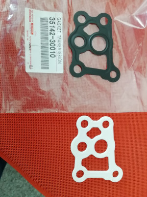

If it helps I've (hopefully) attached some CAD of the oil pump gasket face. BMW use a pump on their auto gearboxes that might be suitable P/N 7834496 from what I can determine this should be fine with the temperature , pressure and type of oil but I haven't found anything about controlling it. They are expensive new - about £450 but are available cheaply second hand. I've got one ordered and will report what if anything i can work out plus CAD of the mounting face when I get some spare time.
oil-pump-gasket-face-20mm.stp
(102.44 KiB) Downloaded 206 times

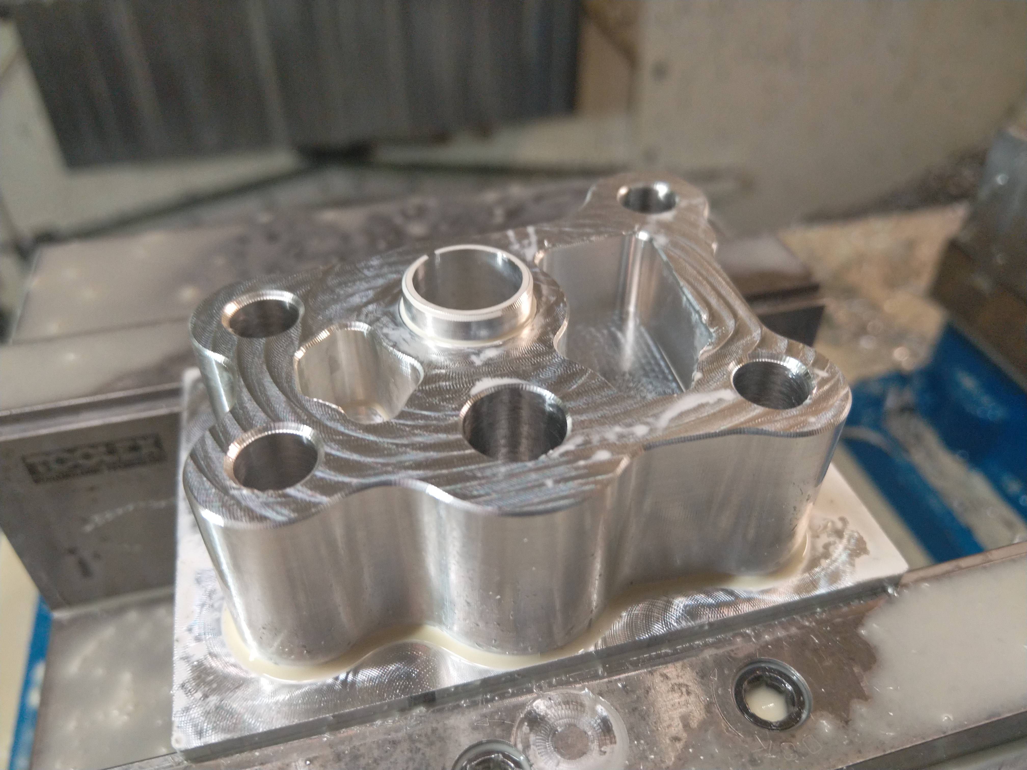

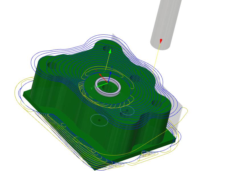

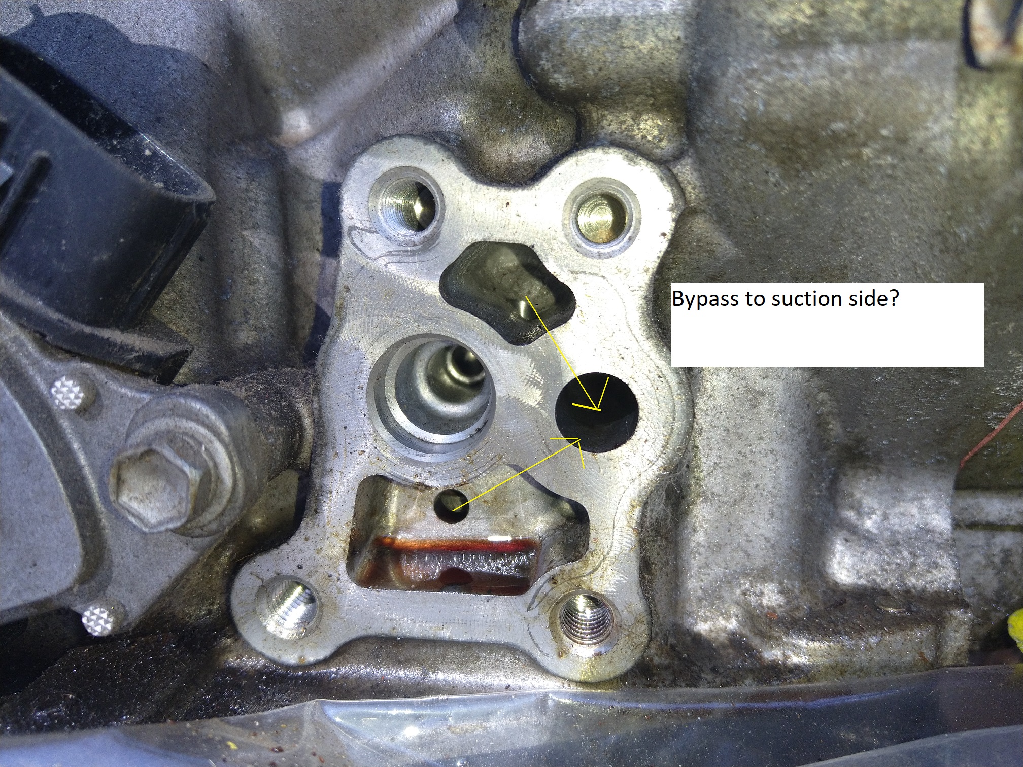

I recently acquired a transmission without a pump and figured it would be a good opportunity to machine an adapter plate for an alternate. My guess is that the left port is the pressure side and the smaller is the suction.
Is it safe to assume that a couple crossover ports need to be made from these two pockets to the suction side?
Since I don't have a pump in my hands I can't tell exactly but it looks like the smaller odd shaped port on the pump goes to nowhere.
The BMW pump looks pretty strait forward to mount but I am also considering a remote pump with a line set to the adapter plate.
Thanks for any insight.

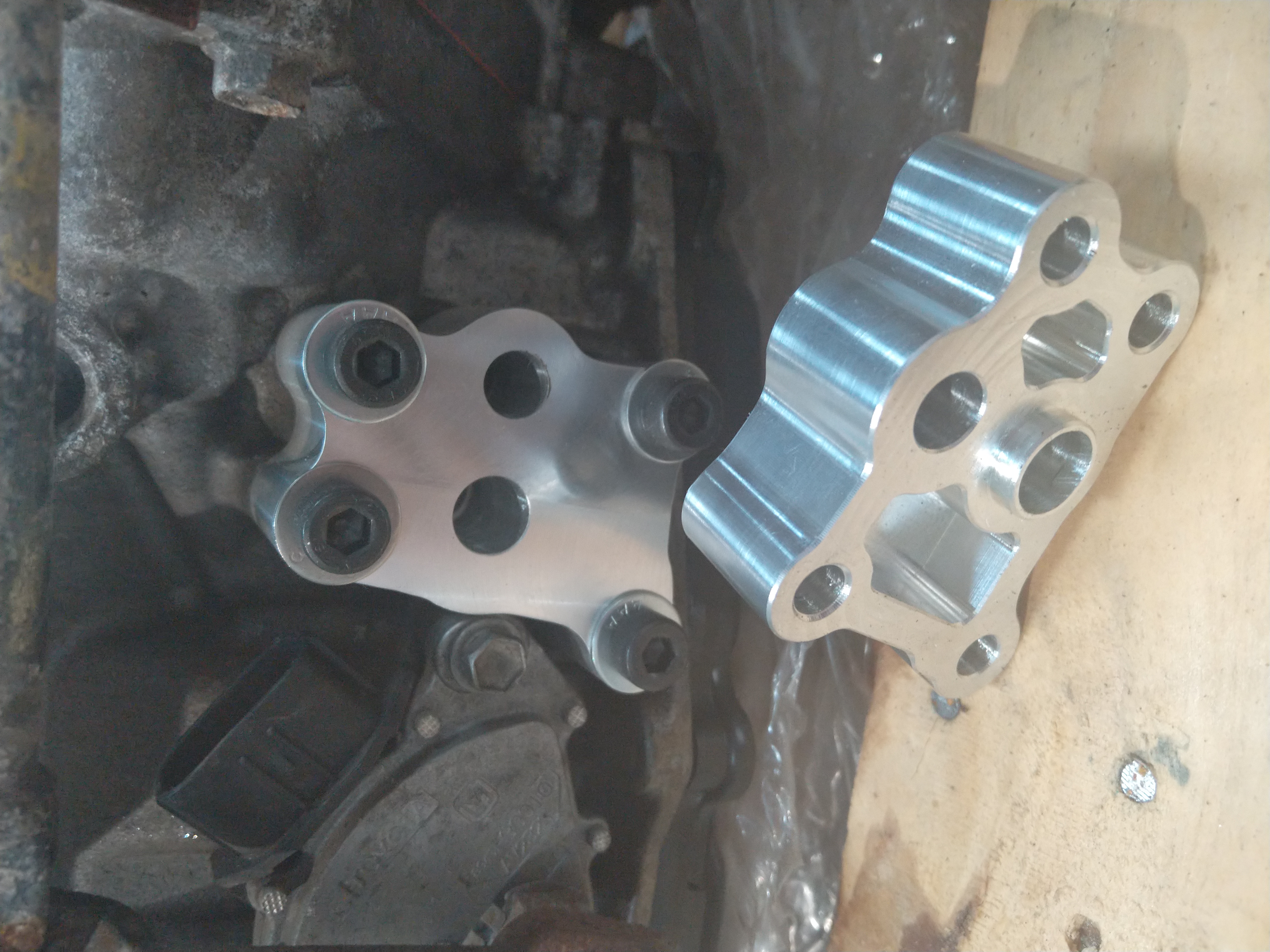

Made some progress. If anyone wants one let me know. No pump yet.

Bustedprop wrote: Wed Oct 19, 2022 7:40 pm Made some progress. If anyone wants one let me know. No pump yet.
Looks like you're a CNC guy too. Nice work.

If anyone wants to keep pushing this forward I just listed adapters on ebay. https://www.ebay.com/itm/175936880476 My apologies for such a delay. I recently acquired an Triumph TR4 that I hope to make some progress this winter. I would also consider bartering for some assistance with my ZombieVerter board.
