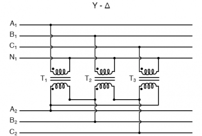

I believe ideally you want 3 transformers. This should give you both the filtering, and a 3P+N output.Pete9008 wrote: ↑Sun Oct 23, 2022 3:54 pm Have thought about this too, for single phase I was wondering whether a 110-240V isolating transformer (of the type used with power tools) would provide enough inductance to convert the PWM to cleanish AC and also provide isolation?
Assume there must be equivalent transformers for three phase but not sure what to search for to find them?
The downside is that I suspect this will be a rather large transformer.

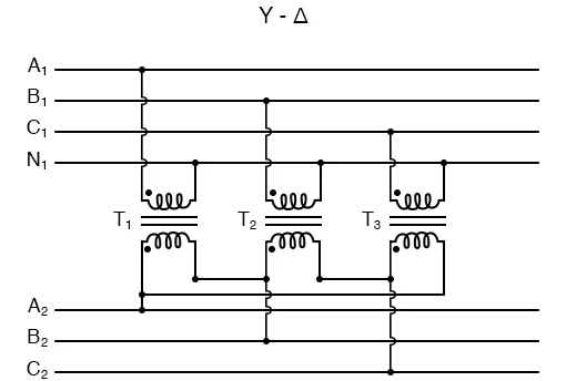

PS: when you have a star delta transformer, the delta gets rid of the third, ninth, twelth and other 'triplen' harmonics automatically.

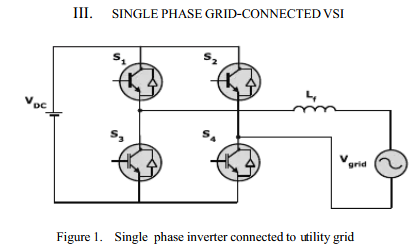

I just happened to see a paper on a full bridge single phase sinusoidal source:
Current for this circuit is ~12 amps peak.
Hope this helps.
from this:
here are the interesting values they use in this paper:Current for this circuit is ~12 amps peak.
Hope this helps.

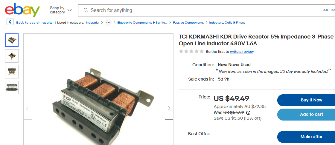

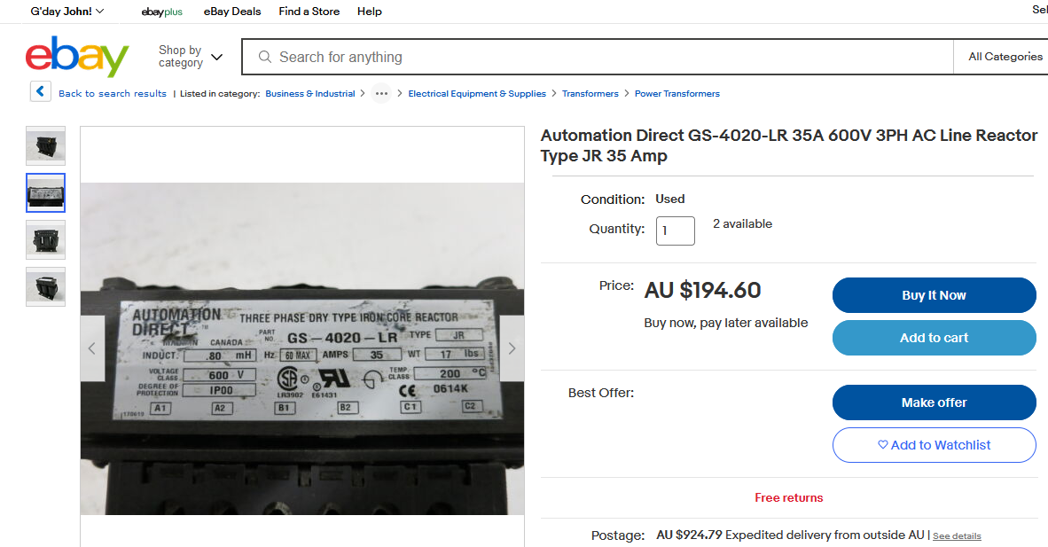

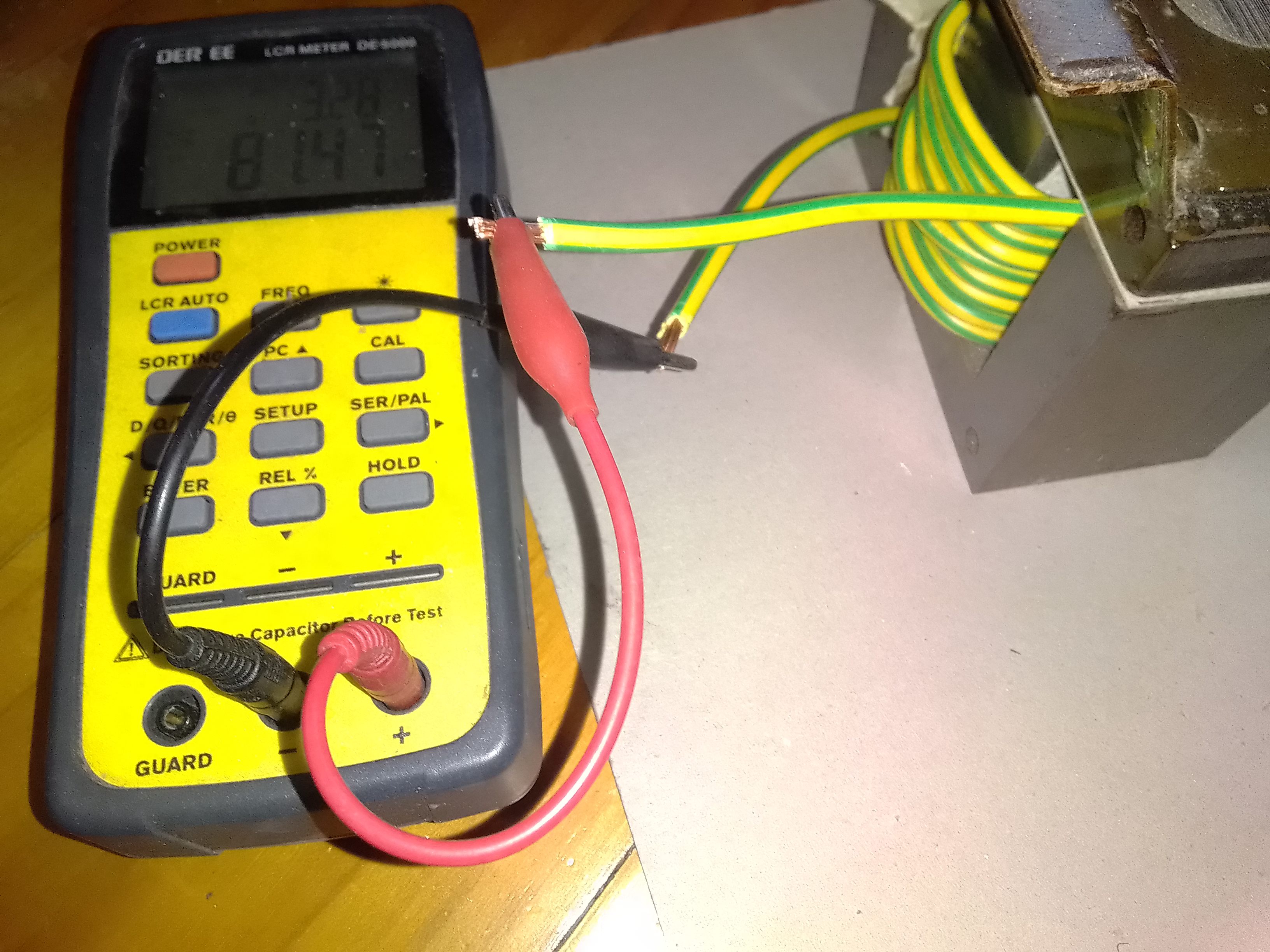

Silly me, you can also get motor inductors that will work perfectly between the inverter and your iron core transformer:
These are specifically designed for Variable Speed Drives, ie waveforms exactly like those out of our inverters

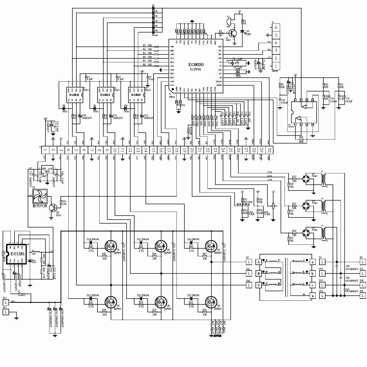

I can offer the board of the generator, which is specially made for the task of the inverter
https://aliexpress.ru/item/100500268781 ... 4aa60dTwYR

I've purchased one of these EGS032 (EG8030 + EG2132) 3PH SPWM Driver Board as decoration for now, though my thoughts were to use for the pure sine wave controller board and the Prius Gen3 inverter IGBT's and maybe some other parts. I really haven't read into the board diagram and circuit in detail. I really need to itemize the pinouts.

Is the LLC Resonant Mode Converter Design a way to go for cleaning up the signal? Appears LC network of some design... though I need to read into more as I've only worked on filters and filter simulation for RF filtering. These high power systems are another challenge with a history and not with the SPWM until more modern times.
Maybe there is a best smallest form factor modern approach?
Wondering..., though the expense will maybe be way more unless somewhere they're found common..., if there are better higher magnetic permeability inductor cores or core material (permalloy, ferrite, Mu metal, metglas, etc.) that can be found or produced to help bring the package size of the inductor(s) down? Seem the other materials are usually for higher than the 50-60Hz apps, though I don't know for certain.
Older welding machines transformer cores come to mind like the MOT cores, though is just a thought and I'm not very knowledgeable of these systems designs and calculations required... though appears very logical, clear and concise as I read around the theory for simulation work for like LC (pi & T?) and other harmonic filtering design.
Also, wondering about potting the inductors if the noise is an issue as I'm familiar with that being done for the audio and RF groups transformers... though again... another expense.
I just have to think 50-60Hz output signal. I know... though I didn't very detailed think about this application until recently.
