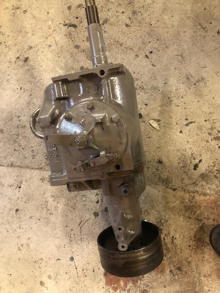

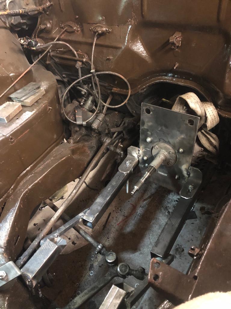

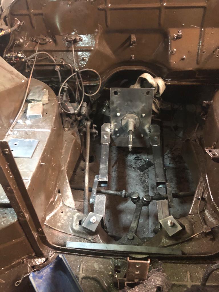

The subrame has been made to hold the original Chrysler gearbox and a Leaf motor. Please note that initially a choice has been made to not use the bell housing but rather weld on vertical plate to attach the gearbox and anoter vertical plate is yet to be welded on to hold the Leaf motor. The gearbox shaft would be shortened to keep the gearbox and Leaf motor as close together as possible (as when using bell housing). 'Love joy' type coupler would be used.
The original Chrysler gearbox looks like this:
The pulley at the end is the handbrake pulley.
Now the person undertaking the conversion would like confirmation or advice how to proceed. Would the initial plan as described above work and how could it be improved on? Or any observations and suggestions of an alternative or better approach welcome please.

pulling the leaf motor in closer is definitely more desirable for space saving. the issue with welding the adapter plate is ensuring correct alignment, welding up an assembly, then getting the mounting holes machined in would be the ideal way forward as welding will cause enough distortion to mess p alignment, and that will cause serious issues with both the motor and the gearbox.

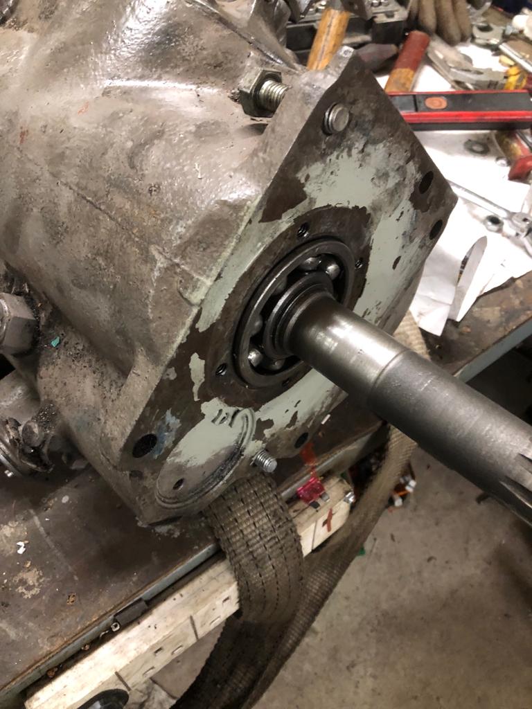

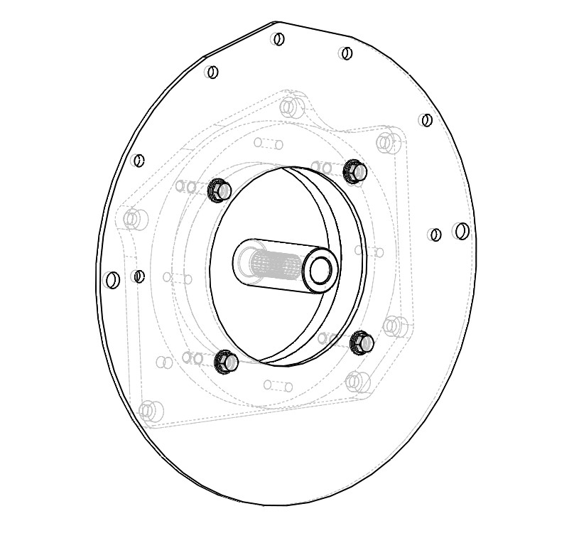

I had drawn up some adapter plate assemblies for it, as he bought a coupler and one of my nema b-face leaf adapter plates. I had integrated the bearing cap into the t5 adapter plate, as the original one sticks out quite far.
this is a input shaft from a t5 gearbox
you could take it out, get it machined down and have a leaf coupler welded to it, or cut it shorter and re-splined for a stub flange of some sort.
there are many differnt eras of the t5, and many rebuild kits, gears, etc for them. they can take some power for sure, but how many hard 160kw launches? not sure. lucky they are used in everything, so they are easy to come by. but i dont see any real issue with it

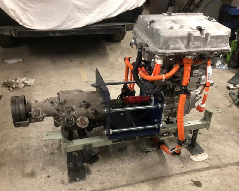

The Leaf stack has been attached to the Chrysler's gearbox. Will be doing a test spin in the next few days and this should reveal if there are any alignment issues/vibrations. Please let us know your thoughts 😊
Posts: 1156
Has thanked: 246 times
Been thanked: 469 times
Re: 1949 Chrysler conversion advice needed please
thats quite the distance! a support bearing might be a good idea. but id just bore out the input gear and weld in the leaf splines. so the motor shaft goes into the gearbox.

We tried to spin the motor with the current coupler and it does wobble and shake at low RPM, so not so good so far.

m.art.y wrote: Wed Mar 22, 2023 2:43 pm We tried to spin the motor with the current coupler and it does wobble and shake at low RPM, so not so good so far.
stack your assembly vertically, loosen some of the bolts, and run the motor, it should help align the setup. then tighten everything down. this should help

Leaf EM57 gearbox coupled to 1949 Chrysler M5/6 gearbox. Vibrations reduced to a minimum but is that good enough? 😊
