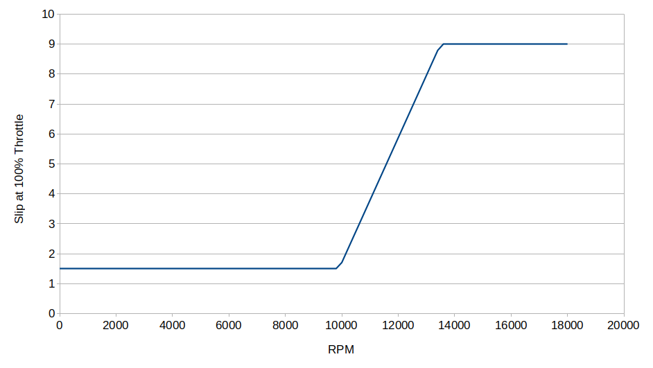

fslipmax is the amount of slip applied at 100% throttle below the speed defined by fweak (330Hz, 9900RPM).
fslipconstmax is the amount of slip applied at 100% throttle above the speed by fconst (450Hz, 13500RPM).
Between fweak and fconst, the slip varies proportionally from fslipmax up to fslipconstmax.
So in your configuration, slip will be 1.5 up to 9900RPM, 5.25 at 11700RPM, and 9.0 at 13500RPM. I've attached a chart showing this curve.
Torque and acceleration are the same thing (if you ignore air resistance) (because acceleration is force divided by mass, and force is torque divided by your wheel size).
Torque is controlled by a combination of slip and voltage, but slip increasing from 1.5 to 9.0 over such a small RPM range will likely be very noticeable.

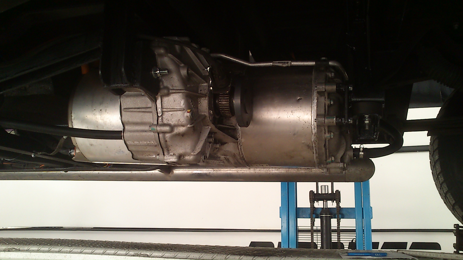

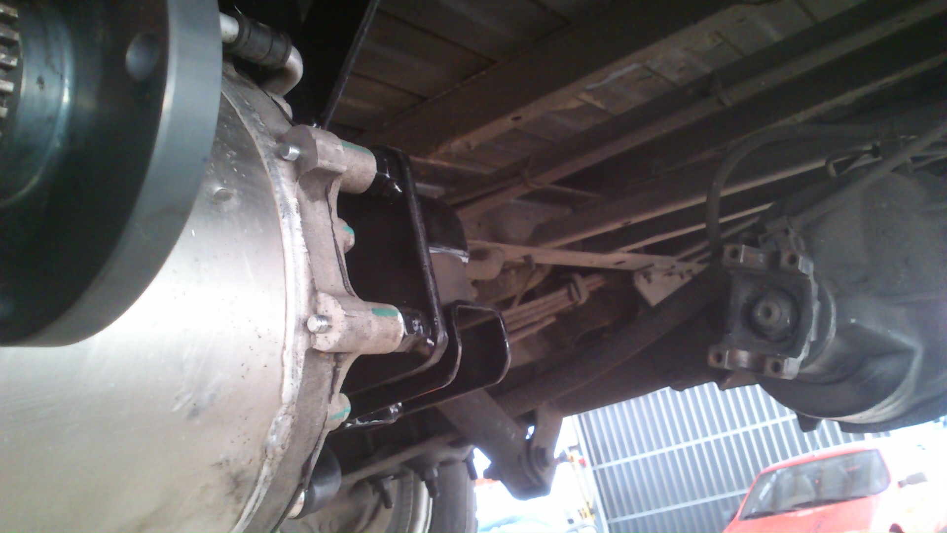

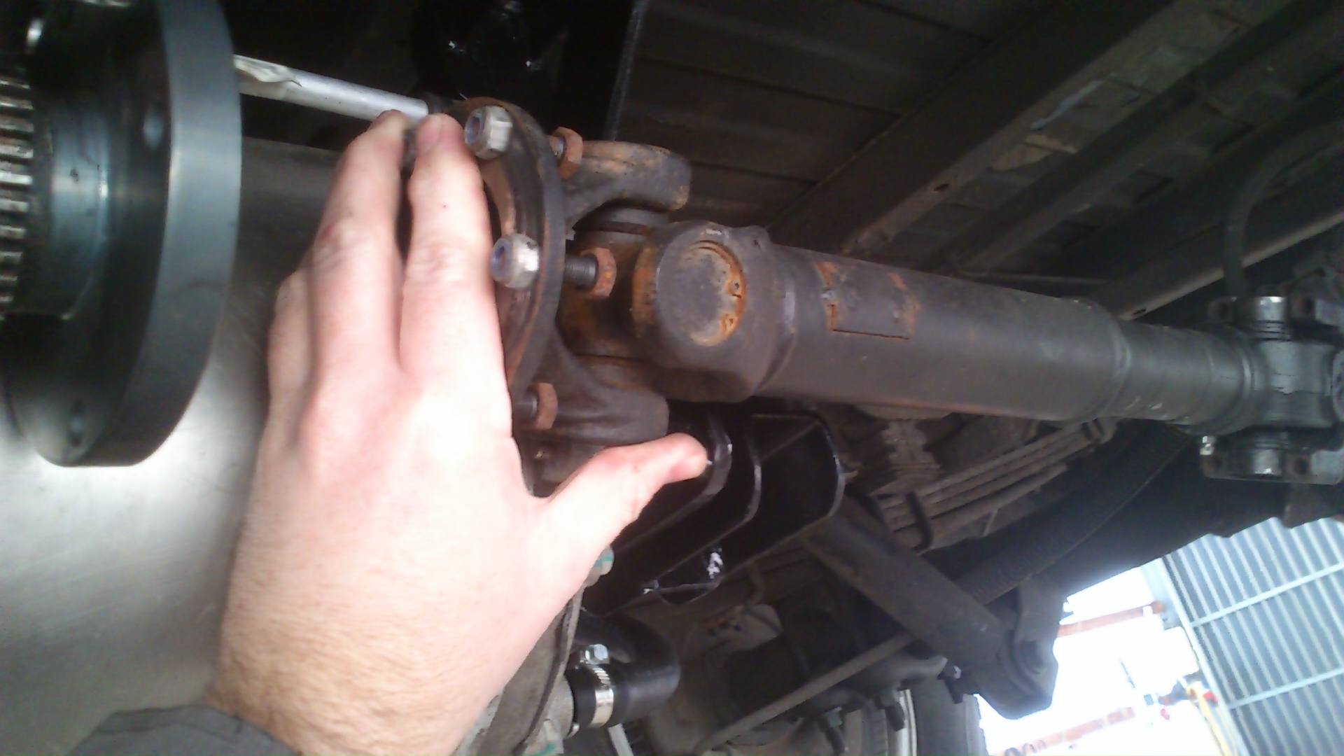

Hi, have you mounted the LDU sideways and run rear differential via cardan shaft from LDU gearbox? You're only using one output from LDU gearbox? The other one is plugged? How are the gearing ratios and performance when it's used like that? Wonder if this can be done with a Leaf motor/gearbox combo too?
Re: Tesla LDU Overcurrent Parameter Problem
Yes we have changed the LDU gear ratio, there is a conversion kit for that:
https://zero-ev.co.uk/shop/teslagearse ... y=48#attr=
Then I fixed the differential and had a shaft built with which I can get the power from both LDU outlets on one side of the LDU. You have to check whether this is also possible with the Leaf engine. It is important that you include the wheel size and the translation of the rear axle drive of the vehicle in which you want to install the engine in your calculation.
