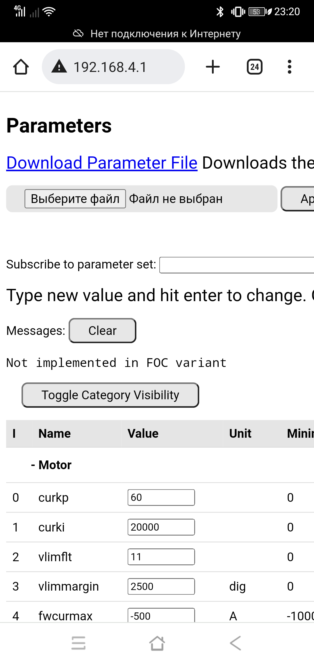

I tried to configure a new motor with firmware 5.25.R.foc and received messages that it is not available for her. sending the "start 2" command or pressing the "start manual mode" button gives the answer "not available".
how do I set up current and voltage sensors now, as well as search for the offset angle?

now there is an understanding of how to set up syncoffs. but how to set up the amplification of current sensors and voltage measurement?

Johu, I respect your time spent on answers. I am well aware of the description from the link and I would not dare to distract you for nothing without using the search. However, when I enter "start 2" I get the same system response as in my first post: not available for foc.

Think, Romale, think :P
So I will repeat my carefully chosen words
I was kind of sick of the manual mode not working so now I have replaced it with something different: manualstart
Manual mode is gone, use normal run mode, however you trigger it
