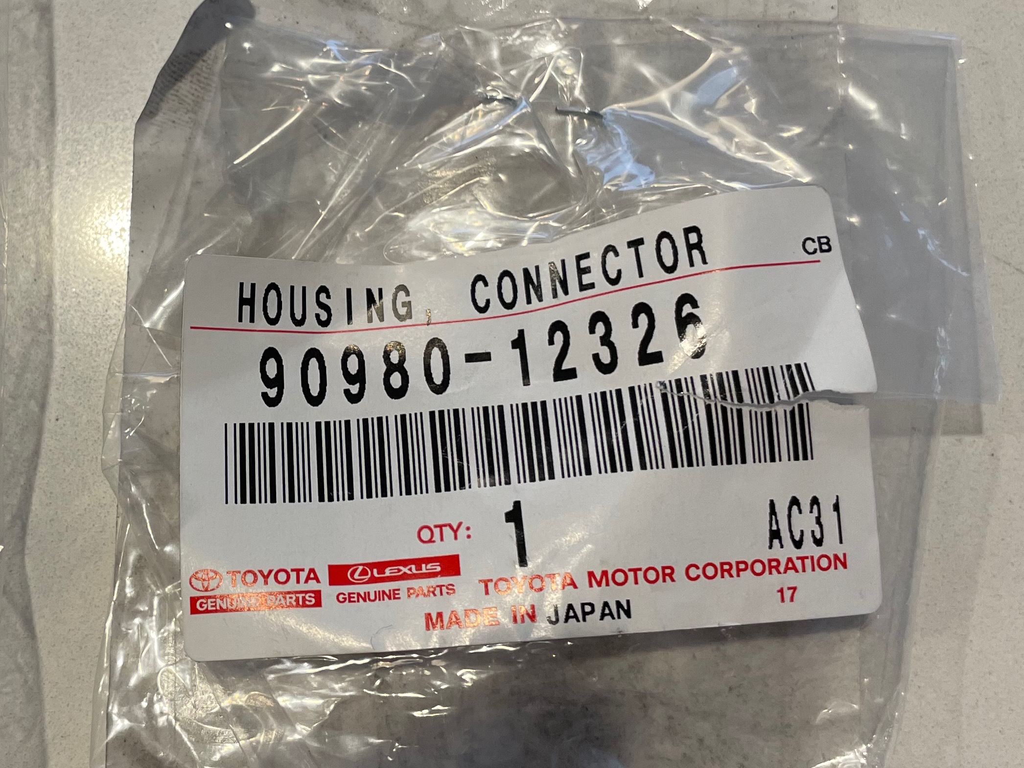

DkubusEV wrote: Fri Dec 30, 2022 10:41 pm Hi Zechy, I'm curious as to what was the problem with the serial wiring connection prior to finding the problem? (Asking so that I and possibly others can try not to make similar "rookie" errors in our connections). Cheers mate
My lesson learned: Take your time and do the wiring and connectors perfectly. It will come back to bite you if you don't.
I didn't have the connectors from the wiring harness, so I had to make up my own.
I ordered the connectors from my local Toyota dealer
But then I didn't have the correct pins/terminals and used what I had. The terminals were too tight and didn't fit properly but looked liked it would work. Motors spinning but then stopped after a few seconds. A few days later when I tried again the motors wouldn't spin at all. Then I realised I had a wiring using.
I redid the main connector and resolver connector with terminals from RapidCables.com.au (https://www.rapidcables.com.au/8100-345 ... .22-0.35mm) and paid careful attention to crimp them as well as I can.
Problem solved.

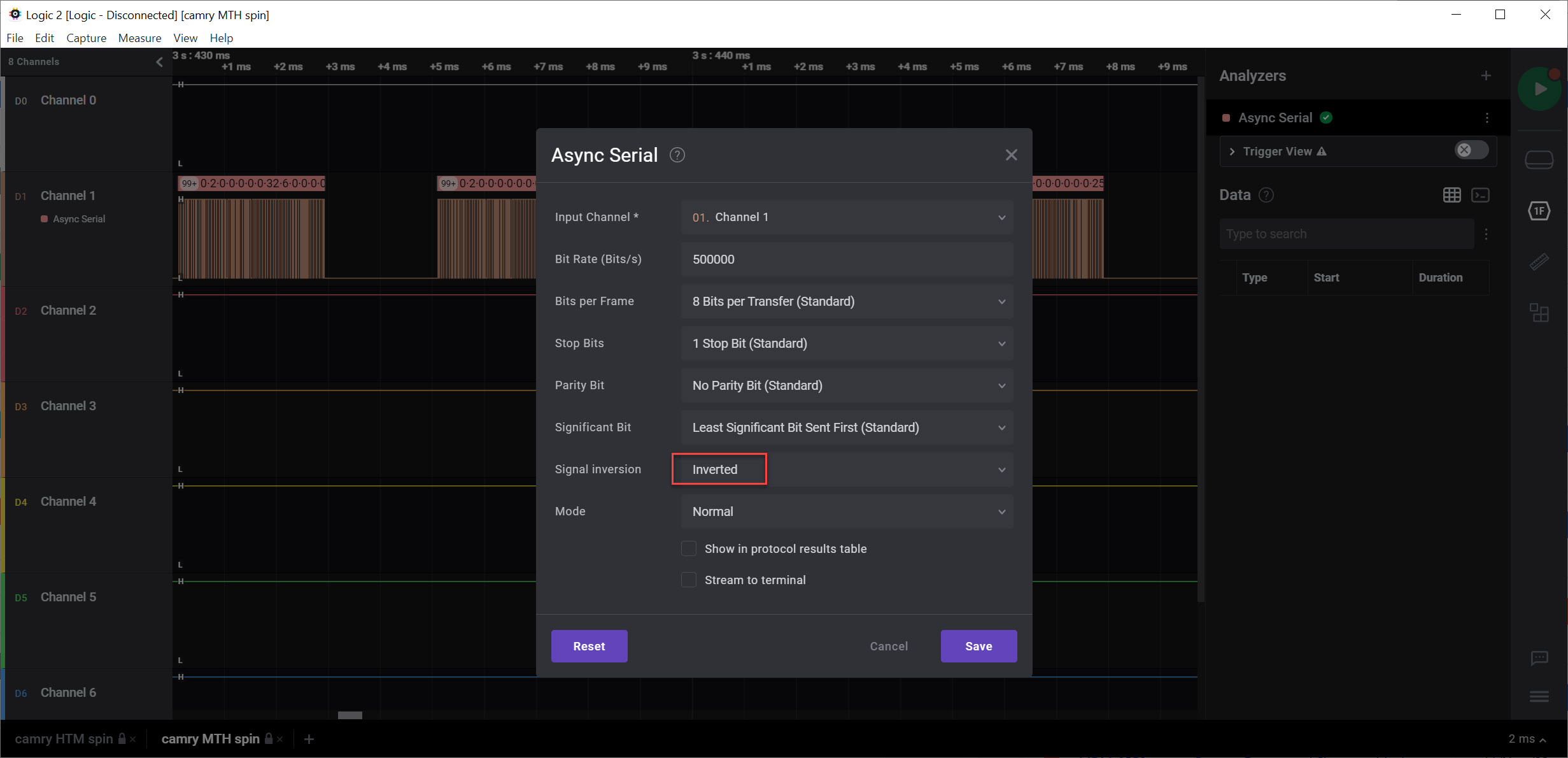

Re: 2012 Camry Inverter AVV50R
Posted: Mon Jan 09, 2023 6:39 am
by Zechy
I captured some MTH data using Saleae Logic. When I use these settings, the data looks correct:
I get 140 columns for MTH
Camry Spin MTH.xlsx
Sample Data
(7.11 MiB) Downloaded 406 times
Posted: Mon Jan 09, 2023 8:37 am
by johnspark
:lol: Thank you Zechy, this works
