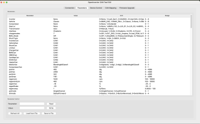

I have written a new command line tool called openinverter_can_tool which may be of general use. It allows the configuration and control of an openinverter system entirely via a CAN bus adapter connected to a PC rather than the conventional web interface and serial connection. I need to build such a facility to allow my Tesla M3 inverter port to work but it may be of interest to others.
The tool should run on Windows, Linux and MacOS machines with almost any CAN adapter. I've only tested it myself on Linux with an Innomaker USB2CAN. It works with stm32-sine 5.24-R or newer only.
It's easy to install just run:
pip install openinverter_can_tool
Linux users check the docs for additional packages it may be advisable to install directly.
Once installed you need to bring up the CAN bus (on Linux):
sudo ip link set can0 up type can bitrate 500000
Then you can query parameters:
$ oic -d parameter-databases/stm32-sine.5.24.R-foc.json read brakeregen
brakeregen: -13 [%]
or change them:
oic -d parameter-databases/stm32-sine.5.24.R-foc.json write brakeregen -30.5
You can also dump out the current value of all parameters and values on the device. Finally you can list all parameters and values known to the tool.
The source is published on github: https://github.com/davefiddes/openinverter-can-tool
The tool requires a "parameter database" of all of the available parameters on the device. At the moment this has to be generated by the build process for the firmware. I have some example databases for the current stm32-sine release. The code that generated these runs as part of the firmware build process. I have published this on a branch here: https://github.com/davefiddes/stm32-sin ... ase-export. In the long run I hope to figure out a way of allowing the database to be generated on the fly on the device and sent over CAN. What I've done here is a temporary hack to get something running.
Going forwards I hope to get CAN parameter map reading and writing working next. After that any remaining capability needed to be able to control the inverter entirely via CAN. The eventual aim is to be able to run an openinverter system with this tool and SavvyCAN (for realtime data logging).
If anyone wants to help out with documentation on other platforms and CAN interface adapters that would be great. It should be very straightforward to get the tool running with the stm32-vcu, you just need to generate a parameter database file.

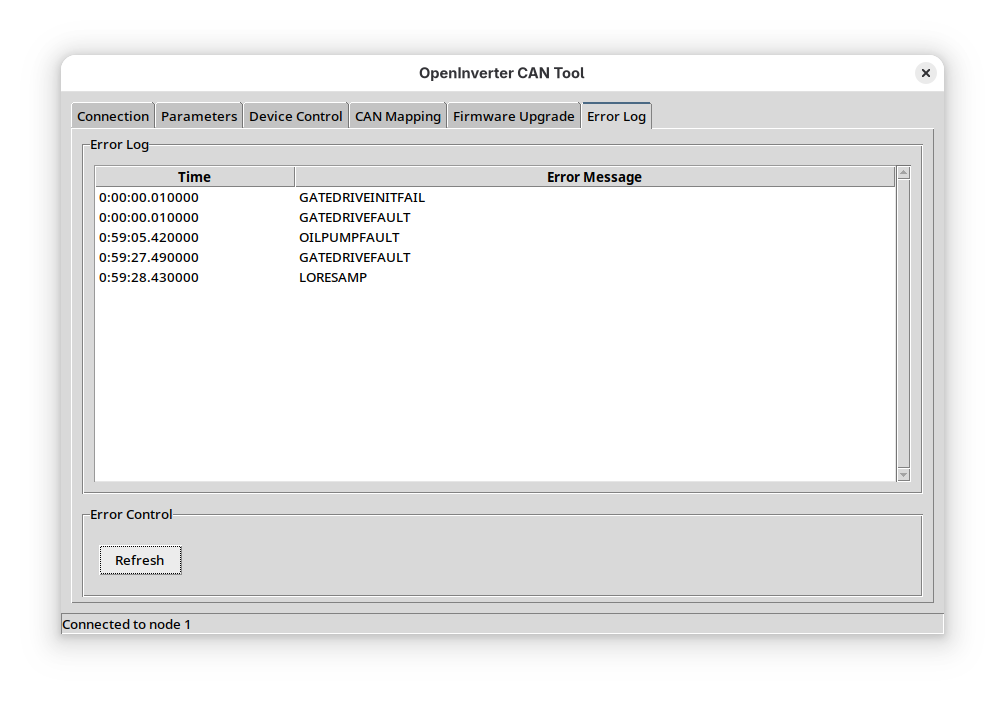

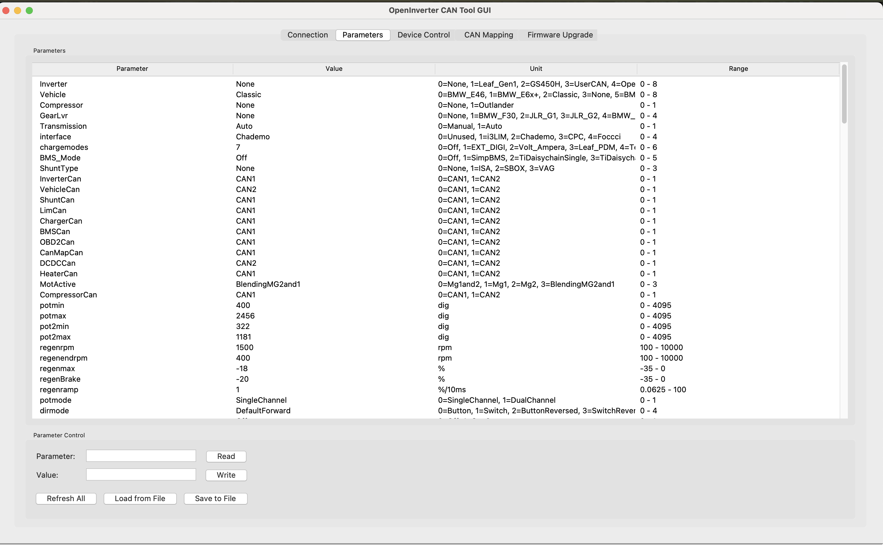

I've put together a new v0.0.3 release. This adds:
  • Save and load all parameters to a JSON file on the PC. Uses the same format as the web interface.
  • Change the way CAN interfaces are configured to use the python-can configuration file. This is more flexible and once set up should be the same from one run to another.
  • Added the details of how to configure to use the SLCAN interfaces like GVRET.
Obtain the release here: https://pypi.org/project/openinverter-can-tool/
Or run
Would be great if someone else wanted to give this a go. It would be useful to know it worked for more than just me... Feedback and github issues greatly received.
