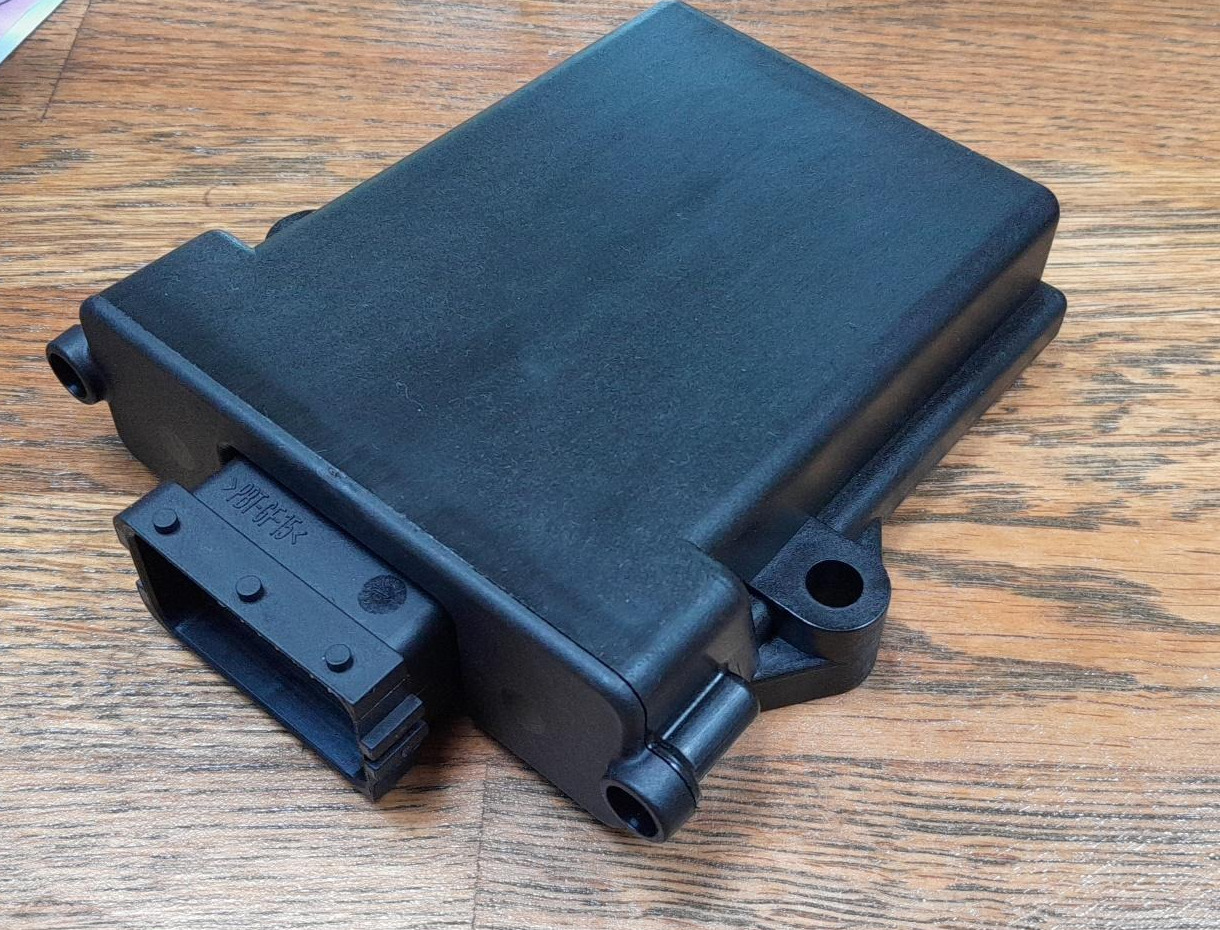

I am building an interface between Nissan Leaf CAN and, in my case Saab i-bus CAN.
I came up with the following specs:
3 x CAN bus
1 x LIN bus
4 x 5 volt input digital (analog with mod option)
5 x 12 volt digital output (to drive relays or dash boards lights)
3 x PWM output at 12 volt (battery voltage) level for dash board gauges
1 x PWM output at 5 volt level (to drive a small servo)
UART and UDC C on the board
Voltage input 9 to 16 volts.
Based on a ESP32 with Wifi and BT.
If anybody is interested I can offer a test sample once I have the first series in.

Here is the 3D model of the interface-controler
Re: Nissan Can translator to analog outputs for old cluster - Is there any?
Posted: Sun Aug 20, 2023 10:25 am
by PaulHeystee
For now I have set these specs:
The controller: ESP32 - S3 mini
I/O:
- 5 digital outputs (9 to 16 volts) for relays, LEDs etc.
- 1 analog input (9 to 16 volts) for variable input (heating level)
- 3 digital inputs (5 volts) for gear switches or any other switches
- voltage output (5 volts) to power the above and a servo motor
- 1 PWM output (5 volts) for servo motor
- 3 PWM outputs (9 to 16 volts) for dashboard gauges, RPM etc.
- voltage input at 9 to 16 volts range, basically 12 volt car battery
- 3 CAN buses for communication with VCU, heater, power steering and car at different speeds
- 1 LIN bus for heater and / or airco pump
- USB C on the board, power and data for programing
- UART on the board for extra communication with other devices like GPS
- Wifi - build in the ESP32
- Bluetooth - build in the ESP32
As soon as a have the boards here for testing I will write an update
