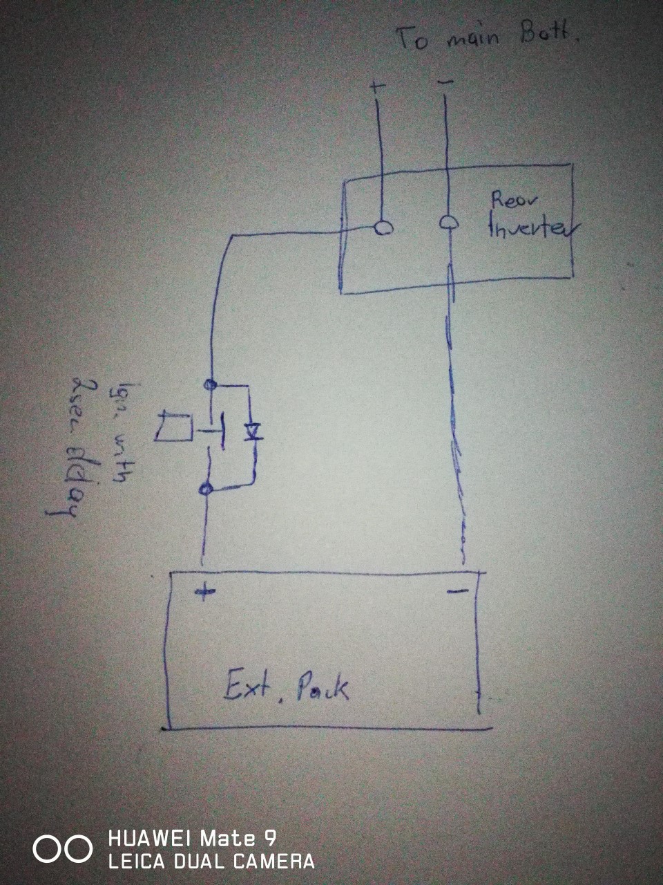

Hi X30!
I have done it with an extra pack on my Outlander and iam superhappy.now i go 120 km on pure EV(same voltage,84 ah cells Comes from Nissan 30Kwh)
So i can say ist very easy Installation only connect to rear Inverter put a fuse,contactor,and one Diode (for charging with OEM charger) thats all you Need!
There is no Need for PCb or hacking the CAN !!!!
Remember:
The simplest Things are the best.
Coming back with schematics and photos of mine.
Cheers
Thomas

Usually those cars use 2 DC contactors to break connection with car. Only then charger can work.
How did you solve that?
I have an Ampera and i connected inverter cable into Y. The other fork will go to another Ampera battery, in effect doubling the range. Its just that i see a problem in connecting 2nd battery and controlling SOC of both packs when contactors are off...
How did you manage to connect your extender?
What do the batteries do when regen or quick acceleration happen?
tnx
Arber
tnx
Arber

The extention Battery is connected with a contactor wich will active after 2sec. after Ignitation.
For charging:
If i switch off IGN. also contactor of extention Batt. is off.
I Bridge the contactor with a strong Diode so charging current goes over Diode !!!!
For charging:

Re: Outlander PHEV: EV range increase?
Good idea.
Myself i am intending to put battery to 2 connectors. First small one with large resistor on it i will connect first to equalize charge if needed. Second will be 175A or more rated. Also another 350A fuse and contactor.
I intend to connect through main emgcy disconnect. I will drill two larger holes in plastic and use brass bolts from underside to connect to +/- points on battery. After bolts i will connect 35mm2 welding cable to the back where main connector will be.
I am thinking of using emgcy disconnects interlock lines to shutoff 2nd contactor in case something happens, ie. first responder pulls the plug....
I am asking how both batteries coexist together. Are there any current jumps or anomalies?
Also how do you communicate with the SOC meter? Did you have to convince it or is it just working by itself?
tnx
tnx

The two Batterys coexist by voltage!Even if the voltage is not the same +/- 5 Volts you can connect via contactor.No current jumps no sparks!
In my case the main battery deliver 1/3 and extention battery 2/3 driving current and this effect ofcourse the SOC meter!
In Fakt you will benefit the mileage of one cycle ,also you extened battery life.
Rgs.
Thomas

Hi Nesto, are the terminals in the rear inverter connected during Chademo charging?
Phil
Phil
- Posts: 3795
- Has thanked: 166 times
- Been thanked: 411 times
I belive they are since there is a diode across rear contactor, therefore everything that flows to main battery then flows to the rear across the diode.
I still cant belive it is that simple. But i think caution with rear battery is needed. I think i will keep second battery well below full SOC when charging.

Yes Contactor is closed while charging or fast charging.Ensure that the diode is strong enough to last the charging current.
I burned down a 40 A diode in 5 minutes with chademo charging!!!( it is DC current,so be aware from the limits of the diode)
A god value is 3x stronger then max.charging current.

Yes you can but ensure that diode is strong enough!
Otherwise you will end up like me ,you came back to car ,open the door and a huge white cloud comes of your car:)
So there is nothing to do for chademo charging but sadly its limited to 16 kw output or 50 Amps!!!
anyone an idea how to blast this limitation away?

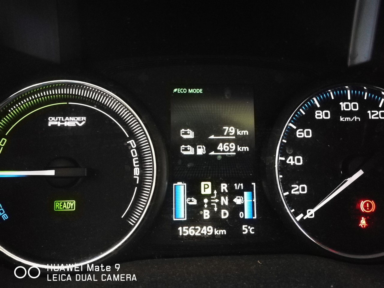

Here is an instant range extender for Mitsubishi Outlander Phev Owners.
Loooking forward who knows this!

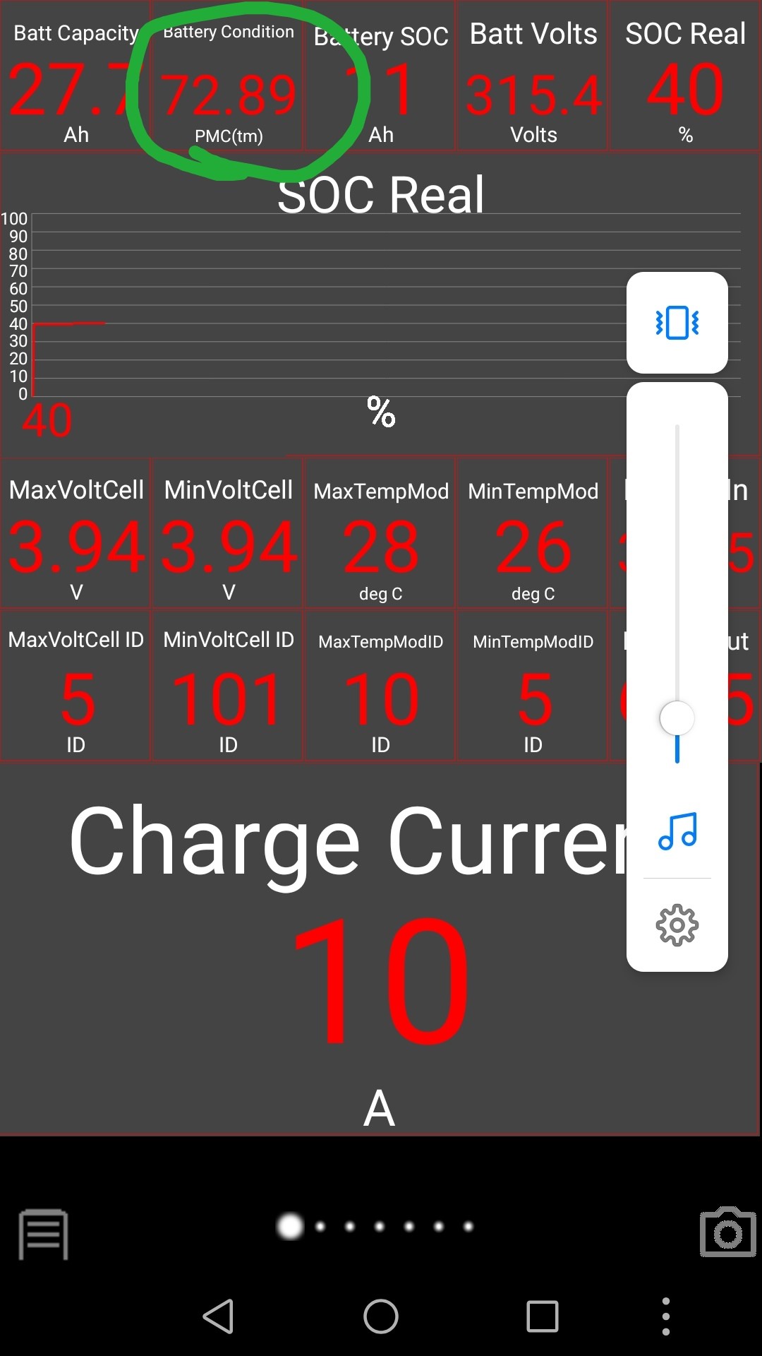

Ok so the is a calculated Battery condition value wich will DECREASE with mileage the calculated Capacity of the battery!
For example my Outlander had 150.000 km a value of 72.9 percent PMC!
Now do this:
1.plug to charge the car
2.Switch on ignition.(not ACC)
3.disconnect 12 Volt minus of the Battery!
4.disconnect Charger plug from car.(all went dark)
5.Connect 12 Volt to Battery.(all come on incl. EV Error in display)
6.Switch IGN. off and on! (no error anymore)
7.Check your PMC percent value (99.9)
Now the BMU calculates like a new Battery ,so check the cellvoltages when it comes close to empty!

I tried it on mine and it works well, I have also monitored the lowest cell voltage when it was showing empty and it didn't drop below 3.71 volts on any cell.
Phil
Phil

Hinesto1972 wrote: ↑Sun Jan 12, 2020 9:37 am The extention Battery is connected with a contactor wich will active after 2sec. after Ignitation.
For charging:
I am preparing to make my own Ampera extension in the same way you did it. Can you tell me what kind of diode did you use? What rating?
I have here one 150A 600V and one 300A 600V transistors. I intend to use its reveerse diode.
tnx

Hi Thomasnesto1972 wrote: ↑Sat Jan 11, 2020 7:30 pm Hi X30!
Remember:
Cheers
Thomas
