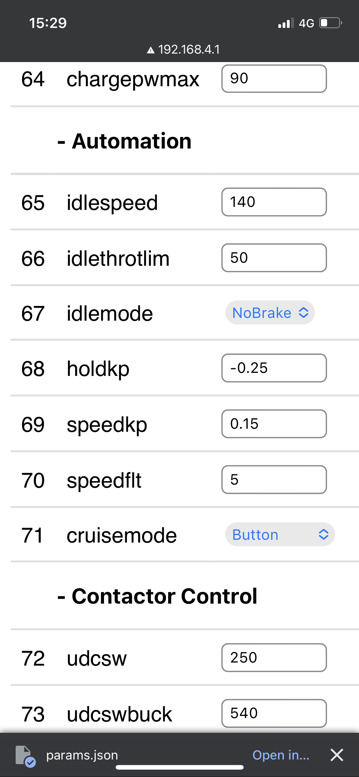

I’m curious if any of the Tesla conversions are using a positive idlespeed setting?
If so, what are your experiences and would you care to share your settings?
Have you managed to create a smooth power delivery?

Back on topic, I’m interested to know whether anyone is using a positive idlespeed parameter without using a an external transducer, and if so, are you happy with it and would you please share the json.

I now do the same idle ajustment over CAN with the pedal position data from the ibooster for whatever thats worth. I believe the idle applicaiton defualts to the throttle ramp value, so that could probably assist in adjsutment there.
