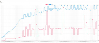

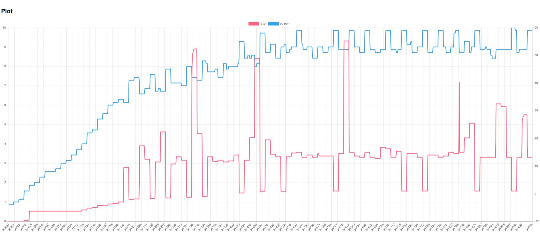

I got my motor to turn but it is turning very slowly. fstat (my guess it this is the freq send to the stator) seems to stay below 5 almost as if limited even if I turn my pot to max.

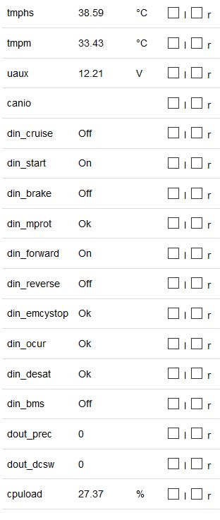

I looked at BMS input (connected to gnd), Error input (Pin 13) is 5V and UVLO input (Pin 14) is 3.3V. What am I doing wrong? Which parameters should I change to send higher frequency to the stator?
