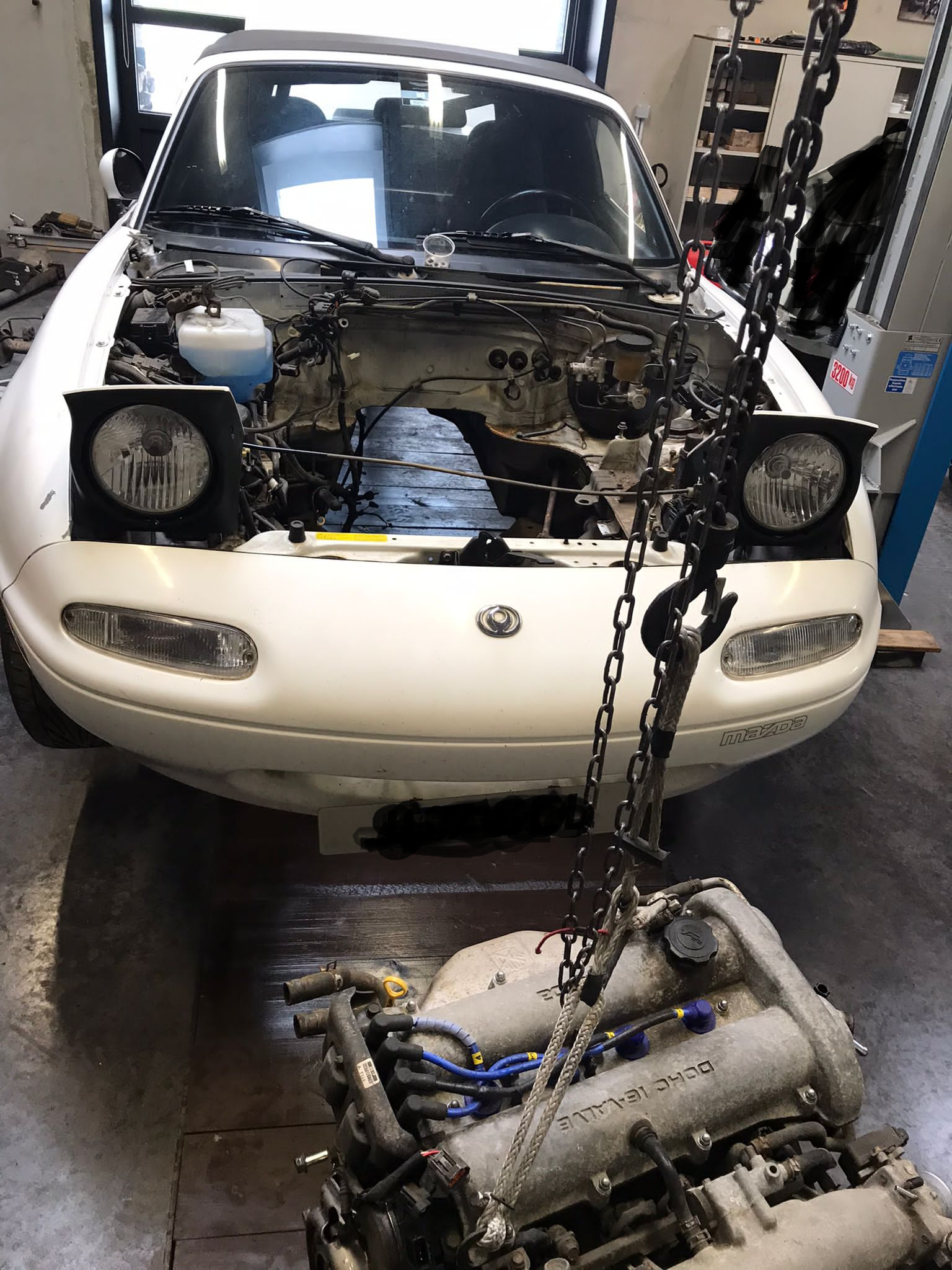

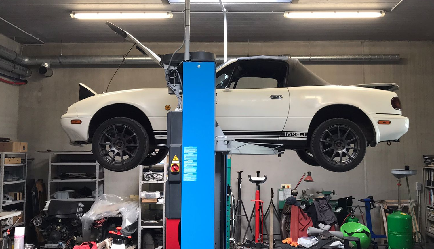

Hello everyone,
First post here, and first conversion !
Base car is a Mx5 NA which I have had for about 10y. I don't have much mechanic skills and although I'm working on this with a friend who has, there are a lot of first for the two of us here. I do have some theoretical knowledge about BEV drives though.

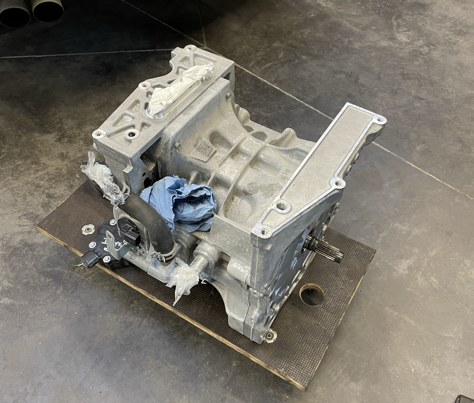

1.6 engine is out and I have already ordered and received a EM57 motor with its inverter and PDM + Zombieverter box, thanks to
m.art.y on this forum (who I highly recommend btw). Plan is to mount it straight to the existing gearbox, with the inverter on top and probably the PDM on the side.
Ready to start
What came out
What needs to go in
Where it needs to go
First point is to figure out how to do the coupling. Based on what I read, looks like the coupling from BRAT INDUSTRIES could be the best option. My early plan was to keep the clutch as a safety device against any unintended acceleration but this seems more complicated.
I still have no idea for the battery, I'll figure out once the motor is in. Thanks in advance for the support.

Thank you. Yes front ARB in the empty engine bay is quite obvious and in the middle of things... And yes, the fuel tank space is already planned for. I'm hoping to put as much of the battery as possible in the rear but will need to see. Would be nice to avoid a split pack. If i can find cell with a sufficient C-rating, 20~25kWh would be perfect. I'd like to bring a little more weight to the rear to help with traction, it could potentially have quite a bit more power than the ICE. Let's see how extensive the body work would need to be.
