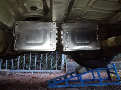

When I removed fuel tank and exhaust a large open space became vacant, it will now hold 52 of the 96 cells. 8 more will go in the exhaust tunnel, 12-16 below the spare wheel leaving 20-24 cells to go in the engine compartment. As you can see there is a lot of space between hood and inverter.
Finally I have also 90% decided against the original charger and DC/DC converter. For a wimpy 3.6kW I think it's way to big and I will try inverter charging instead and also have a DC charge port. DC/DC converter can just be some Meanwell supply which should happily take the 380V from the Leaf pack.

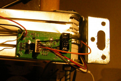

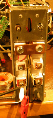

Now I started testing the new BMS slave boards and actually mounted it to the battery today.
I've used that same topology on the Polo except the 1-wire bus (infrared in Polo). Also in Polo resolution is lower and there is no balancing.
- 4 channels
- 1mV resolution from 3.6-4V
- 10mV resolution below 3.6 and above 4V
- 30mA balancing current - balancing is done by programming a voltage set point
- 2mA active current
- 100µA standby current
- 1-wire fail-safe daisy chain bus (it is not dependent of software to pass through messages)
- Self-addressing
- Fully field up-gradable via boot loader

Are you rolling your own BMS too?
Oddly enough I started the schematic for the cell modules for one today. Is 30mA going to make a dent for balancing with the large capacity of these cells? I was thinking of putting the resistors for balancing on a separate PCB, but switched from the cell module.

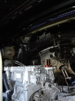

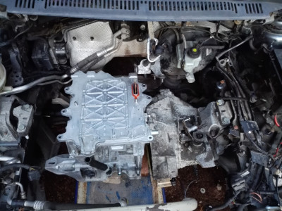

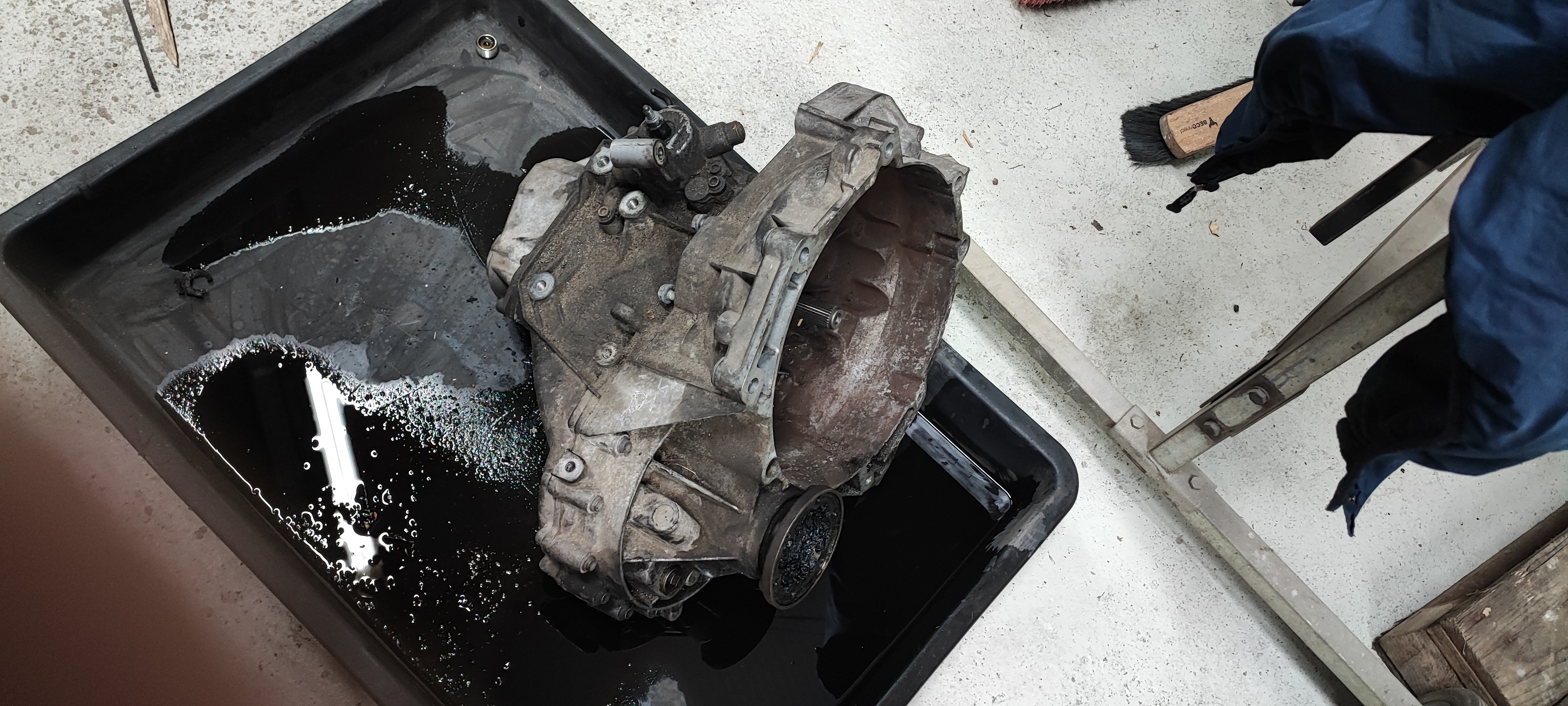

I'm making very sophisticated plans for coupling motor and transmission. I will use my trusty jigsaw to make a 10mm alu plate that matches the transmission and on the other side bolt standard alu profiles to the Leaf motor. And then bolt the plate onto the profiles. I'm thinking 6-8mm wall thickness of the profiles should be sturdy enough.
The drive shaft *just* stays clear of the motor.

I have done just that in the past with no problems. Recently I have used a single 20mm plate but cutting it out to shape is a pain.
- Posts: 3795
- Has thanked: 166 times
- Been thanked: 411 times
I had the same idea for the transmission plate on my Mazda some years back. And it works. You just make a template from some wardrobe back or plywood and translate that to alu plate. While you saw it with jigsaw get someone to spray some WD40 on the blade in regular intervals. It helps with alu sticking to a blade immensly!
I am less enthusiastic about those profiles. I dont think you will be able to get the center of both assemblies accurately that way. You have to get an accurate position of transmission center and make two smooth holes for guiding pins. There are two pins that lineup transmission with engine. Those pins allow you to attach the plate the same way every time. You have to carefully drill so transmission center and both guiding pins align.
On the other side motor has to meet the same center as transmission. So best way is by another plate (both planes align). You then have to worry only about center point.
Make sure you are alligning motor to transmission vertically with assembly out of the car
. It is easier that way.
You could also cut the engine case behind the front bearing and get it to machine shop to be leveled with the front plane. Then you can even use the front part of the shaft and clutch.... Just an idea.

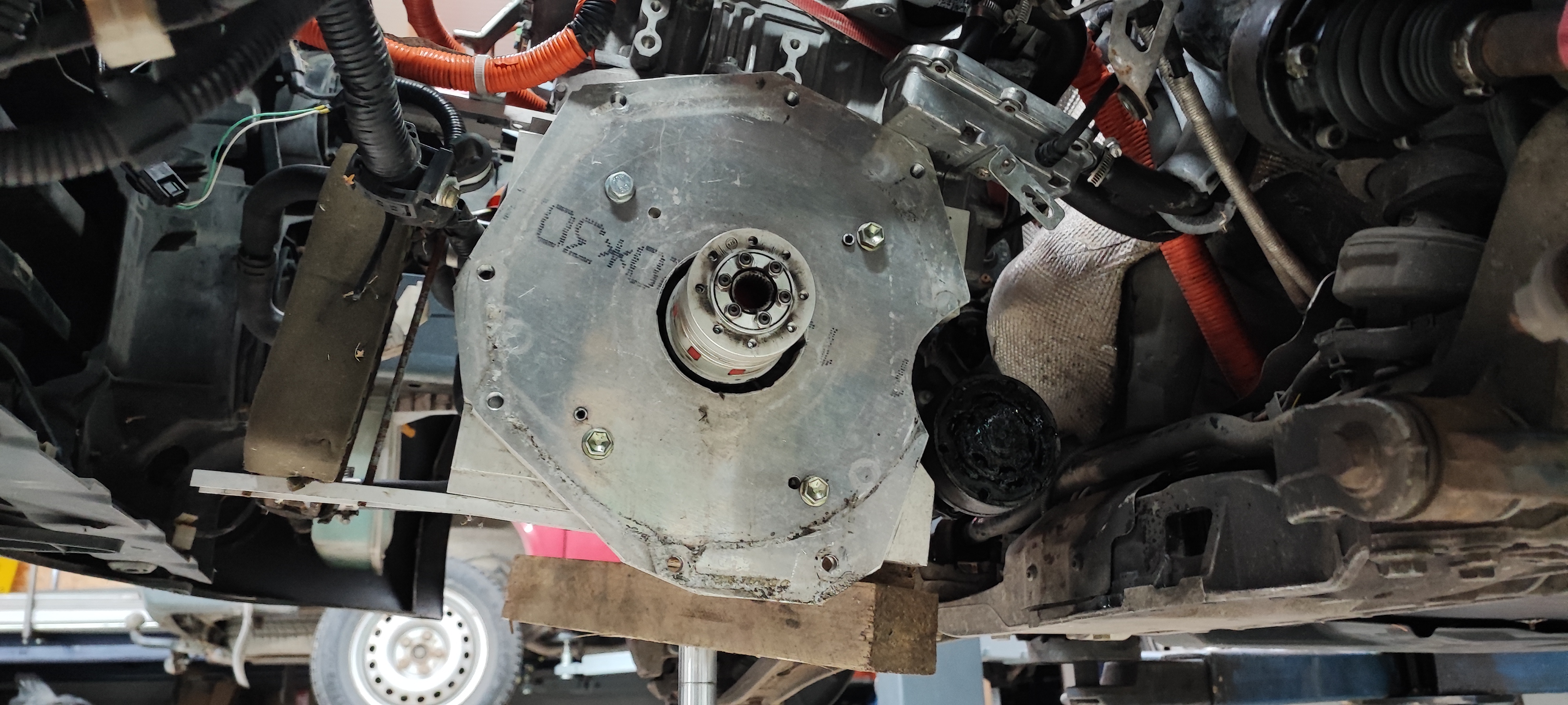

Well if I tilt the profiles a bit I can actually use the existing guiding pins of the Leaf motor. Of course it can still twist but not shift.
I can use another set of guiding pins between the profiles and the 10mm plate.
The Leaf motor is slightly tilted to stay clear of the drive shaft.

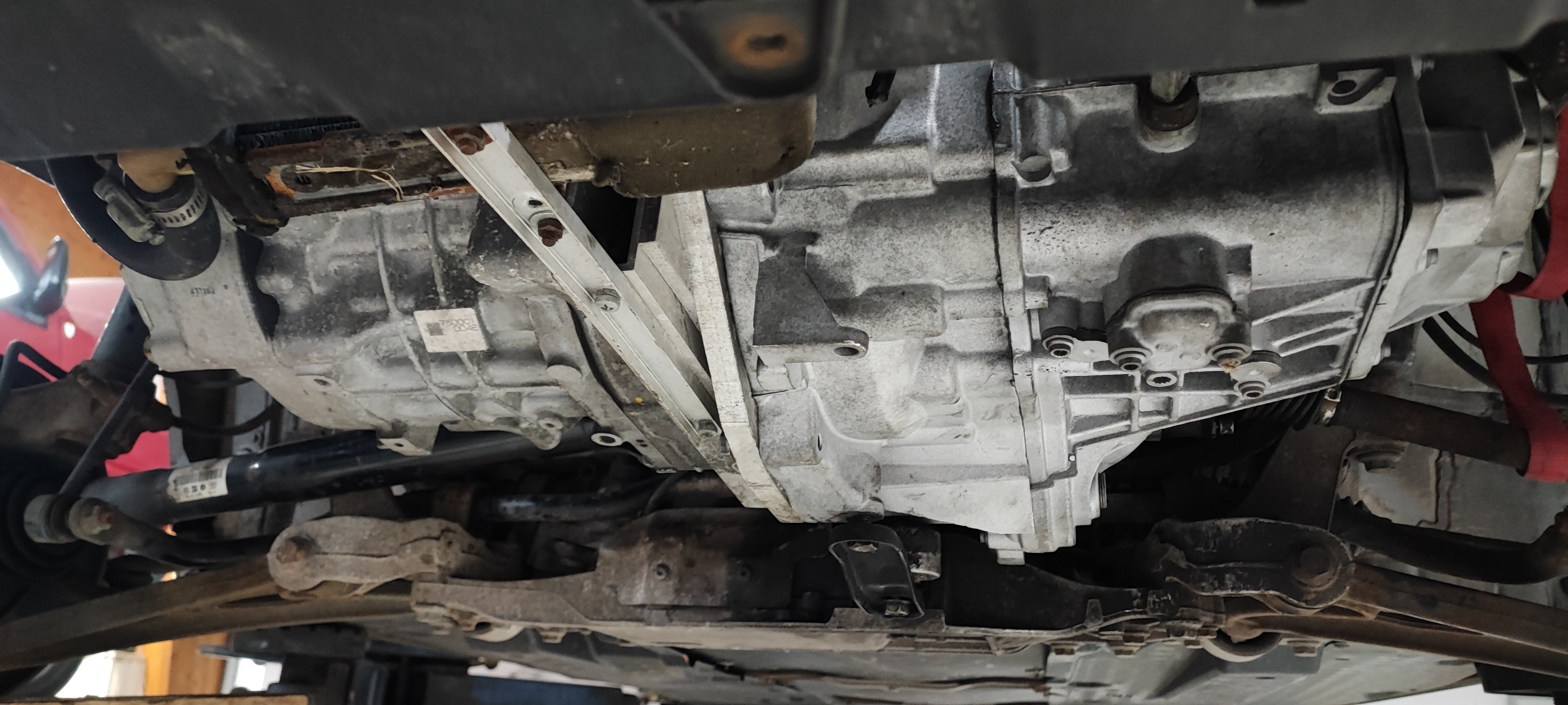

Hello,
Also I'm on the way to join together Leaf EM57 and BMW E87 together. Specially for this we did digital measuring in XYZ coordinates. If anyone needs those info or dxf with coordinates - give some info in this topic. I will put them here.

Painfully slow progress. The shaft coupler is not ready yet neither is a battery in
Only thing I got done is a wooden mockup of the "face coupler". Bad weather and work on the new BMS has been holding me back but both is coming to an end
