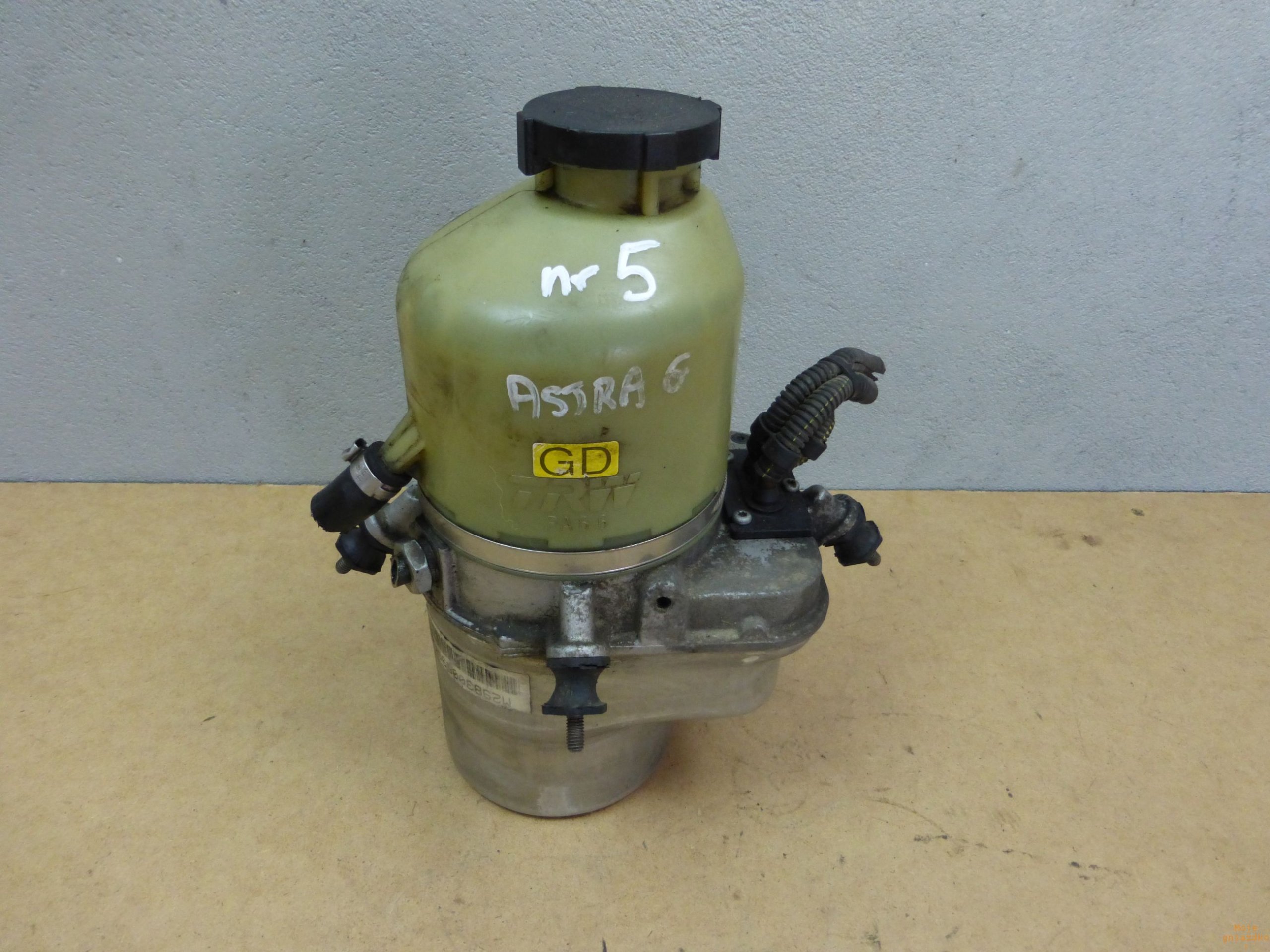

I decided to write up a guide on using some hardware from different gas cars in an EV.
First will be about connecting and using hydraulic assist pump from Opel cars.
Corsa usually has electric motor to assist driver, but all other Opel cars normally have electric hydro pump to provide pressure for servo steering. Usually those are good because they dont use any CAN bus control. Instead they use pressure drop from steering movement and they are programmed to stabilize pressure continuously on demand. This makes them miss for first 1/2s in case of some violent tugging, but i belive it is better that way at speeds.
I got this pump on ebay for some 80€, working with some tubing and mount. It was taken from Opel Astra G car.
You want to connect it to 12V to try if it works, but you want to avoid running it dry.
So here is how the pump works.
- Connect thick red wire on live 12V via 80A fuse.
- Connect thick brown wire to car chassis as negaitve lead.
- Driver provides ignition 12V and pump should get this signal via thin Black wire.

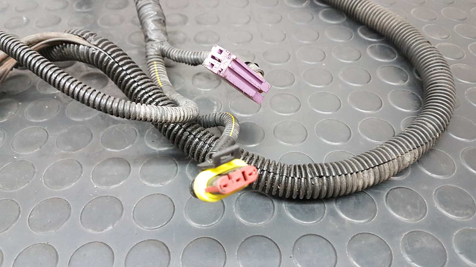

- starts engine and pump gets the signal from live alternator voltage via thin blue/white wire.
In former case pump will spool up at once and provide steady pressure. It will draw some 6A of current with no delta pressure at the steering end.
You can connect both thin wires to 12V at the same time too however. In that case pump will start, but will spool up really slowly.
Normally i use one 12V relay in a car to signal 12V ignition live to other support elements inside car. I connect there coolant water pump, DCDC enable signal, power to inverter , precharge relay, vacuum pump and of course EHPAS pump black wire.
When i turn to start the car i have one latching (or two) relay to provide "engine on" signal for car computer. I connect blue/white wire here nd as soon as i start inverter power steering is on!

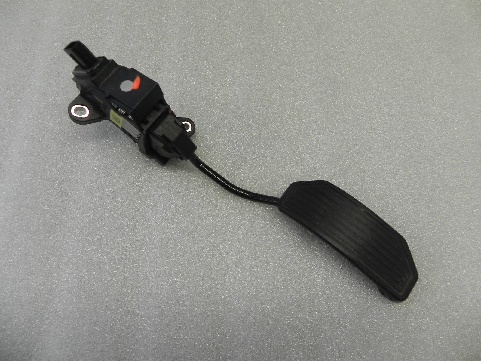

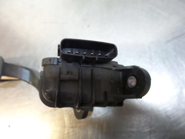

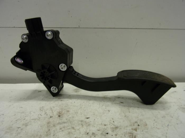

Throttle pedal
I have sucessfuly used Prius throttle pedal for like 5 years now. Lately i have bought Auris pedal and also one Yaris pedal, but this one was from british RHD car. All of them use the same hall sensors and they even share the same connector. Prius P/N is 78110-12050, but rest are the same sensor.
They are 5V powered and signal is simple linear voltage function from 0.8V/1.2V to 3.8V/4.2V.
They are simple to connect to Johannes DIY inverter as well as other.
This has smaller connector than early Prius pedals. I have found it is sold as Toyota 90980-12303 Plug Connector Kit. It seems to also fit to later model Prius.
Pin 6 - Wiper 1
Pin 5 - Ground
Pin 4 - 5v +
Pin 3 - Wiper 2
Pin 2 - Ground
Pin 1 - 5v +
Pins 4,5,6 work from 0.8V - 3.8V
On my 406 Coupe i used Auris pedal P/N 78110-02030 which has a thick wire for lever.
I cut the pedal off it and used an extension to clear pedal past steering column which was in the way. https://leafdriveblog.wordpress.com/tag/throttle/
Pin 6 - Wiper 1
Pin 5 - Ground
Pin 4 - 5v +
Pin 3 - Wiper 2
Pin 2 - Ground
Pin 1 - 5v +
prius_pedal.pdf- (49.9 KiB) Downloaded 1139 times

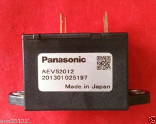

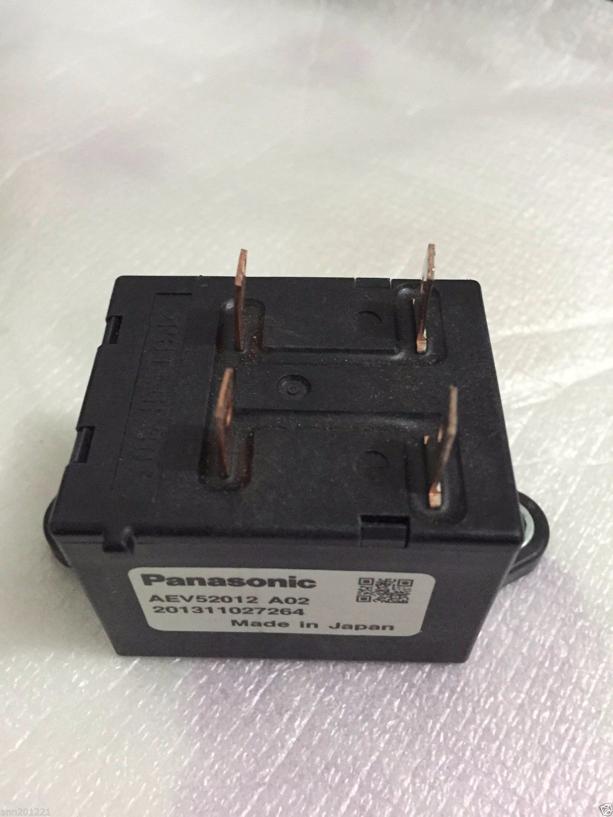

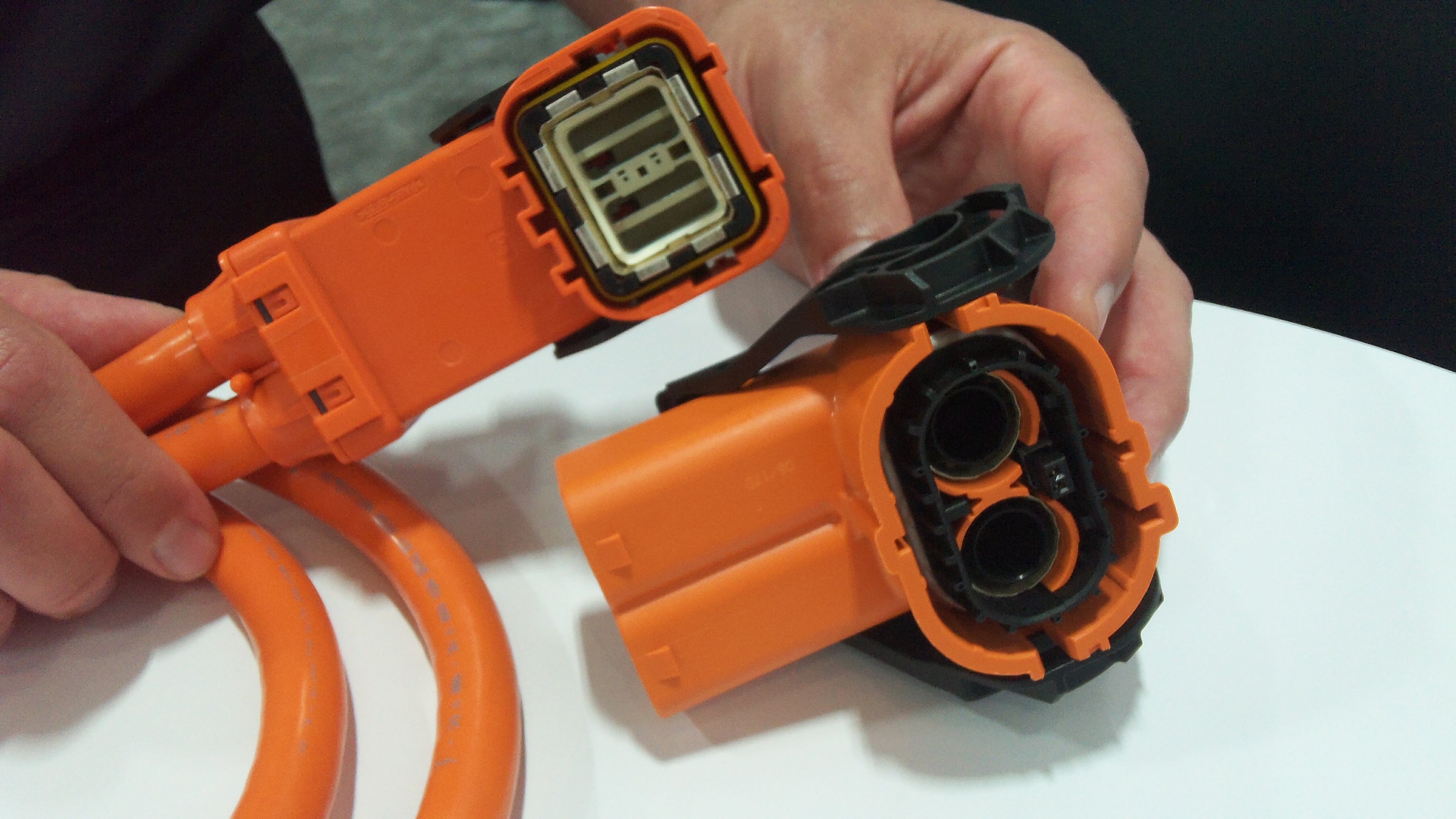

Precharge relay
To perform precharge sometimes one thinks it is enough you take one strong relay and you are done. Normally it is correct. 150R resistor slowly charges main caps inside inverter and when main contactor is turned on and precharge relay shut off there is not enough voltage difference to stick normal relay contacts. Persumably! But what if.. . something goes wrong and precharge is not yet complete and you try to reset inverter. Of course precharge relay will create arc on shutdown and burn through contacts. Next time precharge wont work and you have to take inverter apart....
Of course it happened to me
. Then i decided to search for good small DC HV relay.
I found one from Nissan Leaf P/N AEV52012. It is plentifull as Leaf and can be bought online too.
It can withstand swithching 400Vdc up to 20A. I consider it good also to trigger 5kW heater off.
Connection is by automotive fast-on crimped contacts. It is triggered by 12V.
When i took it apart i saw that under main contacts it has 2 magnets that absorb plasma discharge and arc doesnt form. Also contacts are silver coated.

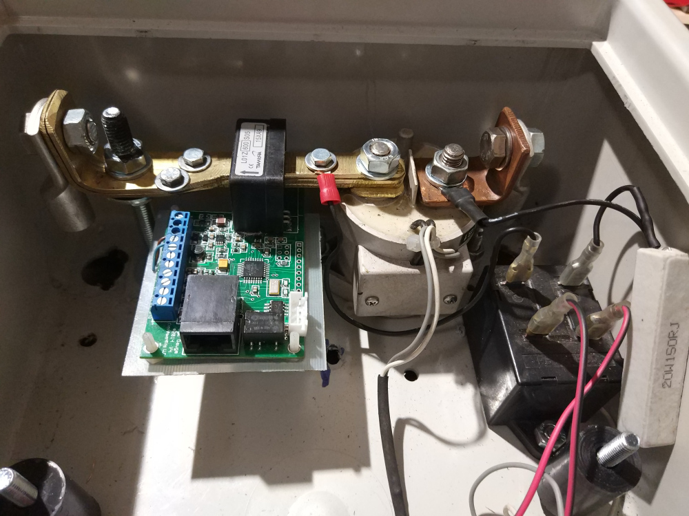

Main contactor
I consider this each DIY preference.
Mine is Tyco Kilovac contactor EV200HAANA.
It is capable of braking 900Vdc at 500A! Inside it is nitrogen (inert gas) filled so arc doesnt form and contacts are silver coated.
https://www.ebay.co.uk/itm/Kilovac-Szon ... SwTghbyFH0
It can be powered from 9Vdc to 30Vdc and its econoimiser only takes 0.5A when holding coil on. However to turn on it needs at least 3A in pulse and i found out inverter transistors are sorely inadequate. After some time it will burn transistor in UL2003 chip.
Also economiser usually doesnt work well with NPN transistor outputs. A lot of chatter happens. So now i use EV200 with arduino relay pair. One triggers precharge and second turns on contactor.

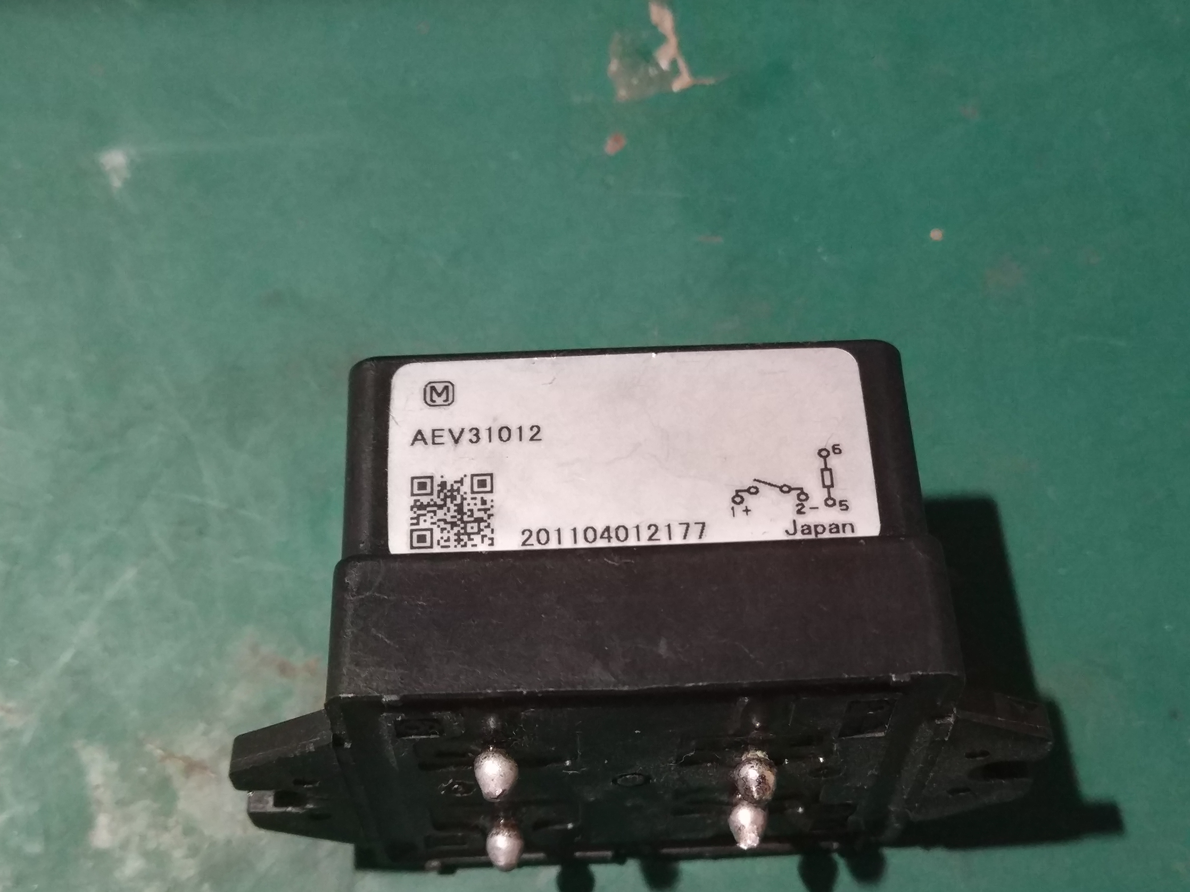

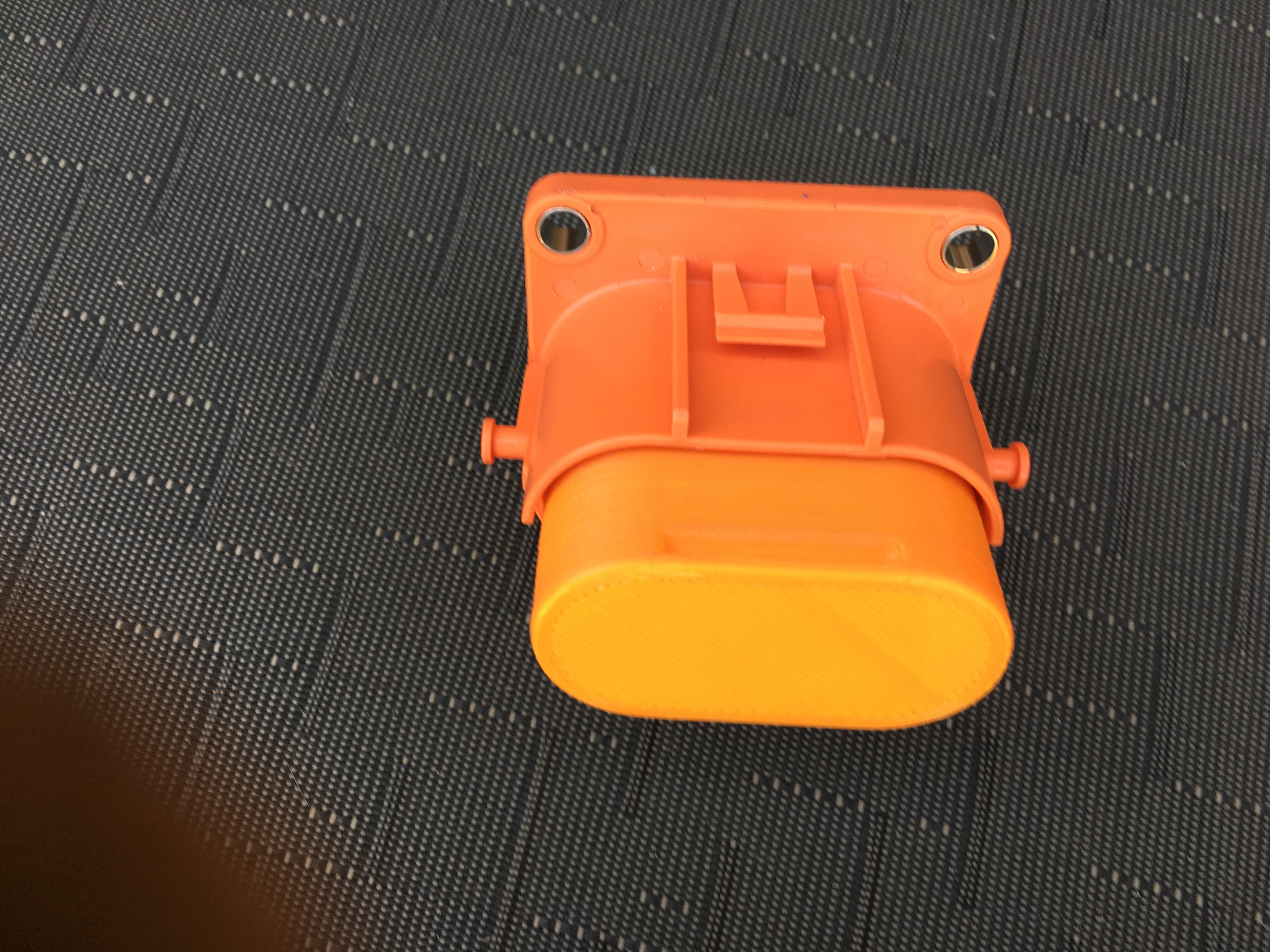

Another precharge relay

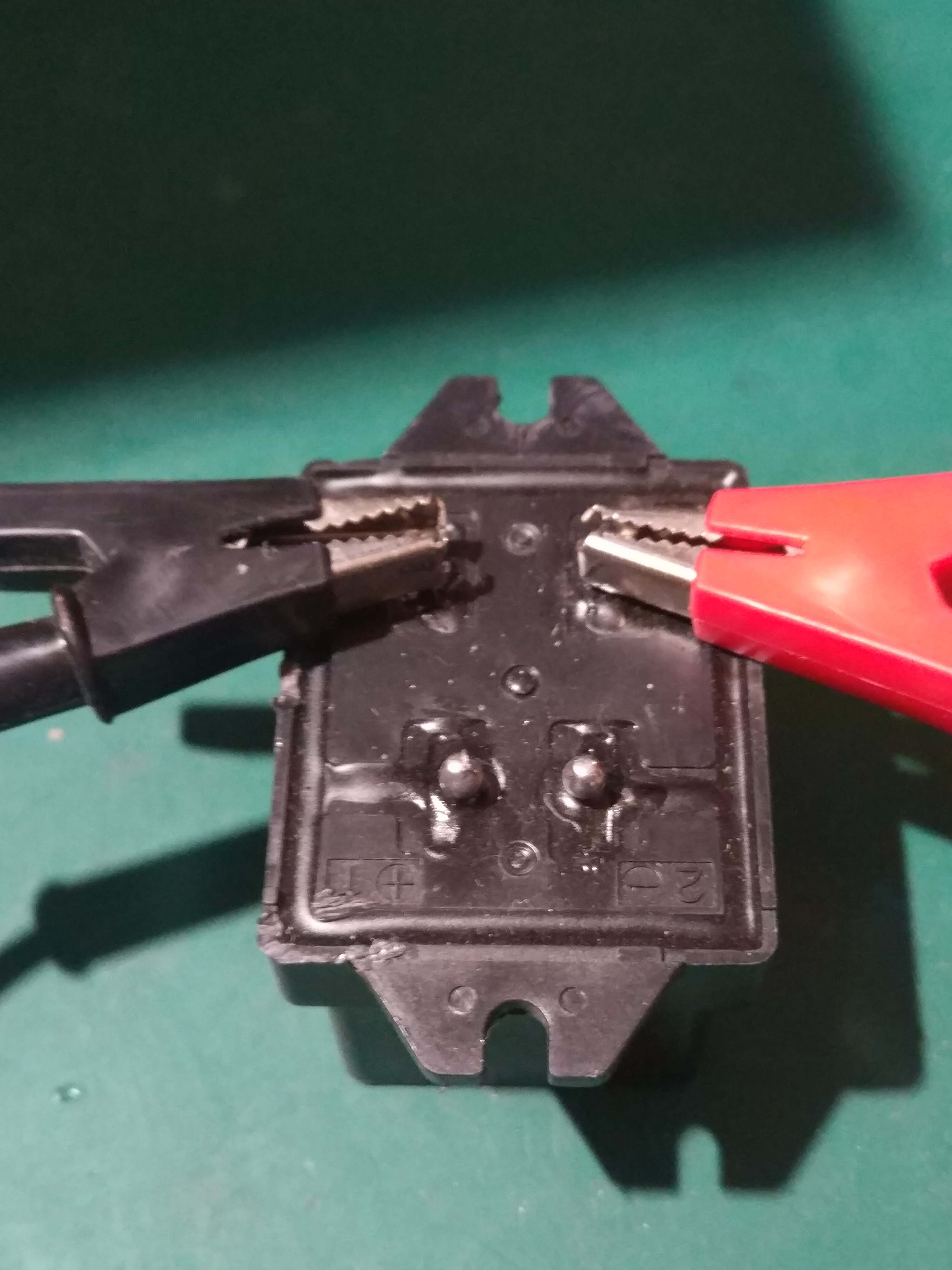

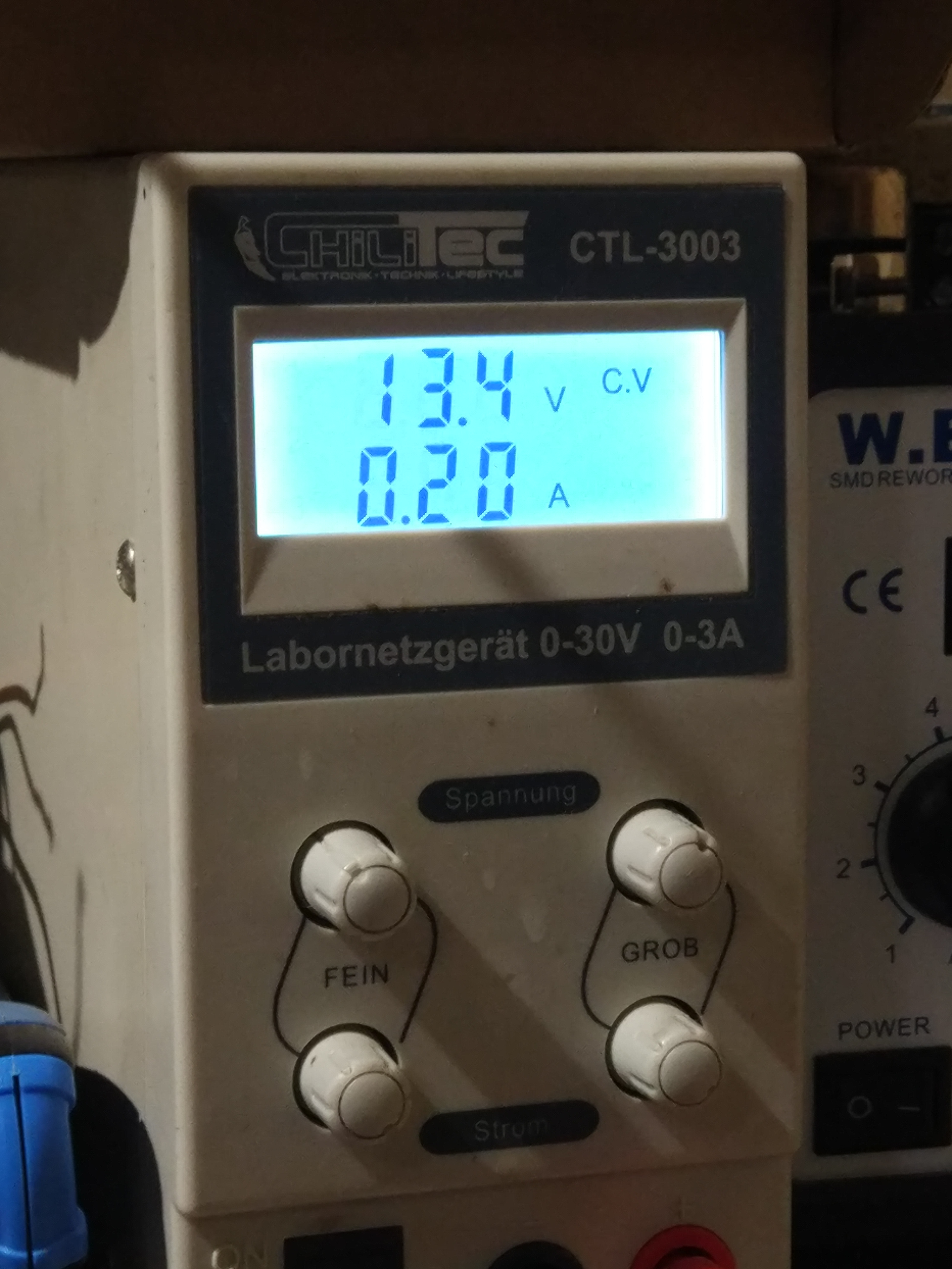

I found another DC precharge relay. P/N AEV31012 rated for 400Vdc 10A. It is from Ampera/Volt car. There are 3 such relays inside battery head unit.
I expect you can get one from salvaged Volt battery packs. It draws only 0.2A when active.

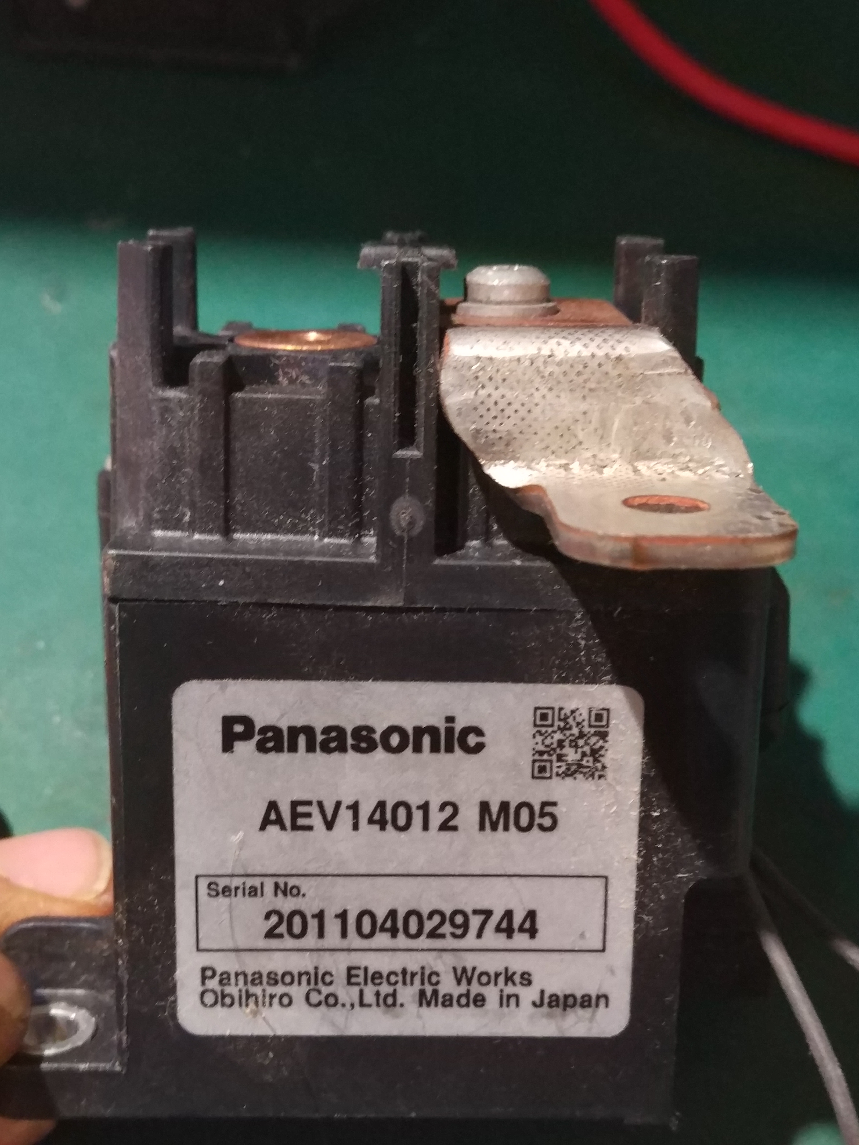

Main contactor II

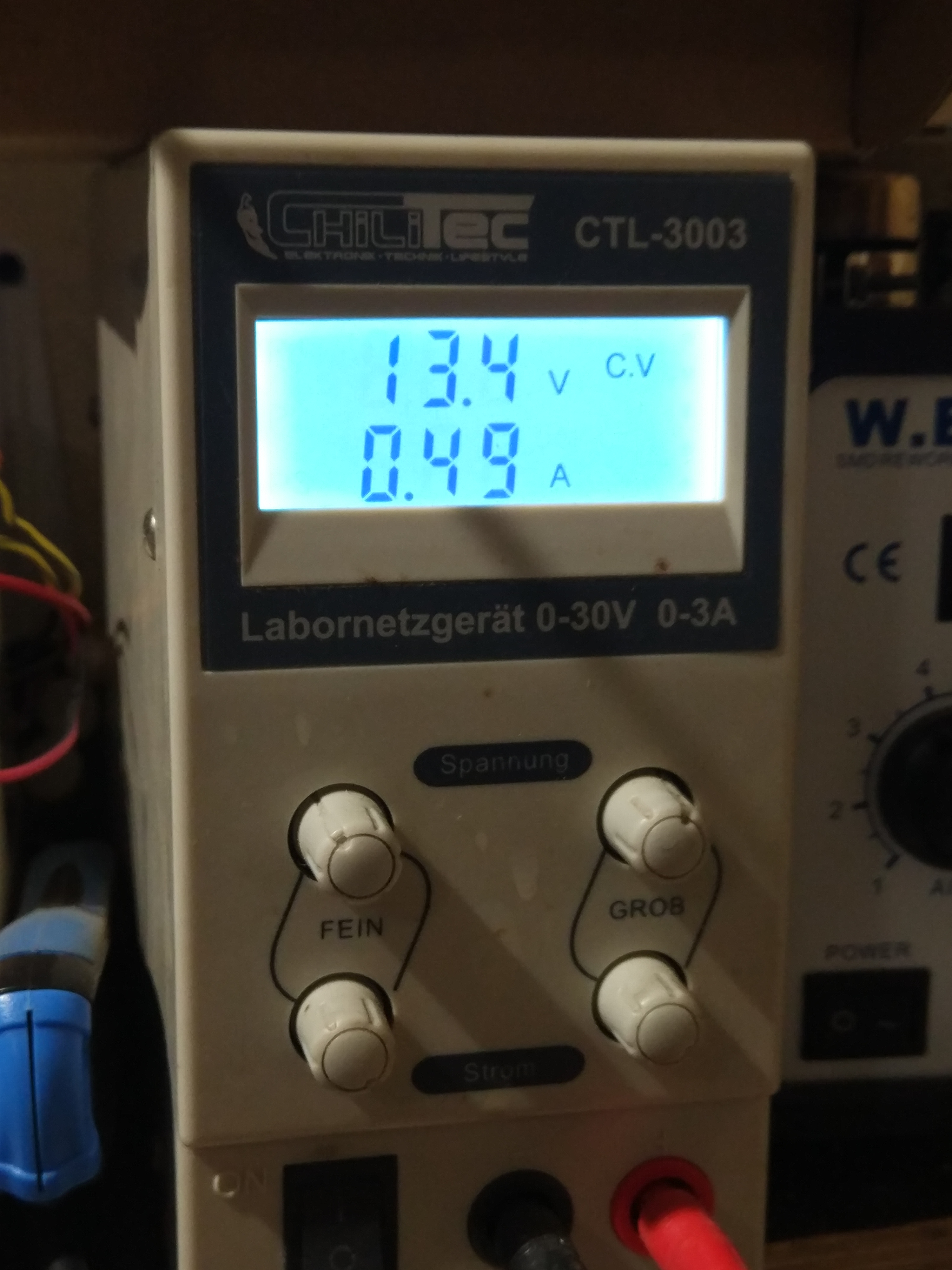

Also from Volt pack you can salvage 2 powerfull contactors. P/N AEV14012 it is rated for 120A continuously and 400A for a short burst. This means they had to use one of theese on + line and another on - side. Together you get 240A rating for system with 800A for a burst of power.
Contactor pulls 0.5A when active.

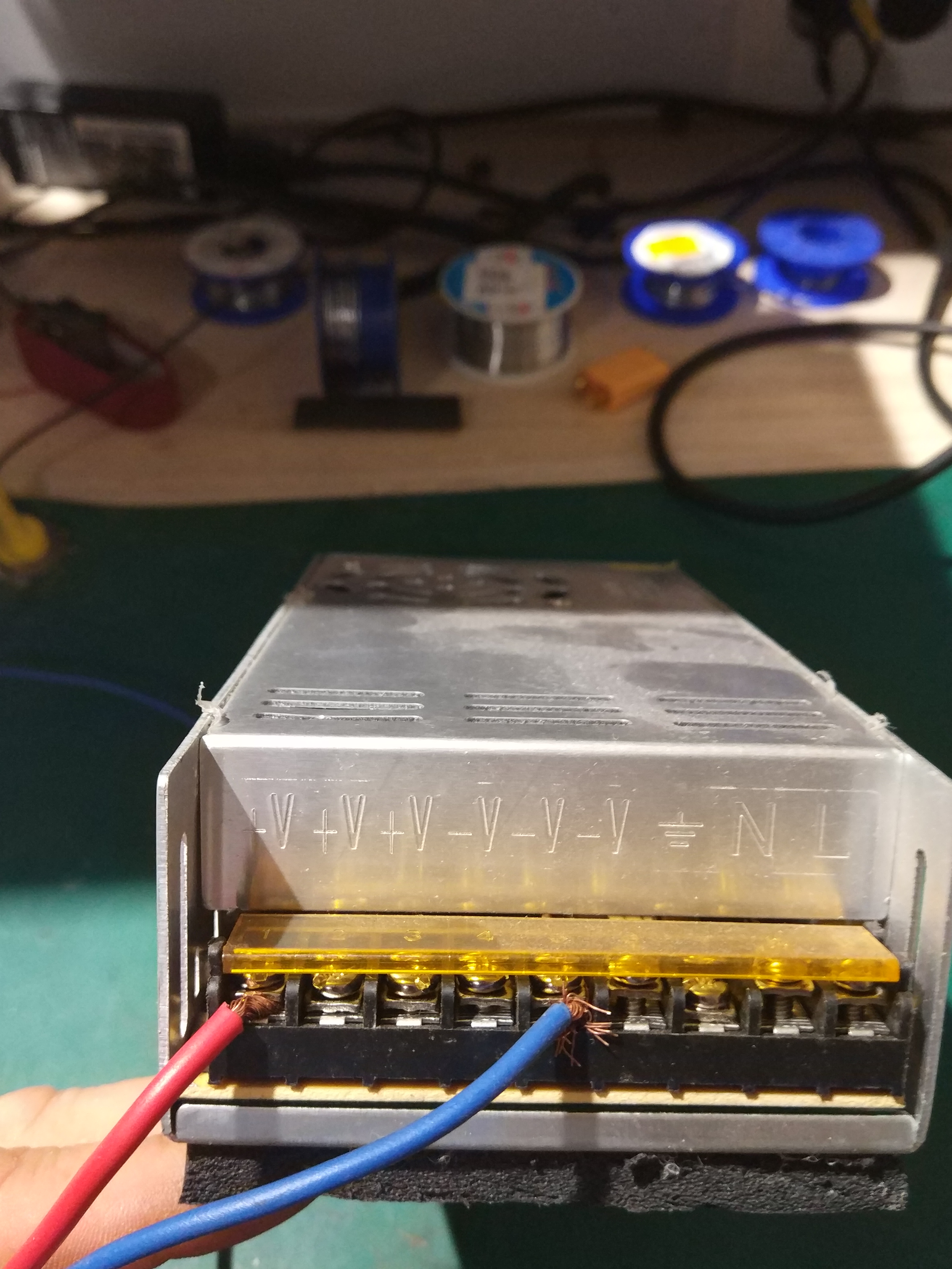

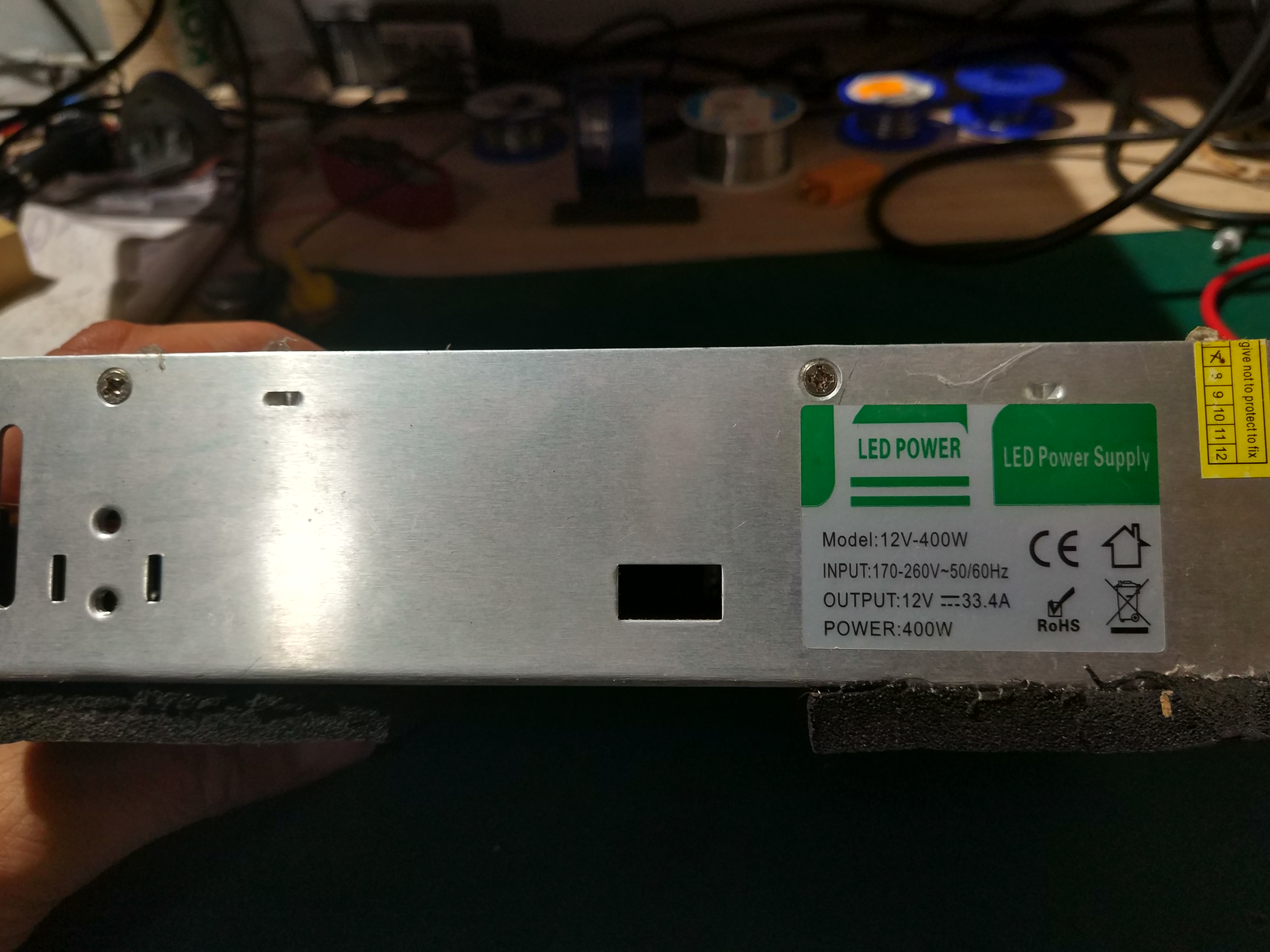

Emergency DCDC power supply
This is not something to be permanently used. it is a stopgap measure if you find yourself with broken DCDC converter. You can get branded versions from Meanwell or Chineese spinoffs.
I ordered one 12V 400W LED PSU. I connected it to 230Vdc and it worked fine and can supply 13.8Vdc.
I use it for experiments here in my lab, but it also doubles as my emergency DCDC converter for Mazda EV.
I connect it o permanenet 380Vdc power and it converts it to your normal 13.8Vdc for lights and pumps in a car.
I did hear strange whine when i was driving. I think it makes all sorts of EMI, but for emergency it is stable isolated PSU.
You do have to put it inside car as it is not waterproof.
It is great for experimenting with your car and systems if your dedicated DCDC needs CAN signal to operate. To test everything you just need to supply 230Vac ot upwards of 160Vdc and it makes some 30A of isolated 13Vdc.

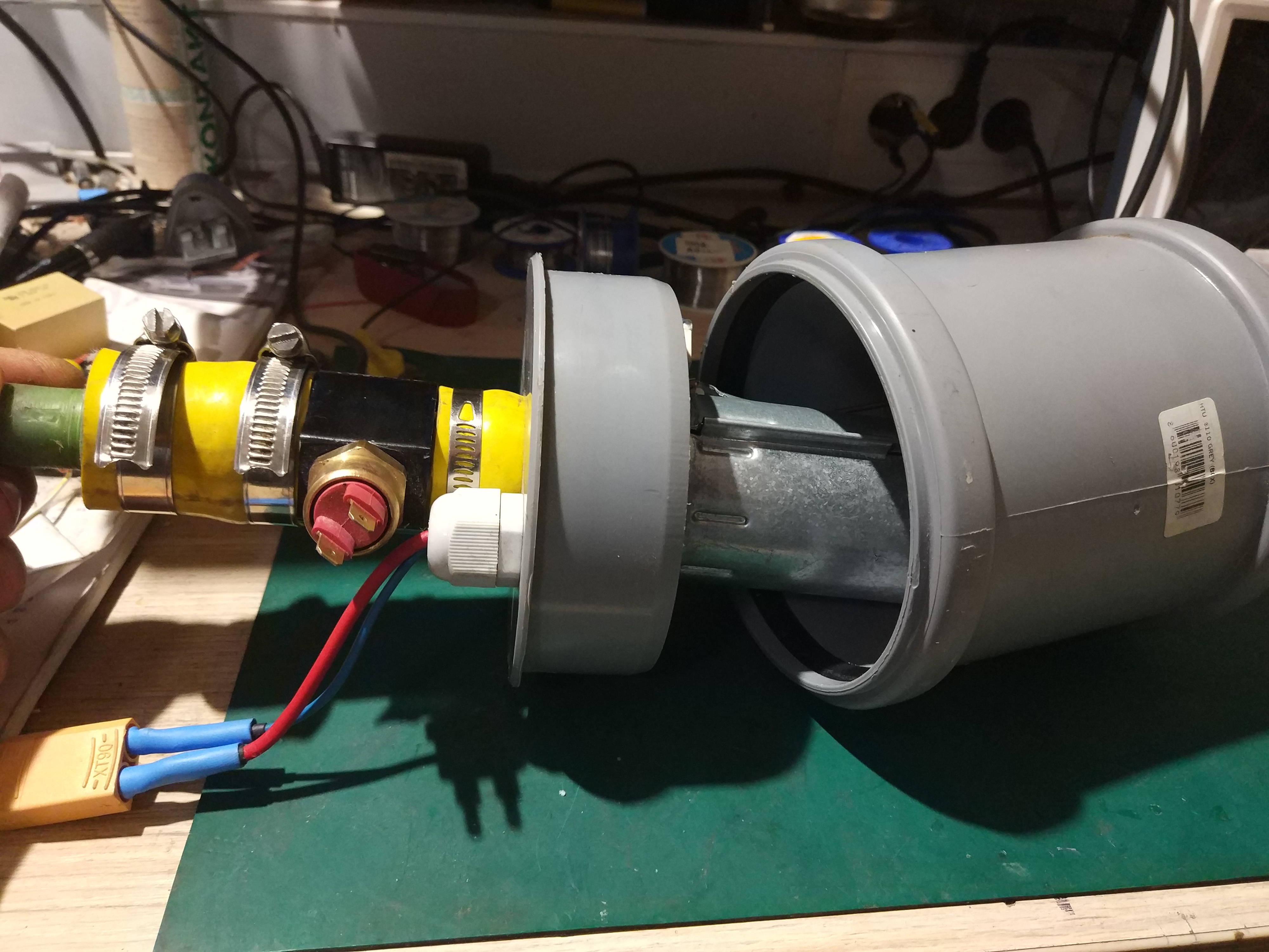

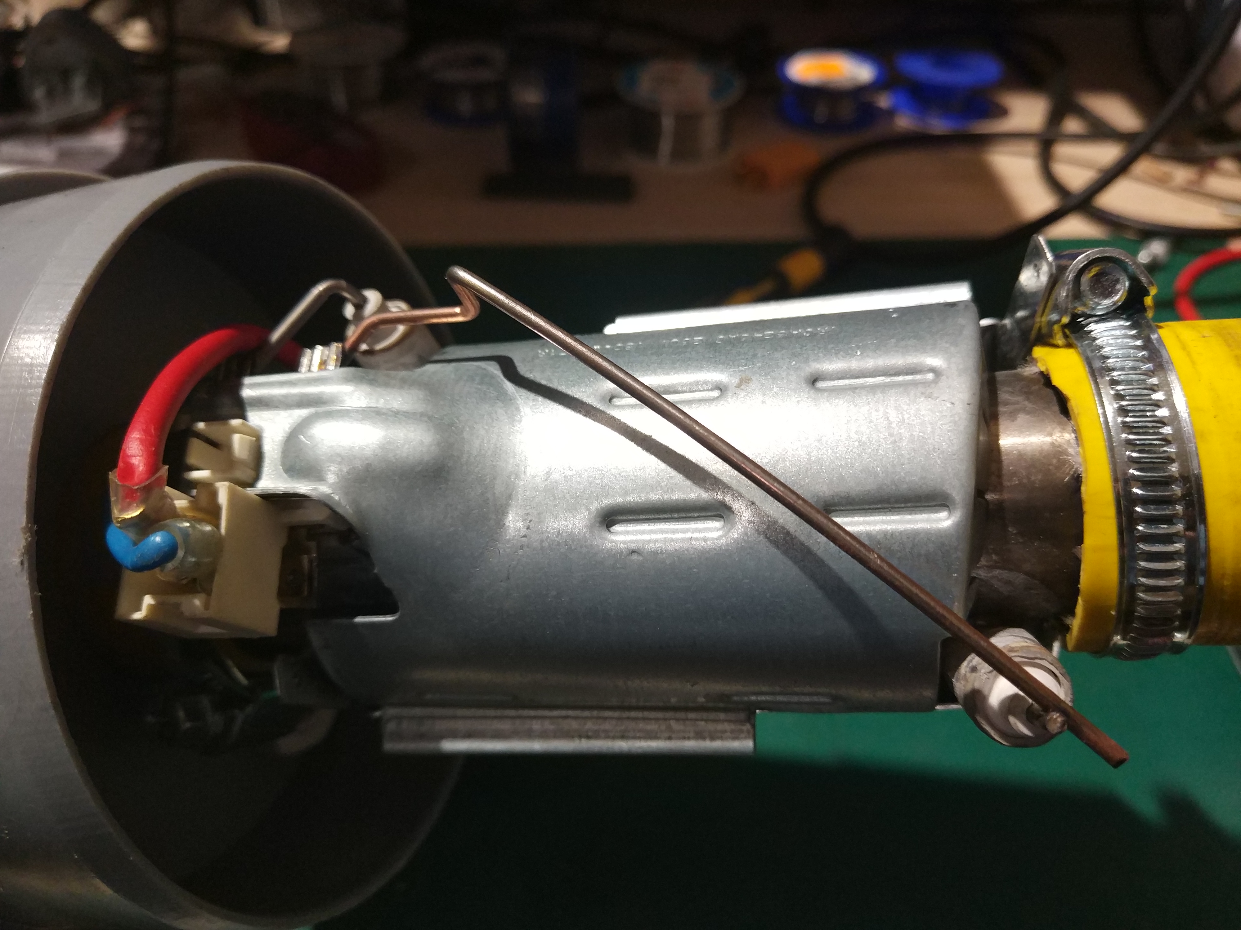

Cheap electric heater
I will not discuss here the legal points of electric heater and its EMI. I start this post on grounds you already have Webasto diesel heater instialled and it has CE mark to perform TUV inspection.
Now for those days when webasto is not needed or just to demist windshield in heavy rain i propose solution that may become permanent for people that live in warmer climates.
I got one 2.3kW Wihrpool dishwasher inline heater. I bought it for 35€ online. it is a 38mm tube with heater around it.
When i connect heater to 230Vac it draws 10A to make 2.3kW of heat. Now if i connect the same to 380Vdc it draws 13A to make 5kW! Nice!
Of course i need to make some modifications to use it. First i need to disconnect thermostat switch that opens at 90deg. If i had used it with DC it will open just once... Instead i connected power across it and i use outside thermo switch on alu tube. This switches 12V relay on and it in turn closes DC relay for 400Vdc. You want to be carefull though 5kW is a lot of power. I use 85deg thermo switch so coolant wouldnt boil off.
I enclose everything in a plastic tube (yes the toilet waste tube) and fill this with glass wool for isolation. I dont want to have DC power open under hood.

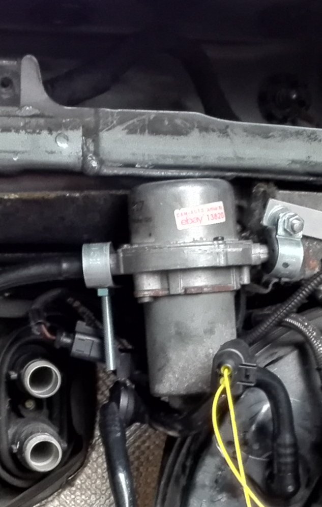

An absolute classic for brake booster vacuum is the Audi vacuum pump 8E0927317: It pulls about 10A.
It is unregulated so you need a sensor 036906051G. It needs 5V supply, outputs about 2V when vacuum is sufficient and a rising voltage with less vacuum. You obviously need some support circuitry for it, maybe there are easier options.
The pump is mostly equipped with the 2-pole VW plug that fits into this: 1J0973722

Usually there are check valves inside brake booster, but we need one https://www.ebay.co.uk/itm/10mm-3-8-Inl ... abf3ad9ba1 after vacuum pump so that we measure vacuum before the switch.
1. Chineese Dracarys Electric Brake Vacuum Pump Switch. It is a simple membrane and spring switch that is calibrated by a screw that compresses a spring which in turn causes a membrane to close contact at a larger suction. Very simple to mount. It only needs one contact from a relay, the other contact is GND on the casing. Case forms a tube 10mm that one connects to hoses.
https://www.ebay.co.uk/itm/Dracarys-Car ... SwJIhdJ54q
2. Volvo XC90 vacuum switch P/N 30645383
Havent tried this yet, but it seems it was made for EV brake system. Connector is some form of Bosch.
https://www.ebay.co.uk/itm/VOLVO-XC90-T ... Sw2wZdoI-m
3. PSF109S-81-330 switch. I actually tried this switch. It worked for like 3 years before elements got to it. Measuring hose is rather small, but contacts are good fastons. Vacuum can be set very fine and hysteresis is better than with Dracarys. I think it is capable to power UP28 pump on its own. Still I recommend to use good relay in between.
https://www.worldmagnetics.com/our-swit ... witch.html
https://uk.farnell.com/multicomp/psf109 ... PSF%20109S

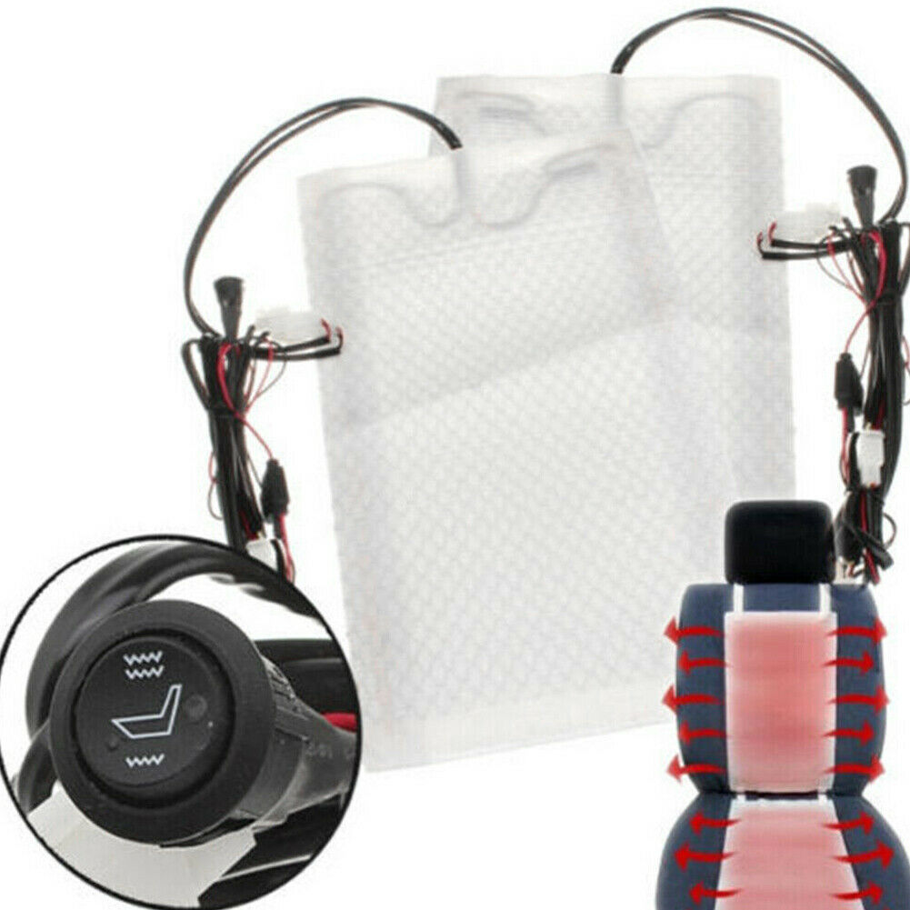

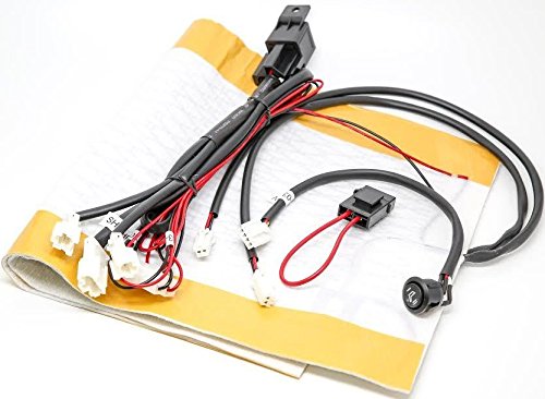

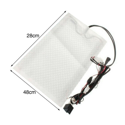

And for heating in very mild cold. In fact it works comfortably in any cold... I use those in Mazda for 5 years now.
Seat heaters. I bought some more permanent design. I like to hide them under the seat fabric. They come with 3 position switches and they heat up enough in about 5minutes. They draw 30W per panel. There are two panels per seat. Heating pad is made from carbon mesh that can be cut or formed without loosing connection.
https://www.ebay.co.uk/itm/Car-1-Seats- ... SwD6VduPLl

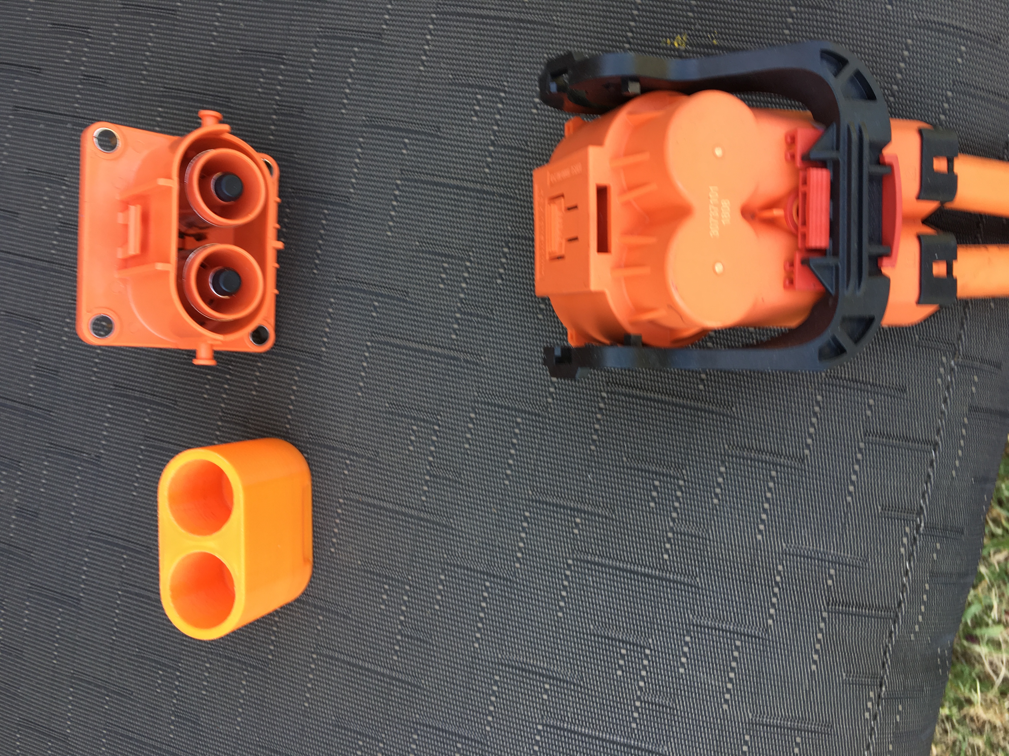

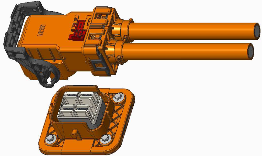

Very interesting Arber. I have bought this plug and socket to use to isolate the inverter when working on it. A friend has 3D printed a plastic cover for the socket, which will have live pins on it from the battery. The plastic cover is an additional safety factor.
Johnspark, maybe you also know where to buy the rest from picture above? Still I'm wondering how to connect main excluding normal connectors availabe for industry.
johnspark
- Posts: 264
- Has thanked: 59 times
- Been thanked: 48 times
damien.lo, i got these from: https://evparts.com.au/connector.html.
i would like to find these from a cheaper supplier for my second conversion though. Or use something completely different.
- Amphenol Plug Socket.JPG (26.58 KiB) Viewed 384175 times
- Kevin Sharpe
- Posts: 1339
- Location: Ireland and US
- Been thanked: 10 times
Tesla Model 3 HV connector assemblies can be purchased at low cost if you hunt around (look for damaged charge port listings). They're TE HC-STACK series and information is sparse. The Model 3 rapid charge connector is the HC-STAK 35 rated for 400A continuous at 85°C and the motor connector is the HC-STAK 25 rated for 275A continuous at 85°C.

Zero-EV has some connectors and cable for reasonable pricing on their site; https://zero-ev.co.uk/product-category/hv-connectors/

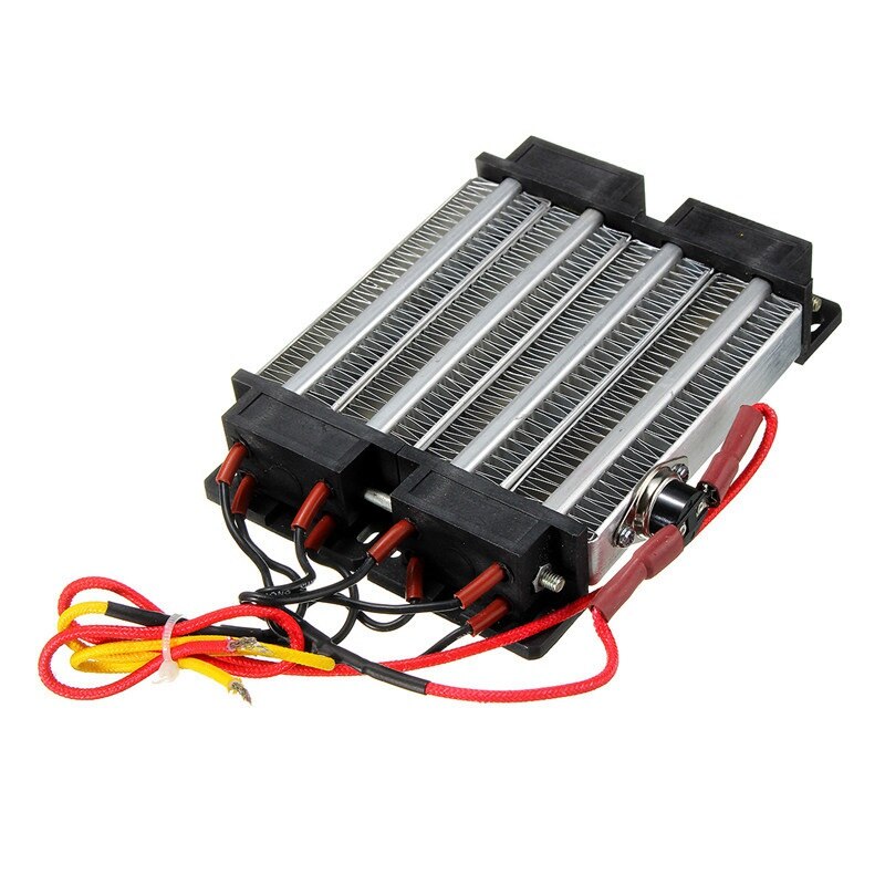

Anyone have a good source for a Ceramic heater to be used in an EV at 300-400V? I am seriously eyeballing a simple blower heater that runs off 240Vac to strip down for its parts.
The Opel/Vauxhall pump is a good one, currently looking at creating a remote reservoir adaptor to enable the 'hiding' of the pump.
I bought something like this PTC heater core - https://www.aliexpress.com/item/32815414254.html
I found one that closely matched the size of the heat exchange matrix in my car's existing heat/ventilation system.
There are different sizes, voltages, heat outputs etc.

I seen those too, however I am not a fan of having those shitty wires. I want to have something like that with spade connectors atleast.
Wonder how they hold up to vibration.
