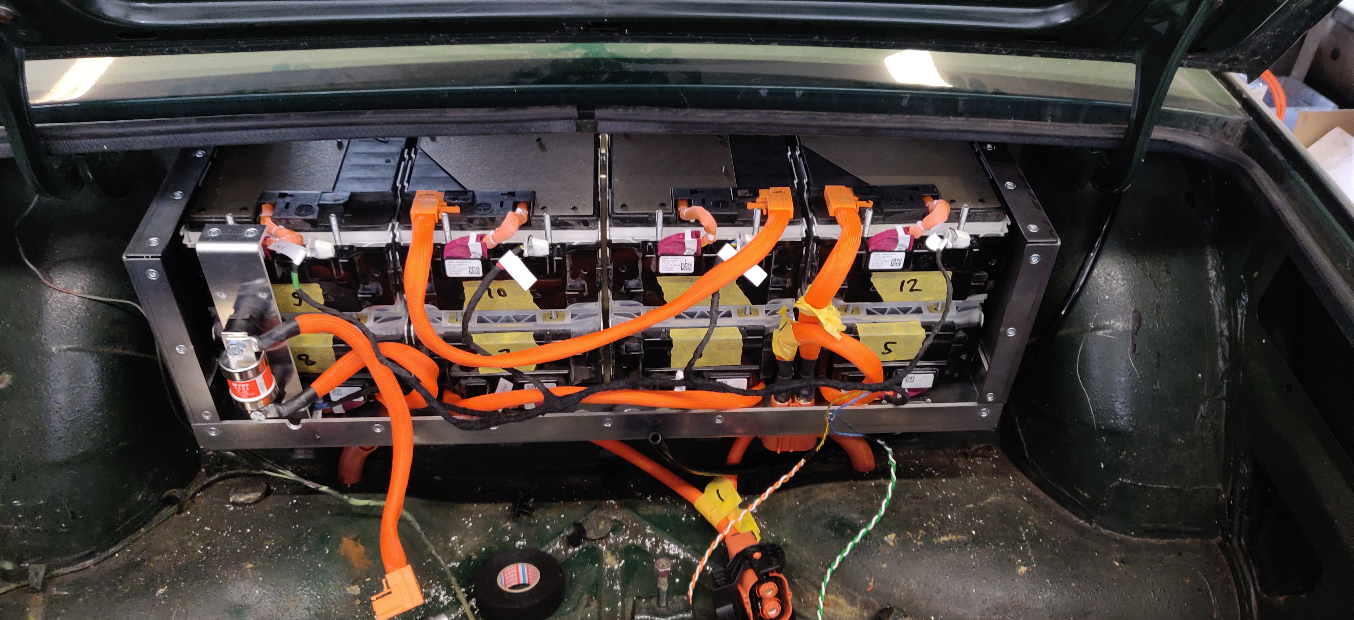

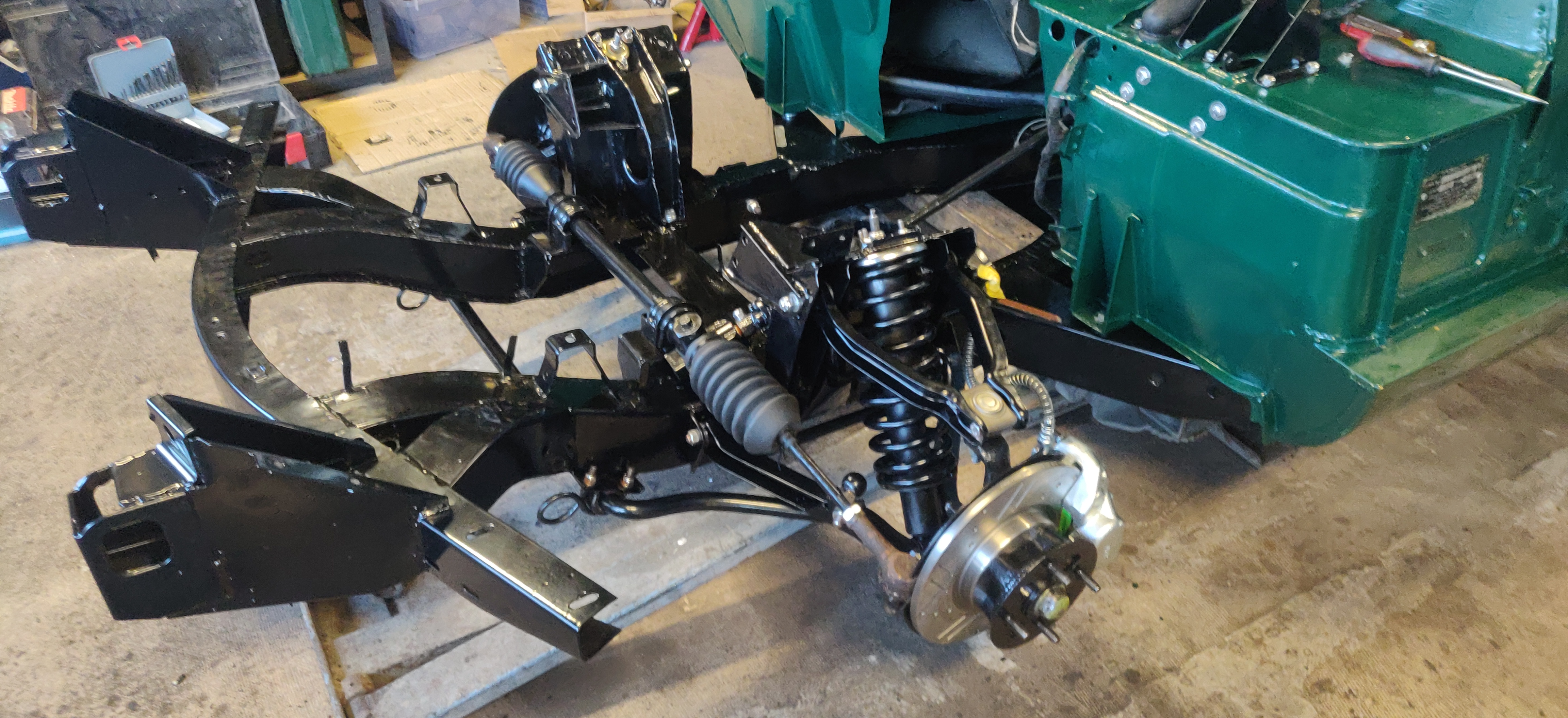

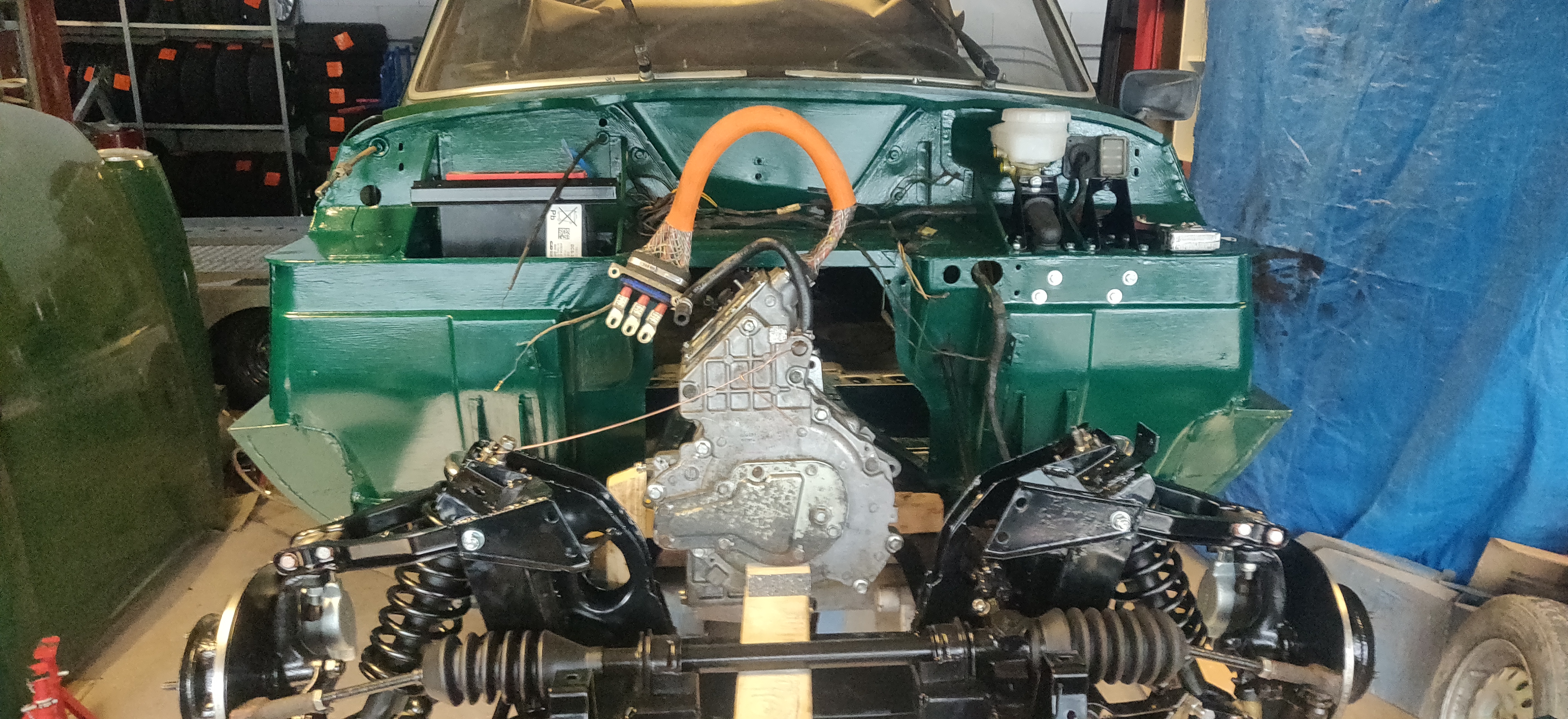

hereby I want to share my project, I will post additional text and explanation later when I have more time.

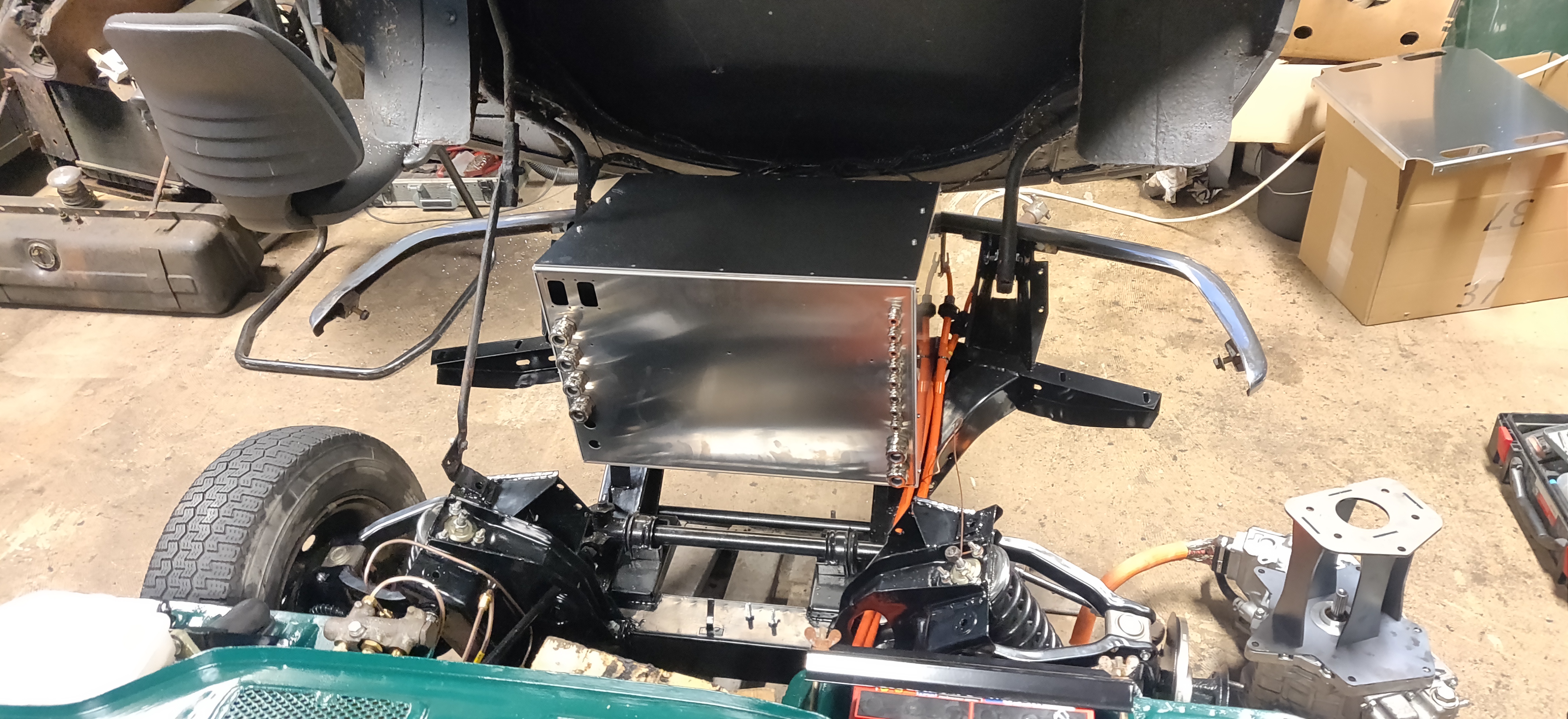

The car has stood still for 22 years in a shed, I use the Mitsubishi Outlander generator as an engine on the original gearbox. original inverter and tesla gen 3 charger, it contains a 24kw bmw battery pack from an x5 hybrid.

Excellent build. Thanks for sharing.
nathaniel wrote: Sat Mar 25, 2023 11:31 amit contains a 24kw bmw battery pack from an x5 hybrid.
Do you have two BMW packs, or do you mean 24ah?
Re: triumph spitfire with mitsubihi generator as motor
Posted: Sat Mar 25, 2023 4:31 pm
by tom91
Boxster EV wrote: Sat Mar 25, 2023 4:16 pm Do you have two BMW packs, or do you mean 24ah?
https://www.car.info/en-se/bmw/x5/g05-m ... 5429/specs
BMW X5 hybrid was made with 24kWh 12 module configuration.

Boxster EV wrote: Sat Mar 25, 2023 4:16 pm Excellent build. Thanks for sharing.
What Tom says, the modules are the same as the 12kw pack but the difference is that these modules are 8s2p configuration instead of 16s. Bms is also the same but reads only 8 cells per module off course.

nathaniel wrote: Sat Mar 25, 2023 11:31 am hereby I want to share my project, I will post additional text and explanation later when I have more time.
Hi, nice project. Interested in your coupler. We're working on 1949 Chrysler which has similar classic gearbox. How did your love-joy coupler ended up working? Did you later replace to a solid one? Also how did you get the alignment right when you made your extension box instead of the bellhousing? Thanks 😊
Posted: Sun Mar 26, 2023 8:04 pm
by nathaniel
m.art.y wrote: Sun Mar 26, 2023 7:40 pm Hi, nice project. Interested in your coupler. We're working on 1949 Chrysler which has similar classic gearbox. How did your love-joy coupler ended up working? Did you later replace to a solid one? Also how did you get the alignment right when you made your extension box instead of the bellhousing? Thanks 😊
the coupler is working fine until now. in my opinion a solid coupler is not the correct way top connect two shafts that have there own bearings, those are never aligned 100% so you want a bit of flex in between. otherwise something will wear out and if there is nothing flexible in between, metal will wear out. but that's just based on my mechanical experiences, this is my first conversion so you might get away with it too. the mounting bracket between the engine and gearbox are very precisely made with laser cutting. test fit done without coupling and checked whether the shafts align, this was the case, so then mounted with the coupling. the distance is so large because I do not want to shorten the original axis of the box.

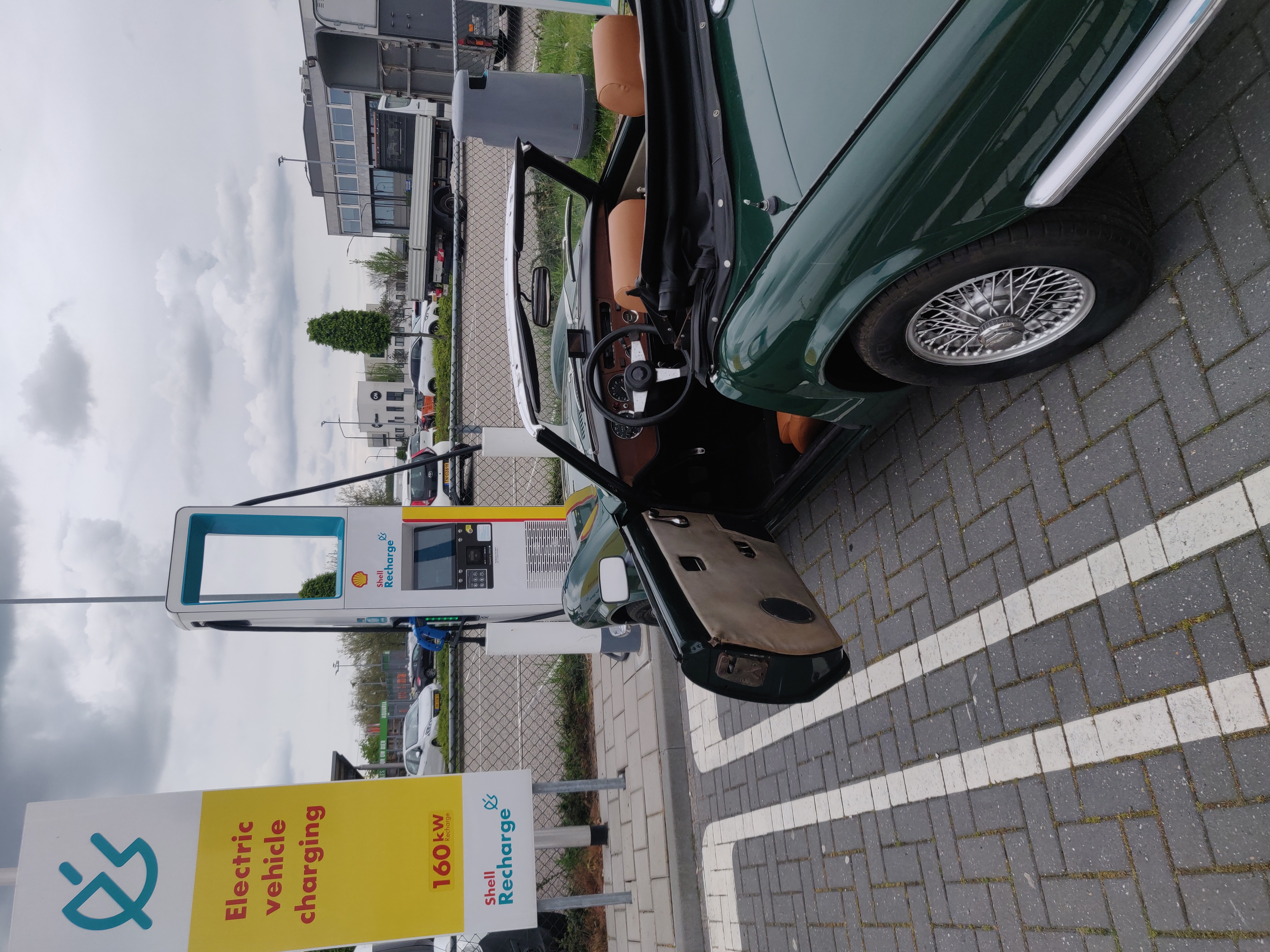

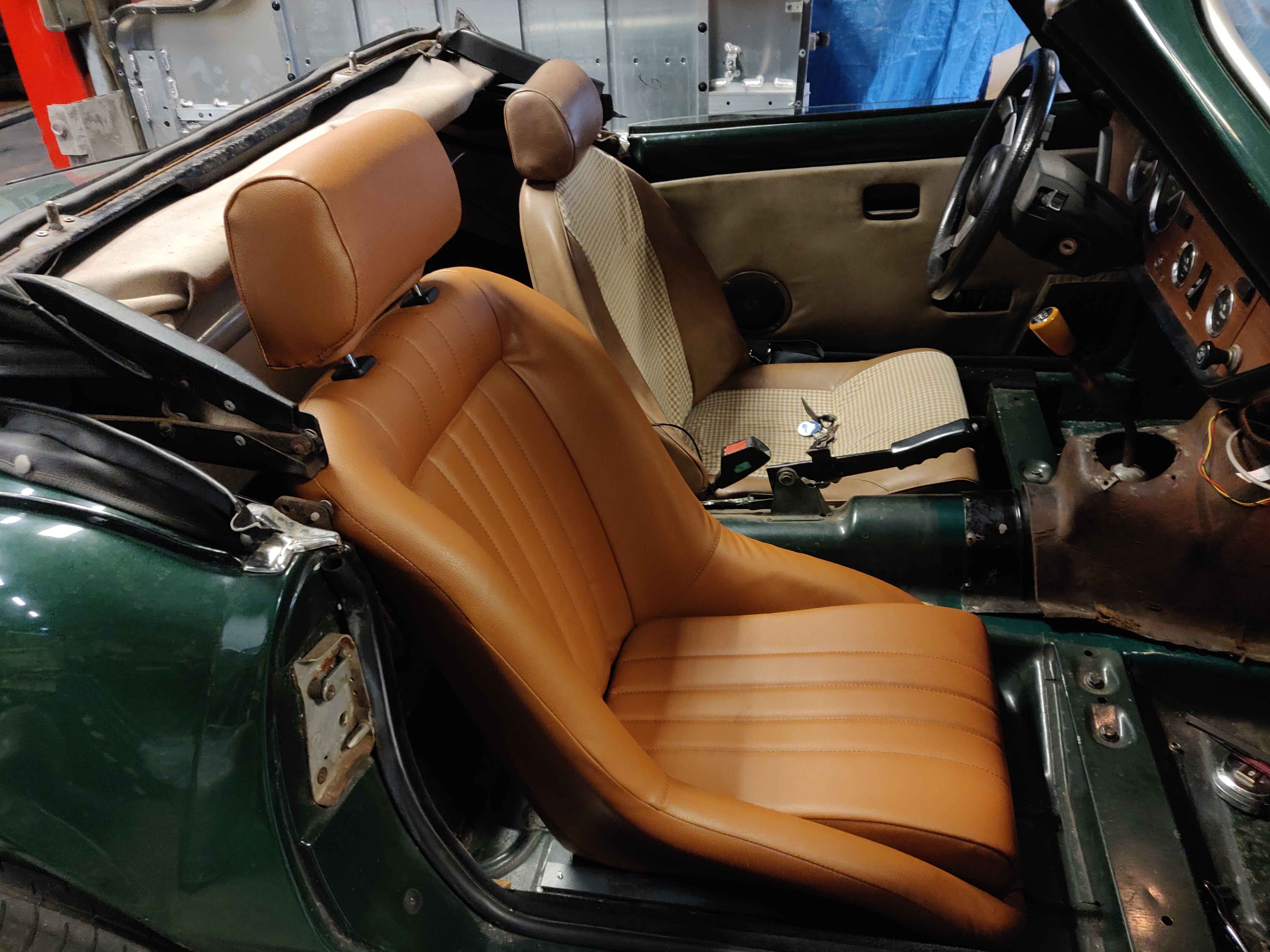

A little update on the spitfire, interieur starts to look nice again. And the main thing is that I've managed to get CCS fast charging working! With the help of this forum of course! I'm very pleased with that.
