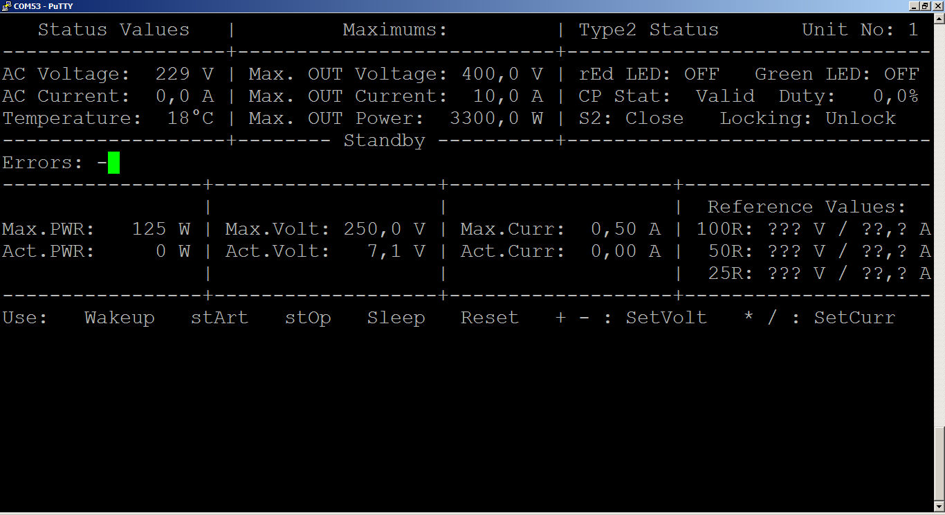

I already have my own diagnostic software for it, which I can use to test it after repairs, but I didn't think that it is customary to write something like this here right away...

I quickly made a screen save. Above in the middle, the Max. Voltage / Max. Current data is returned by the charger and changes depending on the Derating; the real maximums are 430V and 12A. On the upper right side are the data of the charging controller in the charger: it measures the parameters of the CP signal, and the control signals of the Type2 connector can also be controlled.
The lower part is now zero everywhere, because I was too lazy to attach a load to it.
