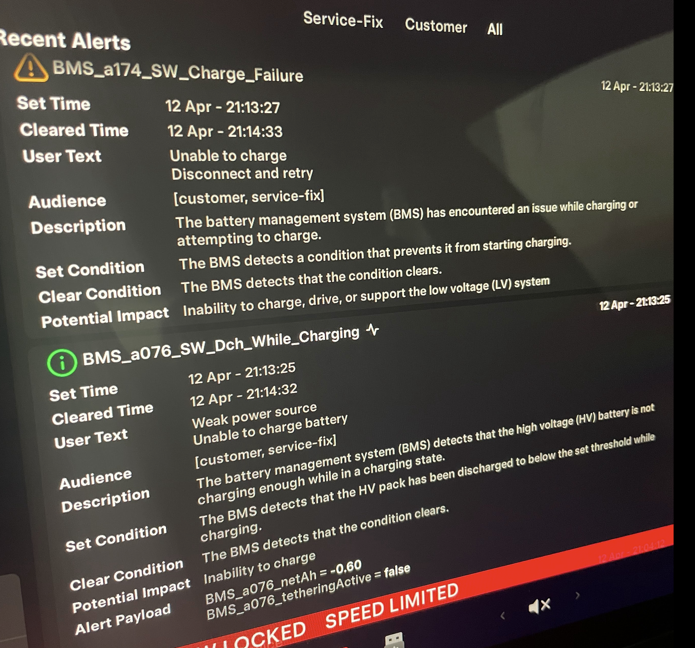

It is a model Y, with CCS2 charge port. I use my own SECC in my test, so the detail in SLAC timing and CP signal could be different here.
From what you described it look like PEV does not go into sounding state, possible cause could be EVSE pwm signal is out of spec, check the timing and voltage level make sure it is with in specification as described in ISO 15118-3
