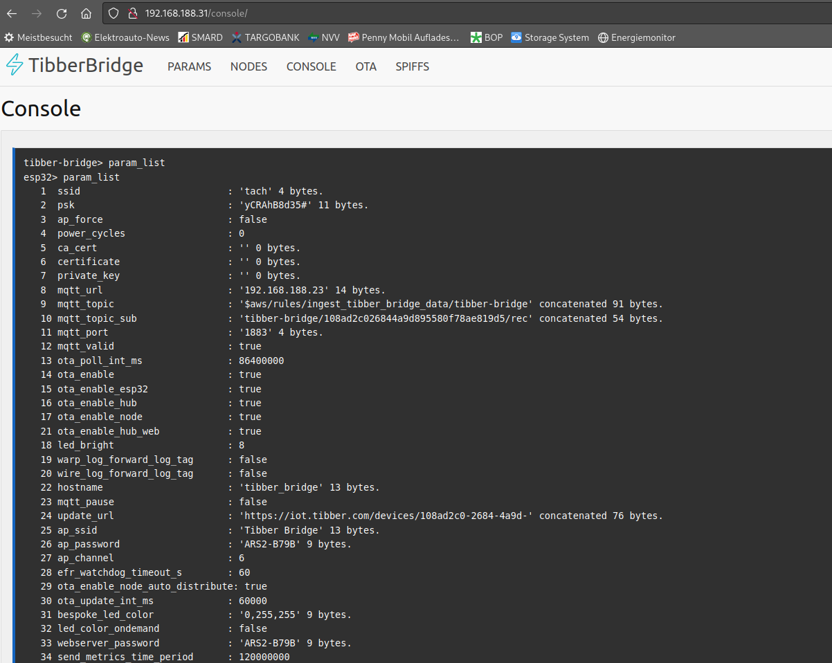

So, I got a bit further with this, be aware that this may apply only to the german Tibber-IR infrared reader.
With the help of others I got the Tibber bridge to connect to my local MQTT server. Besides setting address and port of your local broker you must also fully delete the various crypto keys which is only possible via the console
You do "param_list" which gives you the respective ids, in my case 5, 6 and 7 Then you type "param set 5 \" (same with 6 and 7). That clears the keys and will connect to your broker without cryptography.
Finally you save this with "param_store"
Ok, so now I'm getting some meta data messages on two topics:

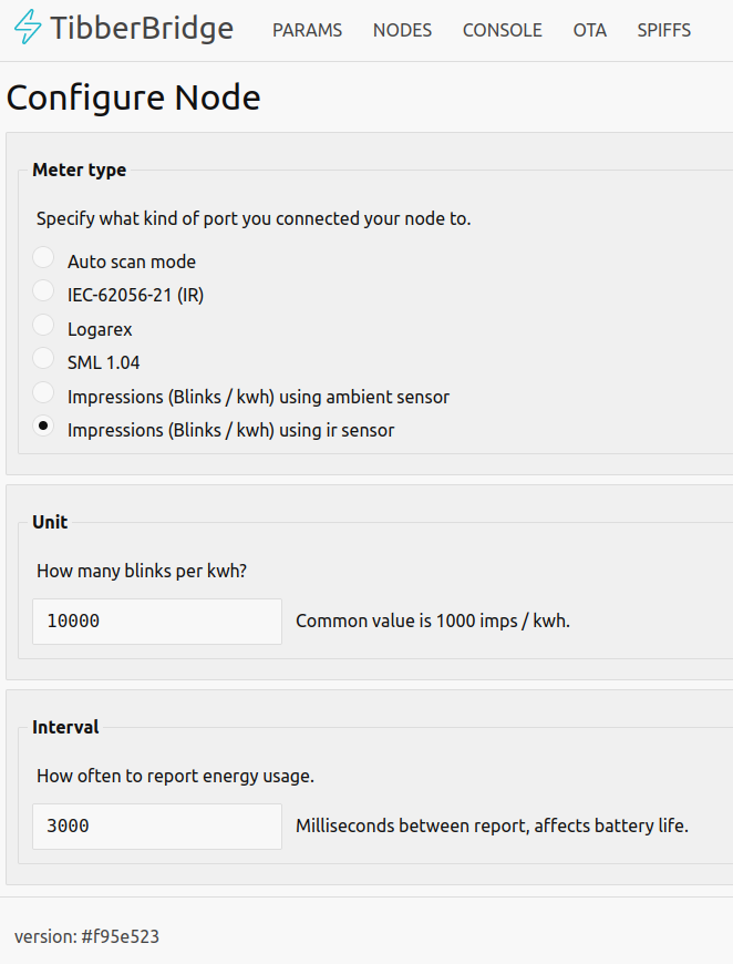

Got a bit further with the data. I configured the pulse for a 10000 pulses/kWh input.
$aws/rules/ingest_tibber_bridge_data/tibber-bridge/yyy/publish/TFD01/dc8e95fffeb82bfe/imp:
I hacked up a quick python script that uses the actual meter data to generate an appropriate pulse frequency (the pulse LED on the actual meter is too dim) and let it run all night. Strangely though, the kWh counter does not increase at low wattage, apparently. In the beginning I simulated multiple kW with like 10 Hz frequency that's how the 0.8297 kWh accumulated but then the realistic data didn't increase the counter.
Most of all the tibber app doesn't pick up on it. It says the pulse is not sending data. So could really use data from someone with a working meter.
I have an EBZ DD3 ODZ1 which according to this facebook post works for some people. I flashed its raw data into the pulse with no result.
Then I flashed an IR LED at it and indeed the MQTT messages now changed:$aws/rules/ingest_tibber_bridge_data/tibber-bridge/yyy/publish/TFD01/dc8e95fffeb82bfe/imp:
{"$type": "imp_data", "timestamp_ms": 34652489,"delta_ms": 11782,"kw":0.030555, "kwh": 0.8297}

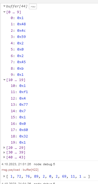

Hi Johannes,
i'm still struggling getting the SML data to the mqtt topic. ATM i've attached a UART IR reading head to my electricity meter.
In NodeRed i'm able to read data: But I've no idea how i should convert to the data for pubishing it to an mqtt-topic.
Could you give me a hint?
