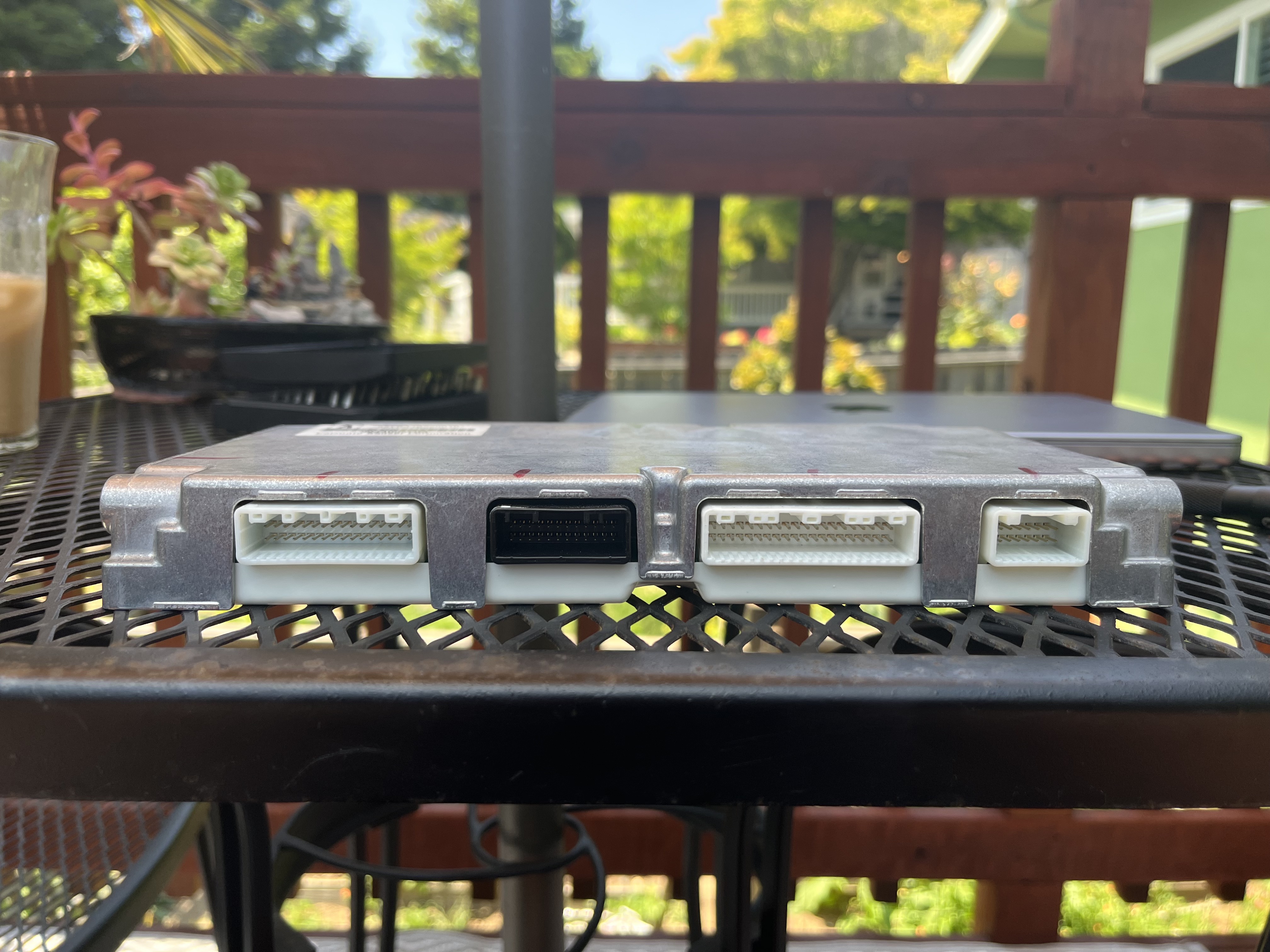

It would be interesting to know if the pinout and connectors are still the same, I made a test board for that a while ago. Most likely it will be identical but you never know:
viewtopic.php?t=2085

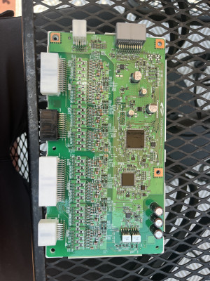

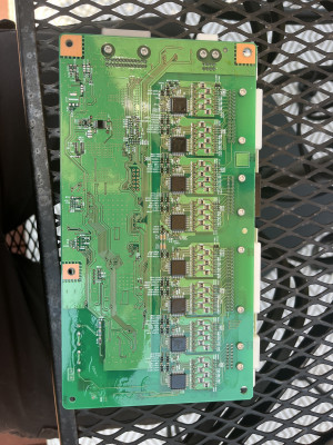

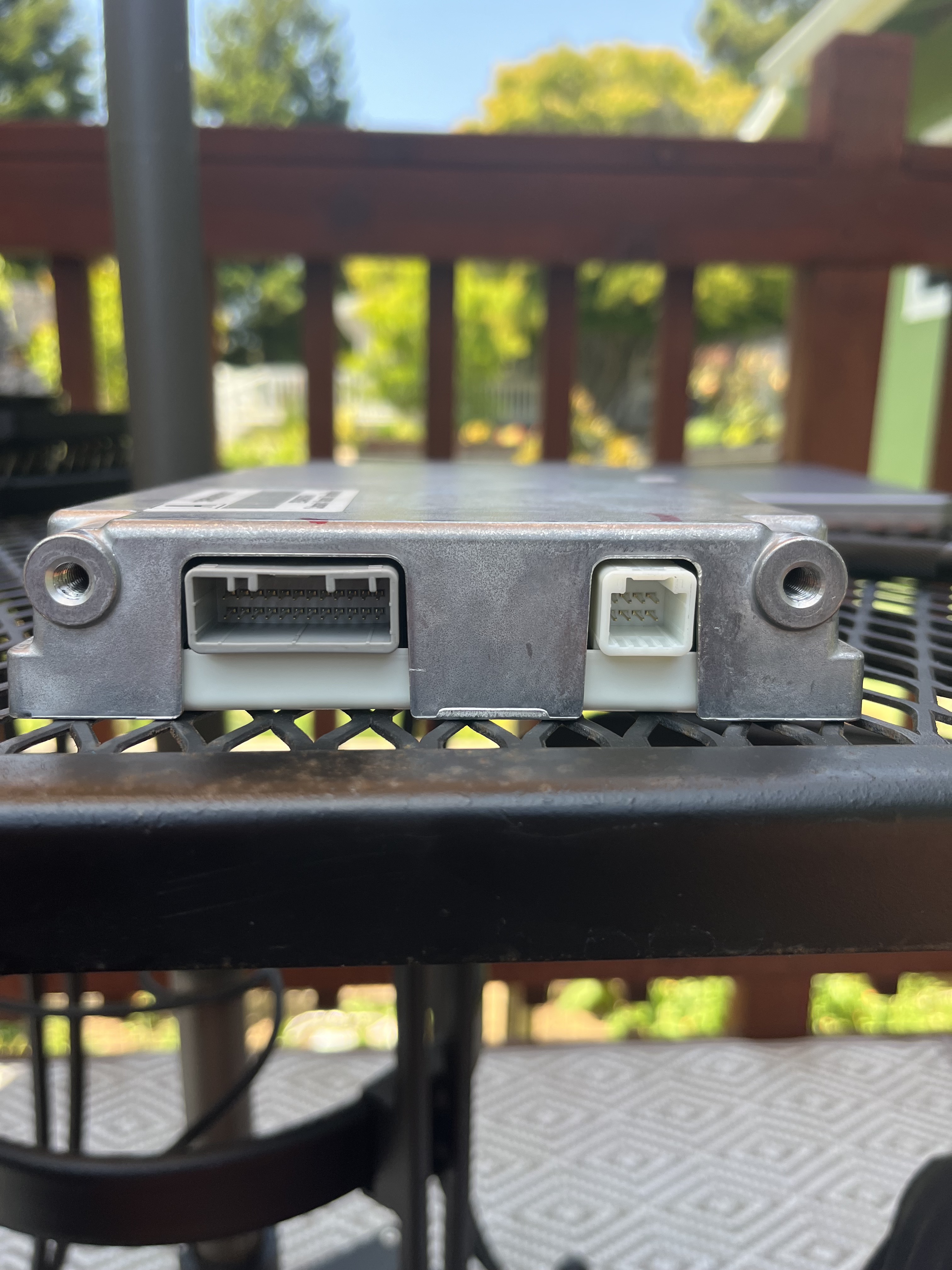

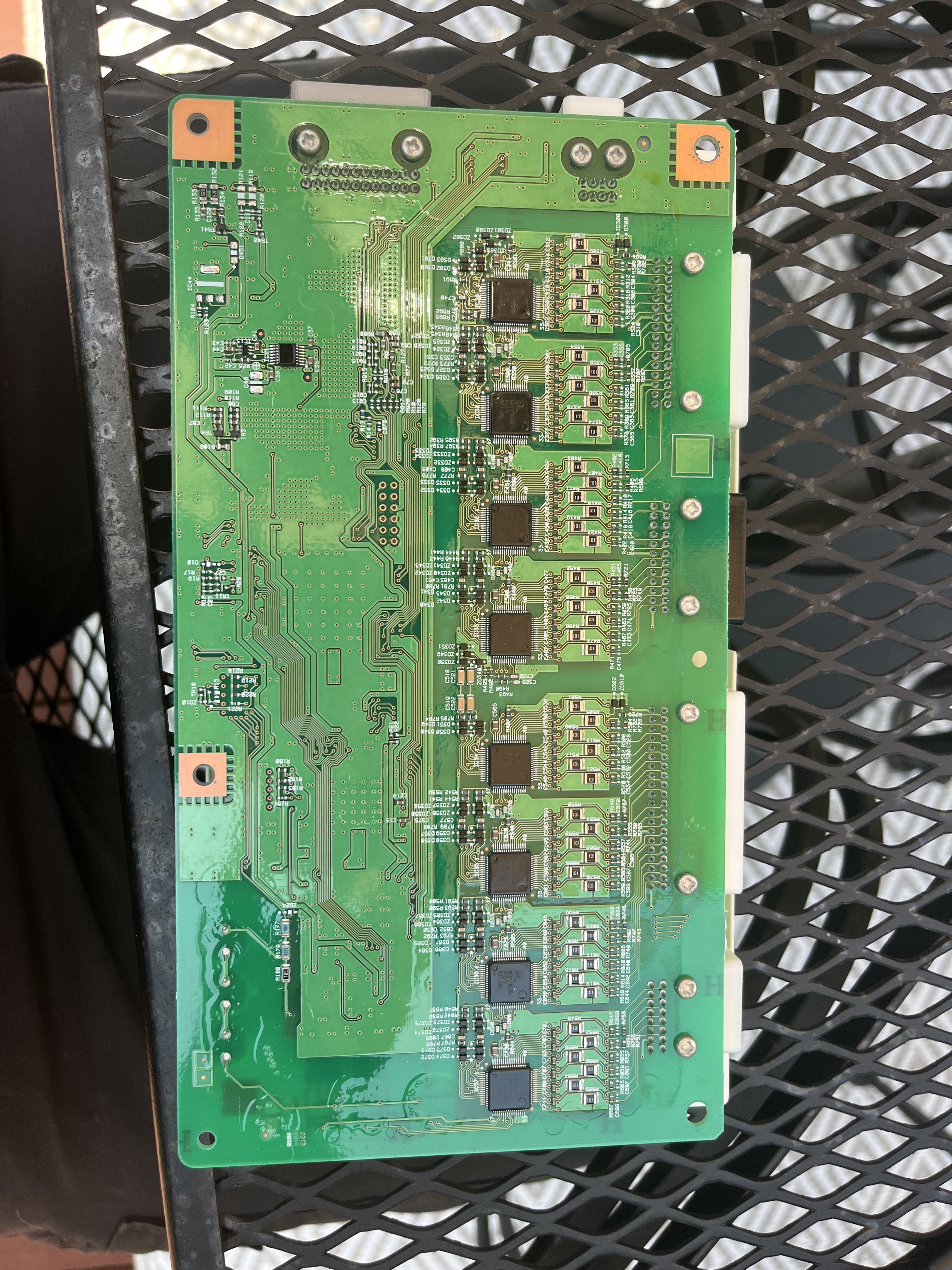

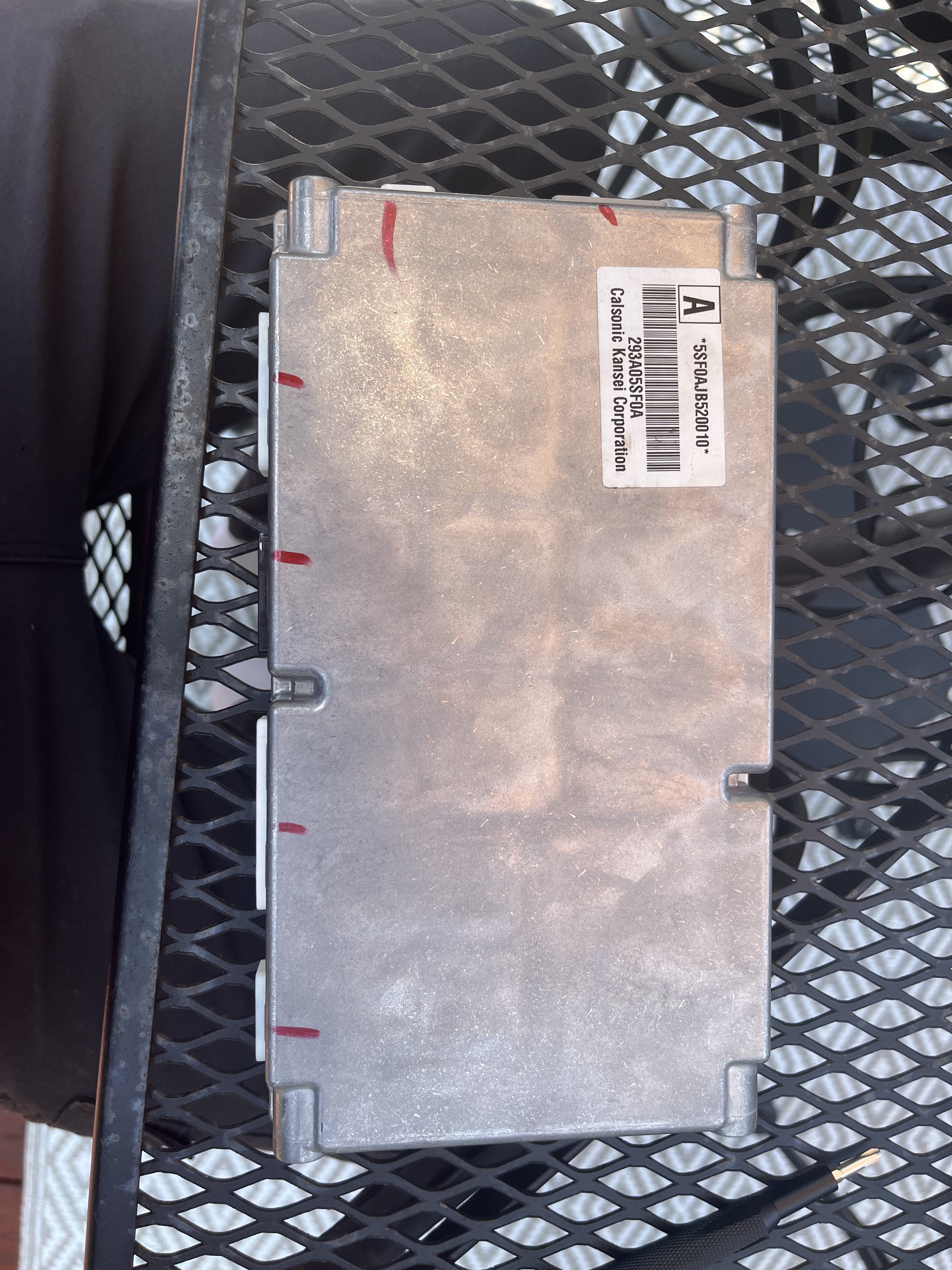

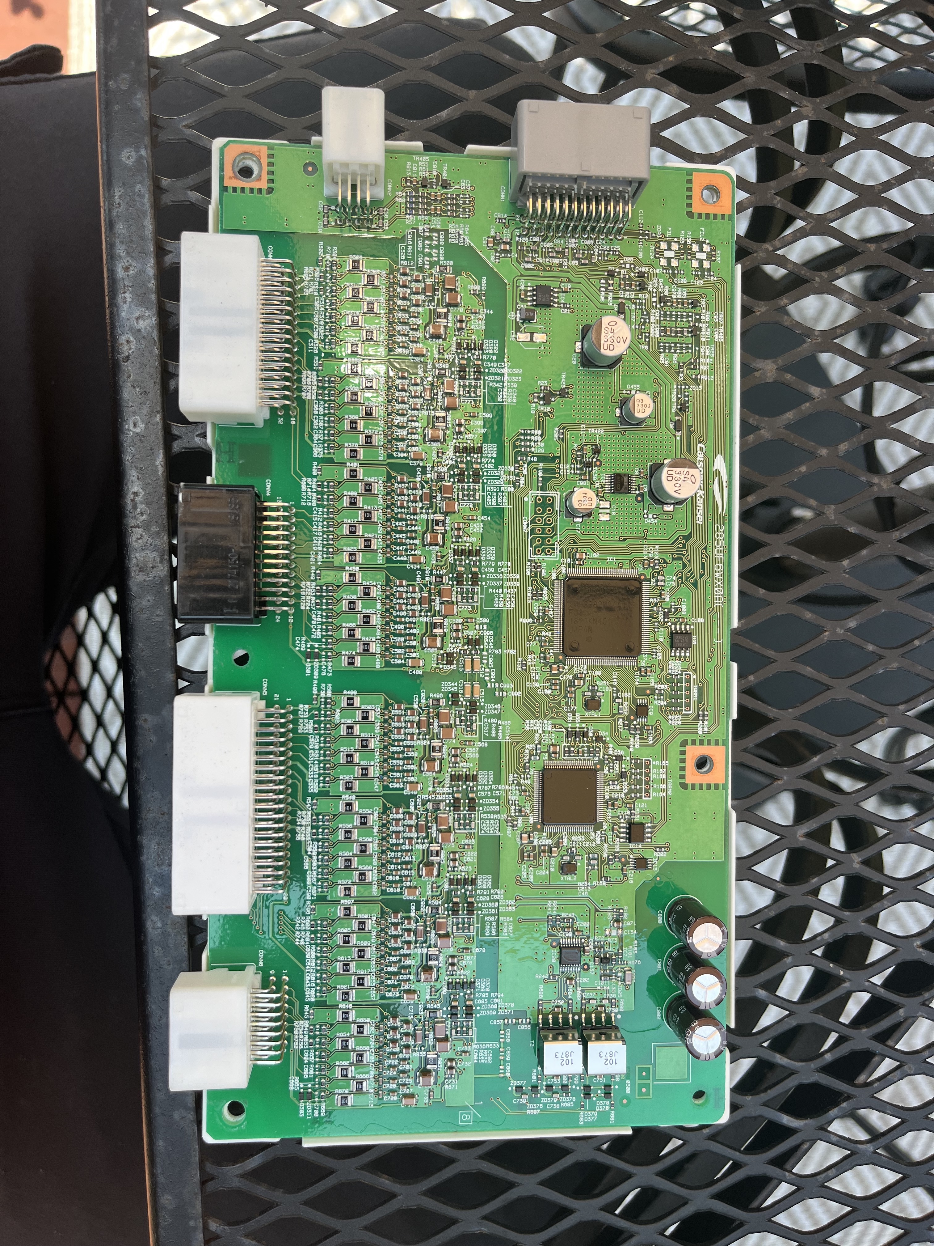

Got any photos of the BMS?

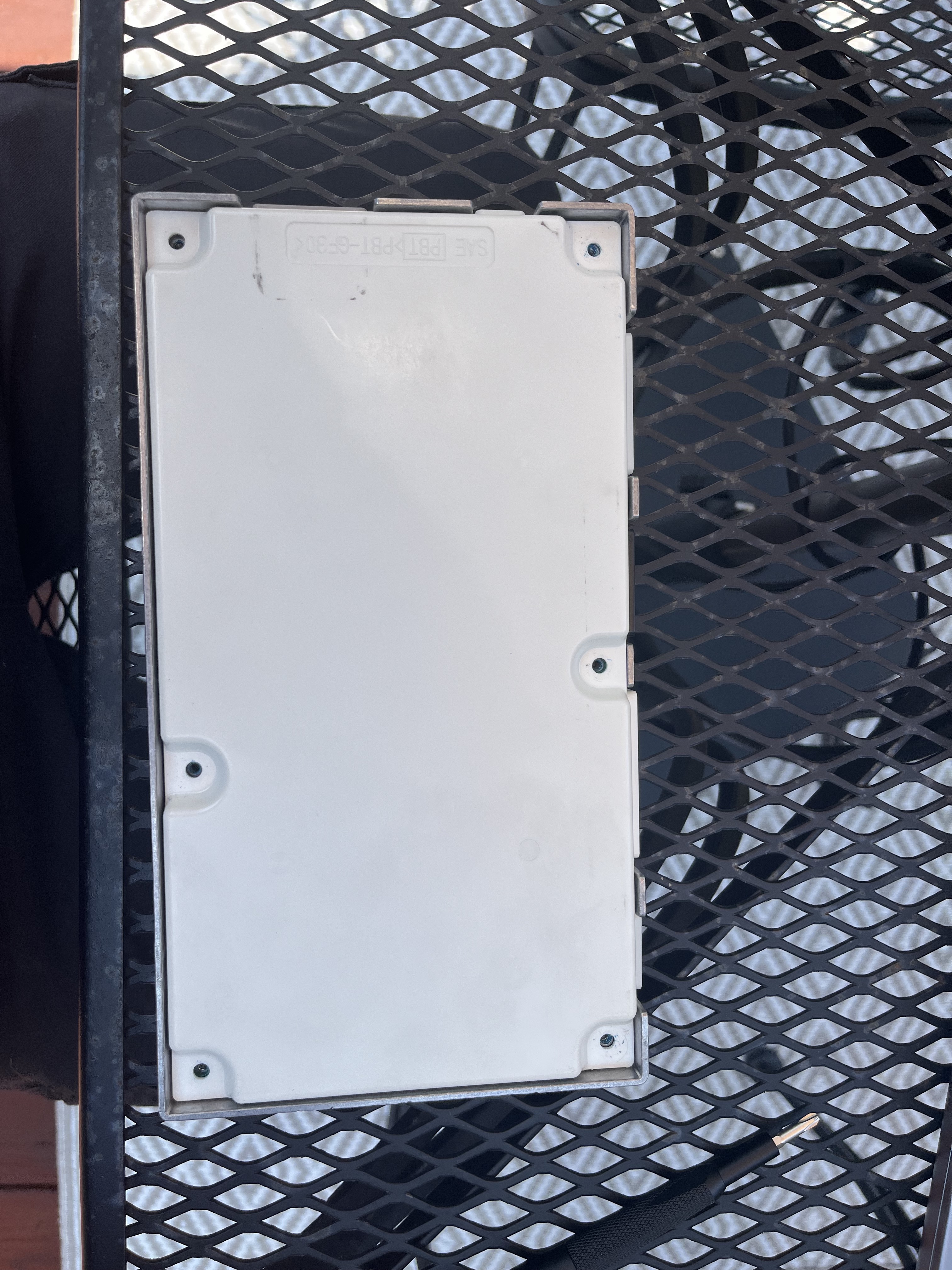

janosch wrote: Tue May 30, 2023 8:16 pm Got any photos of the BMS?
2020 Nissan Leaf 62kwh BMS pictures
