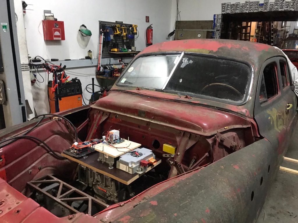

i would like to introduce you to this little project i do together with a stunt crew from Berlin. Its 1951 Ford Vedette piece of rusty metal.
We found it on the scrapyard and thought it is too beautiful to let it go back to mother earth. And actually the material isn't too bad under the bonet, frame/structural parts are good. The car is more or less just a shell, it did't have a motor, gearbox, driveshaft or whatsoever, just a bunch of ratshit we already cleaned out. We already rebuilt the rear leafspring suspension, welded together some preliminary motor mounts and are currently testfitting parts of the drivetrain. We still don't have a driveshaft and gearbox, despite the rearwheel 9:1 diff wich seems to be from a chevy s10.
I should note that we dont aim to get this to a street legal state after the conversion. This build is straight for the lulz and learning and "artistic expression" i would say. Maybe we punish it on some racetrack who knows, but we don't aim to comply with any rulez other than our imagination and newton. So we'll see where that goes :idea: :twisted: :ugeek: :geek:
you see we are fans of that precision german cardboard engineering, :mrgreen:
but we are probably going to replace some of that cardboard after the mockups work.
We have some of that startrek machinery at hand
and will probably use it after we are cool with the general setup.
Ah yeah i should not that we are fitting a leaf motor and inverter with the obvious openinverter magic.
I will post progress if there is some.

So the hubner is running, i swapped in a new openinverterboard and flashed the newest FOC firmware. Next weekend i'm gonna try to spin the motor first time, press thumbs.
Also I hooked up a little round diplay interface i made, into the old gaugecluster which fits pretty nice. Software needs to be rewritten but from the looks i think its promissing and suits the build. But we might as well take another route in terms of the cockpit "design".. something more nasa (or RAKA) would be cool.. segment displays or something.. a bit more retro might just be more suitable :ugeek:
