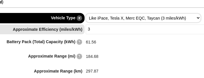

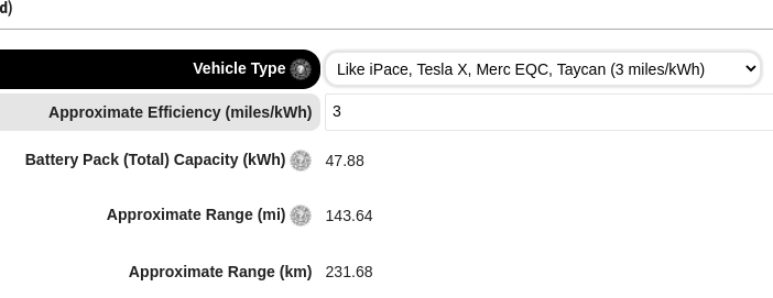

I found something for you:
This is the EVbot from Cascadia motion. you can chose a different battery configuration and different cars.
http://www.cascadiamotion.com/evbot

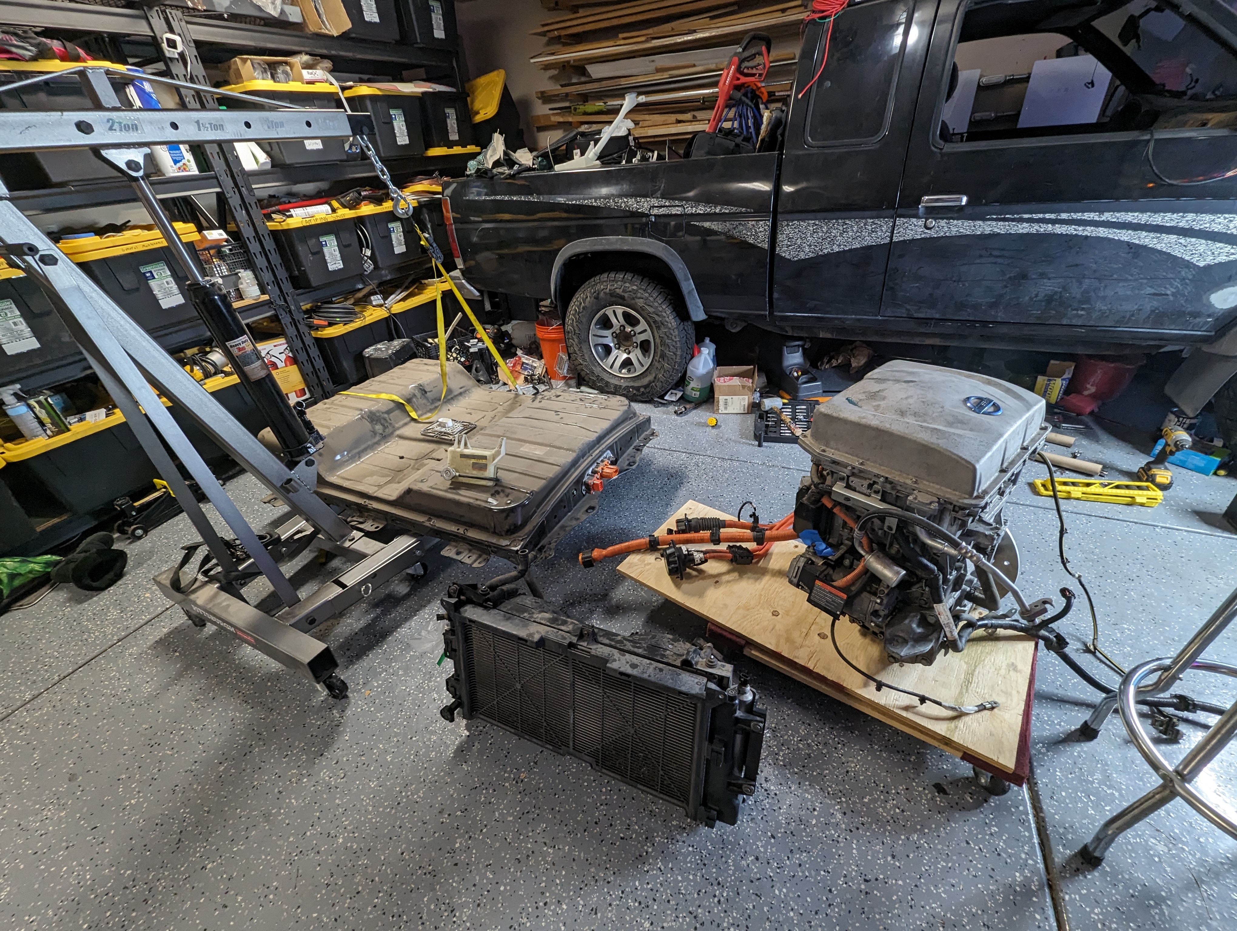

I have made some progress on the truck, and just acquired a donor 2013 Nissan Leaf. In the Hardbody, I have installed the rebuilt transmission, transfer case, and drive shafts. I'm having the Brat Industries coupler machined and welded over the weekend. Also, the adaptor plate seems to line up perfectly with this Nissan transmission. I plan on getting the truck moving as a test with the Nissan Leaf battery pack placed in the bed, and make a custom battery box/pack at a later date.
Does anyone have a recommendation on where to buy the HV wire terminals that I could use to make a temporary extension HV cable for the Leaf battery pack in the truck bed? If anyone knows the exact terminals I would need to make the cable that would be helpful too. :)
What power steering pump would the community recommend for my build?

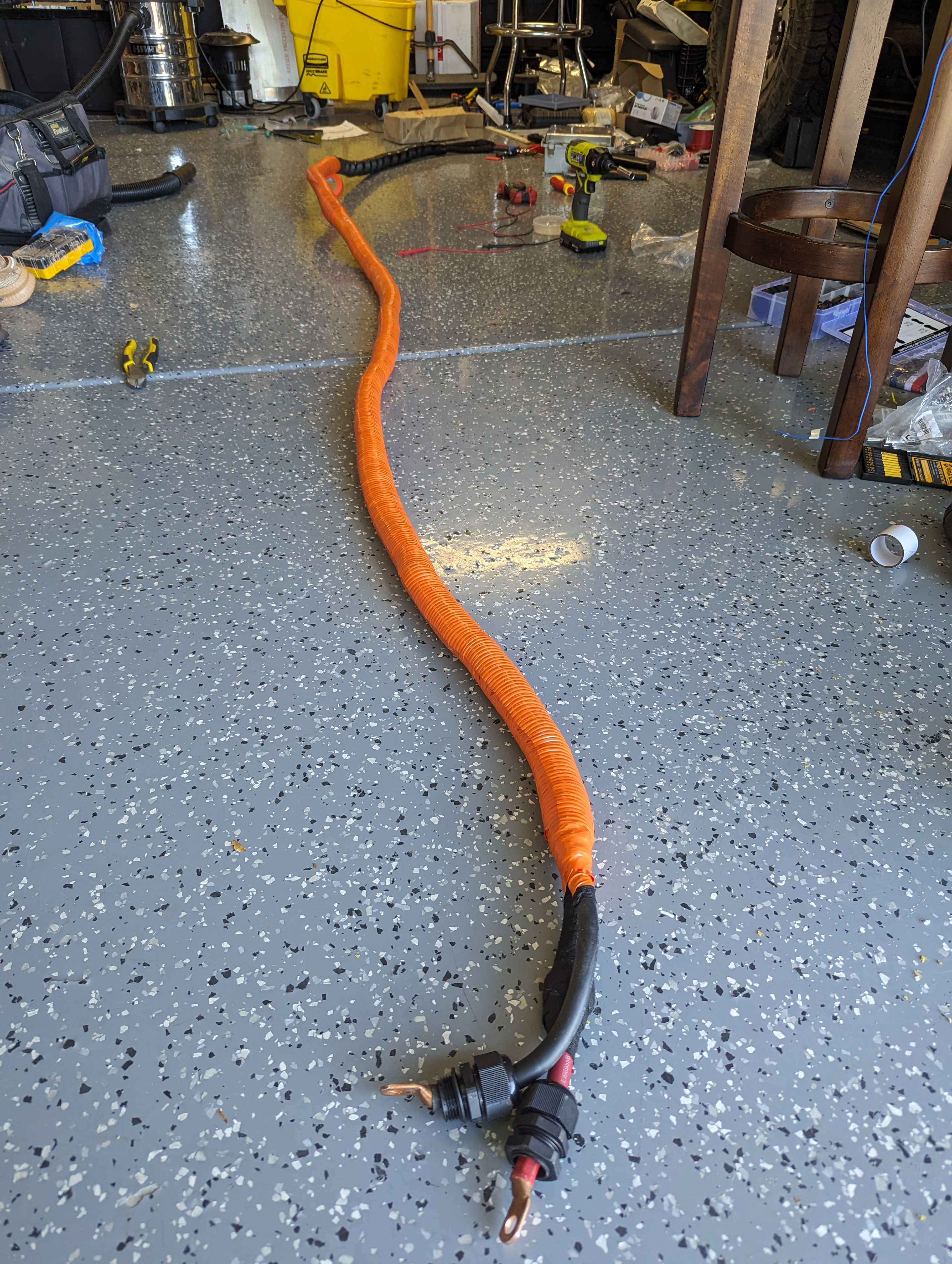

I got some scrap 2/0 welding wire from the a decommissioned TuSimple self-driving semi-truck. I added some braided sleeves for protection and to reduce any EMI. Is it worth it?
It's gotta be orange...
