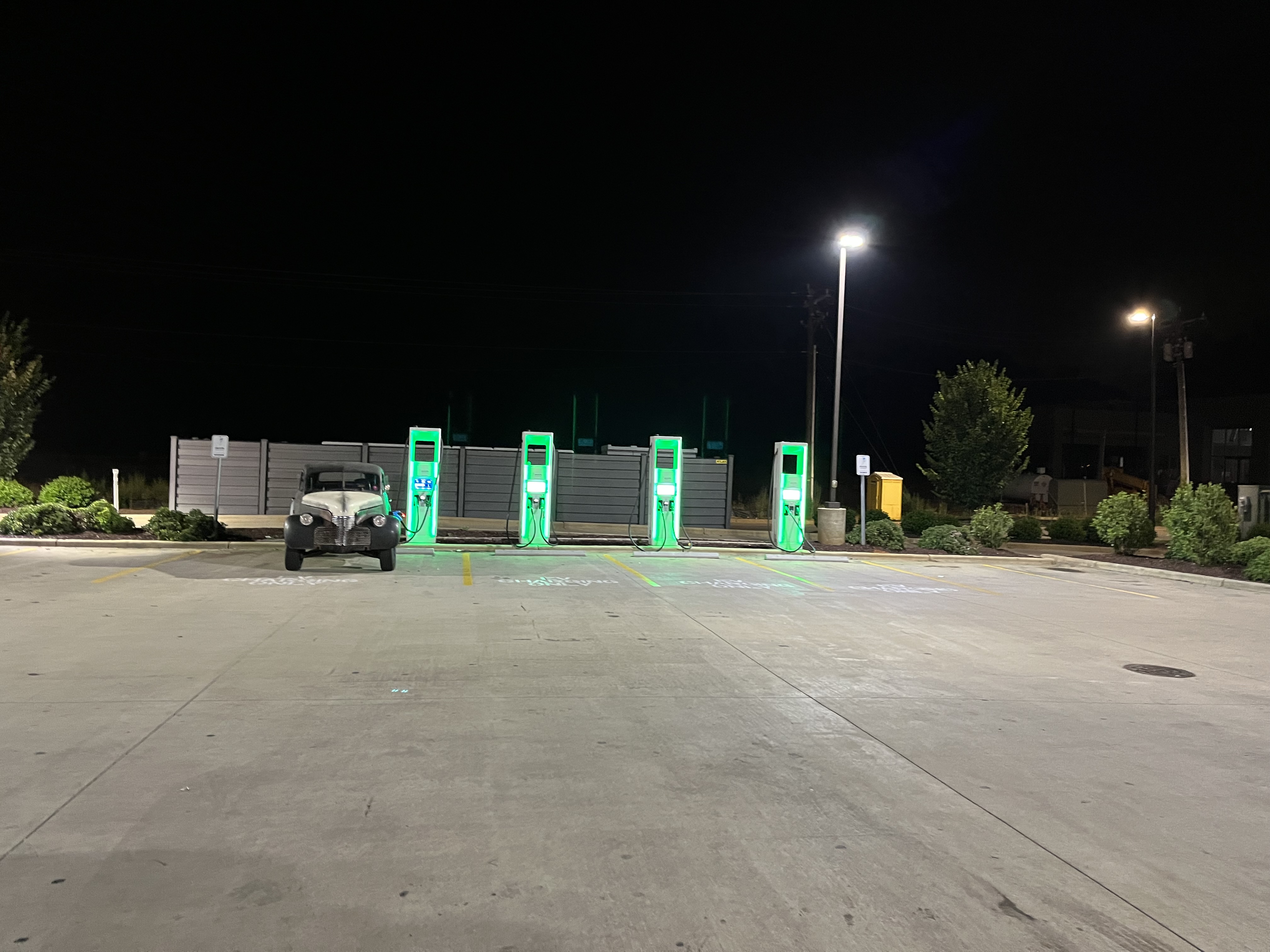

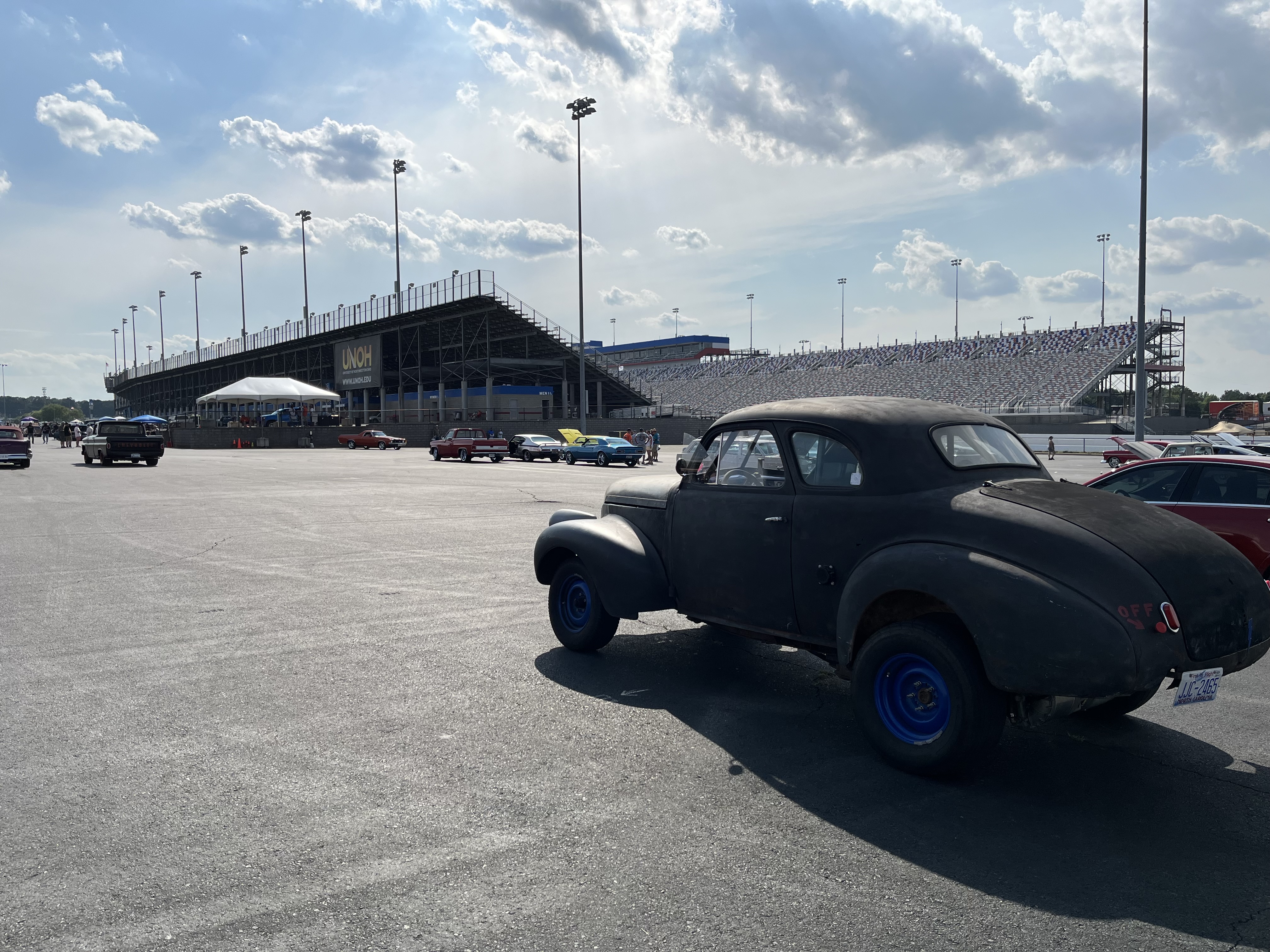

One shot from the track, and one from the second to last charging stop on the way home:
