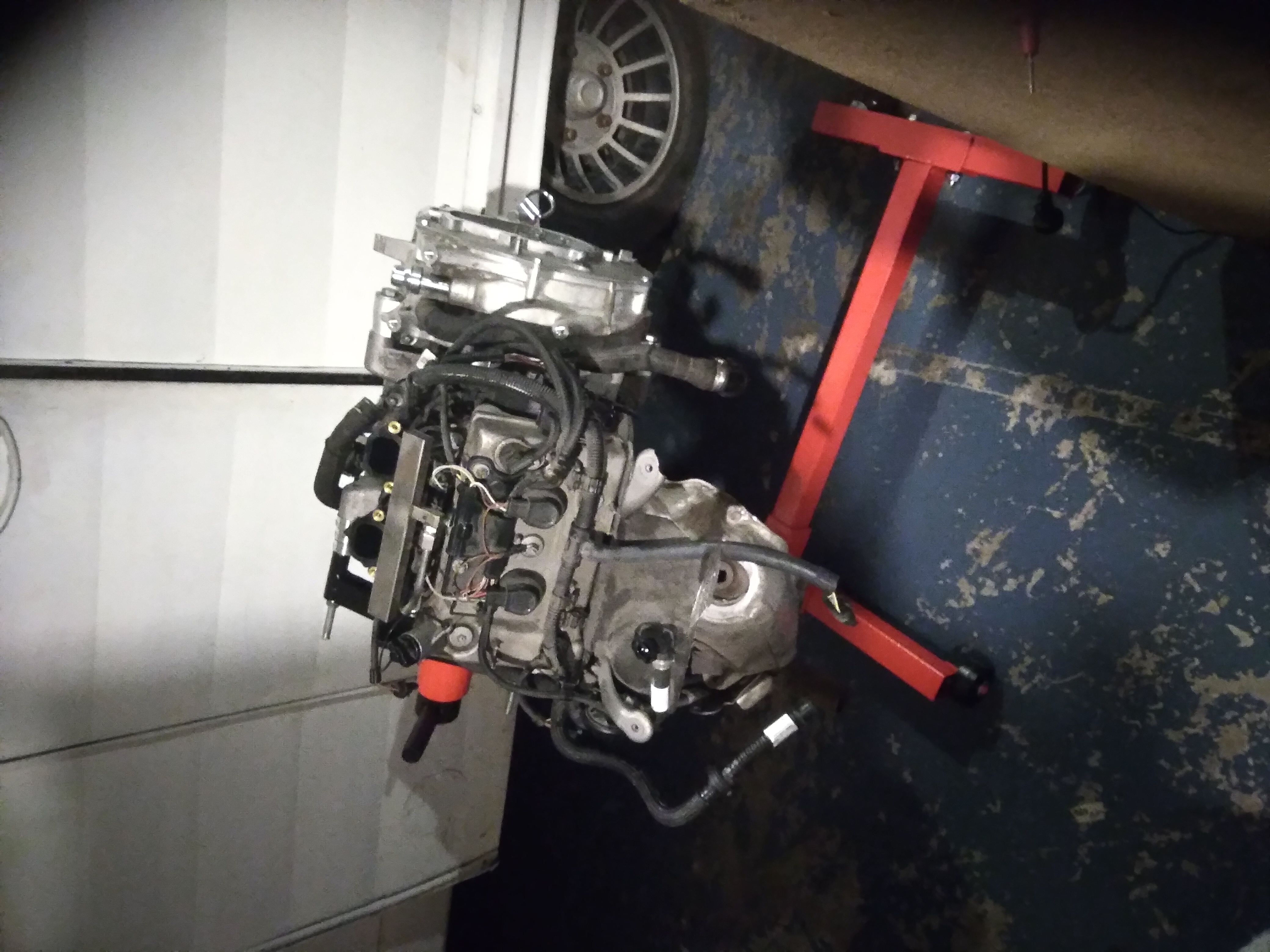

Have collected the i3 REX, which is covered with lots if ancillary hardware. First step will be to mount on a frame, and take off the unneeded hardware, to simplify the rig.
Does anyone have any Specifications on the Valeo generator, 2621582 ? Still searching.
The engine is reported at 25Kw, but enquiries about the generator , reveal that in operation the i3 will drive at 60 to 70 kph on the flat...
This would indicate say 6KW ??? Which seems low for the size and about 80kg bare or 100kg in vehicle specs.

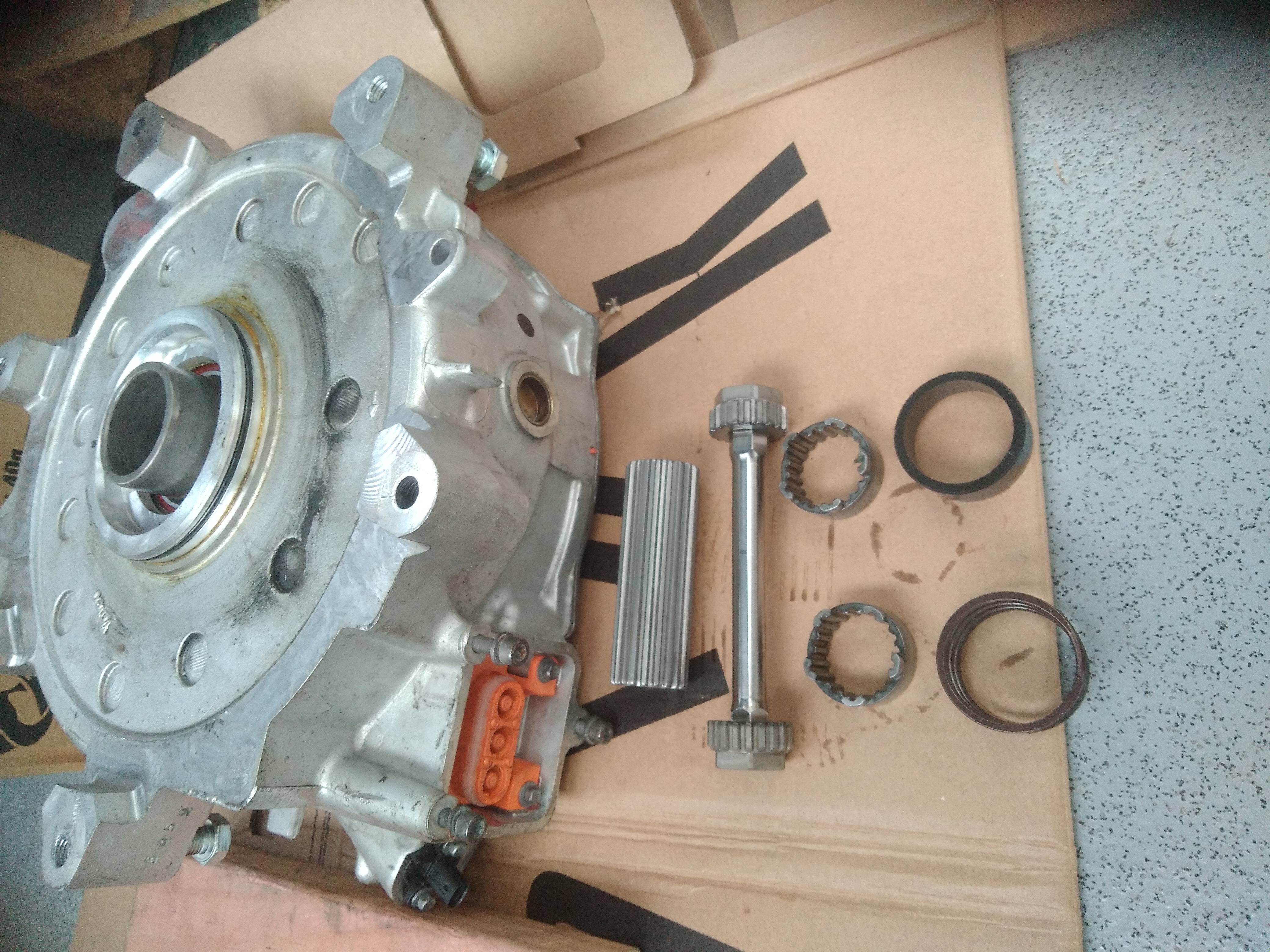

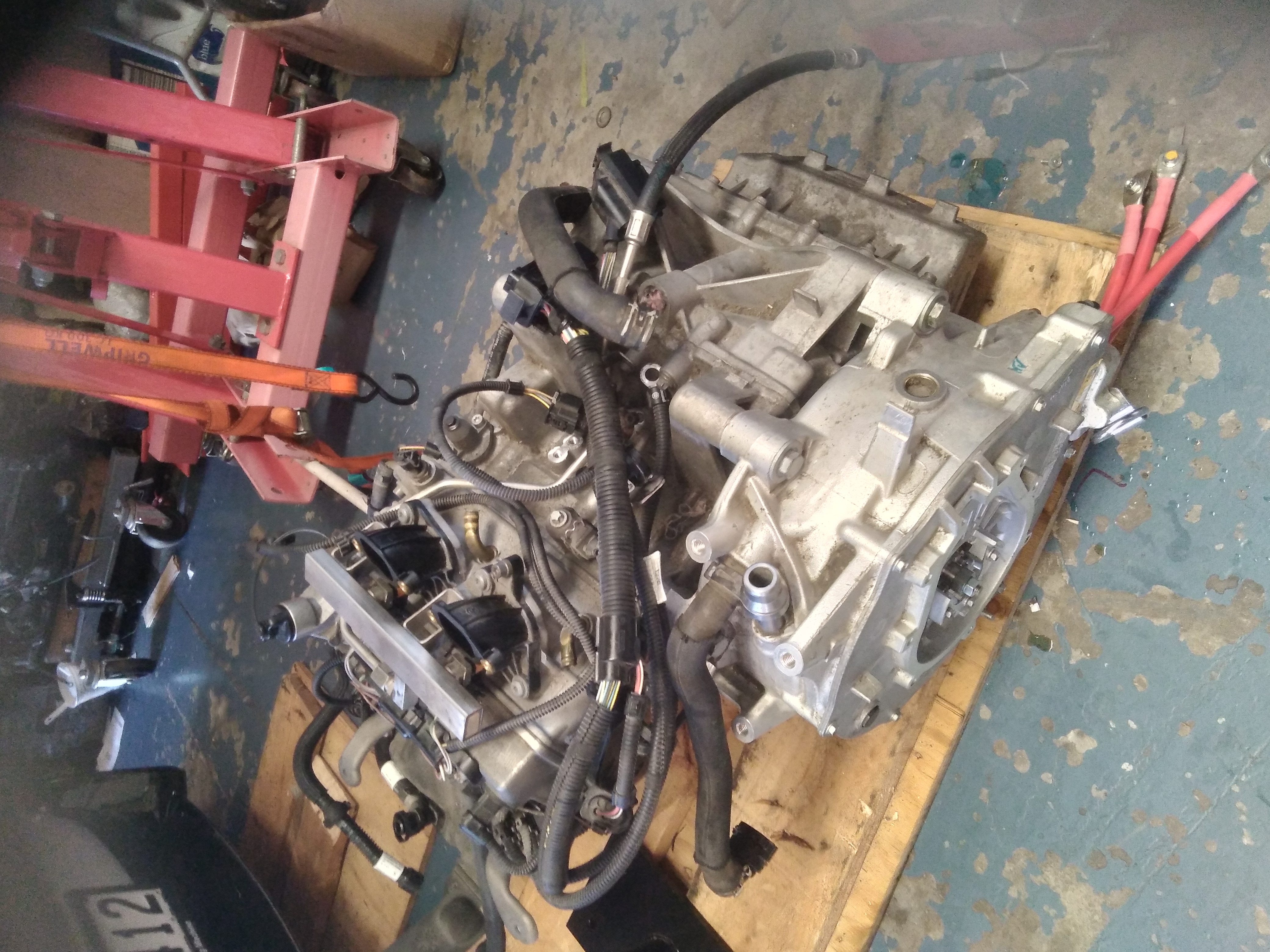

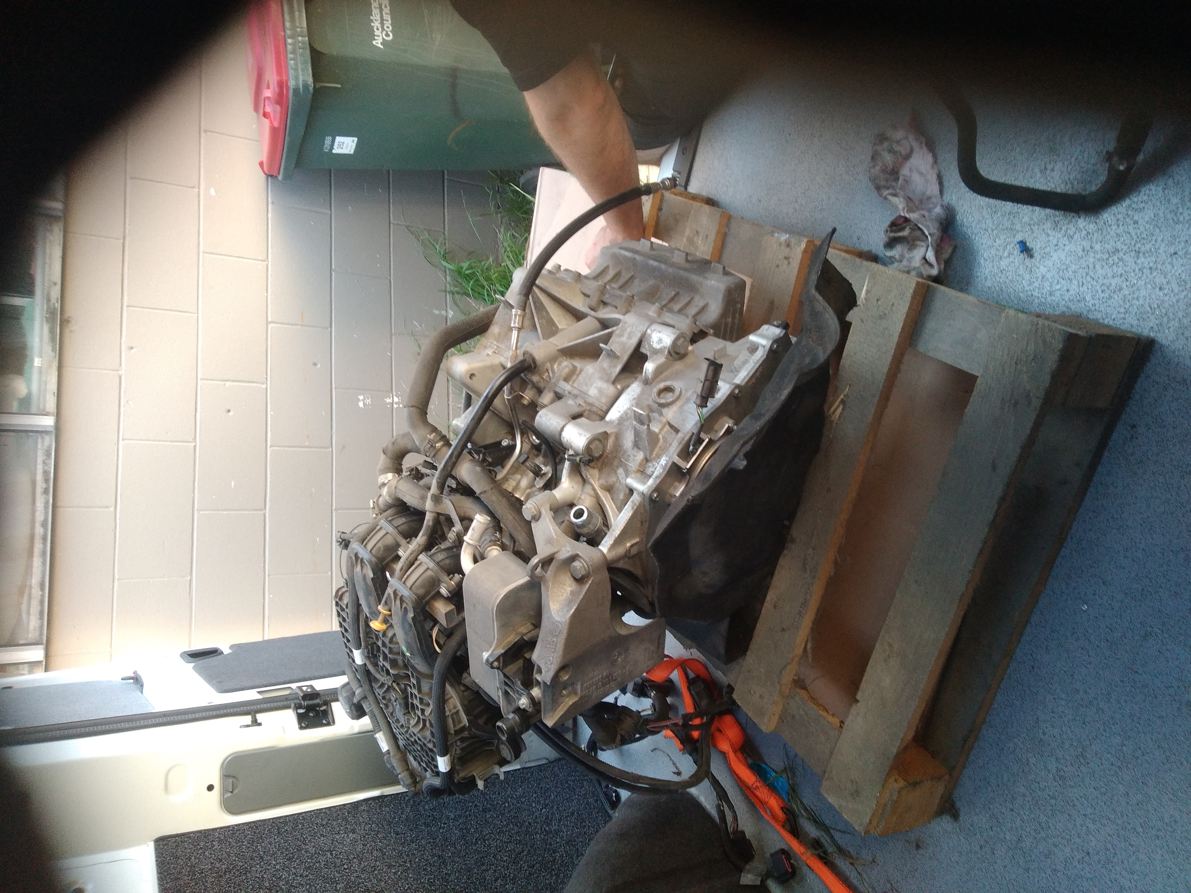

Re: State of Rex hacking?
Have removed some of the conglomeration of cooling plumbing, and removed the airbox with some connectors being rather awkward.. this has revealed the spark plug igniters, which could be useful, and the fuel rail is in easy view..
So far no specs located on the valeo gen/starter.
So have proceeded to separate from the engine . A very grudging extraction, seemed like the spline was locktited in... the housing has threaded holes, which appear yo be designed for Jack screwing the generator off. Suitable Screws and spacers allowed removal of the spline which uses a Hex ended torsion rod , to anti backlash, and possibly work as a dampener connecting the engine to the generator, which is effectively its flywheel.
Of electrical interest, spun the rotor with a drill, at nameplate 1500rpm, and produced AC 33V rms.
There is a 5 lobe resolver, and will do a locked rotor sequence to determine the pole pair count. If this is 10, or 5 pole pairs, then it maybe possible to use a Nissan leaf gen1 inverter and Thunderstruck vcu, to start and charge to the bus voltage.

Have only the REX motor and Generator assembly.jrbe wrote: ↑Sun Jan 14, 2024 2:29 am How much of the rex controls do you have? ECU, harness, etc? I assume it has a fly by wire throttle body too?
If they're outputting 25kw from the combustion engine they likely are sending that minus losses to the traction motor then the balance to charge battery.
I was reading up a bit on it. Sounds like there's at least 2 power output modes from sourceless Internet info. A low vehicle speed mode claimed at 12kw then the higher speed / load 25kw.
Would be great if utilizing these was some can bus messages to figure out.
Unfortunately none of the control or loom available.
Am hunting for a plug for the 3 phase motor connections, which are difficult to connect without the original loom bit.
So no CAN information or control hardware,
The Generator has been removed, and aiming at using an inverter which can run the 5 Pole pair, and 5 resolver Lobe Valeo generator, as a motor to start and run the ICE.
Leaf inverter has 4 pole pair and 4 lobe resolver, so maybe usable.
Prius inverter has 4 pole pair, but 2 Lobe resolver, so is unfortunatly unsuited .
Much to learn..

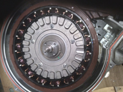

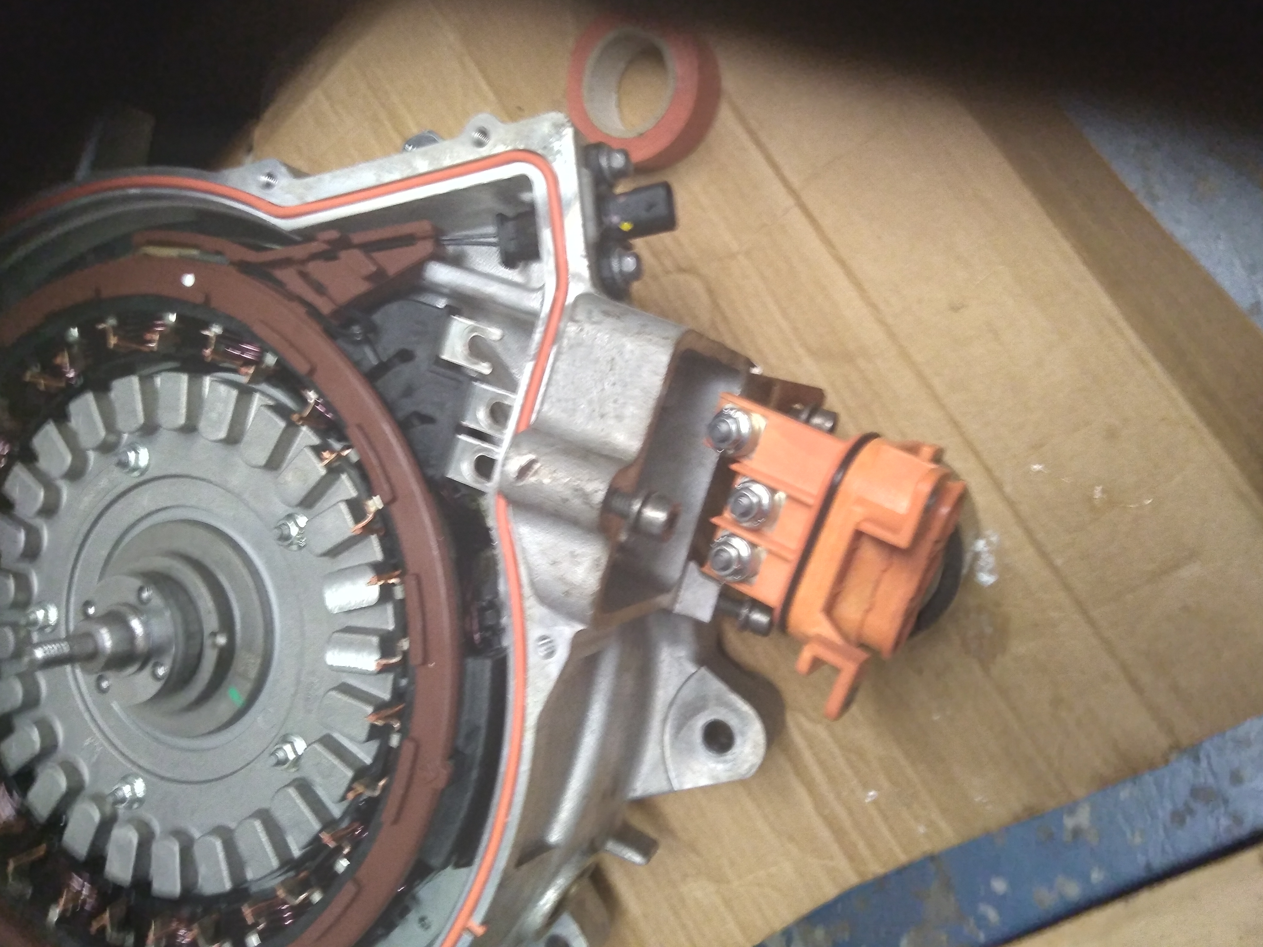

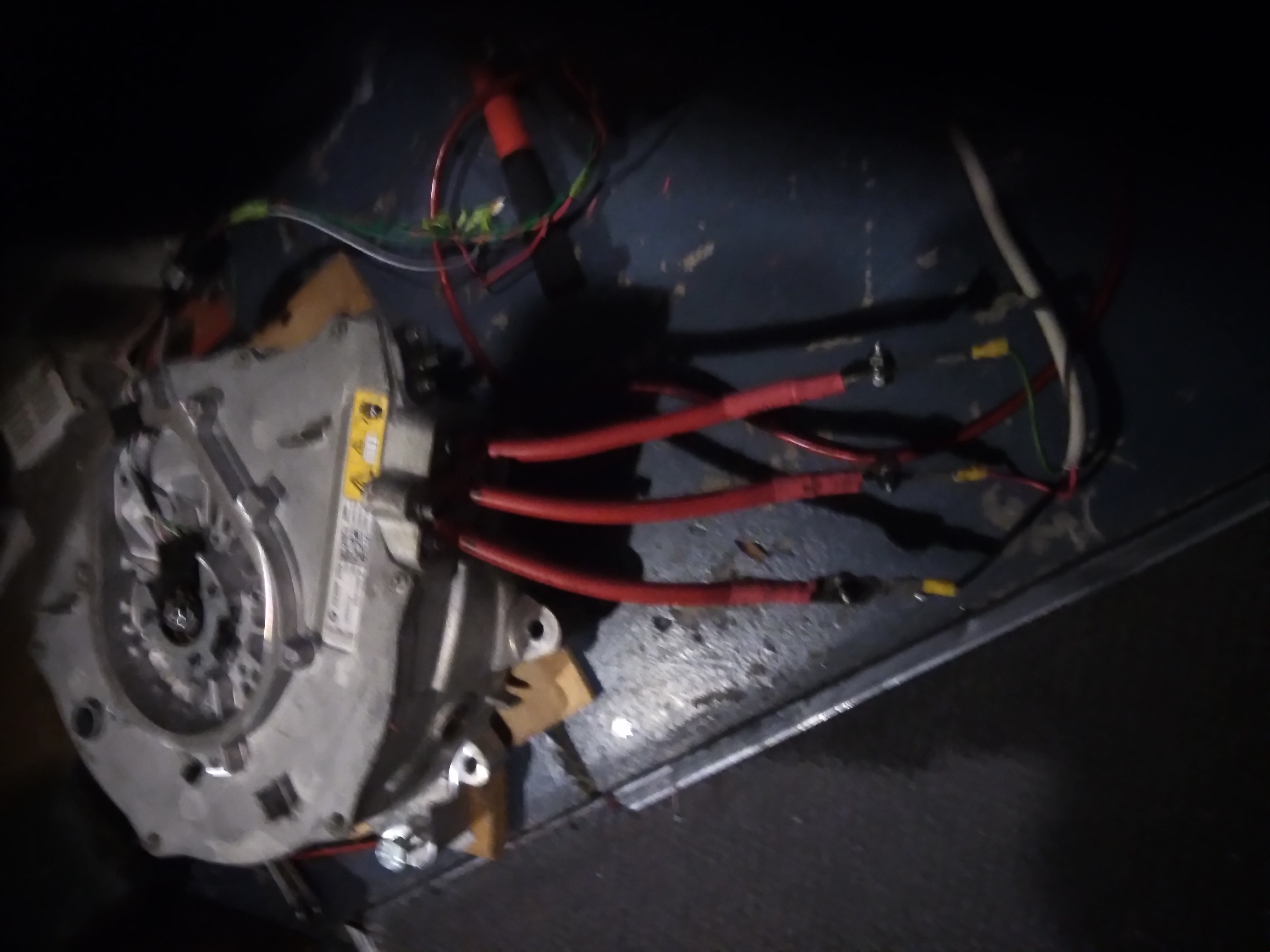

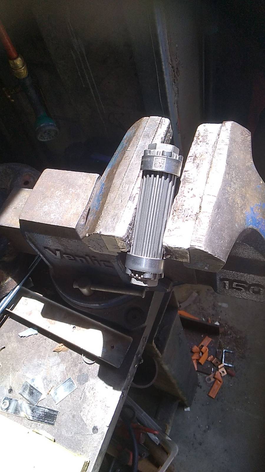

Attempts to locate a Hv plug for the REX generator have not been successful.
A dismantle to obtain a suitable UVW connection was undertaken
Some interesting finds.
Coils are 2.00mm wire wound... how many Amps ??
15 windings , as in 5 per phase. AL 5 on one phase appear to be in parallel.. My guess is maybe an eyeball at 30 A in the winding, X 5 , so 150 A per phase, so maybe 250A total at say 50v, So that would be 12.5 Kw ish.
Think there was mention of 12Kw mode, but would think this would do 80 to 90 kph at around 120wh/ km.
Can anyone confirm what an i3 can do in ReX run when the main pack is depleted.?

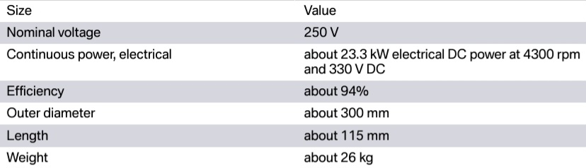

Thanks for that...
Still more curious, the 23.3 Kw stated sounds Nice.
That's much more than I feel the motor hardware looks capable of, But more to Learn.
My Big Baffle is why only around 6 or 7 kw are used in operation..
Is it some USA regulatory nobbling?
I understand that the REX was made to only function when battery at 5% SOC, a USA requirement.
The Original software allowed the Rex to operate on request. And heard of one that had been reprogrammed several years ago, to earlier status.

I'd expect the answer has to do with efficiency and emissions. Thought of differently, lightly accelerating up a hill is more fuel efficient than flooring it. If the rex is making enough power to cover average cruise power and lightly charge the battery it's likely running at the ideal efficiency.
There may be some pzev or some other acronym requiring the rex only kick on at essentially an empty battery.
5% battery might really mean 25% battery the way OEMs state the charge level.

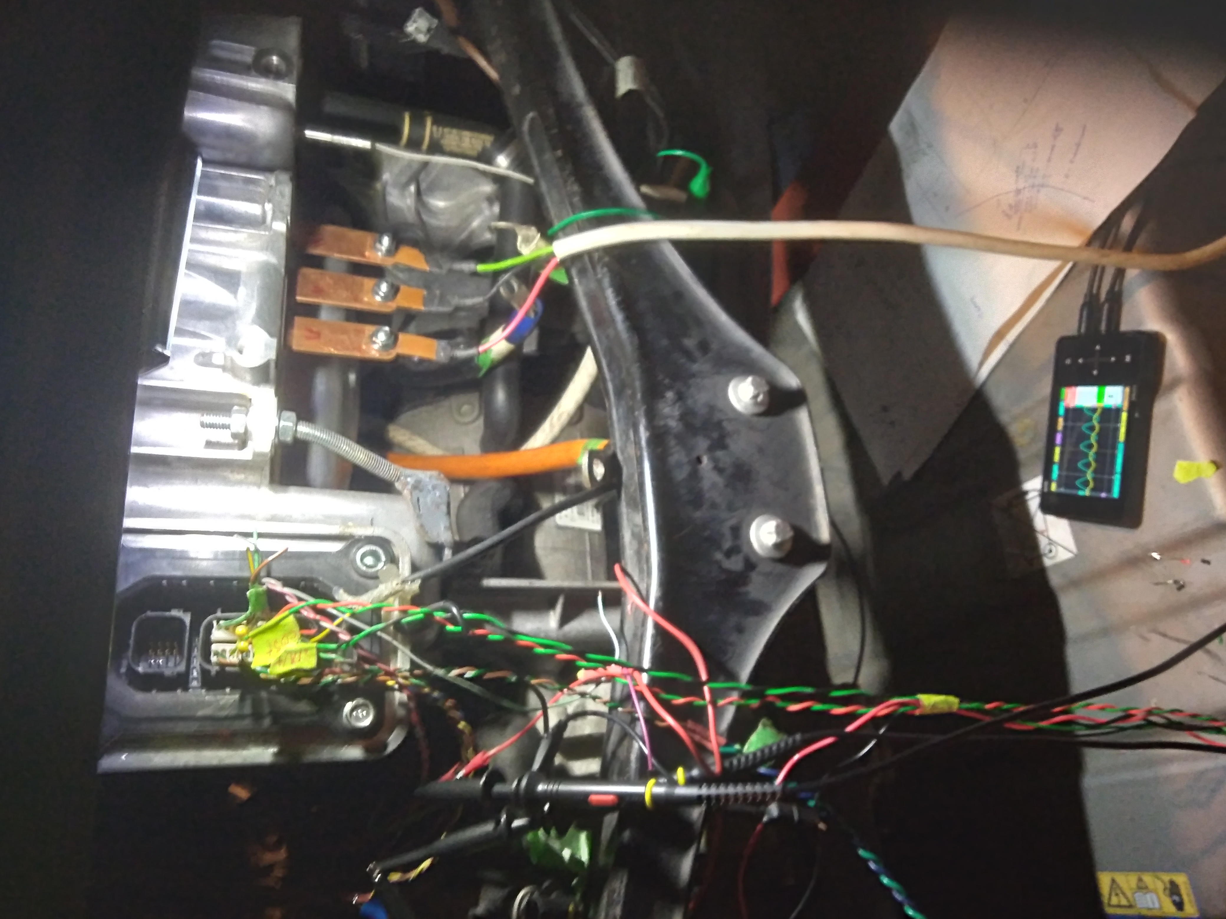

Have just achieved the Generator spinning over oñ being patched to a Nissan Leaf gen 2 inverter,
Will see how can post this progress, am challenged with videos loading... Harder than making German electrics run on Japanese electronics..for me at this stage.

With much premeditation , heaving levers and printing engineer's assistsnce, the Non serviceable Torsion spline has been re Torqued..
As the unit is extracted, the tension releases and the parts all fall apart... So there Was debate as to whether the tension should be forward and giving miniscule dampening, or reverse and the torsion being a backlash eliminator, with solid forward spline drive. Anyone have any idea..? Have gone gor the forward option..
With some guiding threaded rods and carefully assembling, the Torsion spline has been reassembled to couple the Motor and Generator ...
Best advise for this is the same as Hitchhiker's guide to the Universe about Bogon Spacecraft hitching...Don't do it. Where possible Don't separate the motor and generator.. Bmw manual requires you to replaced the Torsion spline ..
Good news is it's all back together and preparing to turn over with the Leaf inverter...
