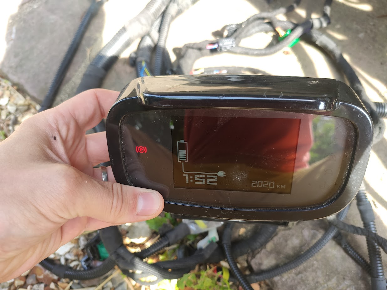

I'm in France and I have a few connection with interesting people. This give me the chance to got the full electrical system of an Citroen AMI. This is a small electrical car limited to 45Km/h.
So I got the Battery (48V), OBC with DC/DC, VCU, Motor with differential, driver display, fuse and relay box and the full wiring harness. RND switches
Things I didn't get : key and neiman and front panel switches and throttle foot contactor; break switch contactor, probably a few things I didn't know they exist.
For the moment My first task was to check and prevent the main battery from dying by too deep discharge. All this was given to me because all the system was out of order. So the Li-ion battery SOH was unknown.
I put everything outside the first day and I checked the battery voltage by opening it. I reconnected everything I tried to charge it. This system need a auxiliary 12V battery as almost all EV. I used a lab power supply to put 12V on the auxiliary battery connector. Reconnected all the chassis ground and put 0V on it. Plugged the 230V power outlet. The display powered up and shown an error message. Asking me to set the hand break. I found the connector by guessing (I didn't do the full tear down) and after few check I short it. Tada ! the charge started.
I know the setup is not safe or satisfying at all but it's day one. The idea was just to check the battery and make it charge to store them safely.
