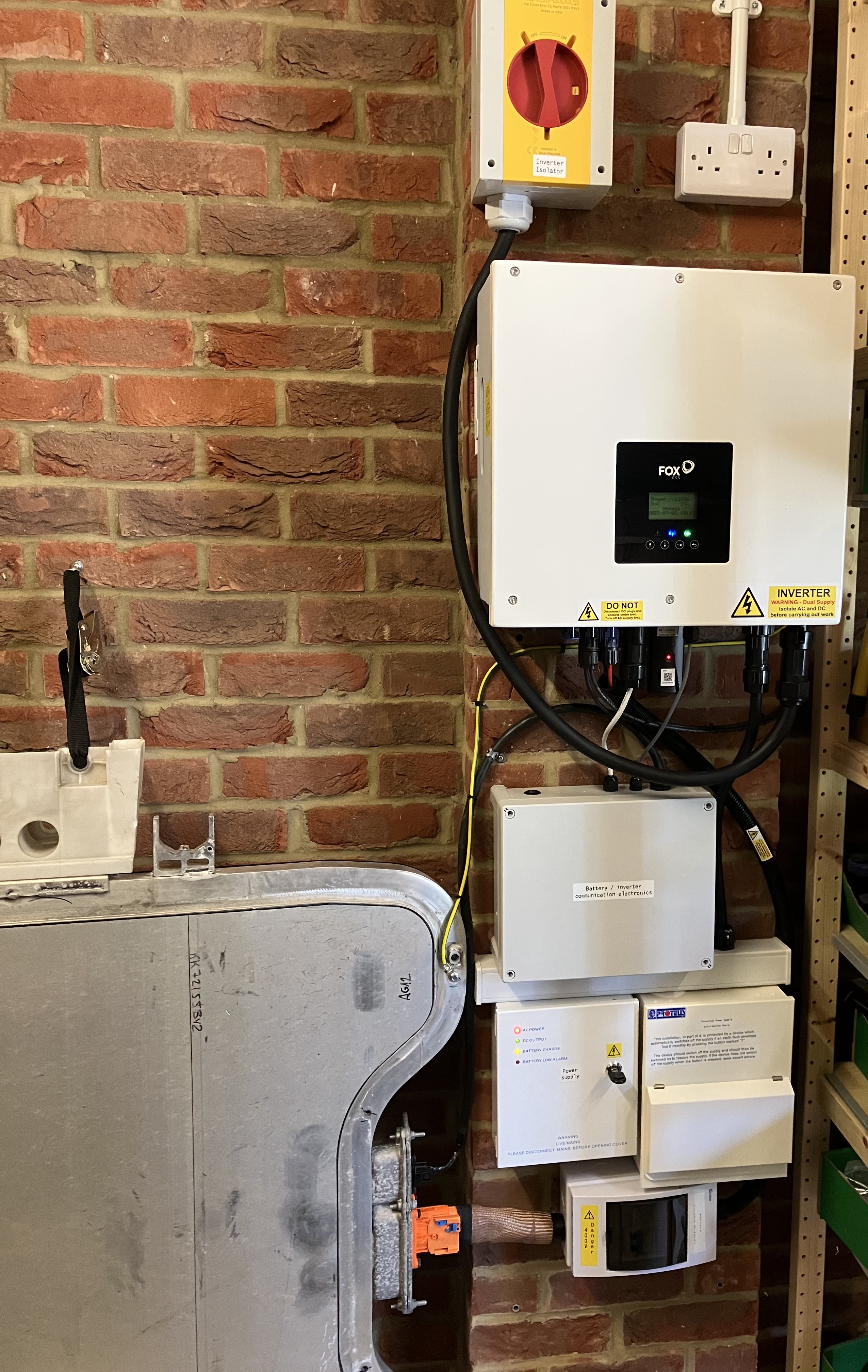

I wanted to share the project I've been working on recently, to set up home battery storage using a Renault Zoe 52kwh pack from a scrapped car.
The battery pack came from EV Breakers in Northern Ireland. The DC is connected to a FOX ESS H1 6kw high-voltage hybrid inverter via a MCB. The communications cable is connected to a Raspberry Pi based interface. This handle the can bus communications, the relays for 12v/precharge and the MOSFET to control the main contactor.

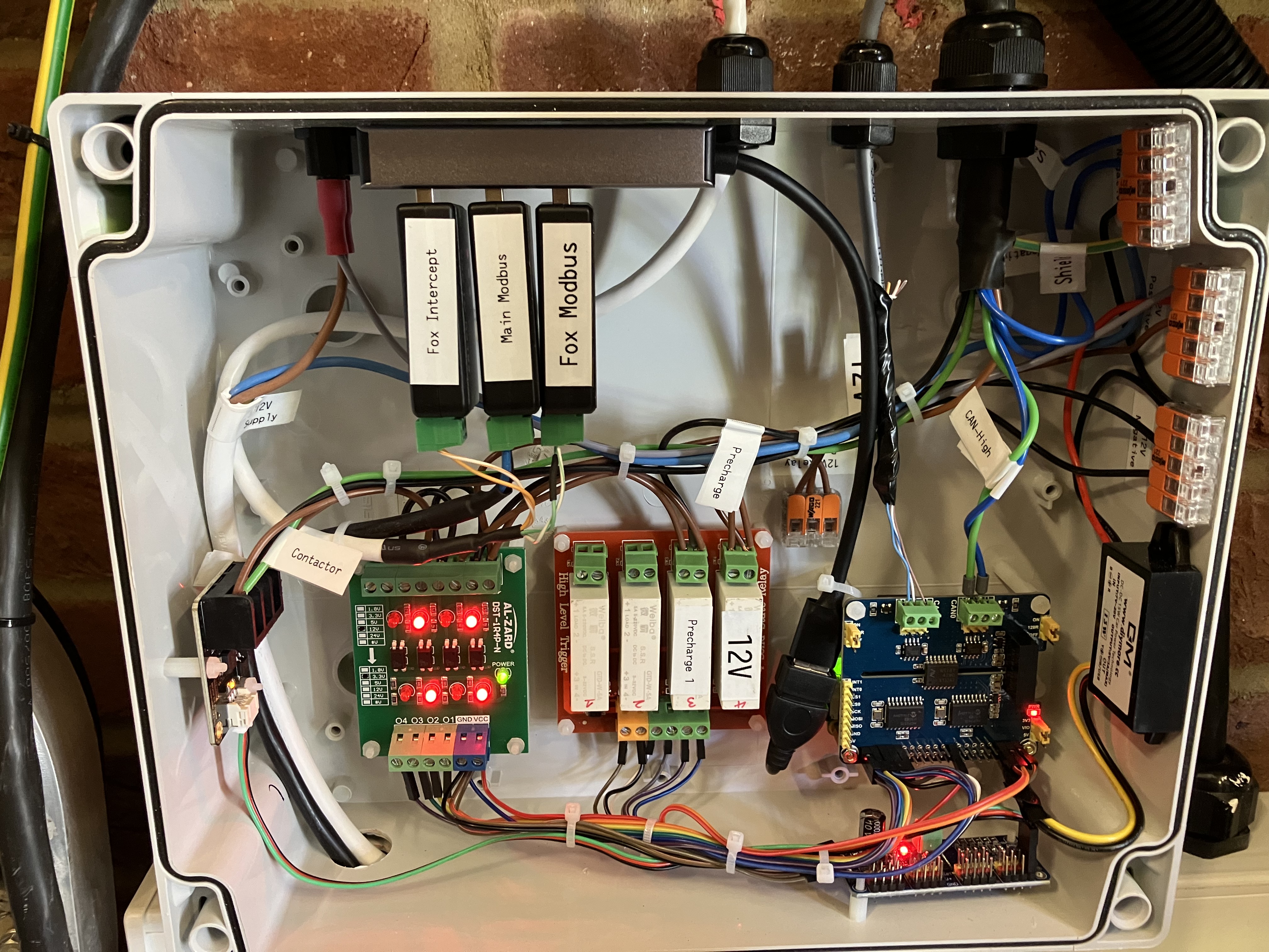

The Pi acts like a canbus bridge, communicating with the battery, and with the fox, so that they can talk to each other. It also handles Modbus to communicate with the inverter and the meters.
In the photos, you can also see a 12V battery backup power supply to maintain power to the control equipment in the case of a power failure so that the battery can still operate. There is also a small consumer unit for the essential power supply
This is only possible thanks to some code that woleg/rand12345 put on github showing the can bus protocol for both the Fox battery and the Zoe PH2 battery. Unfortunately it looks like that has since been removed, but there are some useful links I've pasted below

Ah okay. I've been controlling charging via max_charge amps and it seems to work well, it's very quick to respond and can keep the battery at a specific charge level that way.
One modbus talks to Fox on the normal RS485, another is for my main Modbus network with multiple devices, and the other is on the Fox Meter Modbus. I intercept the fox meter modbus because if it's on the normal main modbus network, it wants to be the master. There can only be one master on Modbus so then I wouldn't be able to talk to anything else on the modbus network.
I could put the normal Fox RS485 on the main network, I just haven't tried it yet

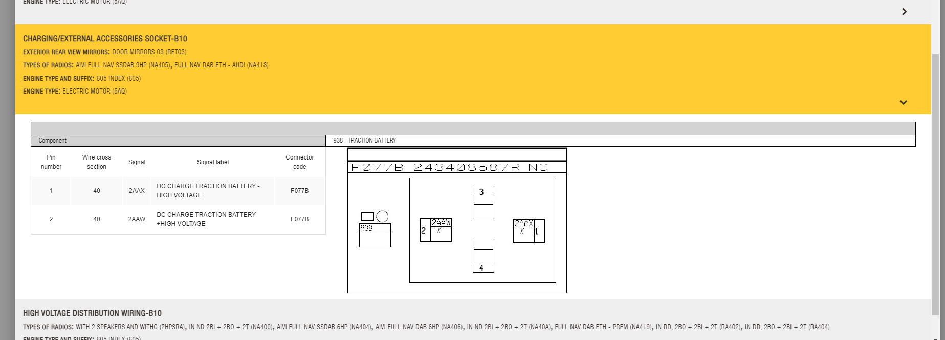

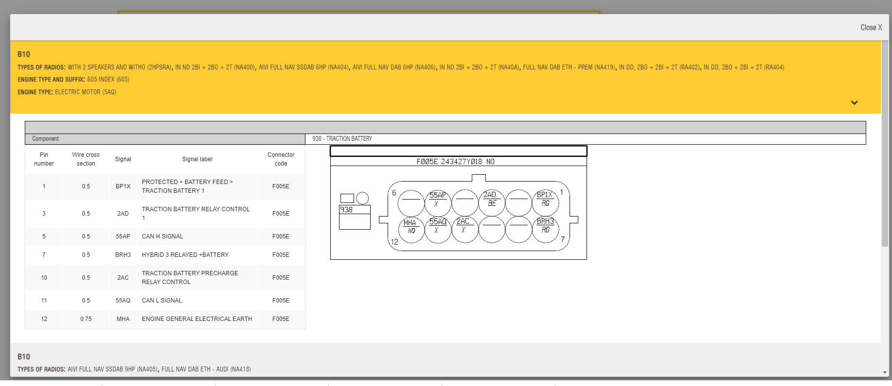

Do you have a pinout of the LV battery connector? I'm unsure whether it is the same as previous models (22 and 41kWh).
The picture looks the same, but can you confirm that signals also correspond?

The connector is the same 12 Pin 7282-8854-30 but the pinout is different, pinouts attached. These are from Renault "New Dialogys" which you can pay for, for just an hour, to get diagrams and pinouts. For the relays to work you'll need to connect that "HYBRID 3 Relayed" pin, but I can't remember if it needs -12 or +12v off the top of my head.
You can see canbus dumps from the HEV bus here https://github.com/ljames28/Zoe-PH2-EV- ... nformation . It only really needs to see 0x373 to wake up and then you can talk to it using https://github.com/fesch/CanZE/blob/mas ... Fields.csv
However, I've had the battery running since, and the delta between the minimum and maximum cell volages has been rising. It's now sitting around 120mv. There is at least one other person with the same issue. As far as we can tell, the battery is never balancing. Presumably there is some sort of signal or something on the canbus in a certain sequence that it is expecting to see. I've even dissambled most of the LBC controller code but haven't yet worked this out.

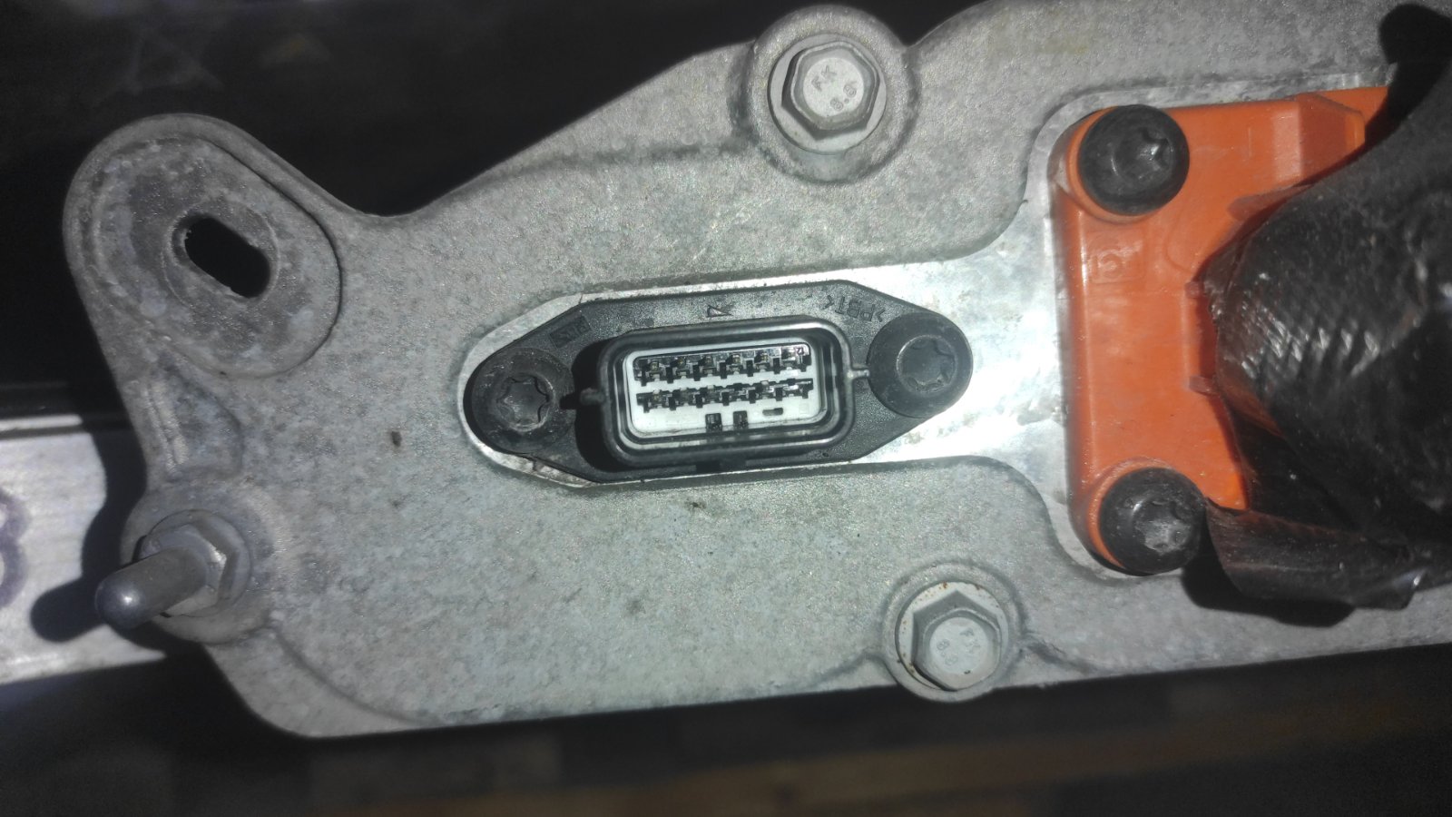

Yeah but in the photo has got 14 pins and is not clear
I will have my used car in a month to see this better , for the battery I will have to fly to Germany or Norway so is not easy to find out for use how many is the pins , I just want to save time to fix my testing plug.
I order the 12 pins connectors female and male from AliExpress , is very cheap and may be I can connect the 12 pins on a 14 with some configuration , but I am not sure because of the photo.
Besides that he connector of 12 pins is for the hybrid , but yeah I only need the can L can H to connect it. Thanks for the reply but we need a better quality picture or a schematic from the ZOE to be here for the record to help others. Keep up-dating

I believe Yaskos photo shows 12 pins. You can go on Renault ASOS/DIALOGYS to download diagrams of any Renault connectorsTeslaCoilkV wrote: ↑Sun May 26, 2024 12:33 am Yeah but in the photo has got 14 pins and is not clear
